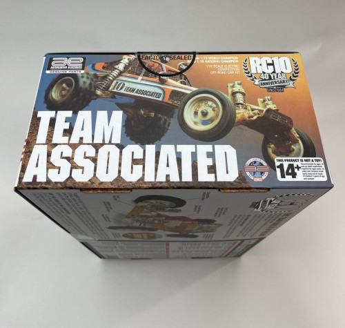

Box looks amazing, I really like how they did a matte finish to give it the classic vintage look.
#6007 RC10 40th Classic Kit
Made in Taiwan
Standard 'Factory Sealed' stickers (3)

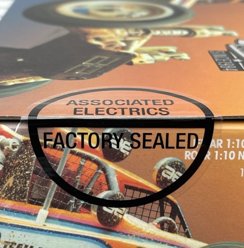

"Genuine Parts" this is a new logo and indicative of AE's recognition of the vibrant aftermarket that has spawned in the wake of their absence :mrgreen:
Very cool embossed '40th Anniversary' logo. Obligatory 'Designed in the U.S.A.'
There is NO serial number present on the outside of the box...

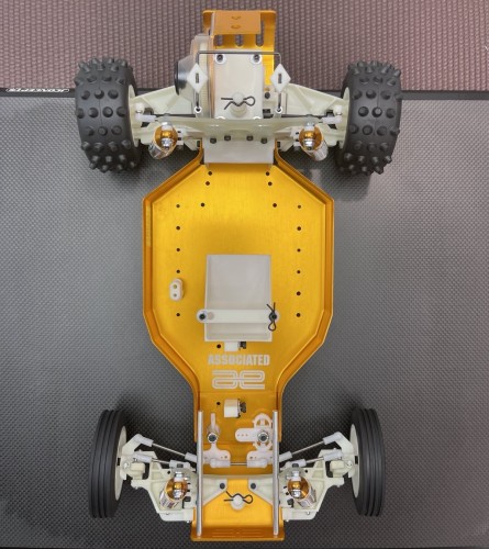

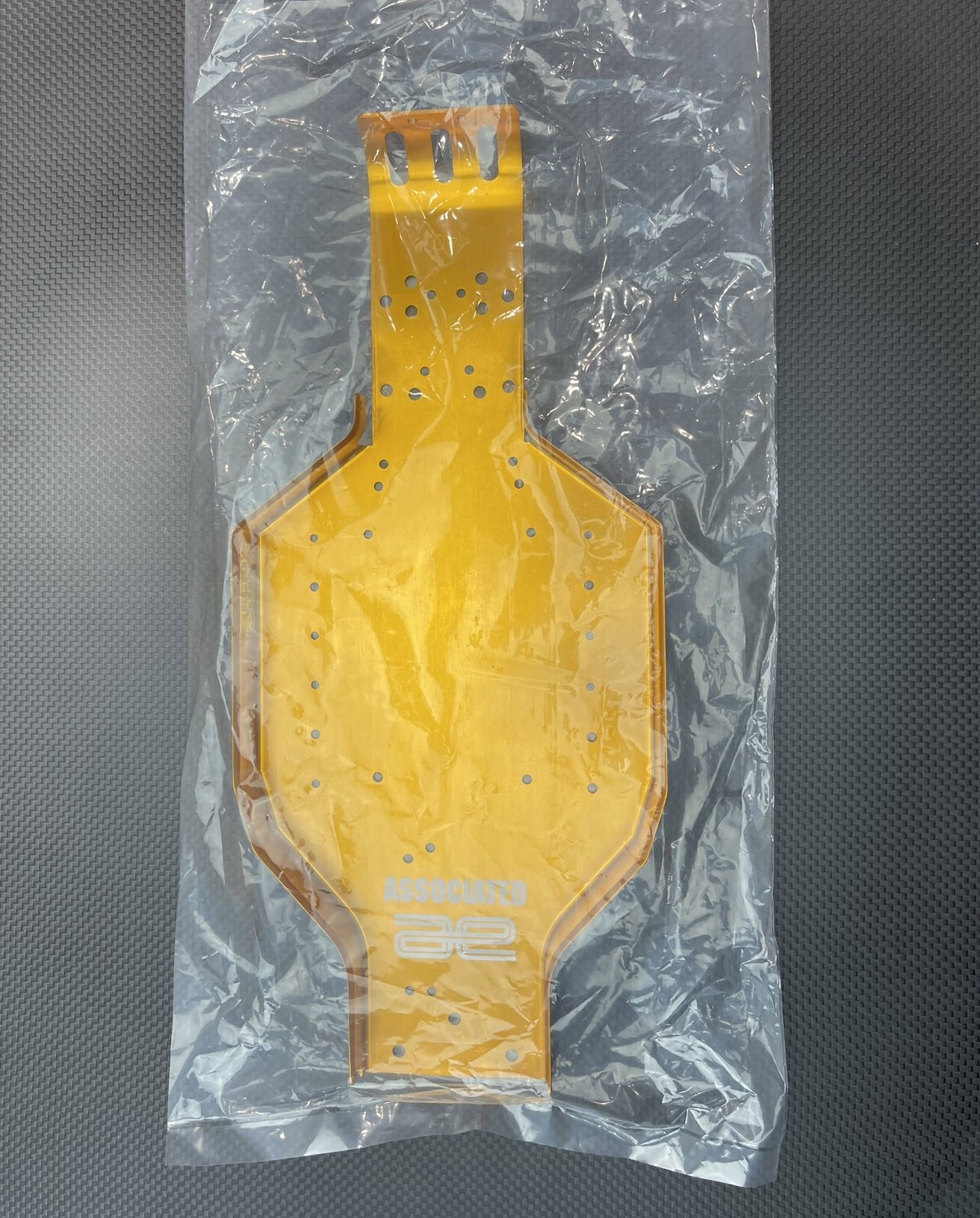

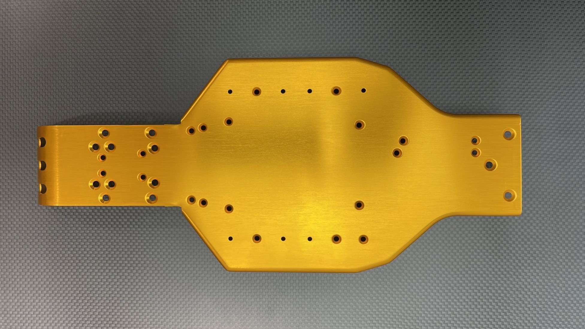

Chassis comes bagged to protect it.

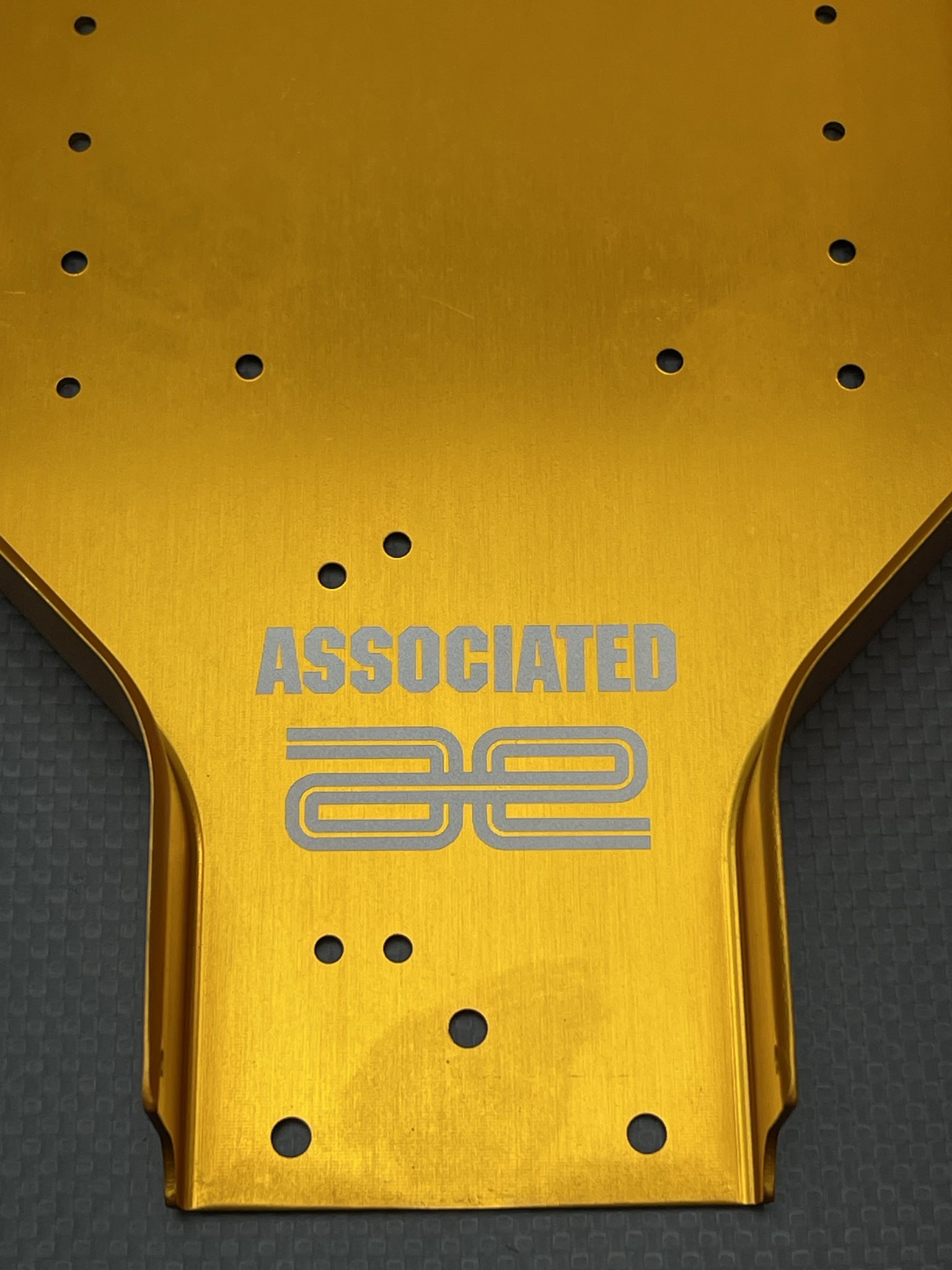

Laser etched logo.

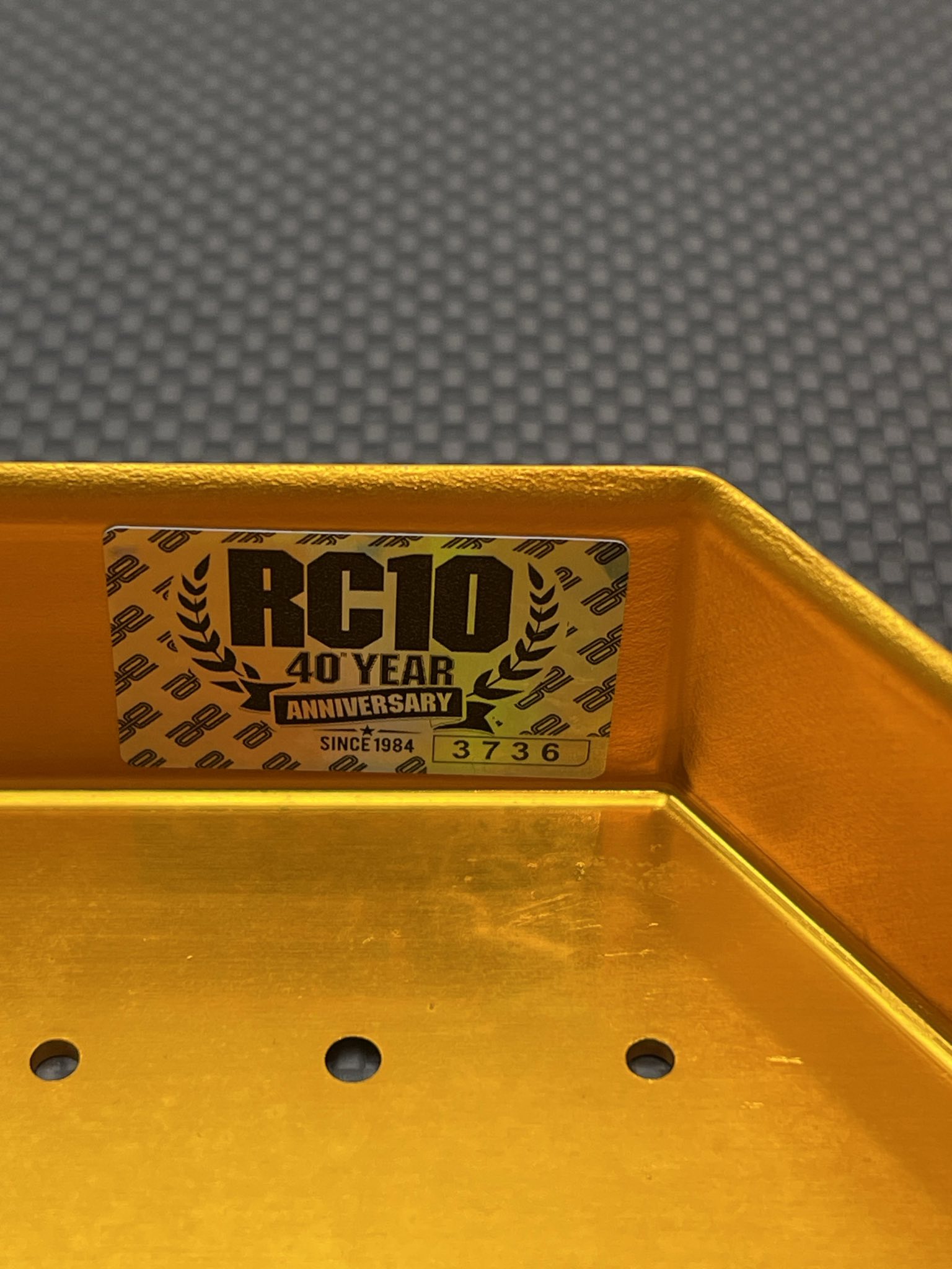

Serial number.

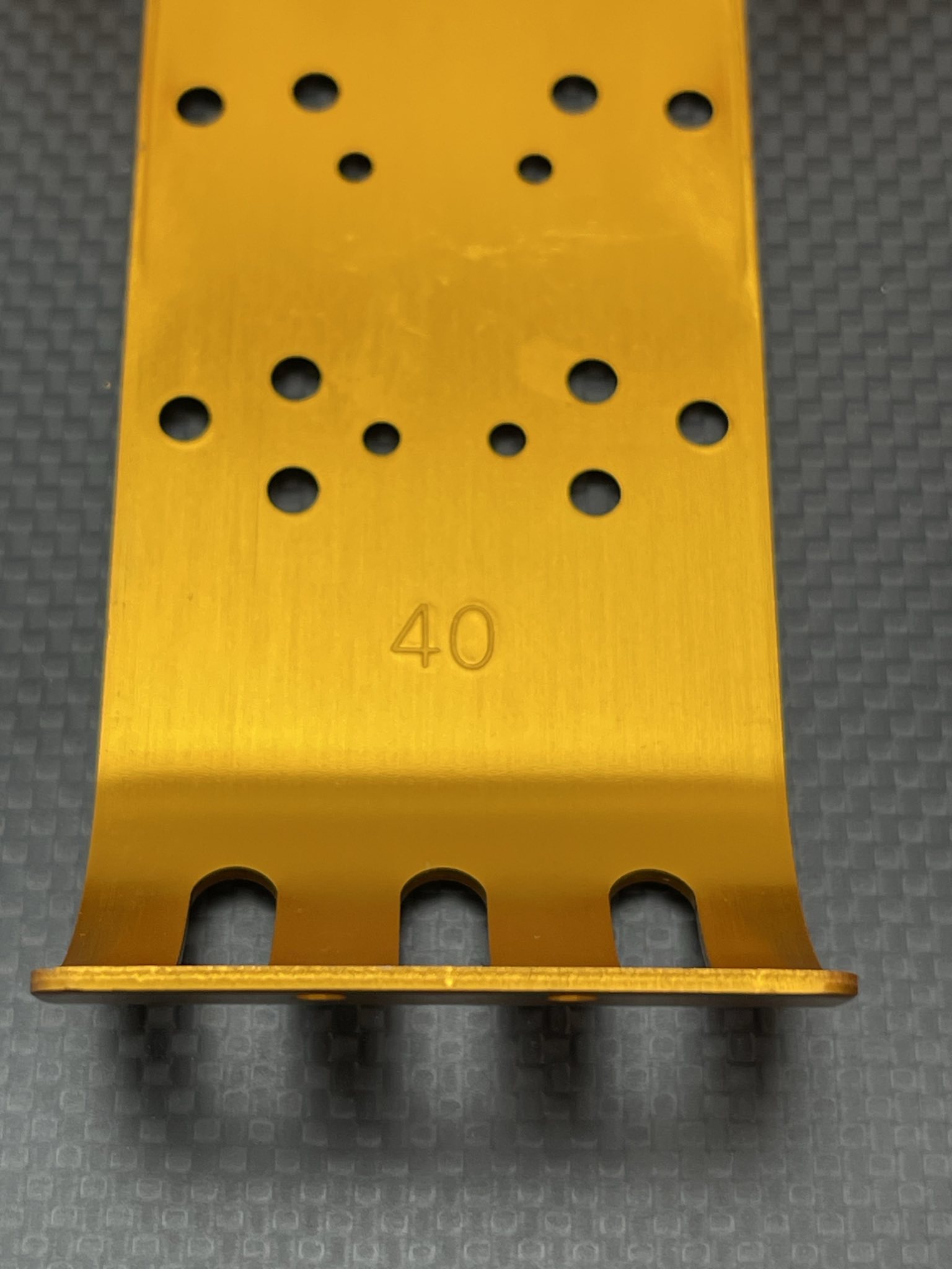

'40' stamped chassis is a nice touch!
Bottom of chassis. Anodizing is much better quality and color than the 2013 re-release.

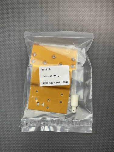

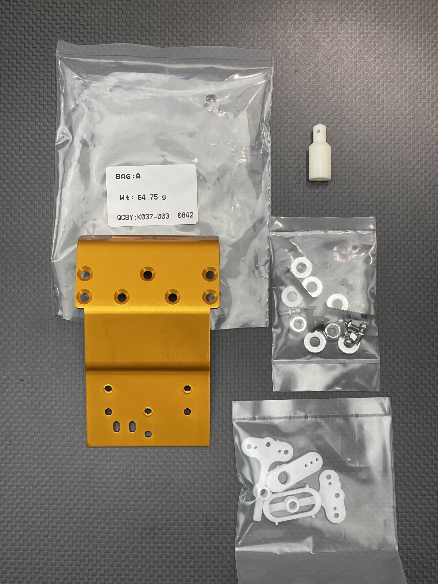

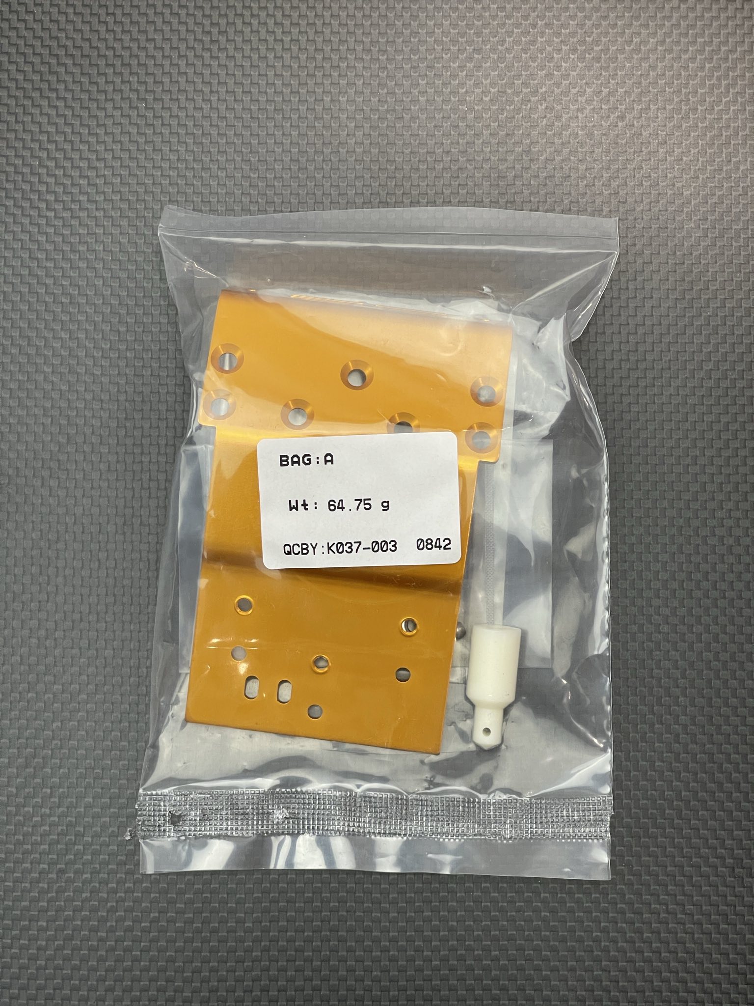

Bag 'A'
Contents of Bag 'A'

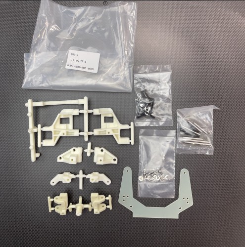

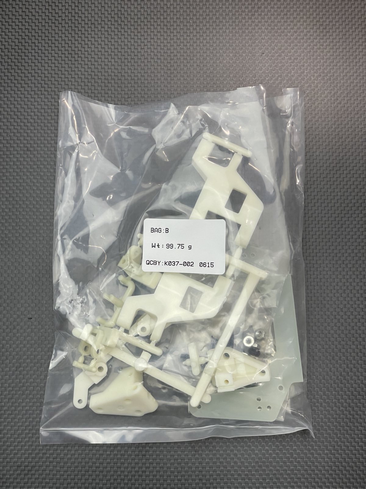

Bag 'B'
Contents of Bag 'B'

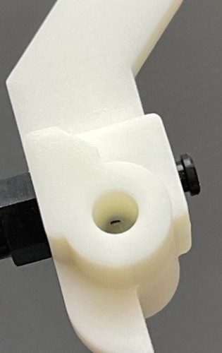

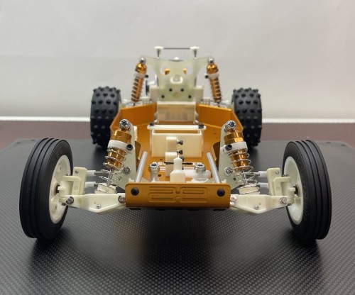

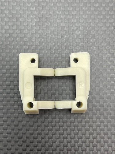

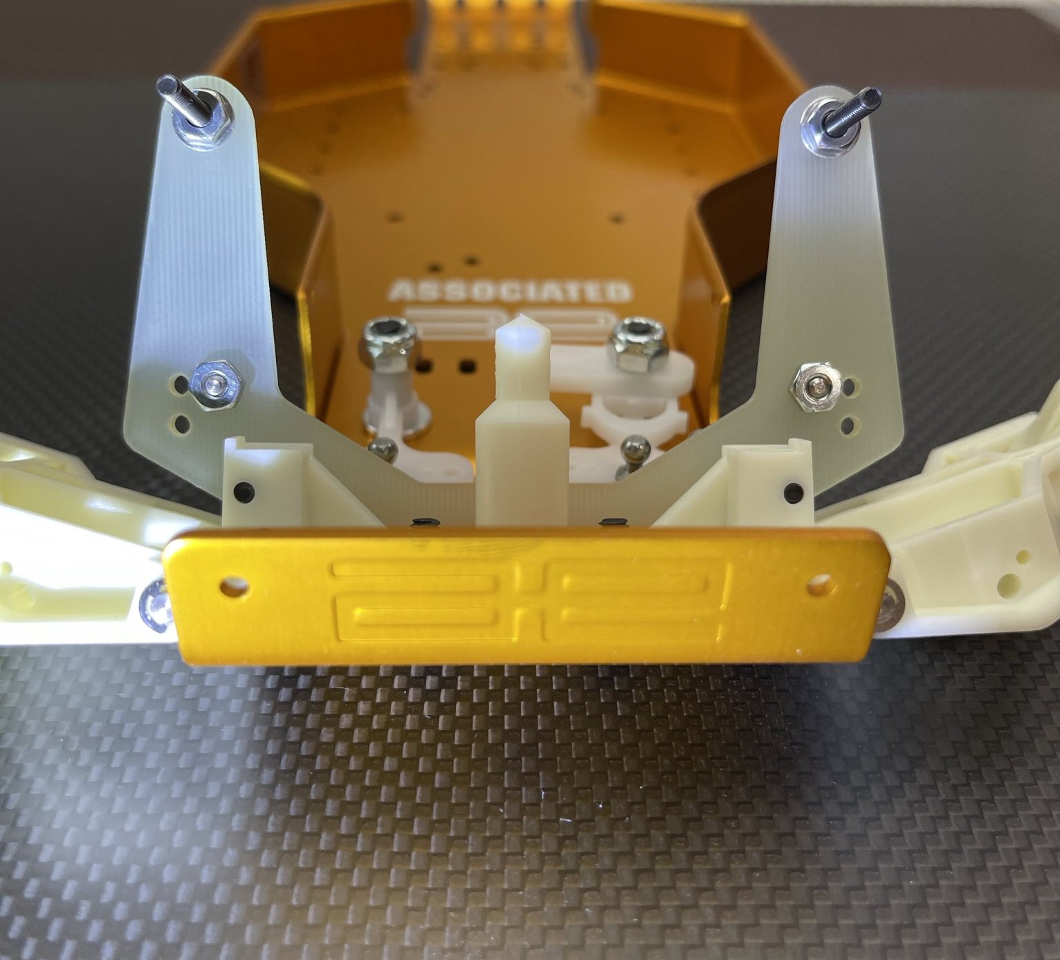

** Distinct color difference in front block carriers

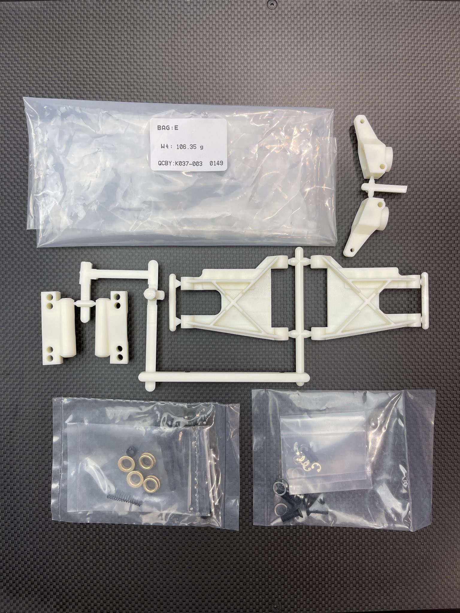

Upon inspecting front block carriers they appear to be glass filled nylon where all other front parts are plain nylon. No idea if this is intentional for strength, but definitely does not look aesthetically appealing. The inside of the block carriers look to be a bit more relieved and thinner, curious if this was the driver for making them glassed filled. For a 'shelf queen' I would have liked to see consistency in the materials for all external nylon pieces. Frankly, this is a potential lost opportunity for AE to release 'hard' versions of these parts. Who knows, maybe that is on the radar 8)

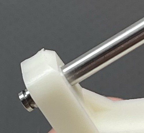

Thin mold wall on steering blocks where axles intersect

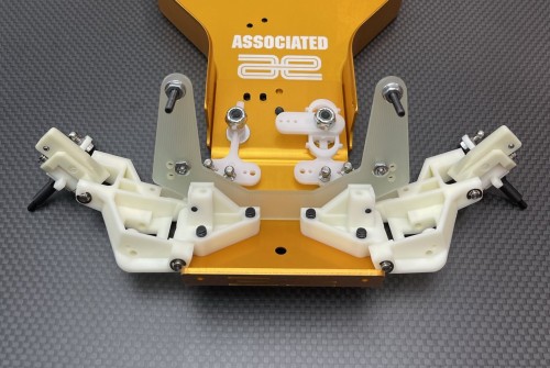

Unique relieved chamfer on leading edge of front a-arms
Good quality fiberglass with vintage looking weave, much better than the 2013 re-release.
Fit and finish is actually exceptionally nice, everything went together well and moves free but without excess slop. I am impressed :D
Stamped front nose plate!!! Absolutely wonderful!!!

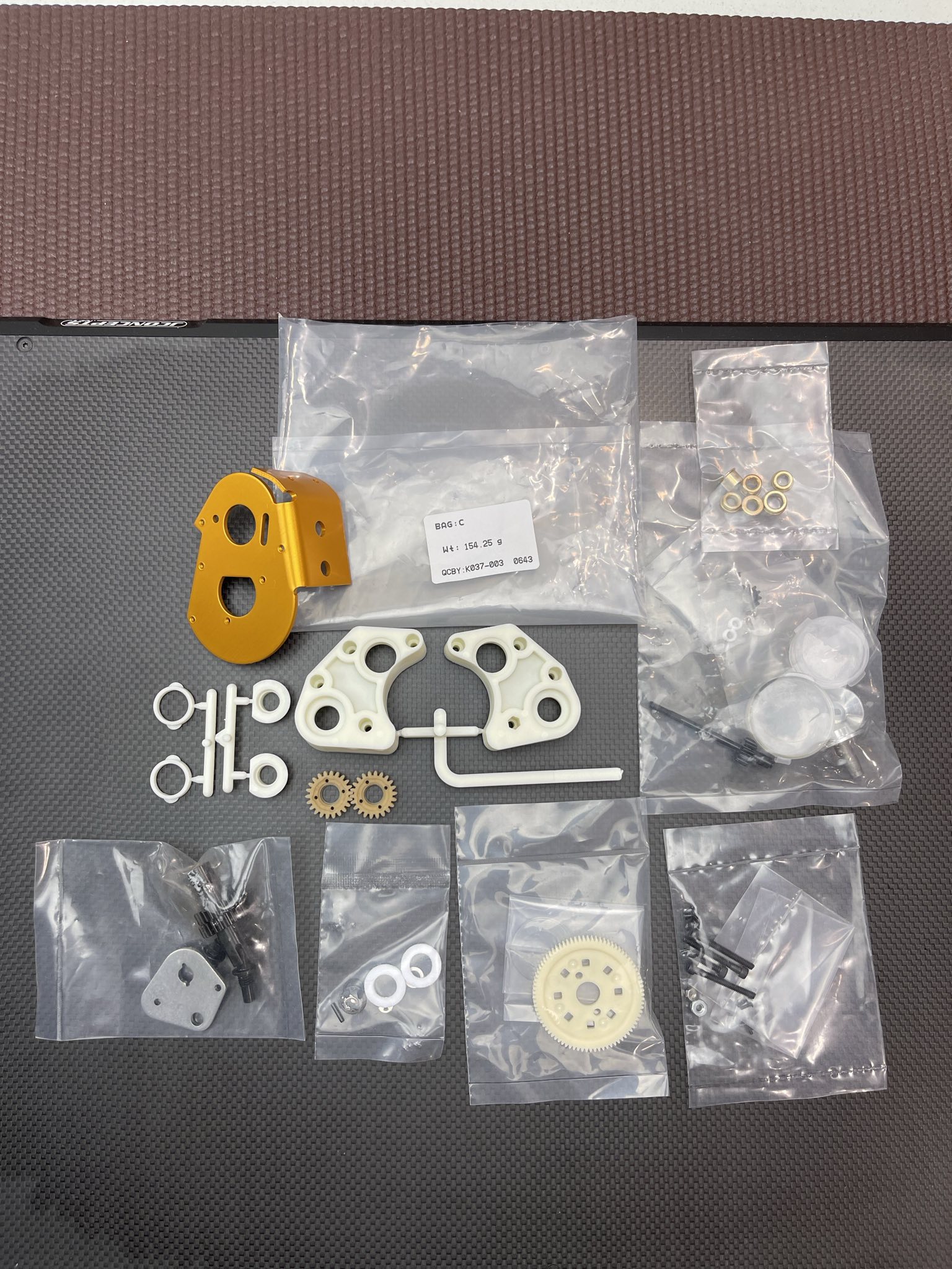

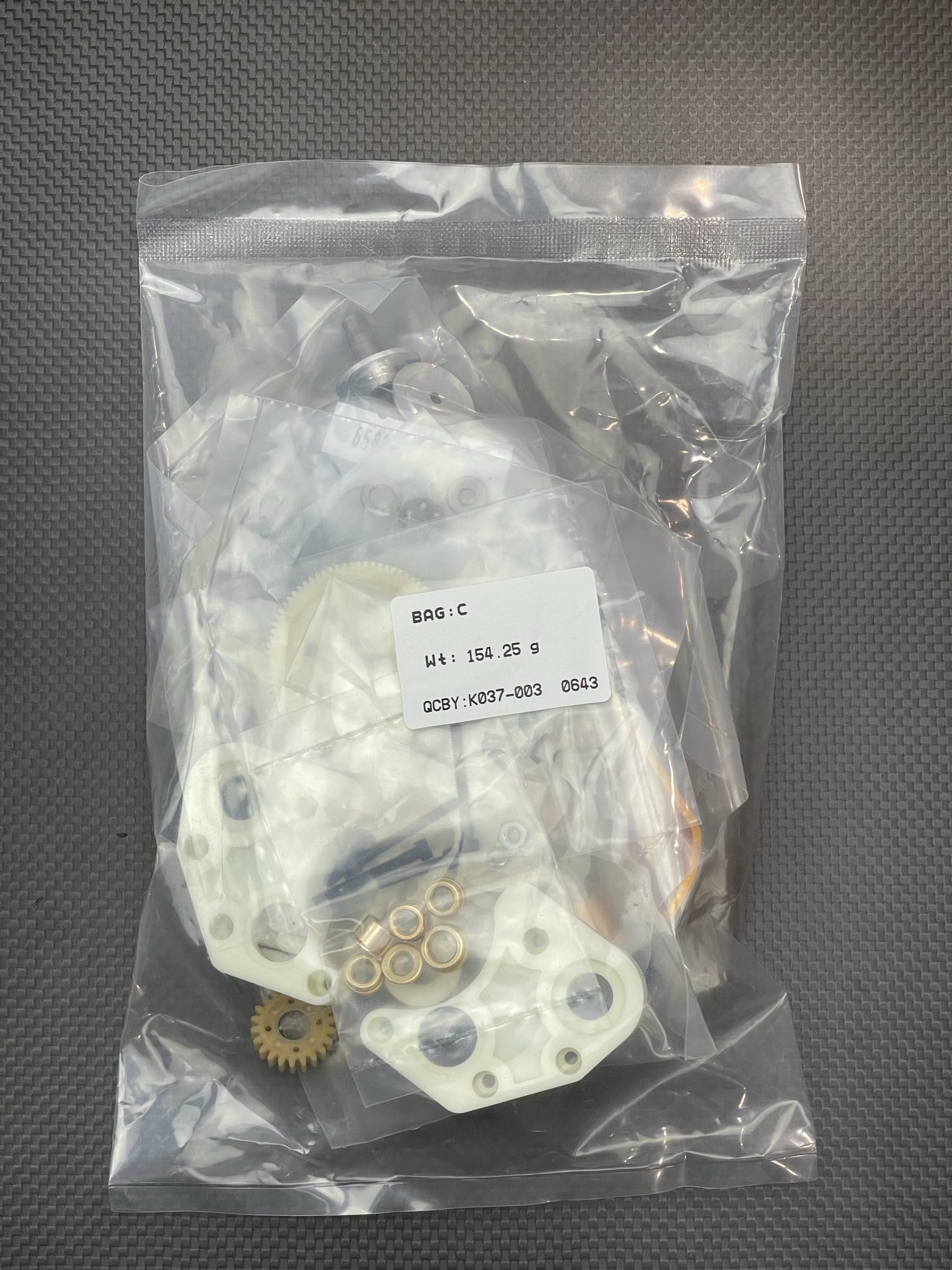

Bag 'C''
Contents of Bag 'C'

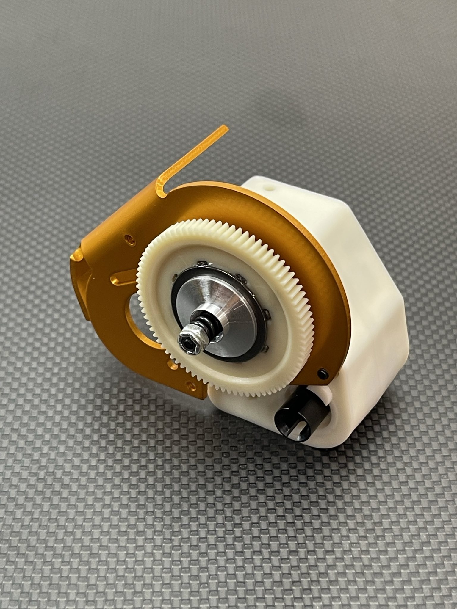

- Spur gear is low % glassed filled, for strength.
- Idler gears are high % glassed filled, for strength
- All steel internals are coated black, possibly a DLC coating?
- Bushings are not oilite, possibly just plain bronze?
Completed transmission, everything went together well and is surpsingly smooth with just a few burrs in the gear mesh.

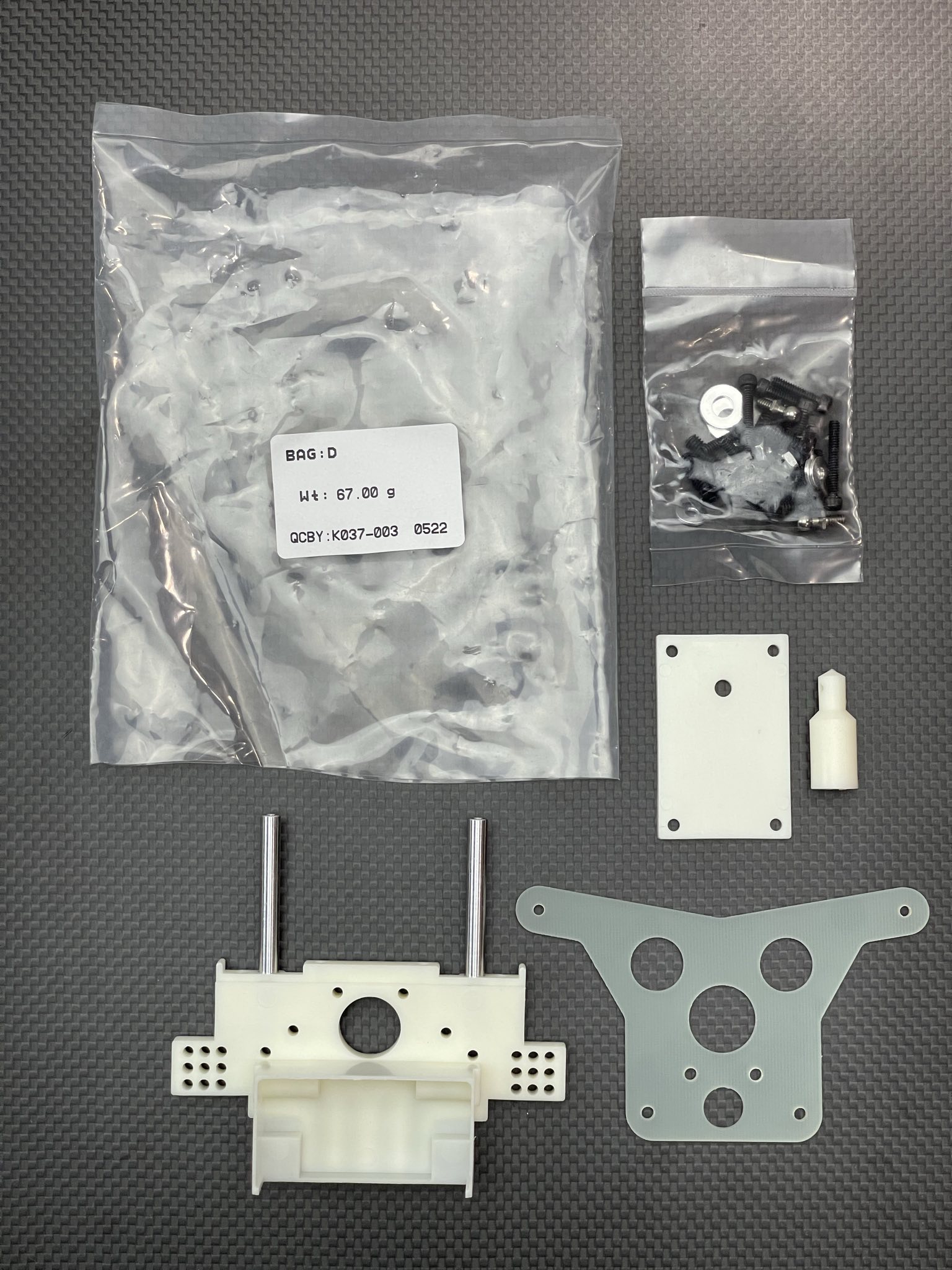

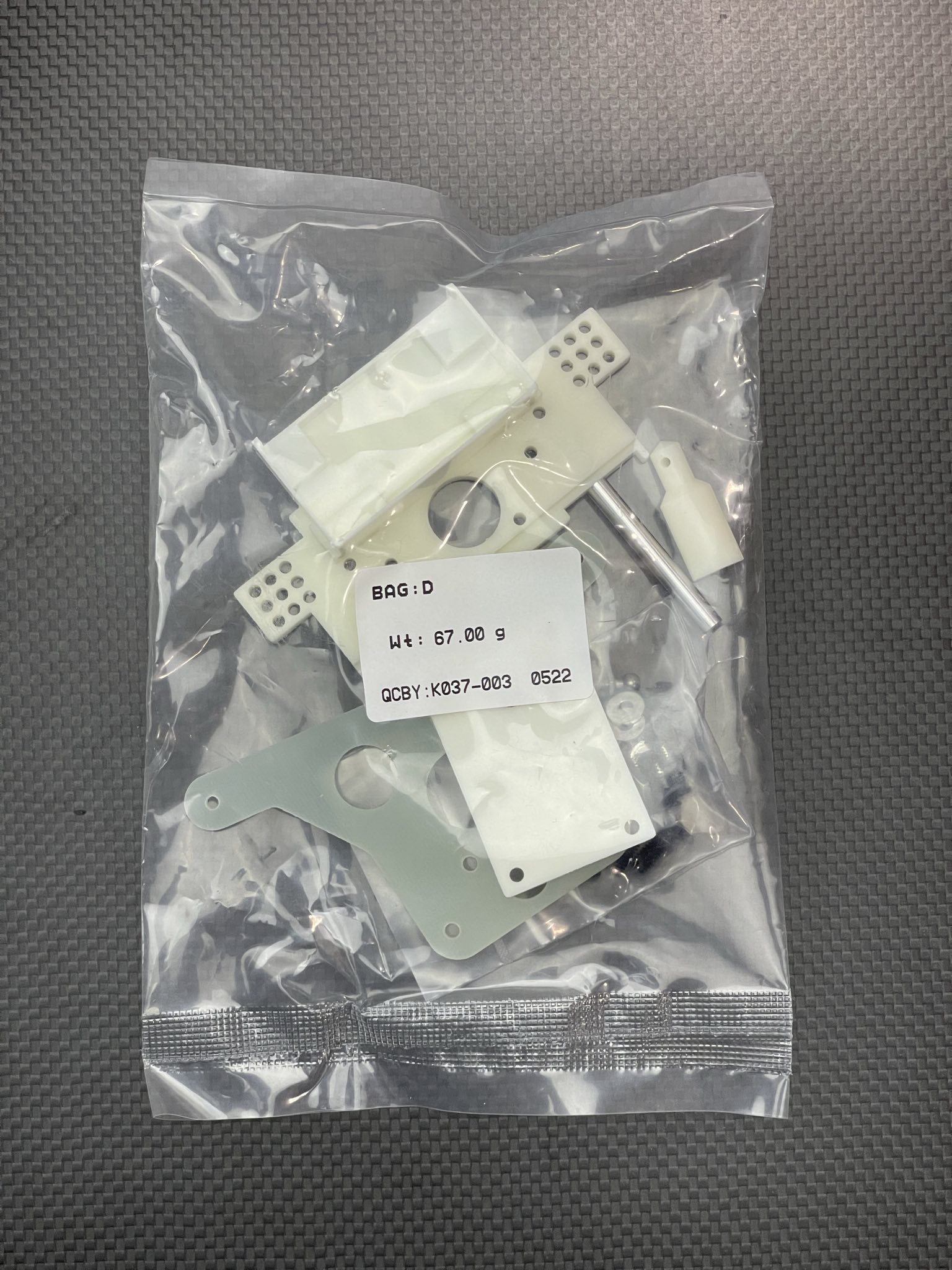

'D' Bag :lol:
Contents of Bag 'D'
Coming along nicely... Really impressed with the build quality, very enjoyable so far...

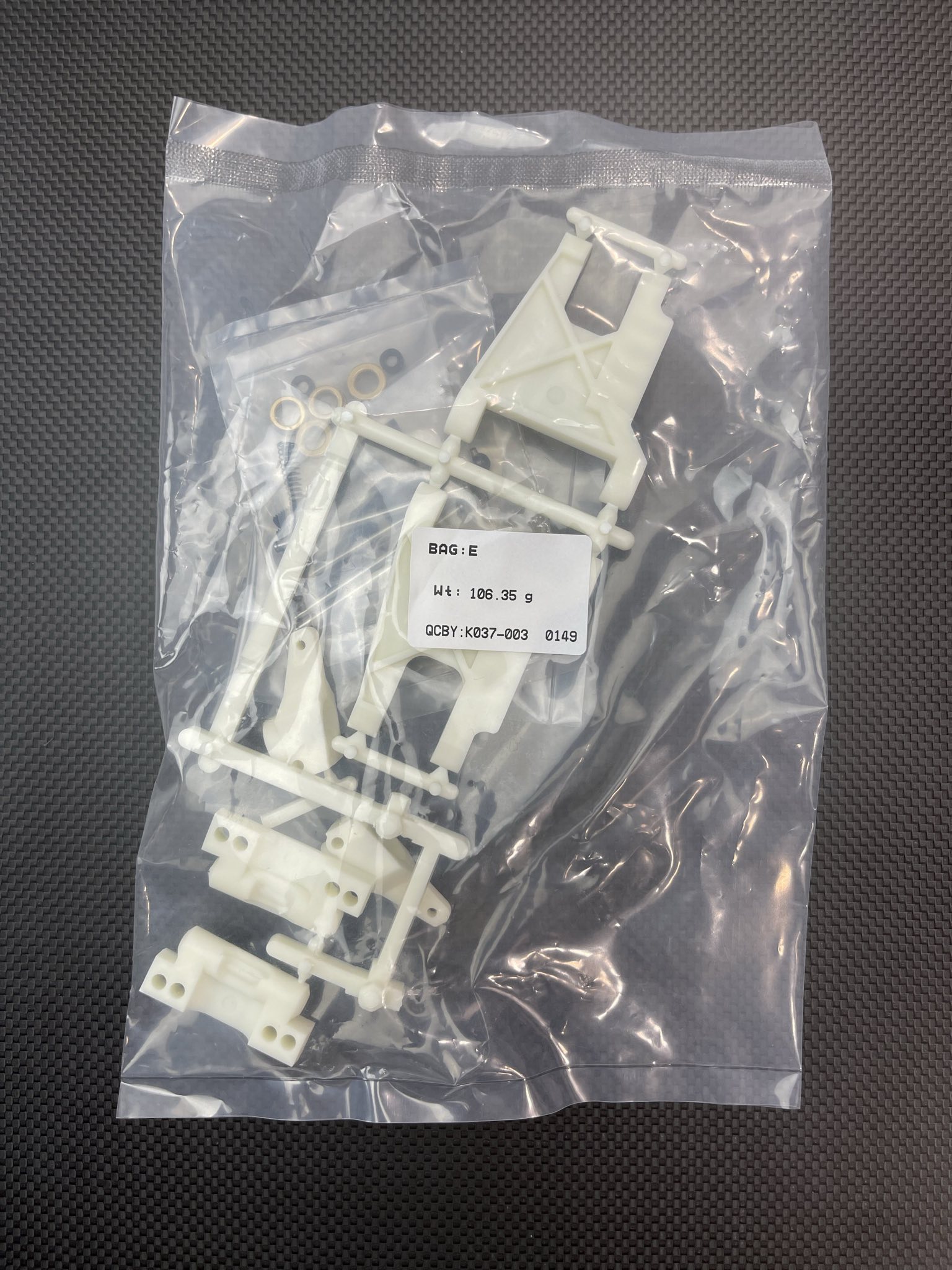

Bag 'E'
Contents of Bag 'E'

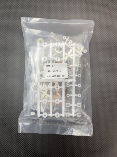

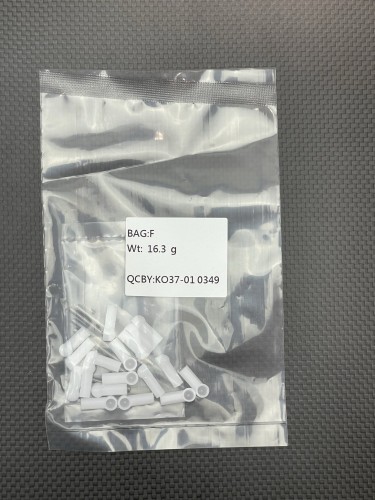

Bag 'F'
- WHITE BALLS CUPS!!! :D
- Full hex on the ball cups
Build has been an absolute pleasure so far, super impressed with the quality thusfar.

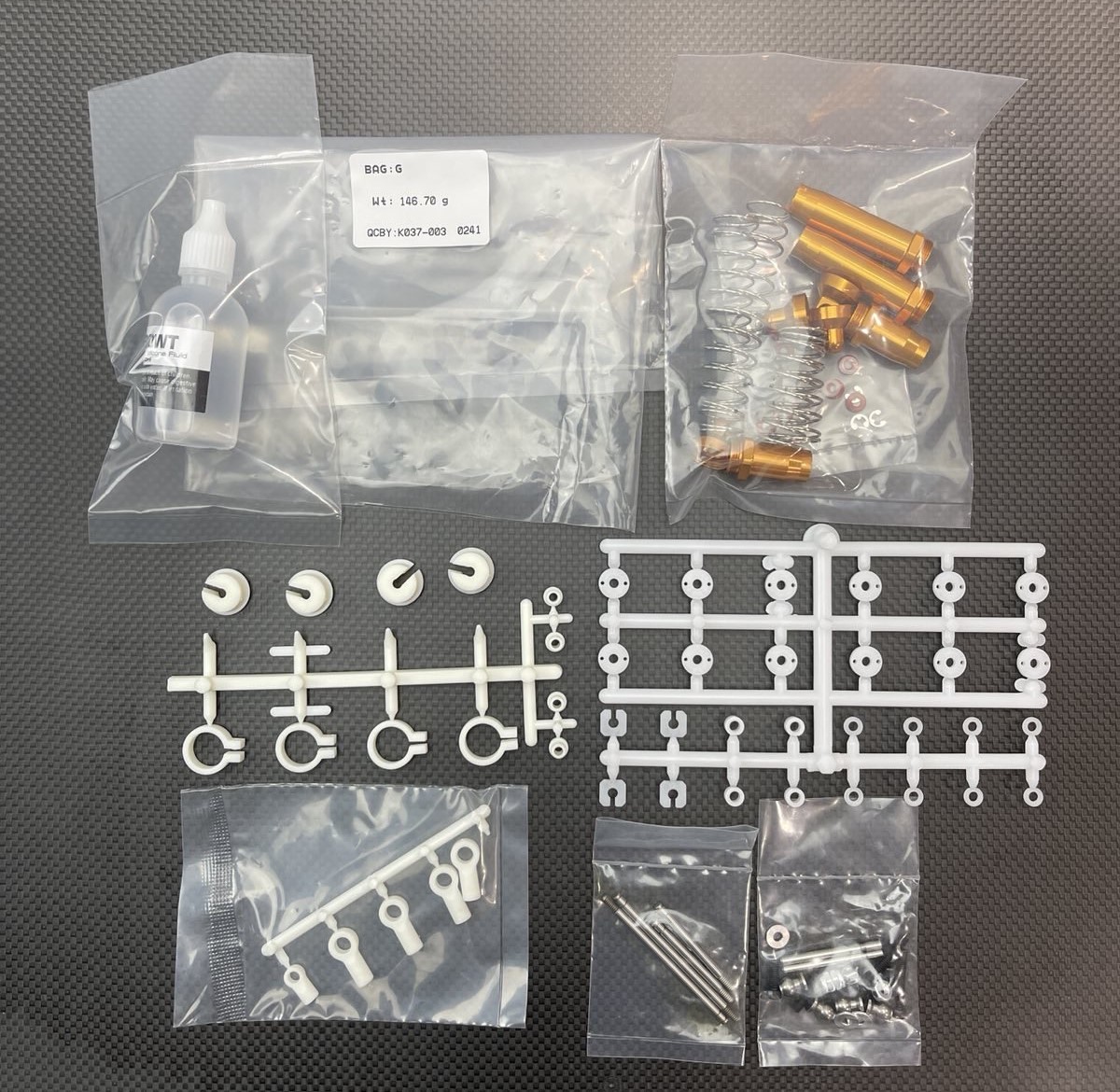

Bag 'G'
Contents of Bag 'G'

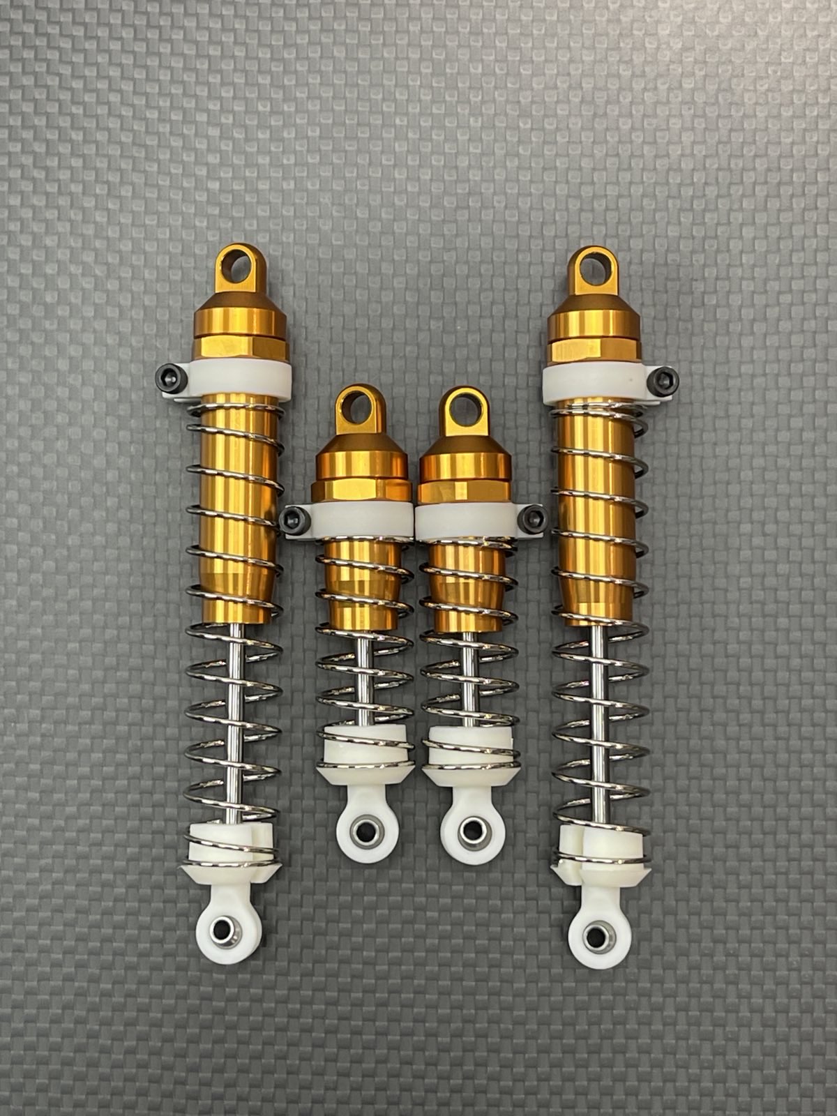

Completed shocks, fit and finish on the shocks is quite nice.

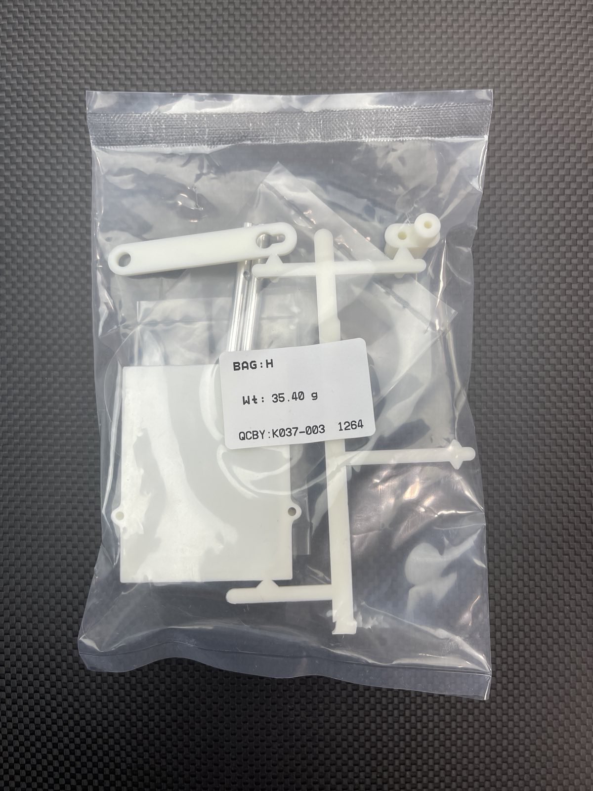

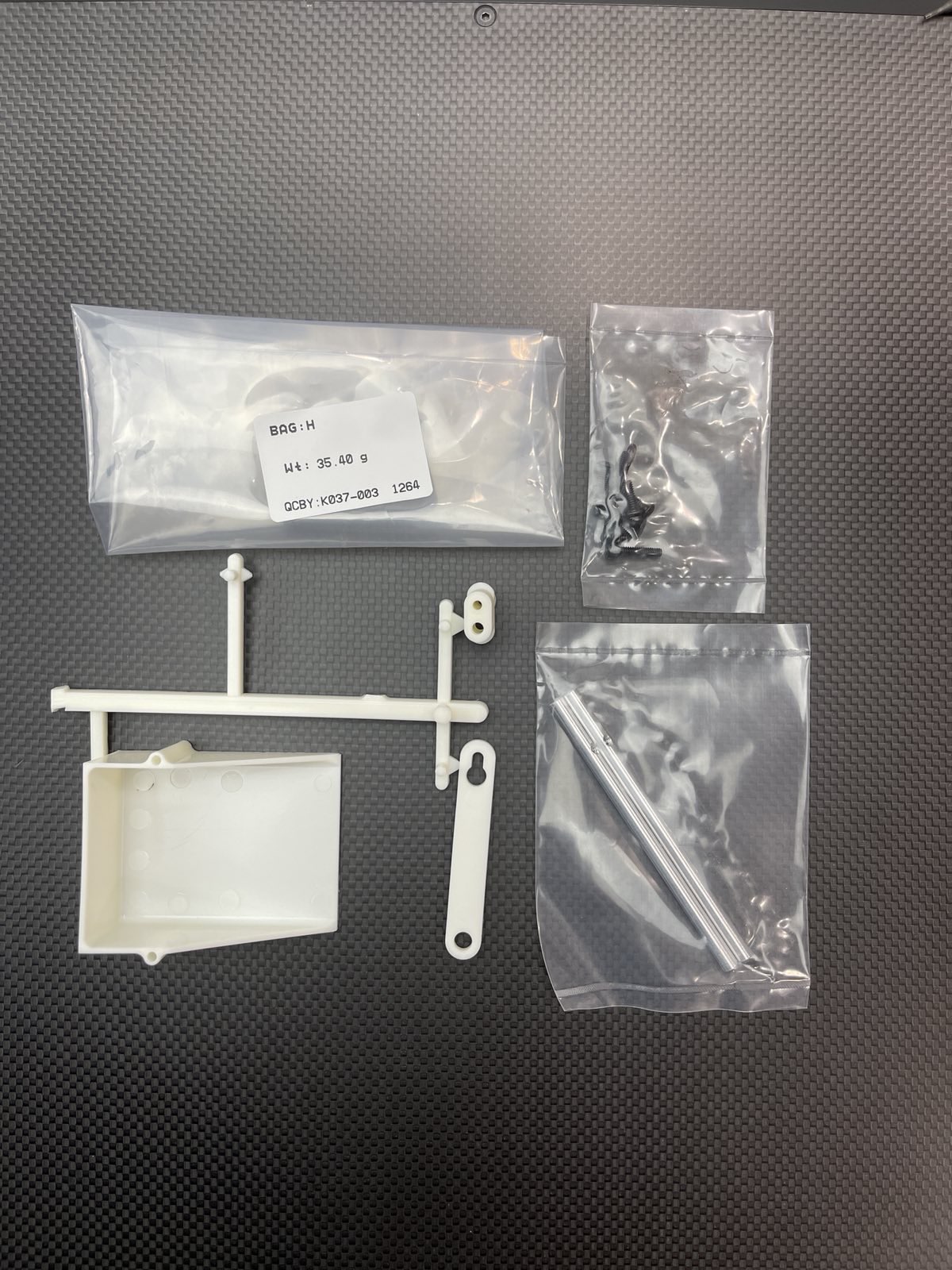

Bag 'H'
Contents of Bag 'H'
Small gripe, wish that AE would have included two (2) battery cups and straps instead of one. Kinda cheaped out in my opinion.

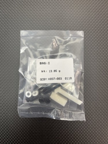

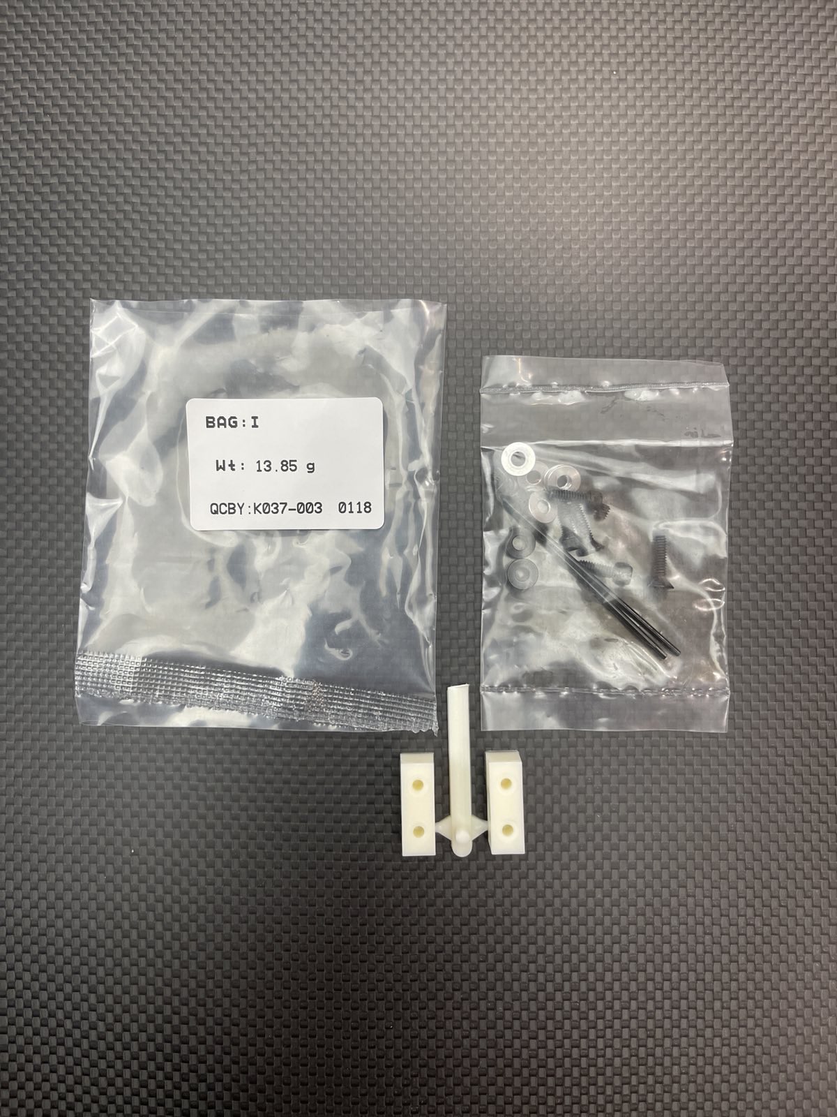

Bag 'I'
Contents of Bag 'I'
Similar gripe as Bag 'H', in my opinion AE should have included two (2) sets of servo mounts. In fact, just as a nod to the heritage and vintage nature of the kit a mechanical speed control would have been really neat.

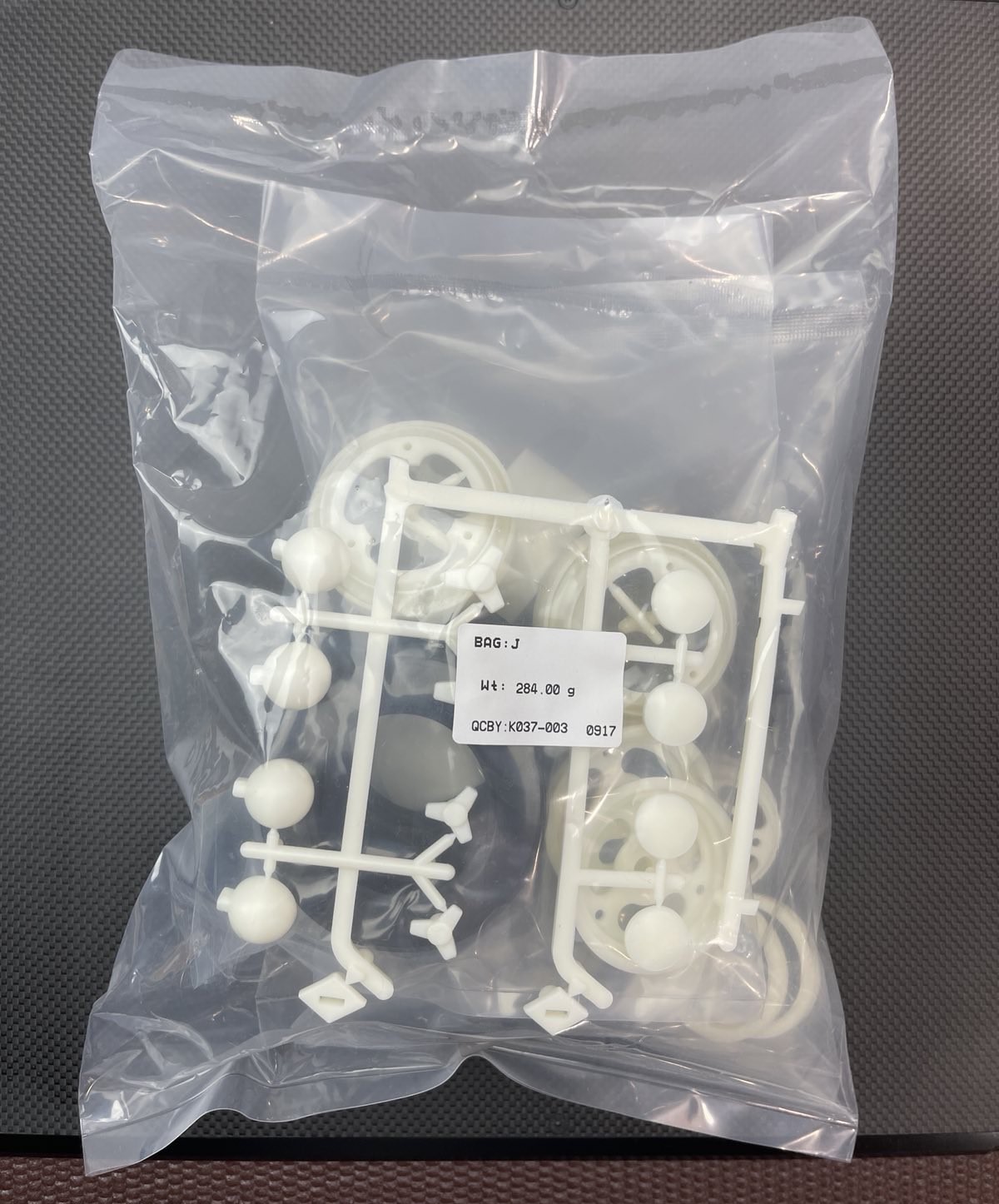

Bag 'J'
Bag 'Master Bag'

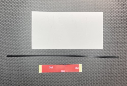

Unique 'RC10 40yr Classic Decal Sheet's
- Body window masks
- Antenna tube and cap (wish it was translucent white like the original)
- 3M double-sided tape
- Commemorative 'post card'.

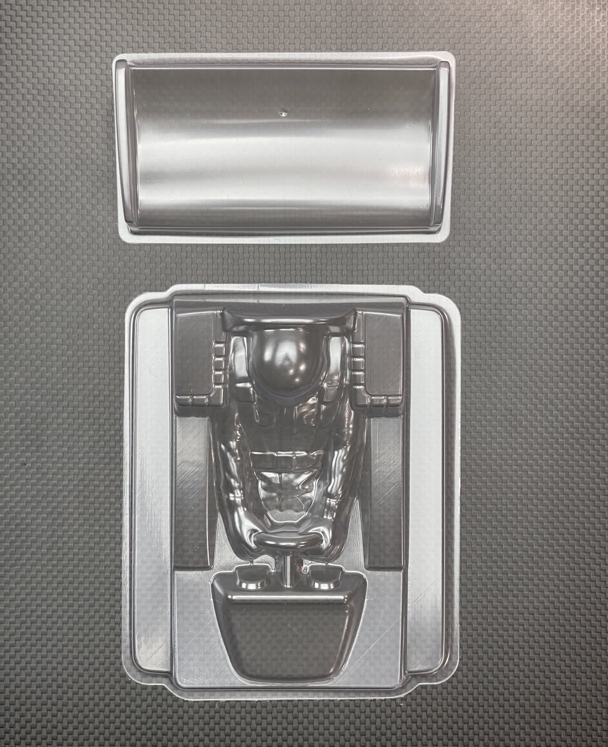

- Rear wing
- Driver figure
Likely the same driver figure from the RC10CC as it has the same visible 'tooling' marks on it.

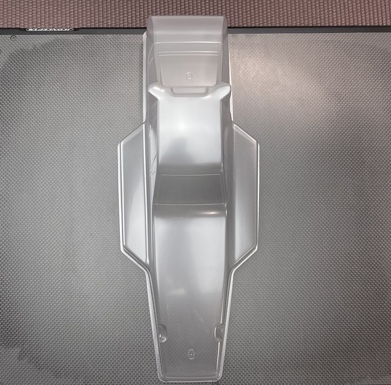

- Body

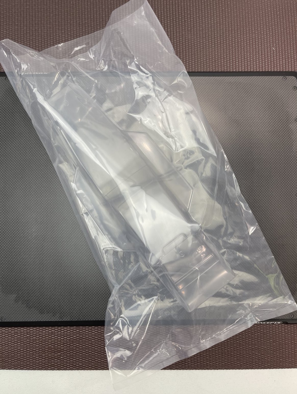

AE did take note of their failure with the RC10CC and polybagged the body. No scratches or damage to this body, hooray!!! :mrgreen:

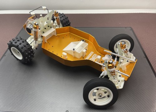

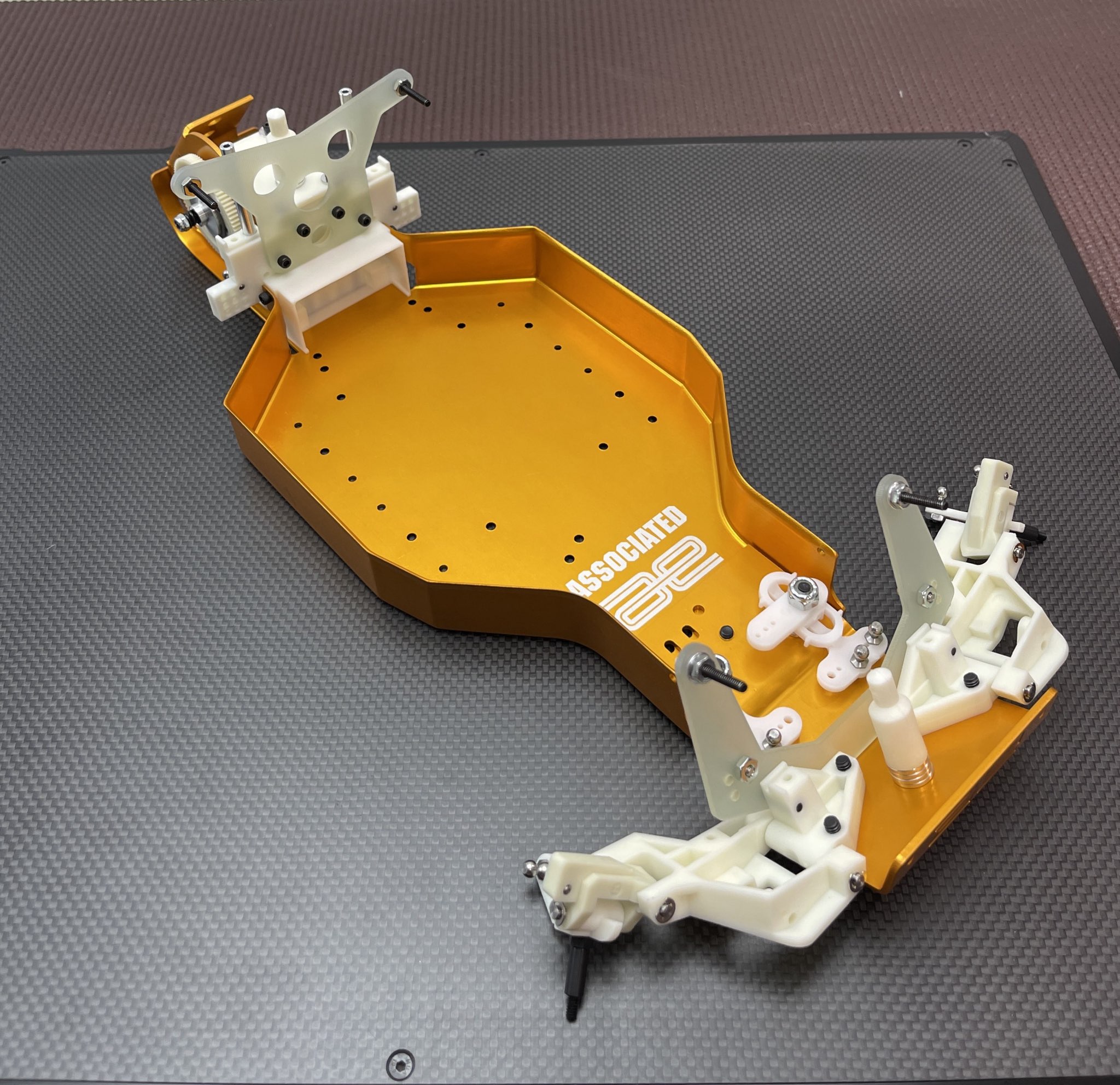

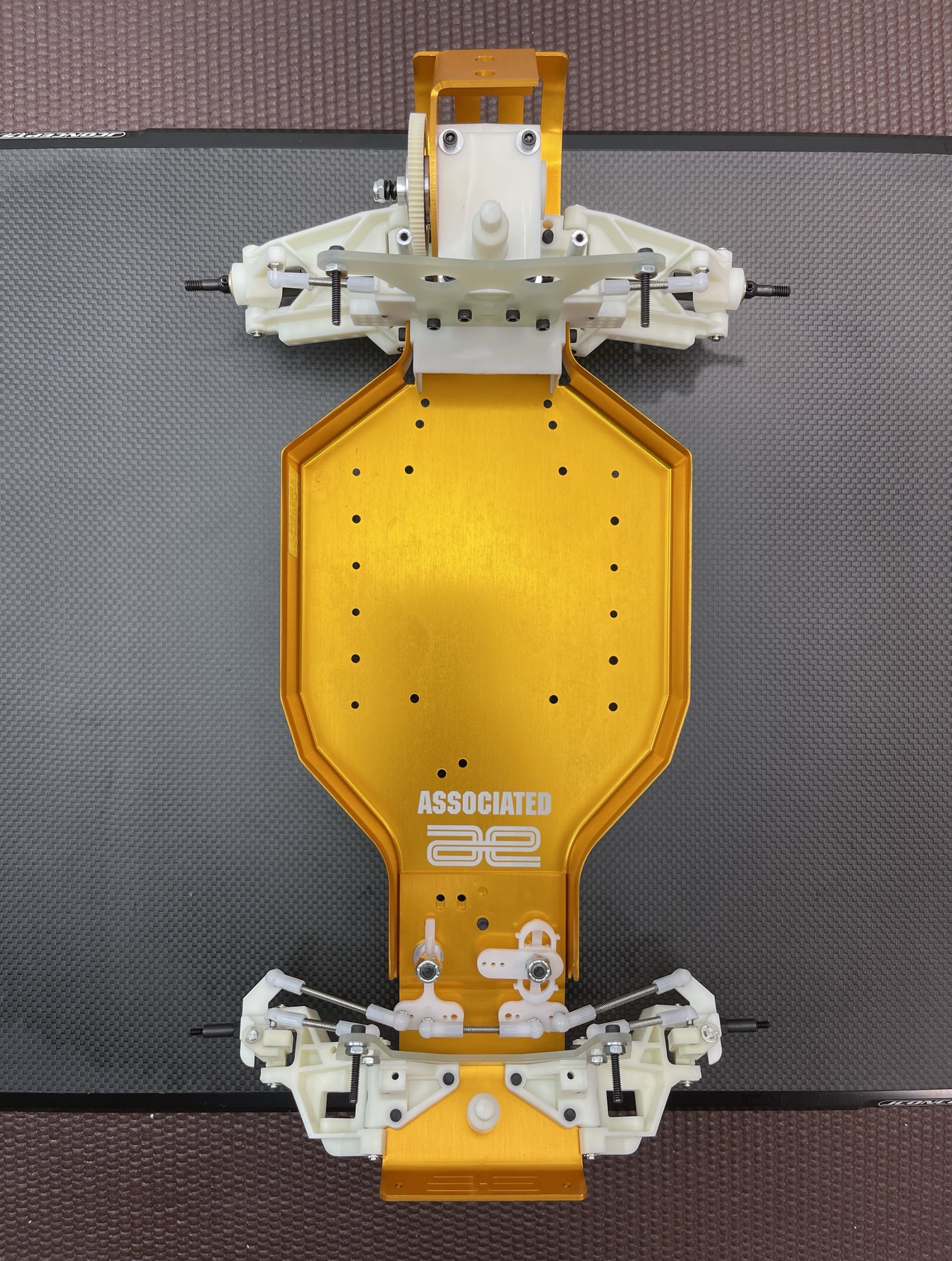

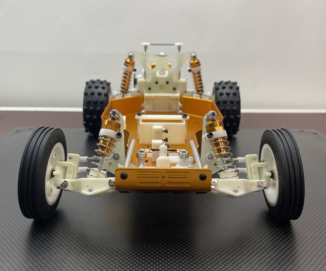

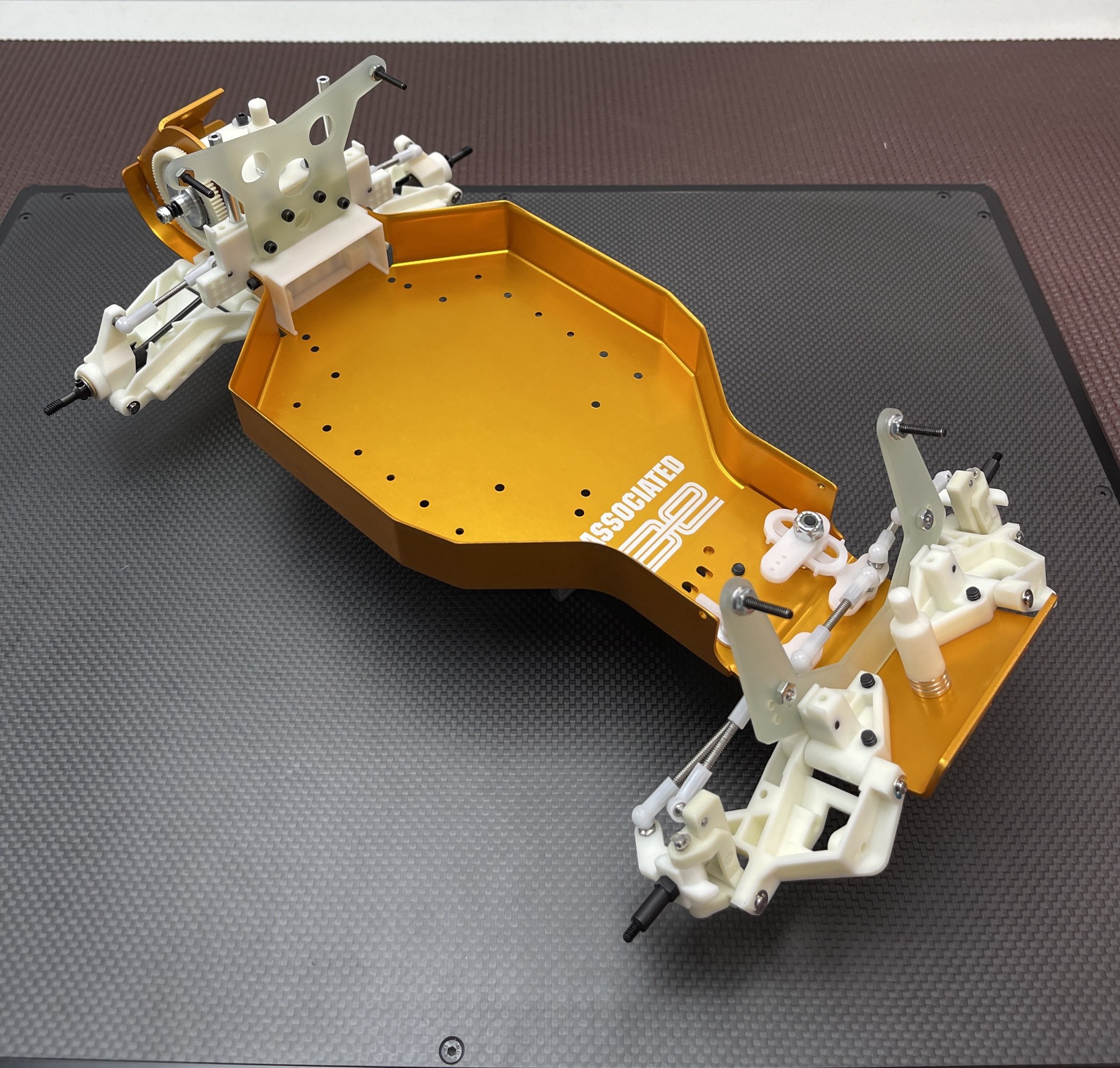

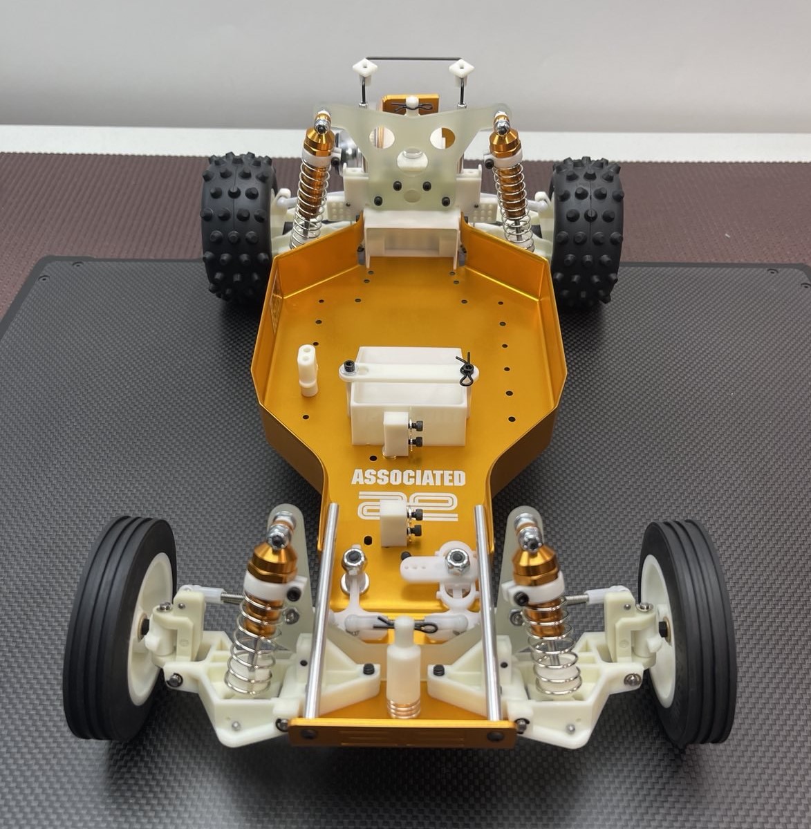

Chassis build complete! 8)
Initial thoughts about the build are extremely positive. Fit and finish on all the parts are exceptional, molding is nice, parts move freely but do not have excessive slop. I'd hazard to say this is the best re-release kit yet, not saying perfect by any means, but the best kit yet :mrgreen:

- Still scratching my head on why the front hub carrier is the ONLY external piece of nylon that is glass filled. It simply looks odd and out of place. If the intent here was to make it 'stronger' for a runner I believe AE has a missed opportunity to sell 'hard' versions of all the suspension pieces. I know many folks (myself included) would purchase them :P
