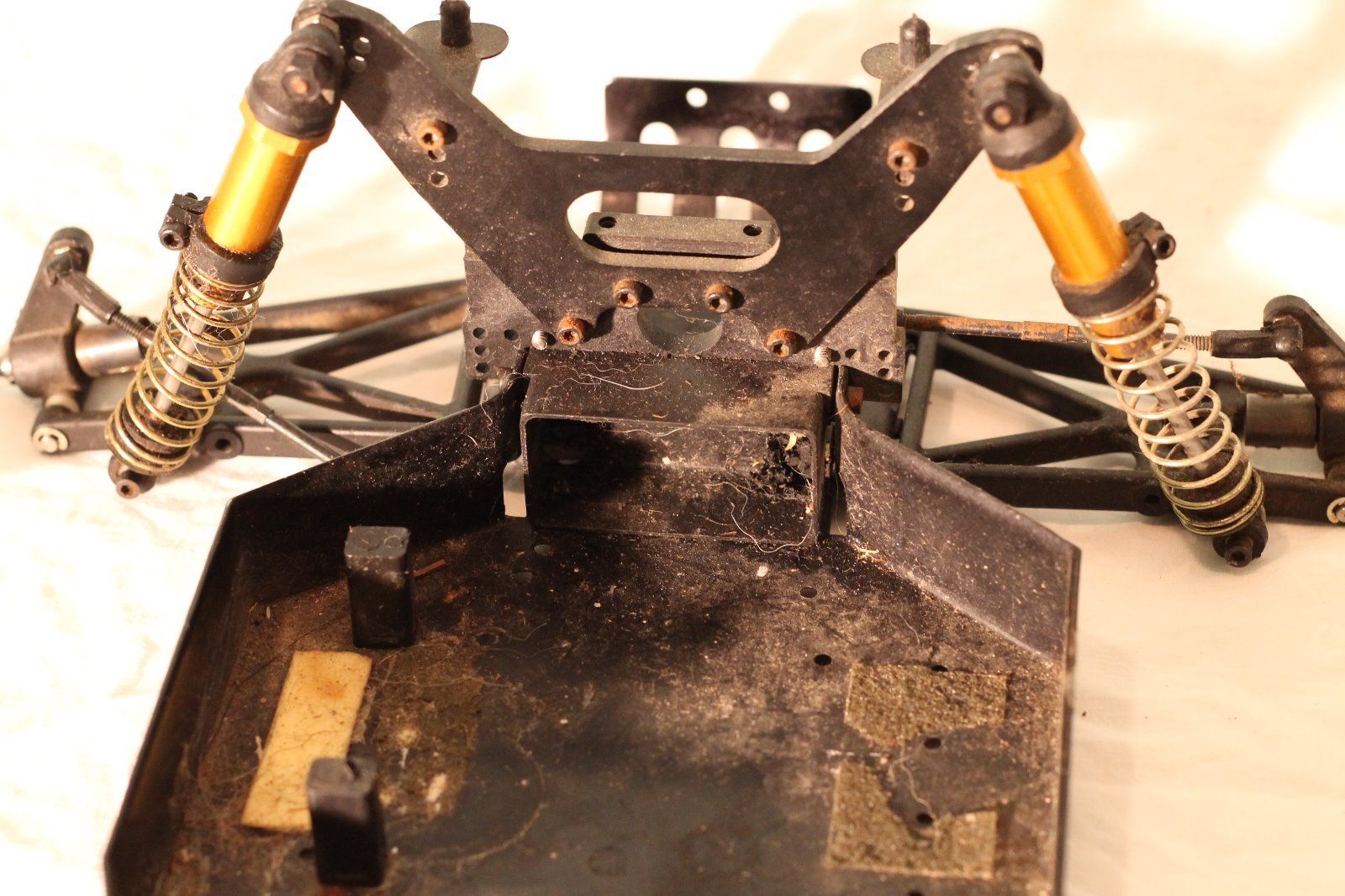

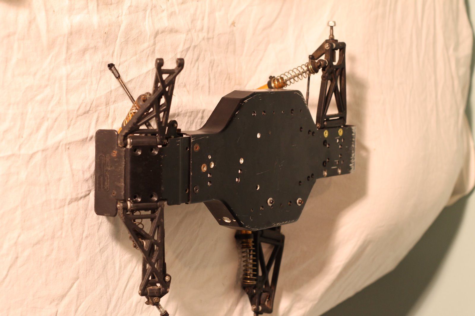

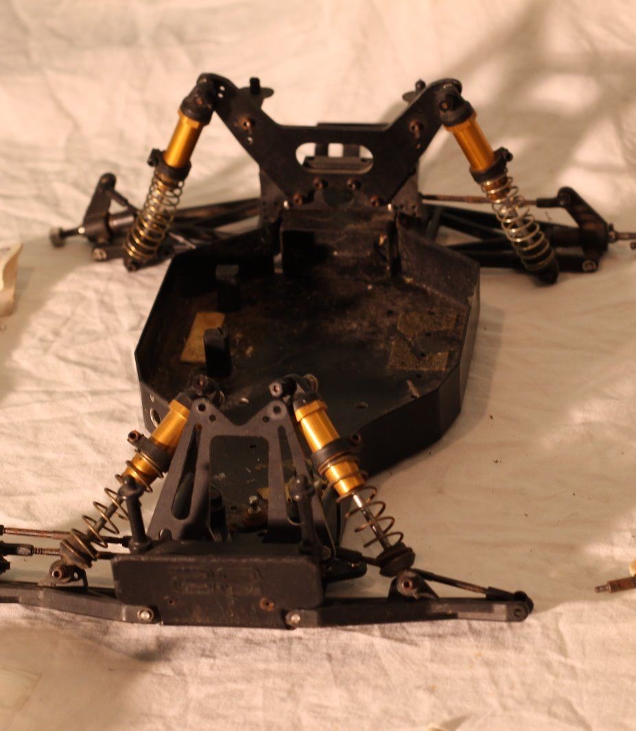

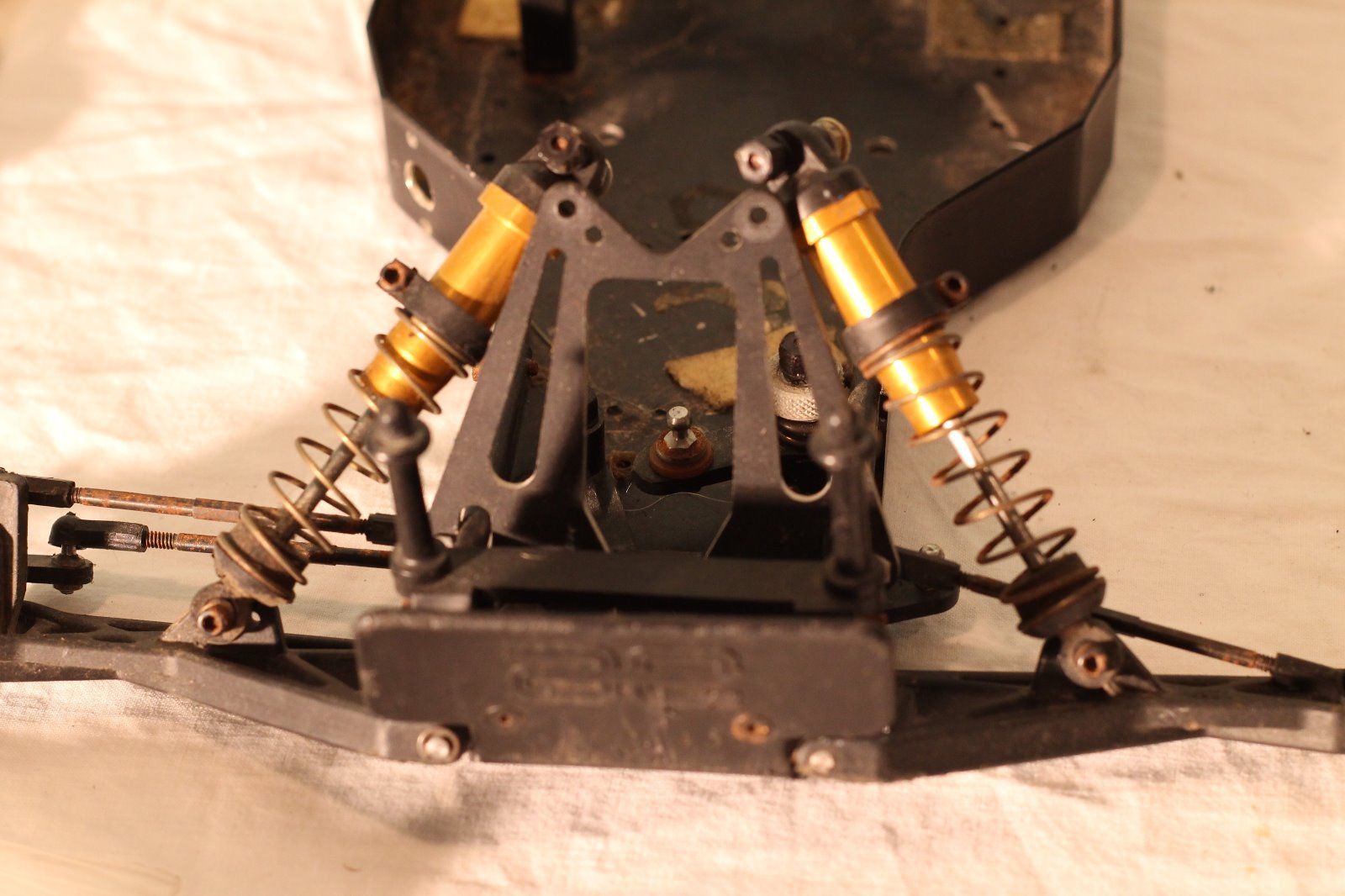

I received this truck many years ago in a parts lot that included a very dirty but very complete RC10 Graphite.
Anyway, I'd like to rebuild this T? close to original and make a nice runner but I'm a bit confused. It appears to have T2 arms but a chassis tub and rear shock tower from the original T.
Is this a junk yard special assembled from various 10T models or was this a thing?
I'm new to RC10 trucks so I know almost nothing about them. Can you help to identify what I have here? What would this have looked like in box art?

Just a late model sport truck. If my memory is correct they were still selling the original truck when the T2 was first released and sold.
Posts: 12362
Has thanked: 1134 times
Been thanked: 3942 times
Re: My first RC10T. But, what is it?
yep, as stated above a late 7011 kit. Bushings and gold shocks, as well as dogbones standard. Three piece wheels. Would have came with a mechanical speed control and motor, a lot of times it would be a DS motor, or a firehawk, whatever was kicking around. I remember one of ours at the hobby shop even had yellow wheels like the T2. The late shock towers were nice, thick and sturdy.

romulus22 wrote: Tue May 07, 2024 4:45 pm Just a late model sport truck. If my memory is correct they were still selling the original truck when the T2 was first released and sold.
GoMachV wrote: Tue May 07, 2024 4:48 pm yep, as stated above a late 7011 kit. Bushings and gold shocks, as well as dogbones standard. Three piece wheels. Would have came with a mechanical speed control and motor, a lot of times it would be a DS motor, or a firehawk, whatever was kicking around. I remember one of ours at the hobby shop even had yellow wheels like the T2. The late shock towers were nice, thick and sturdy.
Thank you! I'm happy that it isn't something that someone cobbled together. Yeah, those shock towers are very thick slabs.

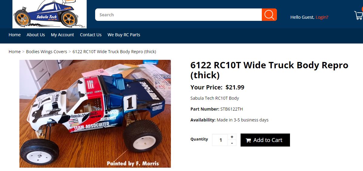

Apparently AE didn't bother to update the box photos (or manual?) to reflect the new suspension parts. Anyway, apart from dog bones and wheels, I believe I have everything to re-assemble this truck - with modern electronics, of course. I also have an original unpainted body shell in the attic somewhere but I'll probably just order a nice re-pop from Sabula Tech. His stuff is very high quality. I'm assuming this model still used the original T body shell - is that correct?

Associated just put a little slip in the box stating parts may have different appearance from manual when they started switching to black parts. Otherwise functionally they were the same and installation was the same.
The correct body for the sport truck would be the wide as mentioned. The team body would also fit as well. Slightly narrower overall and the hood cowl is a little different.
Thanks again!
I bet the team body shell looks awesome but I'd like to keep this truck original so I'll go with the wider sport body shell.

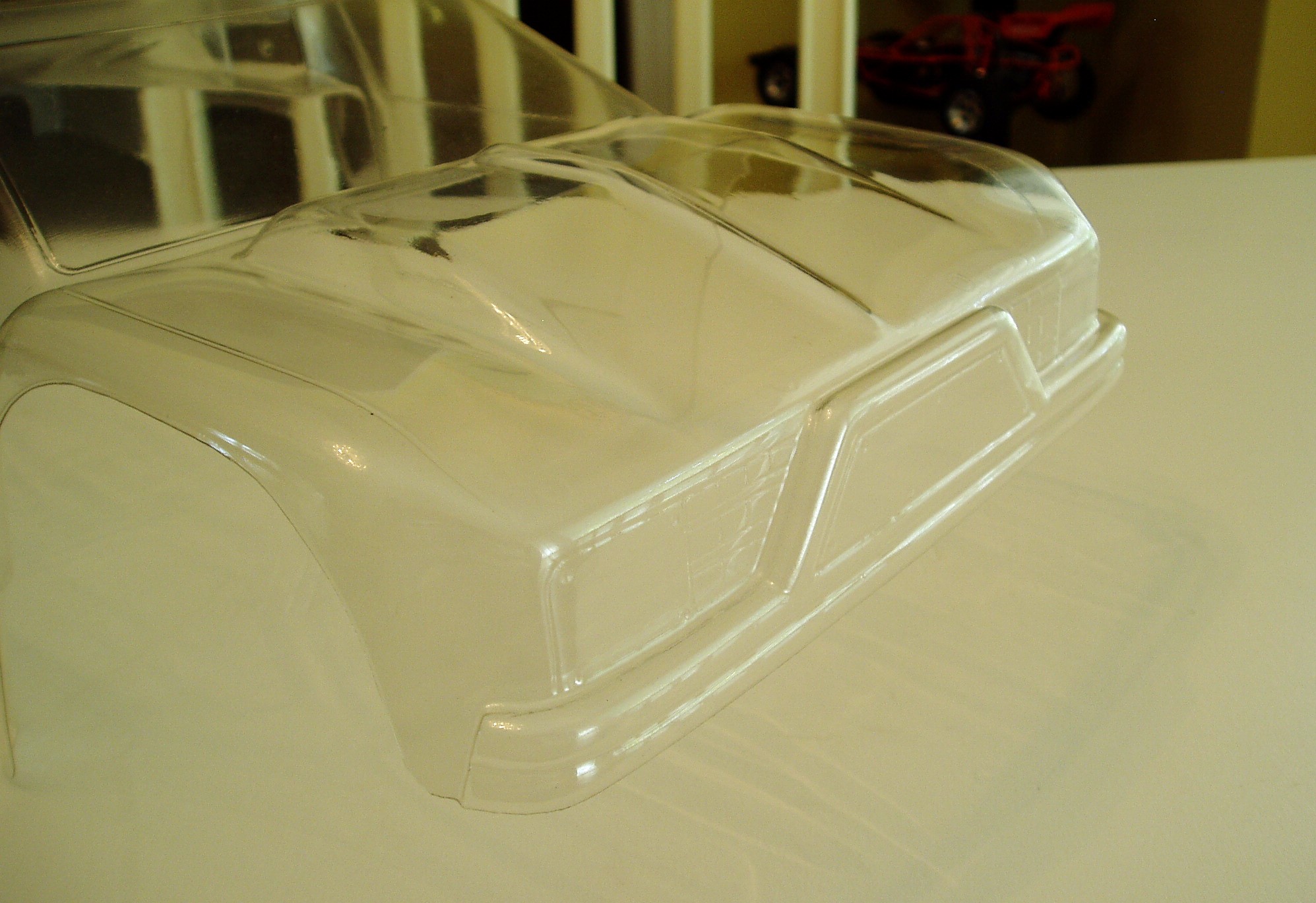

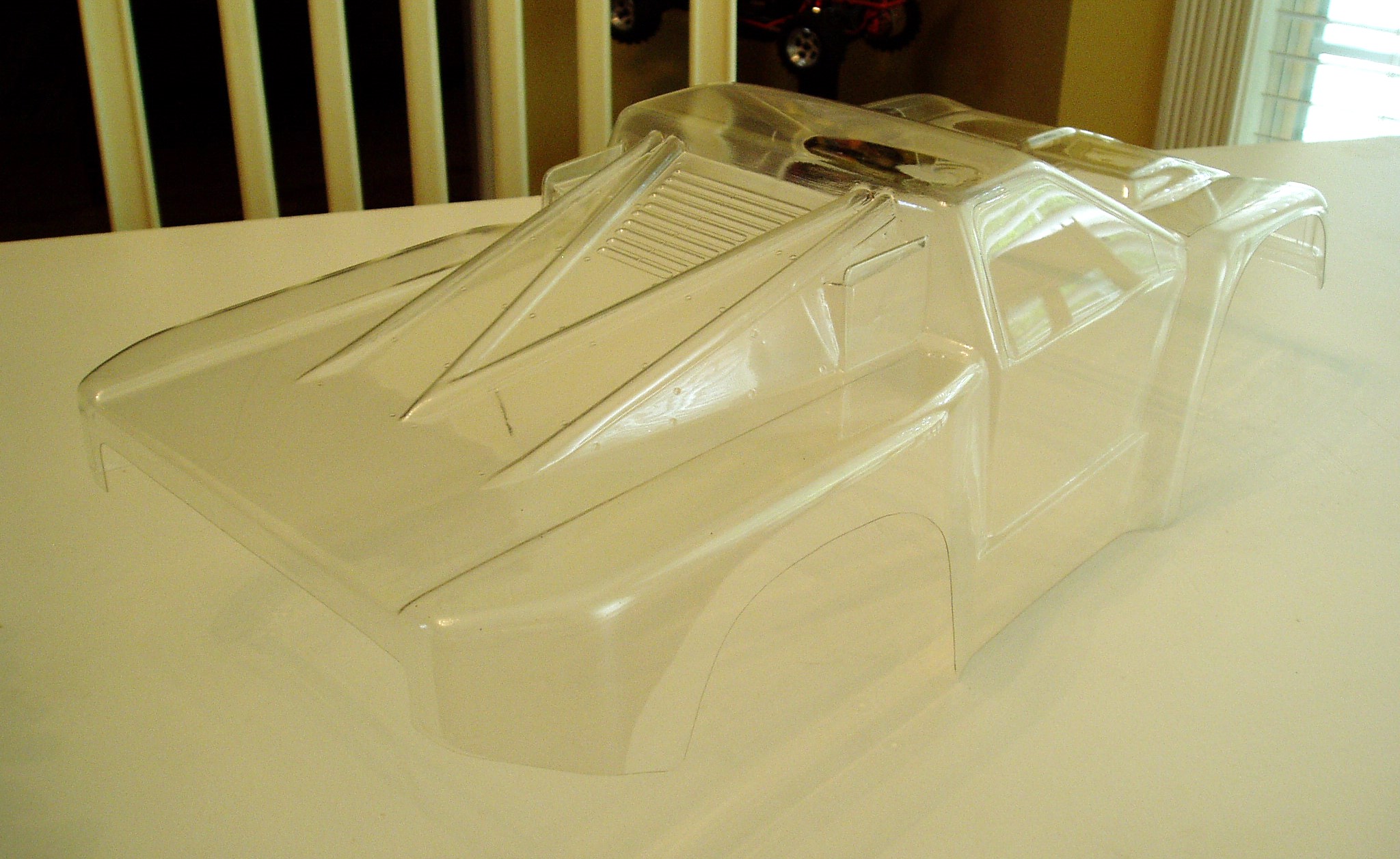

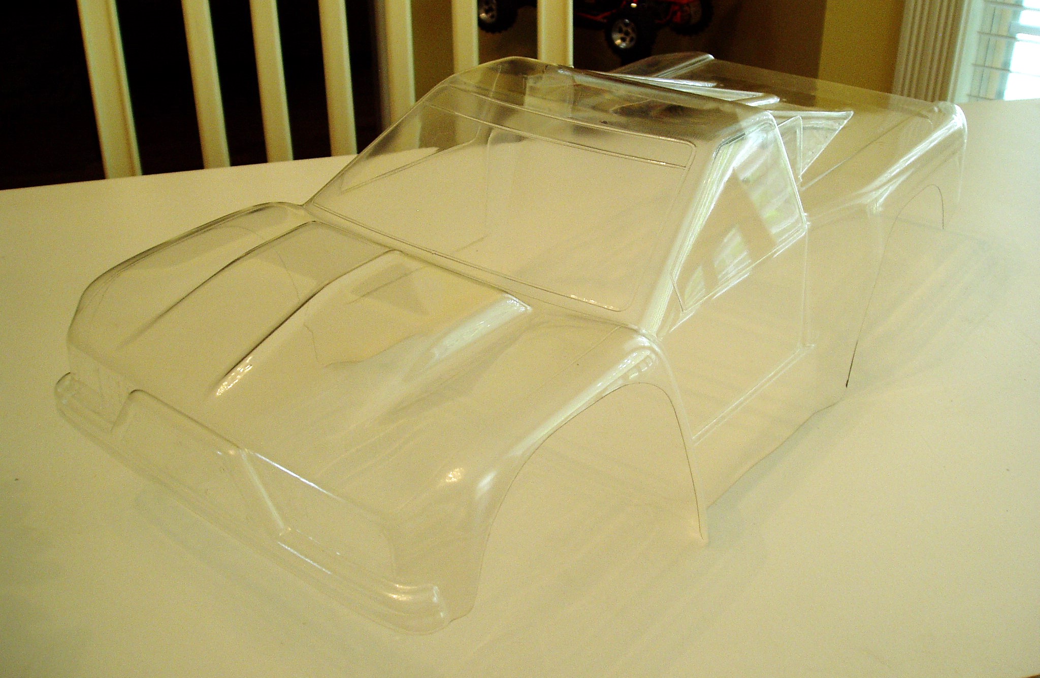

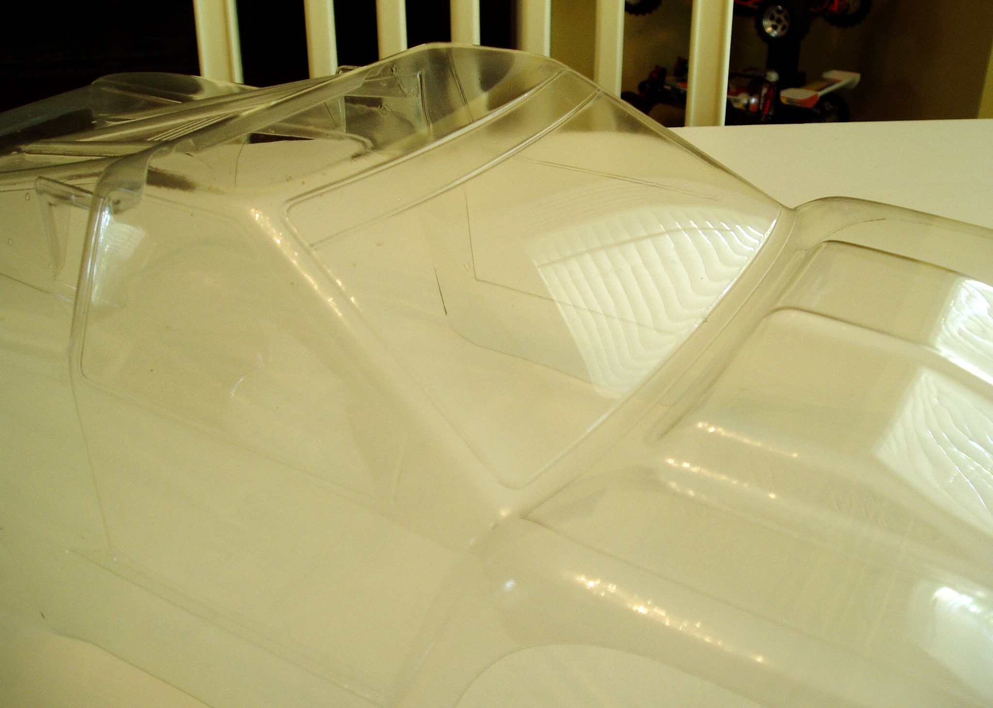

Anyway, here's the body I had tucked away in the attic.
Seeing it now, it clearly :wink: is not an original 10T body; I have no clue who made this.
I bought it bitd but I can't recall why. It's very old (like me :D ) and it never had the overspray wrap so I'm surprised that it's still in good shape.
Anyone recognize this?

No clue who made it but it looks like a modified Losi JRxT body...🤤
