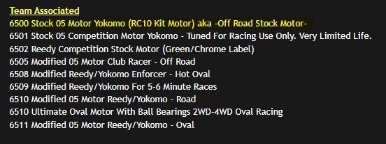

I've also just found the subject motor listed in Lowgear's Ultimate Brushed Motor Guide - he indicates the motor was made by Yokomo:
https://www.rc10talk.com/viewtopic.php?f=78&t=18586
FWIW, the unmarked motor I have is from an early or mid production Edinger kit - one with 7 rib front tires.
