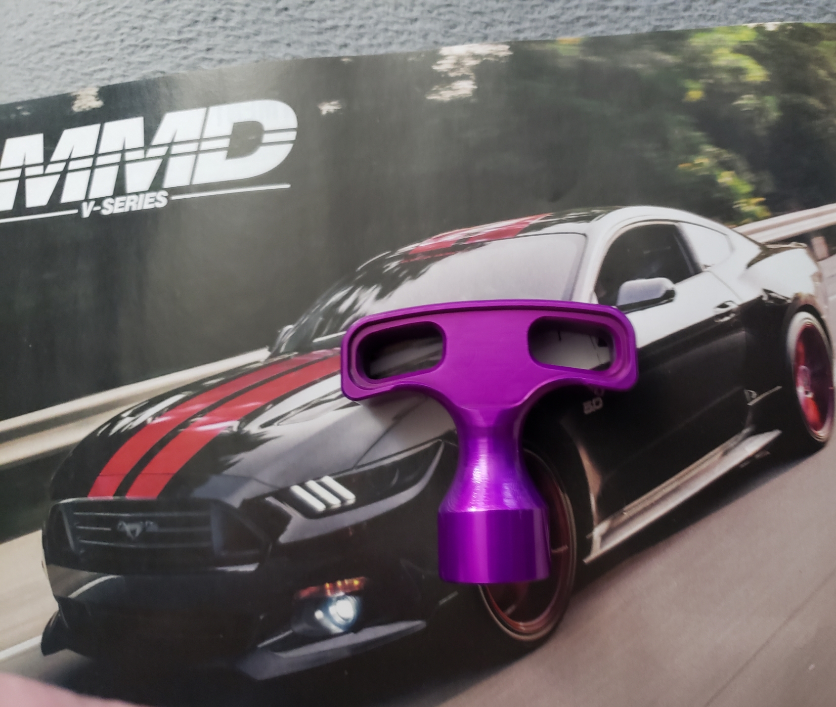

Prep work is key to having the desired finish. If you won't a shiny piece after anodizing then polish it to a mirror finish before anodizing. Also a super fine 000 steel wool is good to help polish as well as a metal compound and never dull will work as long as the anodized surface was done correctly. This piece was polished after I anodized
