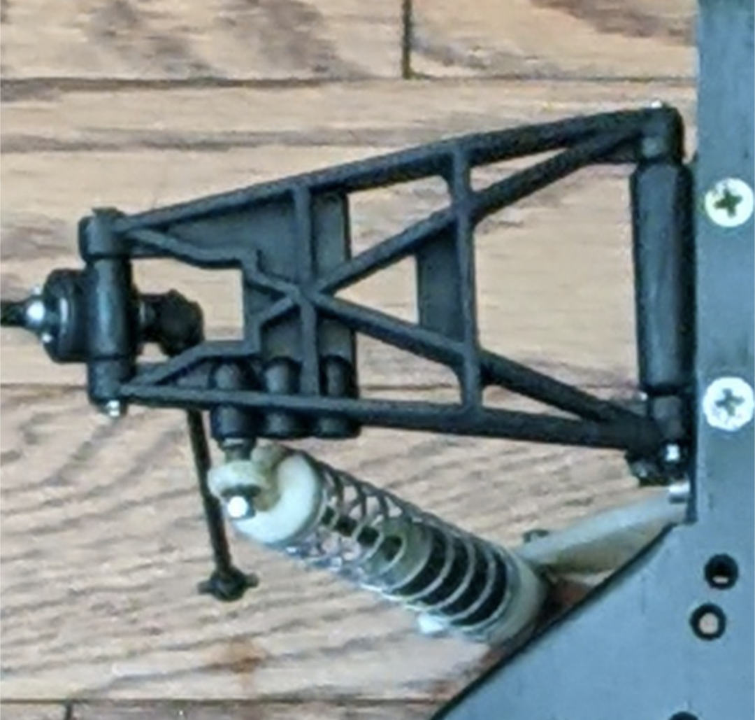

So I'm assembling the rear suspension using SC10 dogbones as placeholders until my order arrives. I noticed the bone collides with the arm severely limiting droop (maybe 2 or 3 degrees angle on the arm). This is with a single o-ring spacer in the axle drive cup.
If the o-ring was moved to the transmission drive cup (positioning the bone deeper in the axle) maybe droop would increase but then up-travel will be reduced because the bone will collide with the ID of the axle cup. Is this normal? I'm tempted to clearance the arm to provide more droop but I really don't think this should be necessary. Any advice?
Posts: 3702
Has thanked: 2535 times
Been thanked: 2856 times
Re: My first RC10T. But, what is it?
FYI those aren't RC10T rear arms. They're one of the later trucks. These are T1.
Posts: 12242
Has thanked: 1101 times
Been thanked: 3783 times
Really common issue bitd. They should have just relieved both sizes of the arms

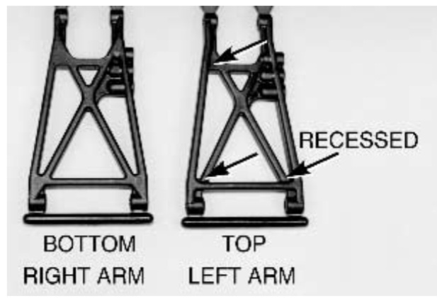

XLR8 wrote: Anyway, unlike early T's, these arms will fit either side and there isn't the recess (or notch) that provides additional clearance for the bone. Probably because both top and bottom would require the recess (to make the arm fit either side) and maybe the arm is too thin to accommodate both recesses.
I hope that makes sense.
You did understand the pic I showed right? The arms are most definitely left and right specific. They just didn't mark them since the gt would have been opposite. They look symmetrical but are not.
XLR8
Posts: 3309
Has thanked: 1663 times
Been thanked: 1171 times
Post by XLR8 »
GoMachV wrote: Sat May 18, 2024 2:01 am
After reading your previous post, I went back and had a closer look. My truck has two left arms. :(
I could try to find a right arm but I can't be bothered. I'll just make a shallow notch so both sides have the same droop.
This truck will never be a pristine, time capsule museum piece anyway. It's had a rough life.
Thanks again, Jeff.

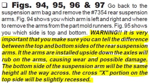

I've just downloaded the RC10T2 manual and found this note on page 25:
This note doesn't appear in the original T manual that would have been included with this truck.
Unlike the T2 arms included with this truck, the original T rear arms were very different and it's easy to identify left vs. right.
I wonder how many of these late T kits were assembled incorrectly and handled poorly due to virtually no droop in the rear suspension.
This could have been avoided if AE had designed the T2 arm symmetrical about the mold's parting line. It would have reduced their tooling cost as well since both arms could be made from a single mold cavity.

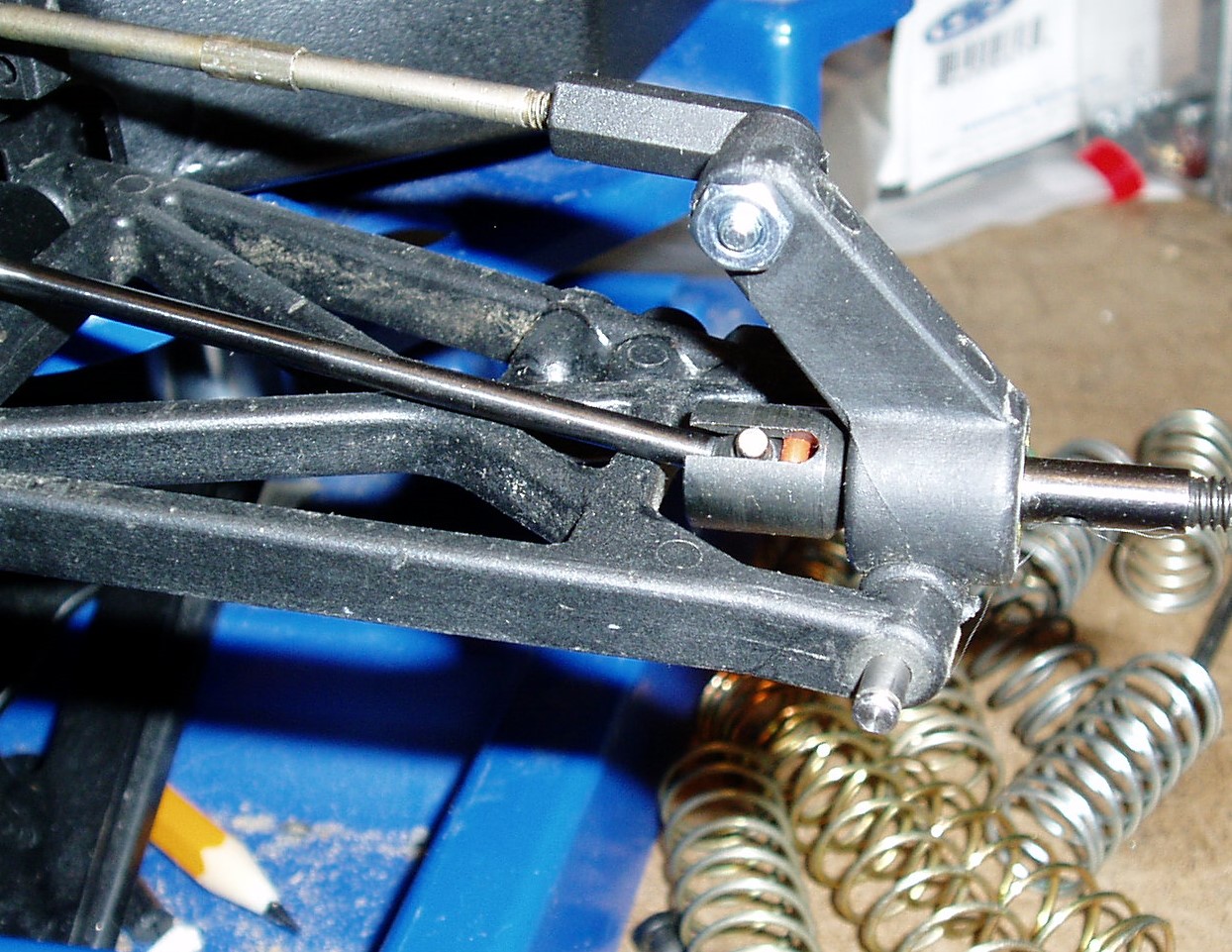

I have the front suspension assembled per the manual and I'm seeing some bump-steer - did not expect that. It's not extreme but it's there.
This is my first T build. Maybe there's an old racer's trick to shim the ballstuds or steering rack to reduce or remove it? ...or do we live with it?
Posts: 12242
Shouldn't see much, but different caster blocks do vary the amount or need for washers under the ball studs. As a rule of thumb, try to get the steering rods parallel with the suspension arms and you should see little to no bump steer
