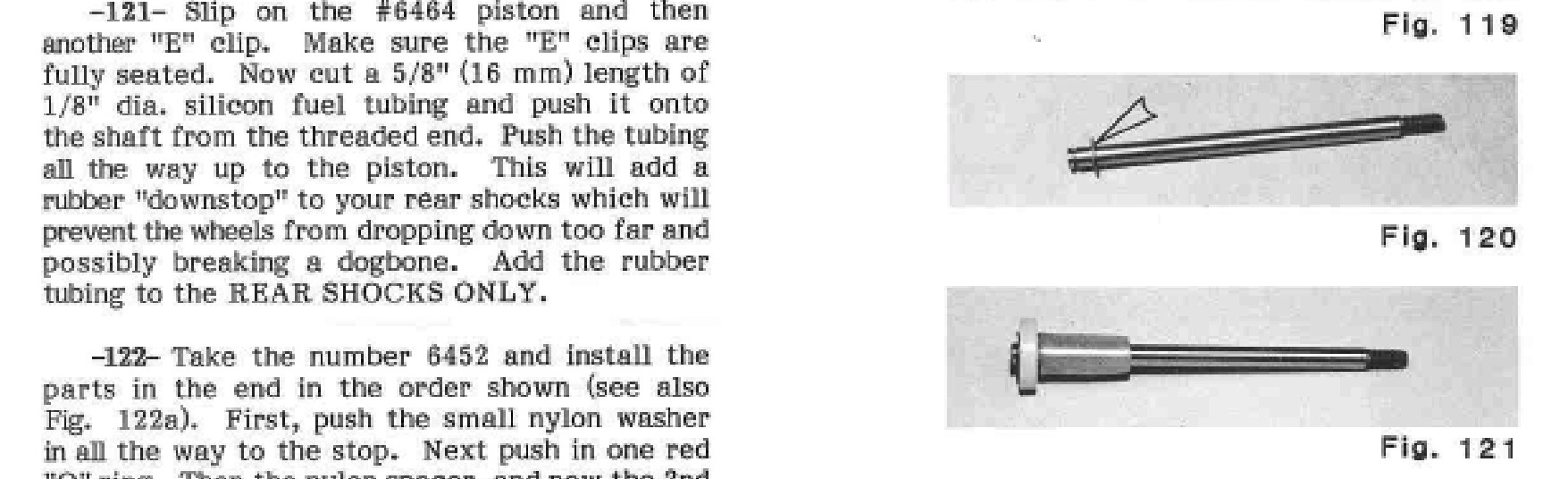

Willing to bet he didn't have enough internal limiters in the rear shocks. In the original manual they tell you to put 5/8" of fuel tubing on the shock shaft to limit down travel. Without this the axles can rub like what you see on yours.

RogueIV wrote: Thu May 23, 2024 12:12 am Willing to bet he didn't have enough internal limiters in the rear shocks. In the original manual they tell you to put 5/8" of fuel tubing on the shock shaft to limit down travel. Without this the axles can rub like what you see on yours.
I've never read the manual for the early RC10, I do have it in PDF, just didn't know that was in there. It's a great idea, and seeing as I'm going to be rebuilding a lot of shocks in the near future, I want to do this to all of them. Much thanks for letting me know this is how it was done!
