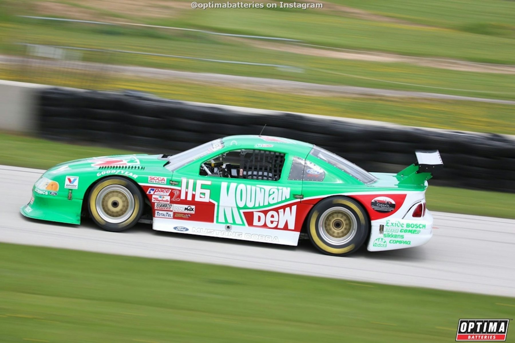

Brendan2904 wrote: Fri Aug 16, 2024 10:45 am Ok so is the body that comes with the kit a Trans Am like AE says on their site or is it a Ford Mustang like the Fakebook Mafia swears it is?
Yes.
It's AE's rendition of the Mustang Tommy Kendall drove in the SCCA Trans Am series.
Thus, it is a Trans Am Mustang. :wink:

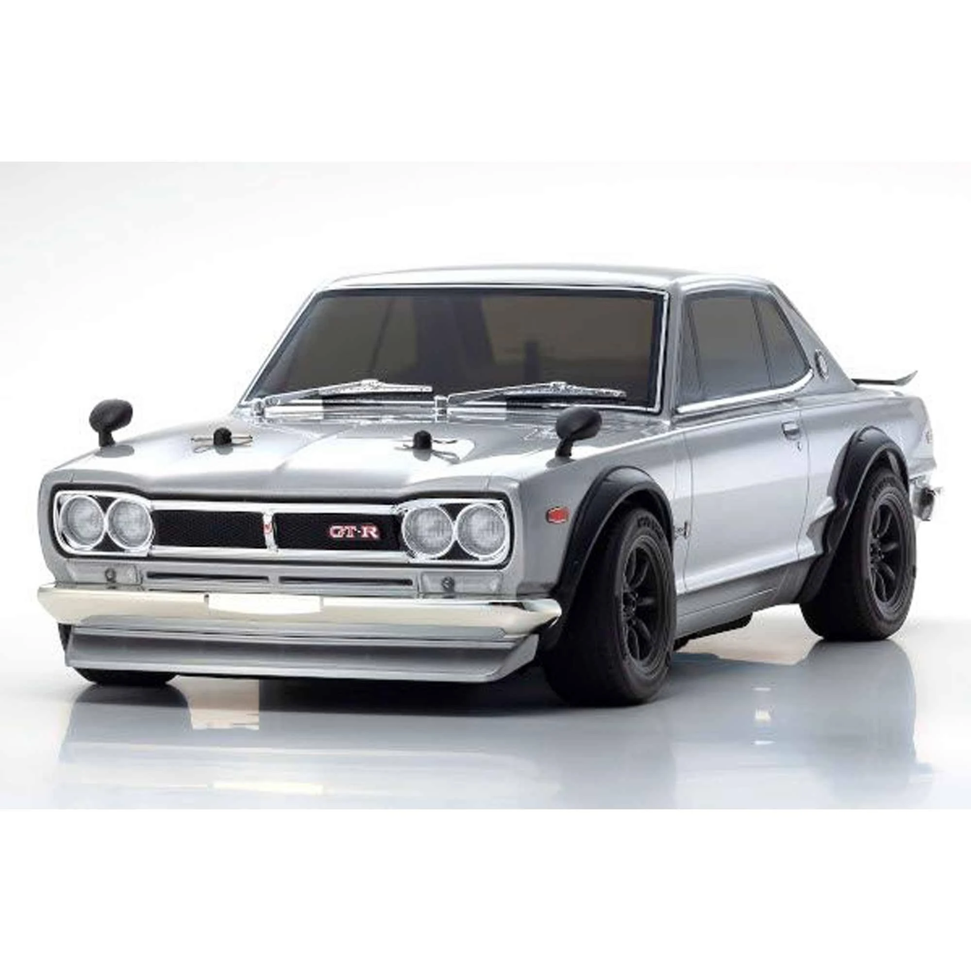

I actually Picked up this Pontiac HPI body last night with my DS as there was one on the body rack at my LHS. Your build showing how nice this body is really set it up for me.
I did briefly consider going with the Kyosho Skyline 2000 GTR but was unsure of fitment and it was twice the price. Maybe later, you can never have too many bodies!
XLR8 wrote: Fri Aug 16, 2024 11:28 am
Yes.
So to reiterate, Trans Am is the racing series the car ran in not the name of the car. There's a bit of weirdness with the naming in RC world to get around licensing. I still think it's funny that the 2nd car on the Box Art was changed to the Mustang body as well when it was originally a Mercedes. Also note that there's no Ford logos in the sticker sheets and All Sport was replaced with Dual Sport. All for the sake of not being sued, I'm sure.

morrisey0 wrote: Fri Aug 16, 2024 12:16 pm
XLR8 wrote: Fri Aug 16, 2024 11:28 am Yes.
The Jon Gooding version is better looking IMO. I think I am going to just go with the stock body and try to pay tribute to it (minus the big wing).
This is the scheme I'm planning on for that body. Although I might give it a twist and switch it to Baja Blast colors.
