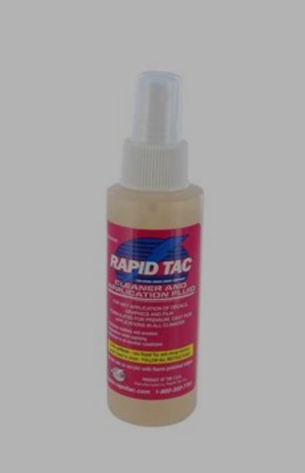

GreenBar0n wrote: Fri Aug 16, 2024 9:45 pm The decal squeegee was delayed in delivery, won't be here until tomorrow now. Hoping to finish Sunday.
Some guys swear by the soapy water technique with decals. Kinda gives you some time to float them around and get the placement right, then squeegee them down/run the air and liquid out from underneath. I've totally done it on 1:1 cars, storefront windows, etc. I personally haven't done it on any lexan bodies, but it's worth a look. I think there is even a product...something like "application fluid". Essentially it's just a calculated mixture in a little spray bottle that is equivalent in function to the "soapy water". One thing I did notice when I was "doing vinyl" is sometimes squeegee passes on non-protected surfaces (i.e. no transfer tape on the topside of the decal) can lead to slight streaking/"scratches" that can be seen in the right light. But, the wet application method does provide some lubricity that helps to minimize this. I always took the carburetor rebuild mindset of "cleanliness is next to Godliness" with the decal applications.
Something like this
And I'm sure there are some soapy water YouTubes on the topic.
But, go with your gut, you have a plan and all that crap I just typed might just be noise. Last person I'm trying to be is the "good idea fairy".
Good luck, I've been enjoying your thread!

Personally, I like the Windex and hair dryer method. It works really good for weird angles and body lines.
I use a small (breath spray size) pump sprayer that I got somewhere.

TRX-1-3 wrote: Sat Aug 17, 2024 8:09 am
Something like this
Thanks so much! I have been using Dawn and water, but without the squeegee, and there are too many bubbles left behind. The squeegee is necessary for the large window and hood decals, it has a felt strip on it to prevent the scratching, that's why I'm waiting for it, but doing this without soap and water would be too hard.
