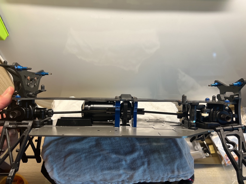

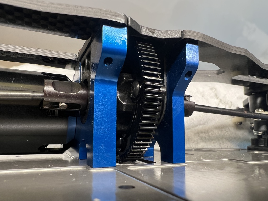

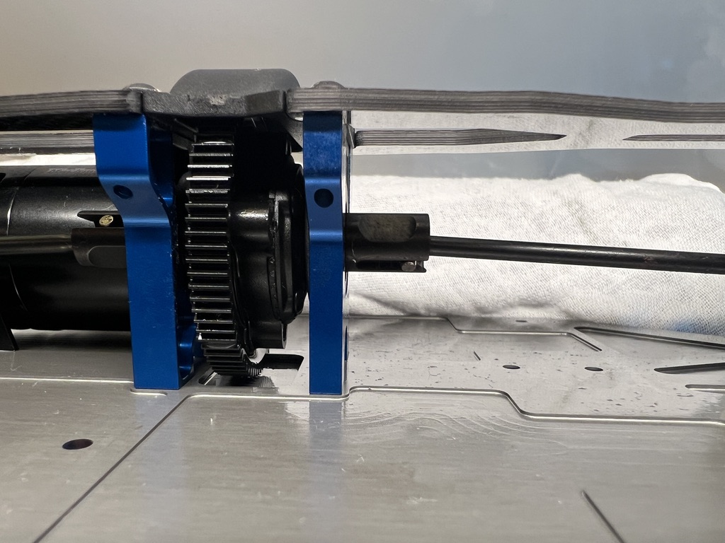

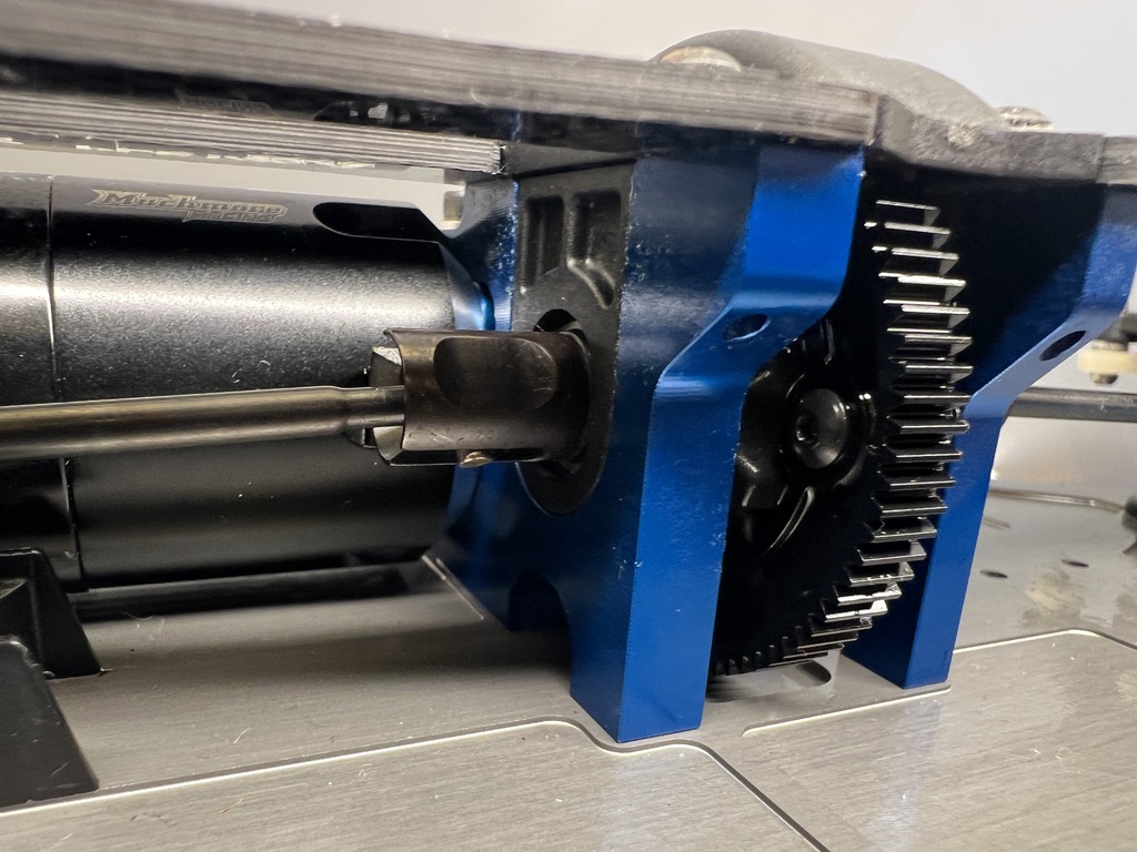

1) The diff shows leaking. I thought the viscosity of a center diff would be very thick...was leaking a common issue on the buggy? Never worked on such a diff, and thought leaking was not common.
2) The front weels and the rear wheels (diff outdrives as shown) turn the opposite direction when turning the center shaft! How does this happen lol? Again, front wheels turn forward, while rear wheels go reverse when I turn the center spur gear/shaft in the middle. What did the previous builder do wrong?

They flipped one of the diffs, not sure if front or rear but if you turn the spur the correct direction figure out which end is spinning backwards and slip the diff over. Better yet, grab the manual and start from step 1 and see what else they messed up. :wink:

Thank you very helpful! Some room for error between the saddle pack and the short pack configuration I see. I will have to do a full tear down. The diffs seem to have some leaking visible. I think the previous owner cranked down on the screws. I have never built fluid gear diffs so hoping I build them to be leak free in the future.
