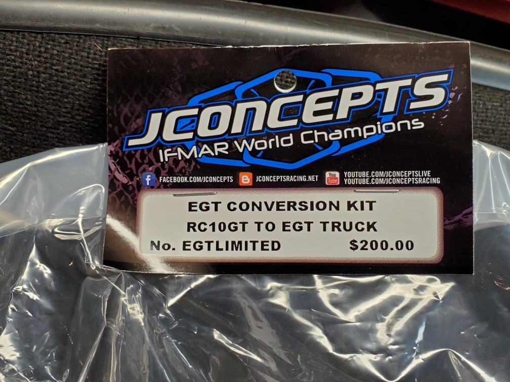

mikea96 wrote: Tue Dec 31, 2024 10:35 pm Now that looks good with the gold chassis and it says full bearing throughout. Maybe jconcepts will do another run of there EGT conversion kit.
What is the EGT conversion?

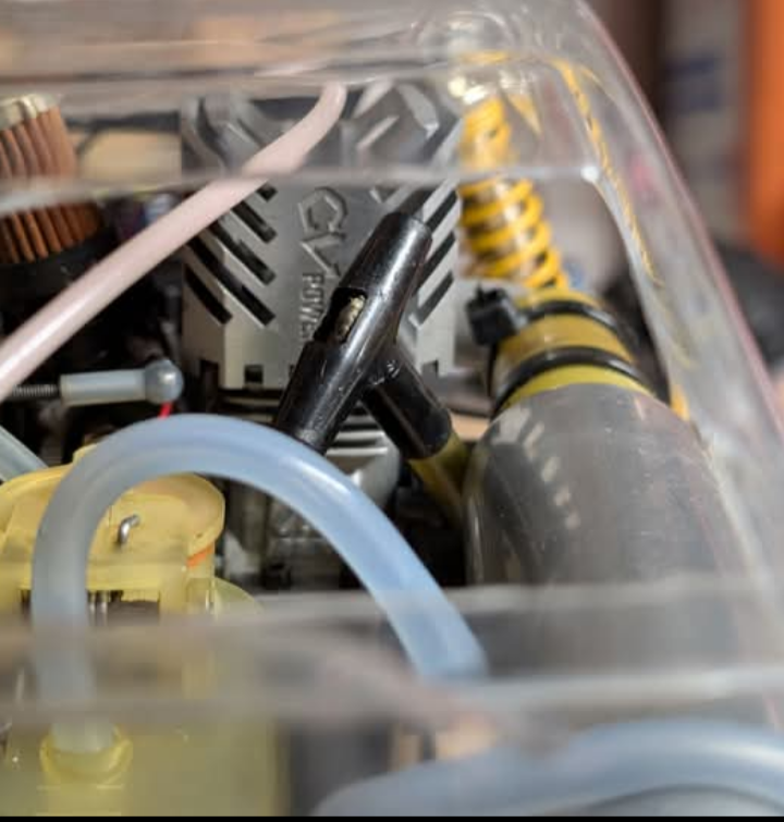

Is there anyway to run a pull start on these? When Googling engines for these I see some of the older trucks that ran a pull start, looked like the exhaust manifold kicked out further to allow room for the pull start.
And if no pull start, what are the starting options for these?

Dangeruss wrote: Thu Jan 02, 2025 1:19 am
Garage Hack wrote: Thu Jan 02, 2025 1:04 am What is the EGT conversion?
https://blog.jconcepts.net/2019/07/inside-look-jconcepts-rc10-egt-racing-truck/
The prototype is better because I built and raced it. :P :wink:
I believe only 30 kits were made and sold. I still have to build mine.
https://www.rc10talk.com/viewtopic.php?t=43125
https://blog.jconcepts.net/2018/12/inside-look-rc10egt-pro-build/

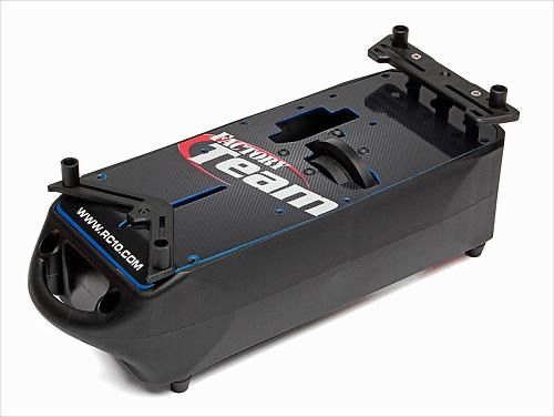

mark wrote: Thu Jan 02, 2025 8:45 am Is there anyway to run a pull start on these? When Googling engines for these I see some of the older trucks that ran a pull start, looked like the exhaust manifold kicked out further to allow room for the pull start.
To run a PS it requires a different manifold, taller engine mounts (engine side mounts), and not necessary but the nonPS models came with a taller flywheel as well, so you could bumpstart if wanted/needed.

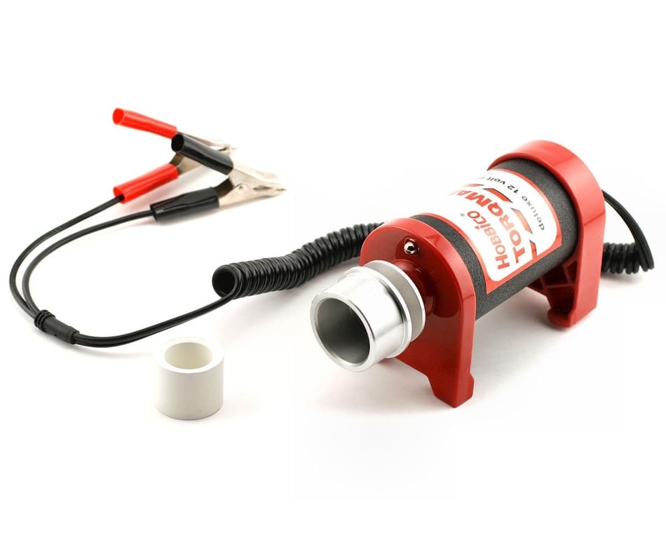

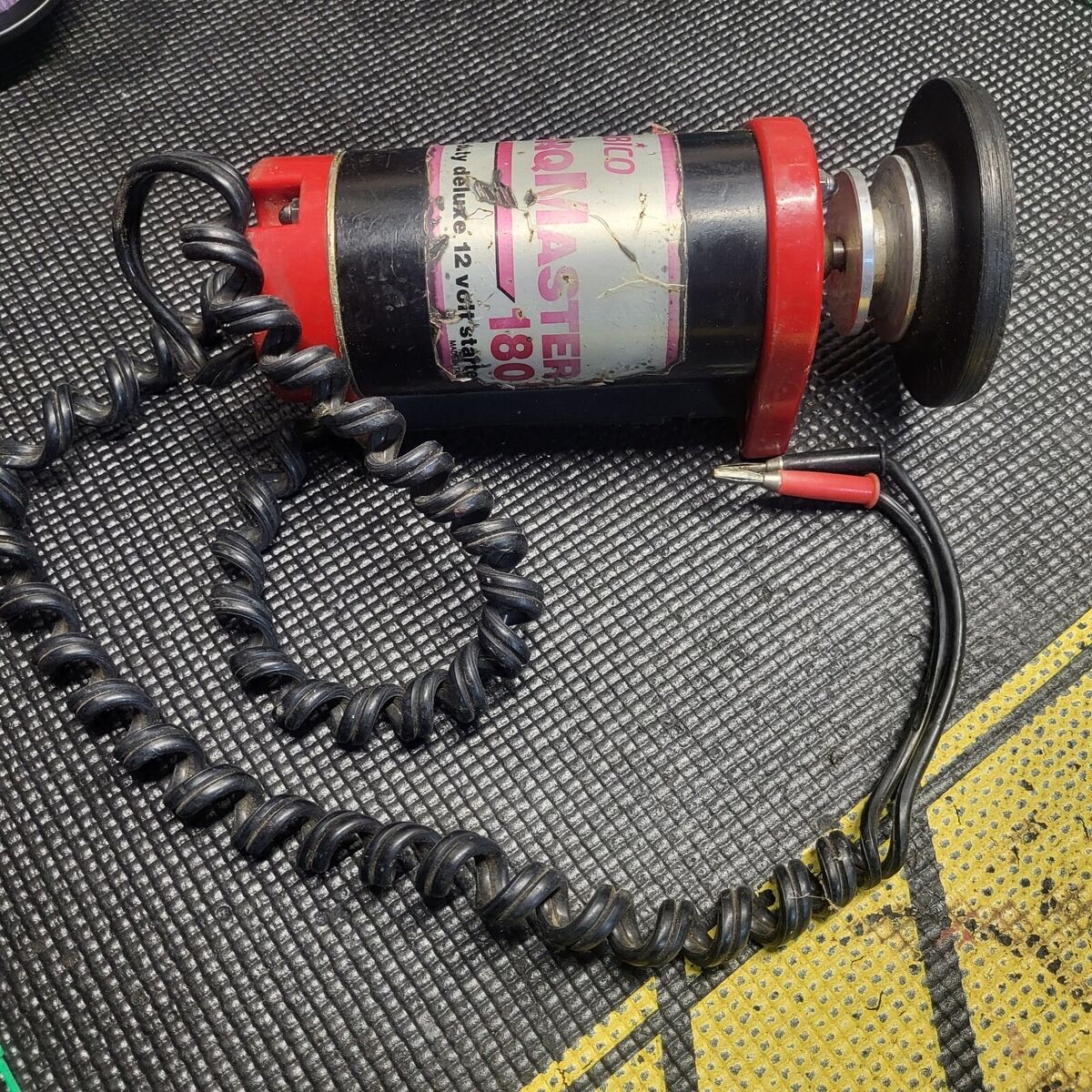

To bumpstart the engine you could get a universal bump box and set it up. Or they made boxes designed for stadium truck engine layout. Or go cheap and get an airplane nose cone starter with the rubber wheel added.
