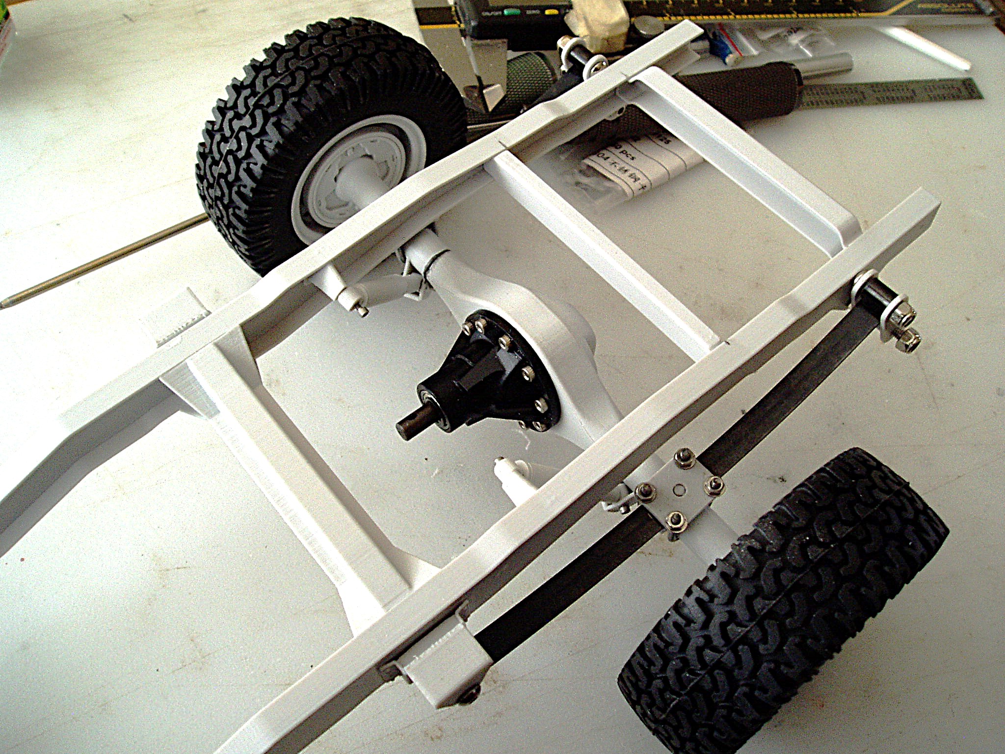

I've been using Tamiya Extra Thin Cement on my PLA prints and so far, it's working pretty well. TETC is an acetone and MEK blend.
The rear axle was printed in three sections (left, right, middle) and the fit was very loose so I used JB Weld to fill the gap per Dadio's suggestion. The bond went well but after it was set, I noticed the left and right ends weren't clocked correctly (misaligned).
I could reprint the parts and reassemble but I was able to salvage the assembly by adjusting the angle of one of the leaf spring pads.
Anyway, every project is a learning experience.
