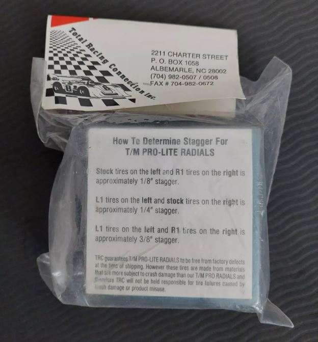

S was Stock or Standard according to TRC.

This is information I got off another place but nobody has the answers like we do, so figured I'd ask. :mrgreen: I might have to buy one of each to see what the difference is if I can't find out for sure. Although 2 years ago I bought the narrow green tire for the left rear which is marked L as I just checked it, so I should probably go with the L and R ones to match.

Updated my previous post to correct myself. :mrgreen:

jcwrks wrote: Sun Feb 02, 2025 8:37 pm S was Stock or Standard according to TRC.
Very interesting, thanks for the updated info/pic! It's even a little more complicated than I anticipated.
