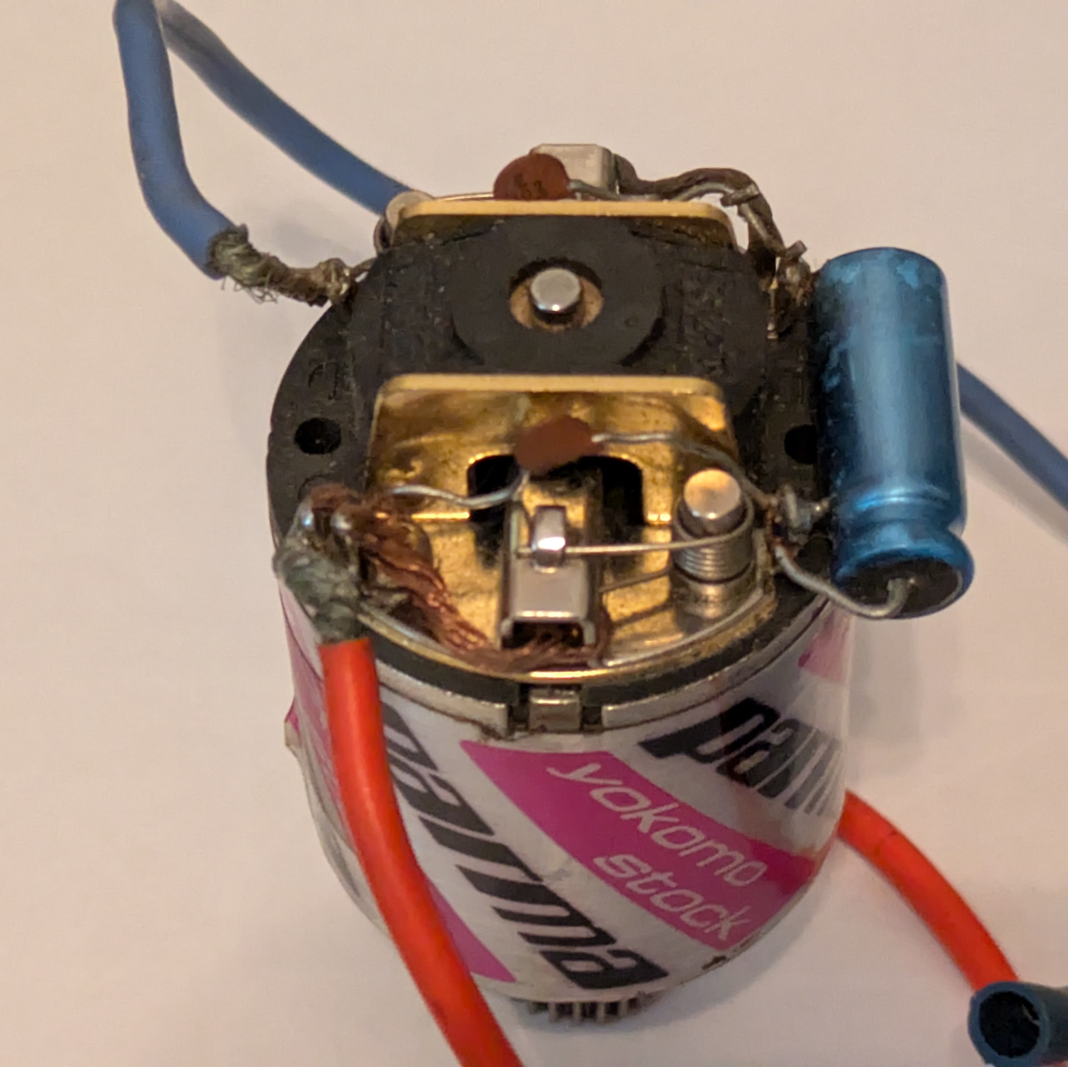

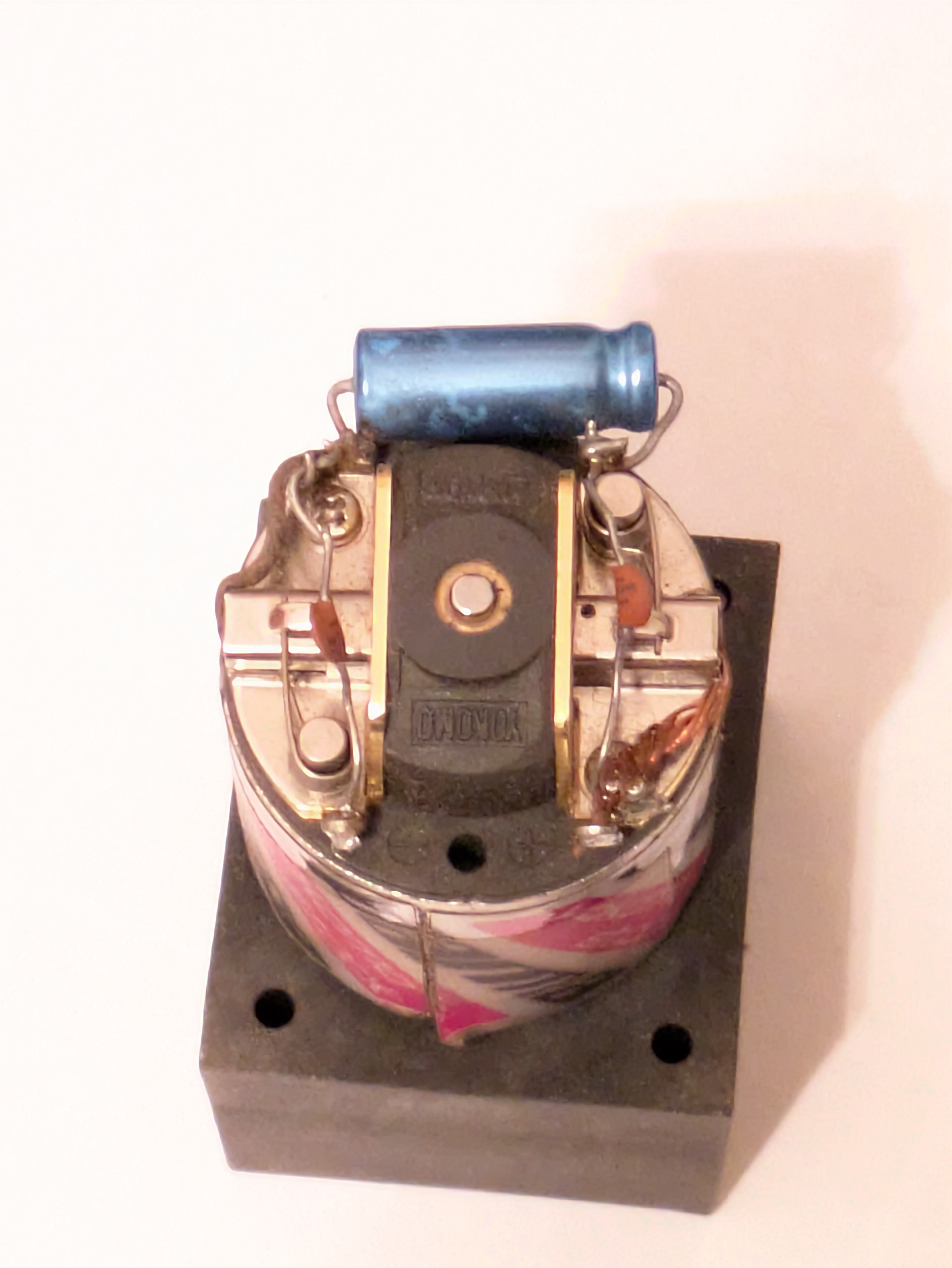

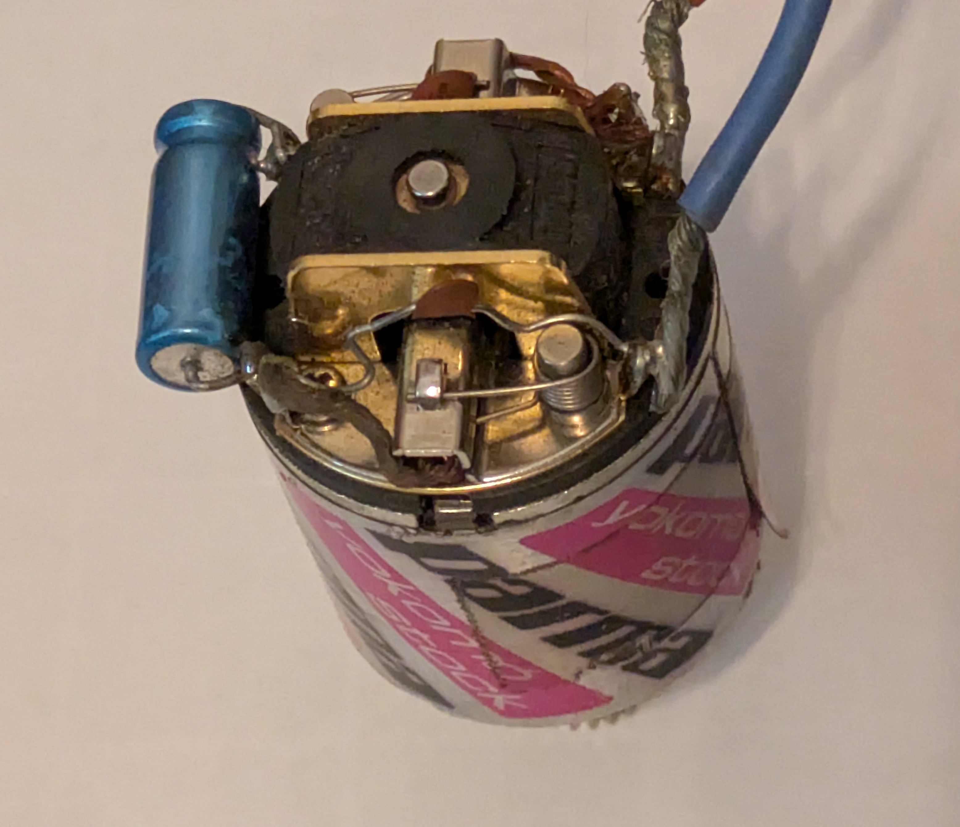

This seemed like a good topic to bump up with a new post. I've never seen disc capacitors soldered across the + + and the - - terminals before. I don't see how that would do anything, unless a change builds up there.

Those ceramic caps are doing nothing, Possible the solderer misunderstood the directions.Frankentruck wrote: ↑Mon Feb 10, 2025 5:42 pm This seemed like a good topic to bump up with a new post. I've never seen disc capacitors soldered across the + + and the - - terminals before. I don't see how that would do anything, unless a change builds up there.

But this is weird.

That was my thoughts too, but wanted to see if I was missing something.RogueIV wrote: ↑Mon Feb 10, 2025 7:47 pmThose ceramic caps are doing nothing, Possible the solderer misunderstood the directions.Frankentruck wrote: ↑Mon Feb 10, 2025 5:42 pm This seemed like a good topic to bump up with a new post. I've never seen disc capacitors soldered across the + + and the - - terminals before. I don't see how that would do anything, unless a change builds up there.

Yeah they are doing nothing.
They should be from each brush hood to the motor can or motor tab(if a modified).
Electrolytic is also fine but a ceramic cap would be sufficient. If you haven't sat there and cooked the cap it should be fine, they are pretty tough. I've discolored the end of the potting a time or two at the leads.

This motor is just going into my Parma collection, so the caps are all coming off. I just was puzzled by how the little brown turds had been installed.
