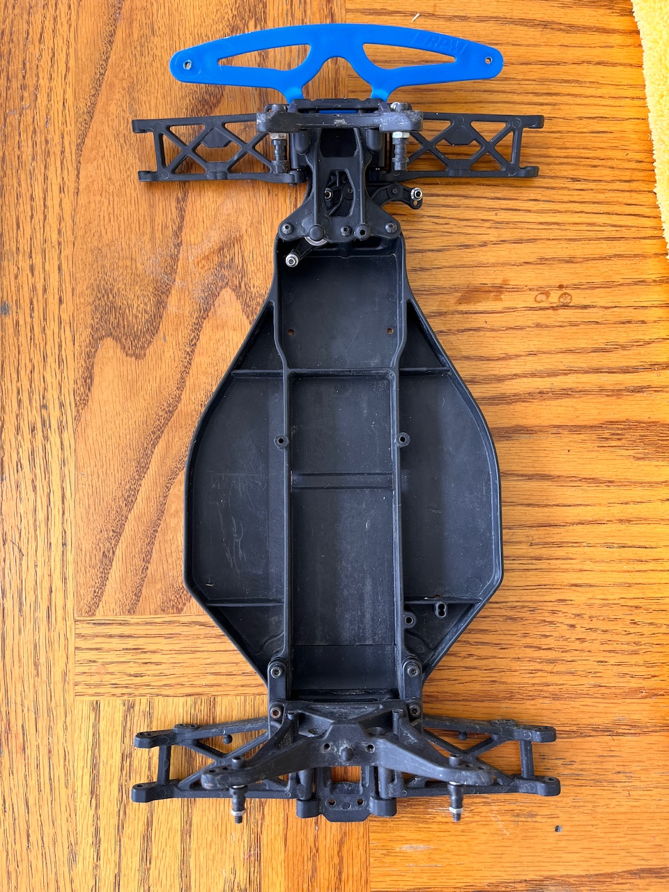

I finally started on this project, it was a b4 parts lot, missing rear shocks.
I picked up a set of 12mm rears when they were on eBay for not much money
Found some transmissions, but I need to disassemble it to see if if for the b4 or the b4.2/sc10

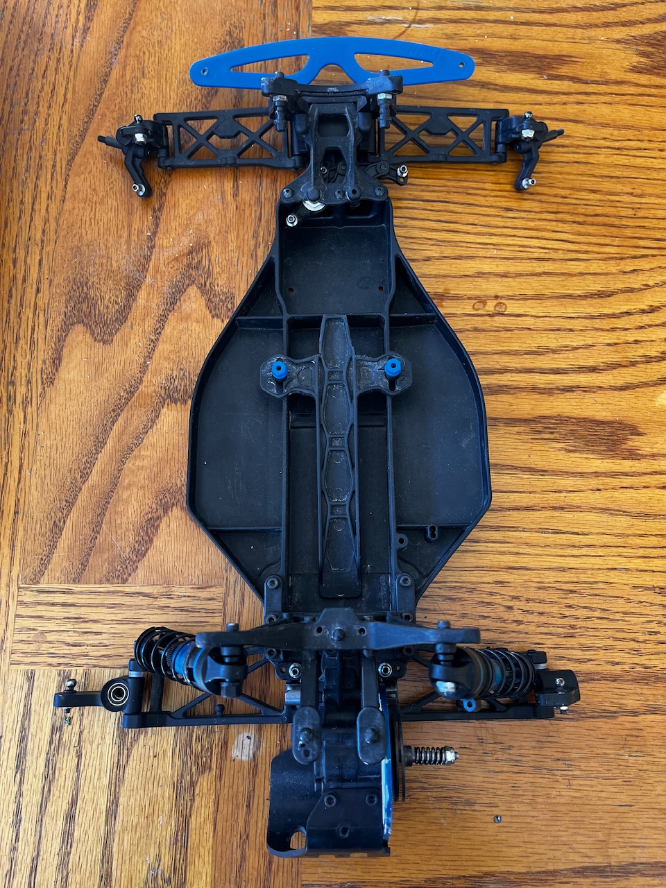

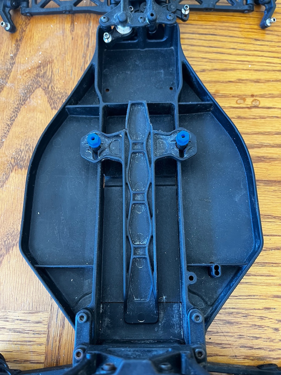

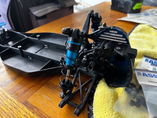

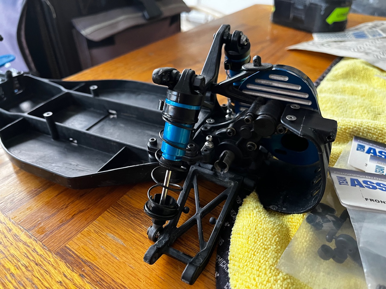

A bit more done
Found my axle spacers and attached the rear hubs on the proper sides. Replaced the newer style motor guard with the b4 style one.
I’m not sure what I can do about the drive shafts. Are there any rc10 parts that can work? Is there a cheap way to replace the shafts?
Made the best I could have the battery holder . Added some threaded rod and rpm nylon nuts that work as thumb screwsFound my axle spacers and attached the rear hubs on the proper sides. Replaced the newer style motor guard with the b4 style one.

Do you have any axle parts to work with or do you need a complete set? There are a few ways to get it together. With the 5/8 outdrives, its either: 1. Find the stock cvd/cva b4/.1/.2 parts (ebay) or 2. Get the cva axles from the Ae or Fan RC rc10 cva set along with B5 65mm driveshafts and slightly grind/open the stock outdrive area for the larger B5 metric driveshaft pin. If you have the sc10 trans case with the metric outdrive bearing, you can use a complete b5/b5m ball diff (both sides of the diff gear slightly shaved) and b5 65mm driveshaft mated to a b4/rc10 cva axle that will all drop right in.
