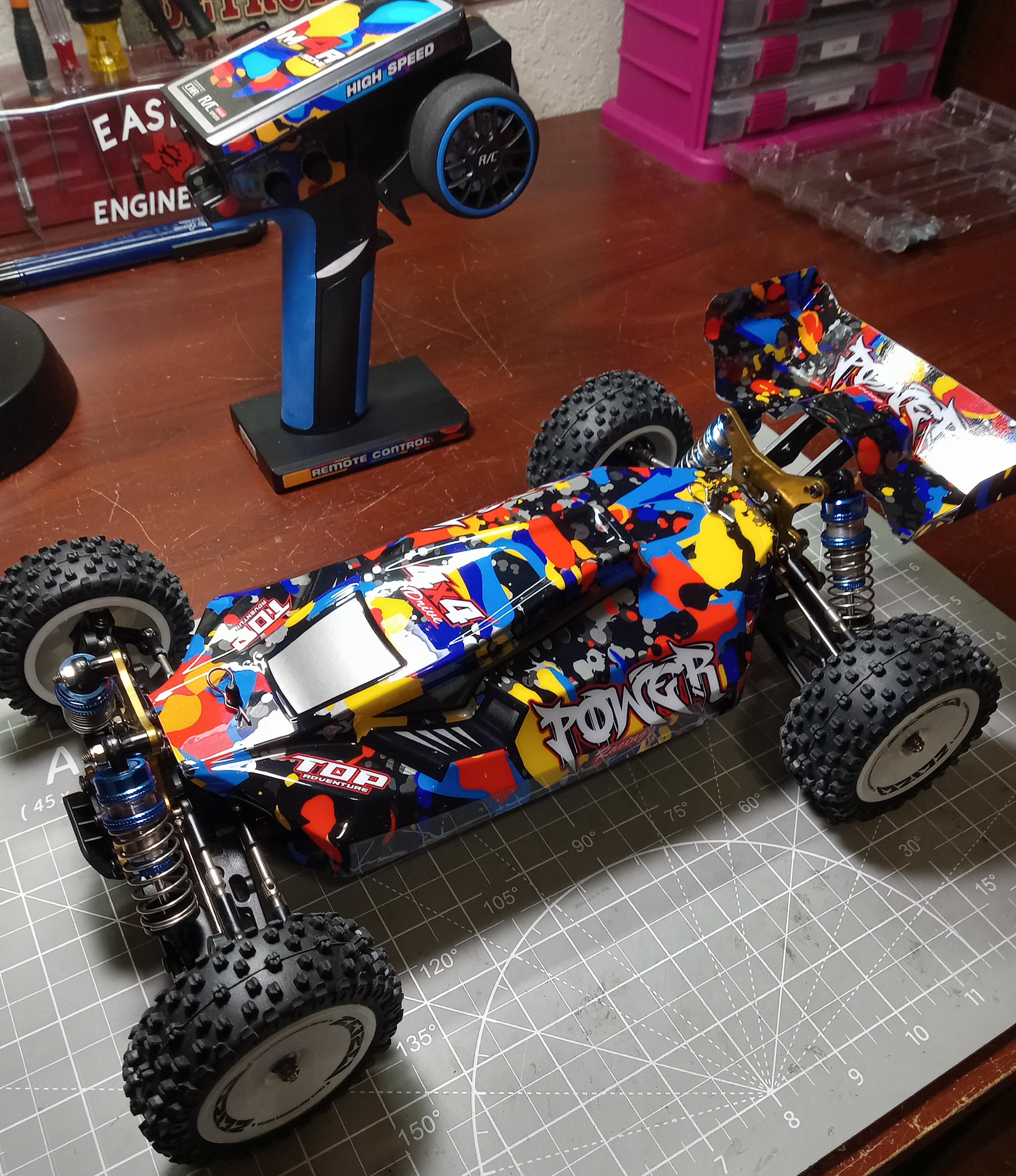

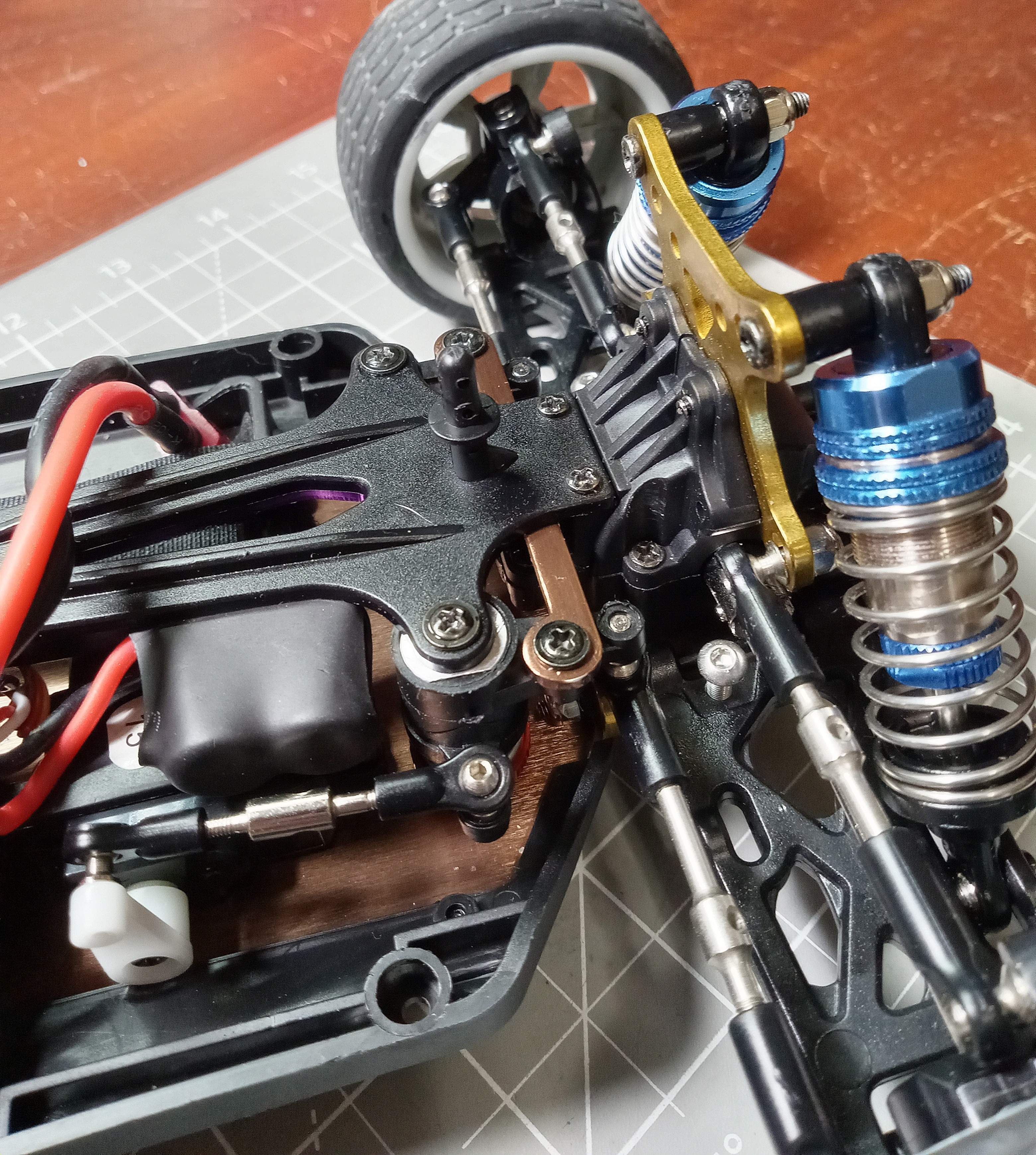

I've had the building/tinkering bug lately. I'm pretty much done with the cars I have, and honestly, I don't have the money to build what I'd really like...Anyways, I still get tires and odd hardware from Amazon periodically. I never paid much attention to the RC cars they have, until now...I took the chance on this WLToys model 124007..1/12 scale 4wd buggy. I figured, if the car was junk, I could use the electronics and parts for a scratchbuild project.
I could not believe how this car is built ! ...Metal chassis, shock towers and suspension tie-bars...gear diffs, full bearings (including the steering rack), turnbuckles, multiple camber mounts, drilled for droop screws, VERY nice threaded body aluminum shocks, metal cv front and dogbone rear axles, 4300Kv motor, and a 2s 2200Mah Lipo battery (with deans plugs)....$ 120.00 brand new complete!
The car feels very solidly built. So far, the only real drawbacks are the CHEAP transmitter (no servo reverse, or dual rate), and the lack of programming for the ESC (or, I haven't found any info on it yet).

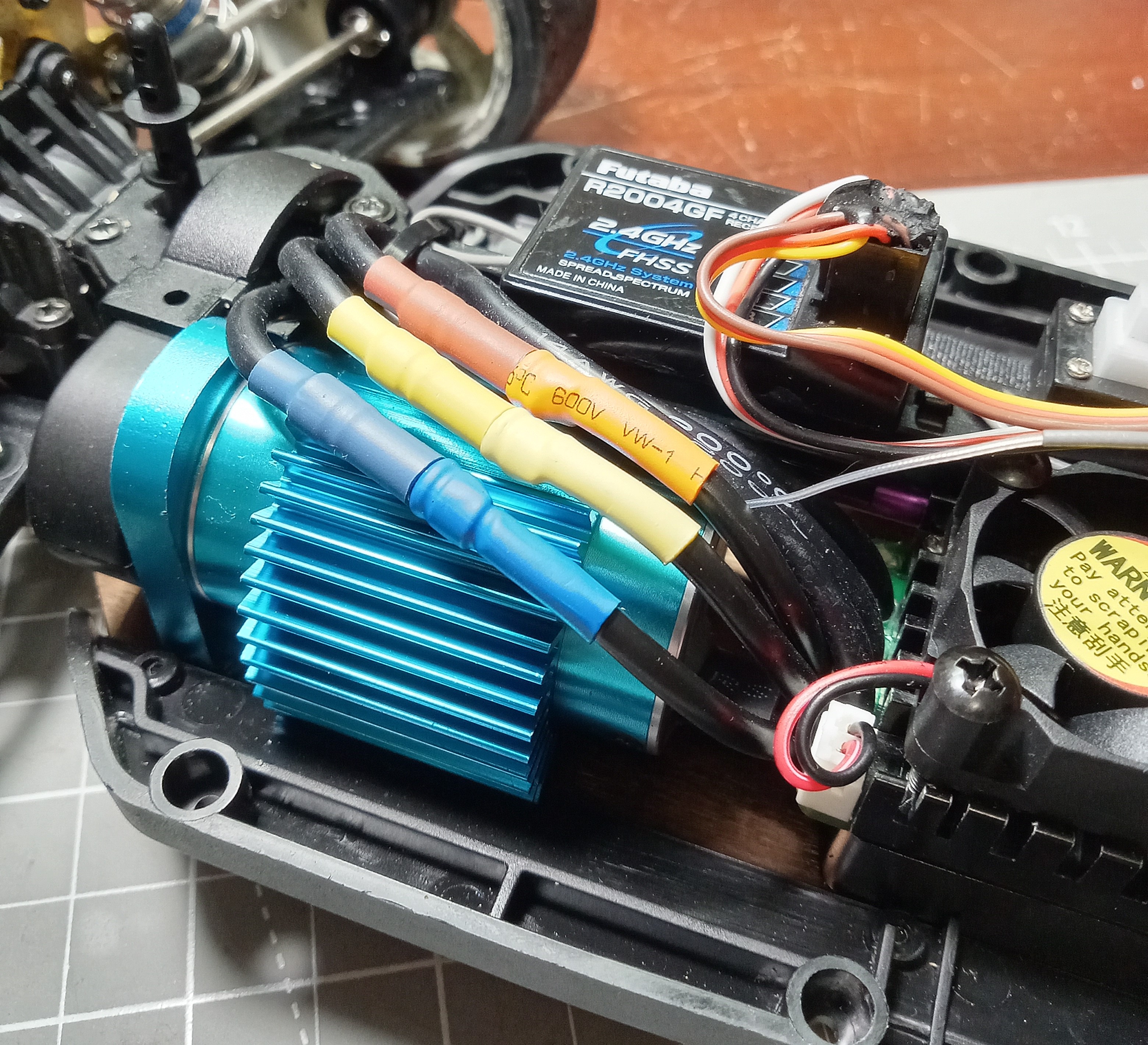

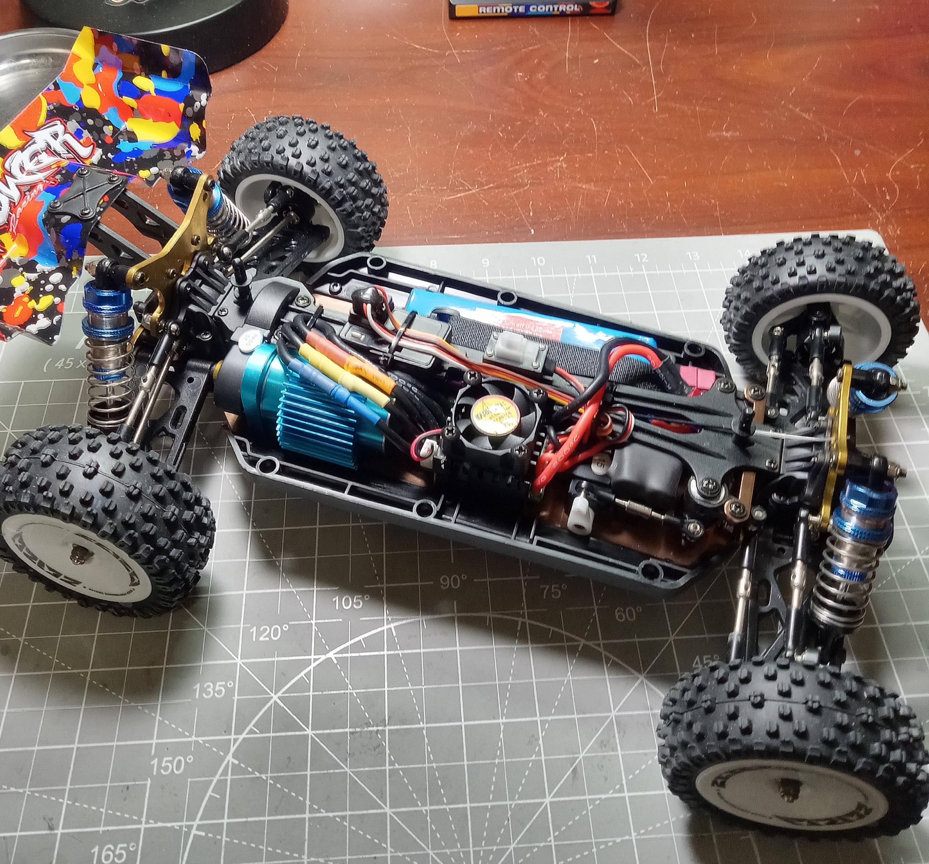

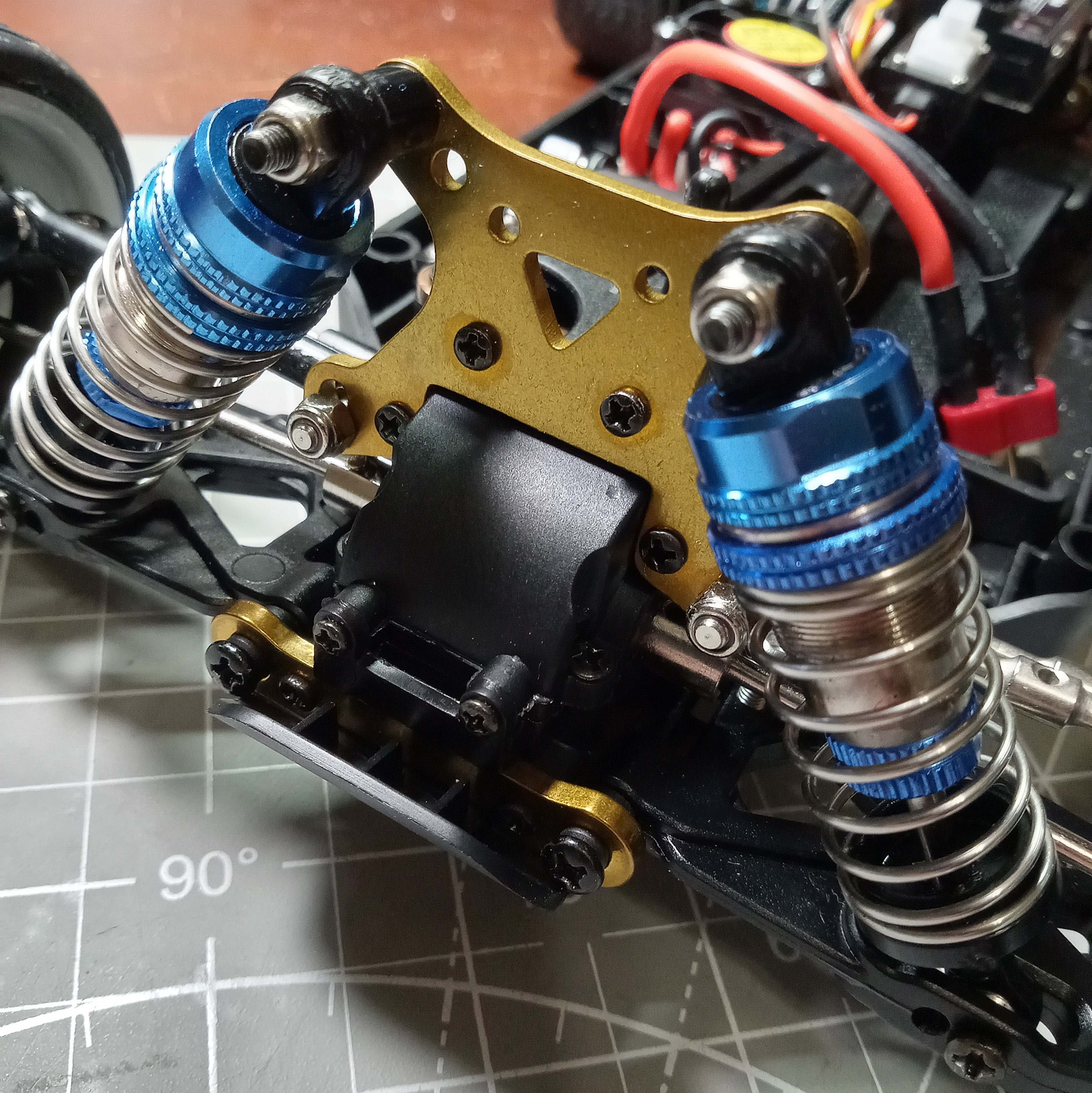

First thing I've done was disassemble the car, lubed the bearings, packed the diffs, put much heavier oil in the shocks, squared up the linkages and swapped out the receiver to use my Futaba transmitter.

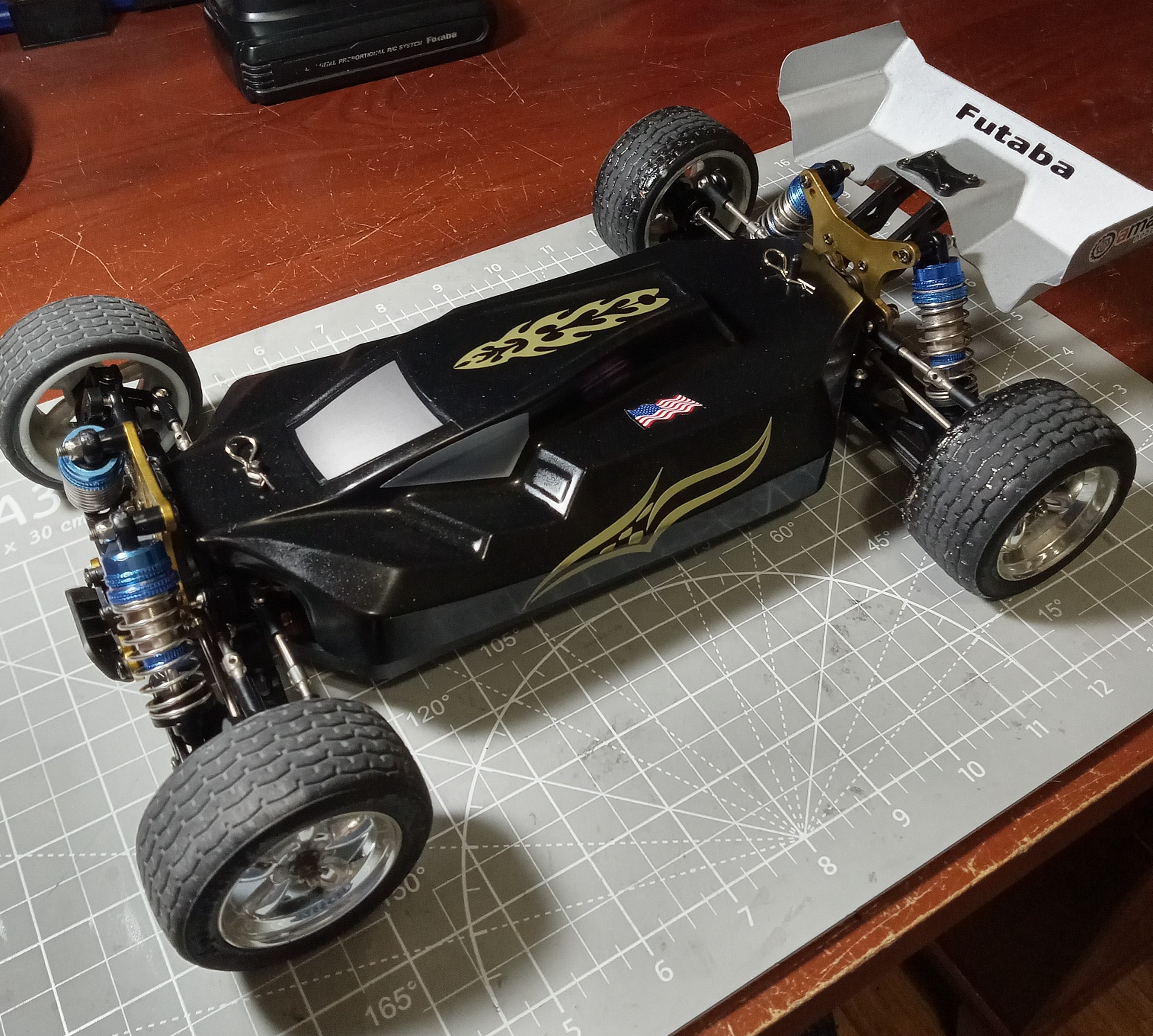

The body is gawd-awful....looks like a clown threw up on it. I did a quickie rattle can paint job on the outside, and sealed it with clear lacquer....It'll do until I get a new body.
The maiden run was very surprising...It's very quick, and my telemetry unit clocked it at 43 mph on pavement, out of the box....This is quickly becoming my new favorite toy!
This car has a full line of parts on Amazon, and a ton of upgrades. I'm considering eventually doing a full aluminum build, and turn it into a street rod.

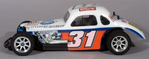

The biggest problem, is the body. Being a 1/12 offroad, it's tough to find something I like (I'm not into trucks or buggy bodies)....I have an old Mcallister coupe that I checked against the chassis, and it might be a winner, if I trim it differently.
Similar to this:
Of course, it'll be a street rod, instead of a race car.
