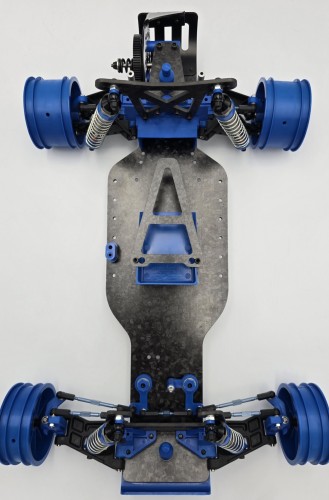

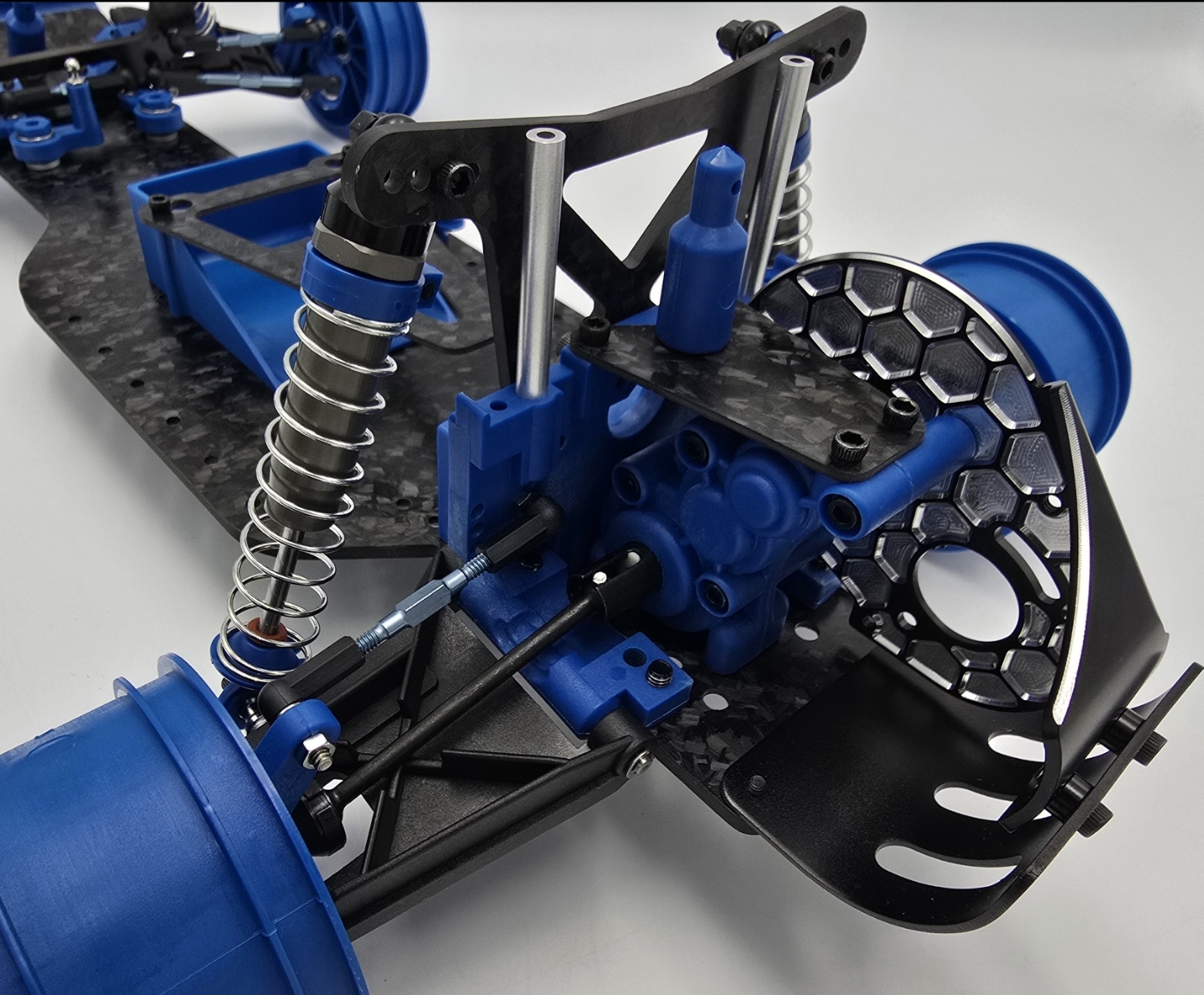

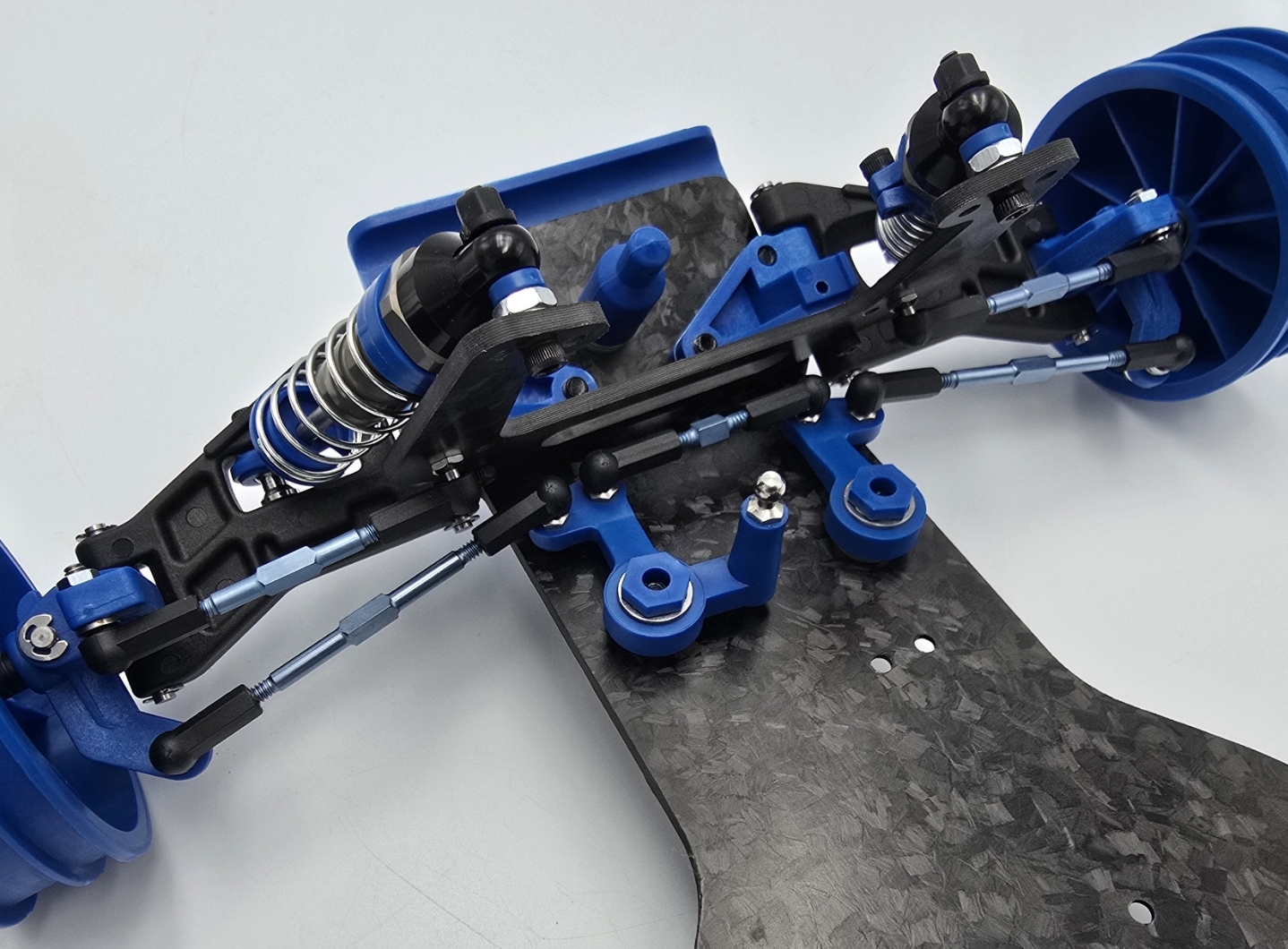

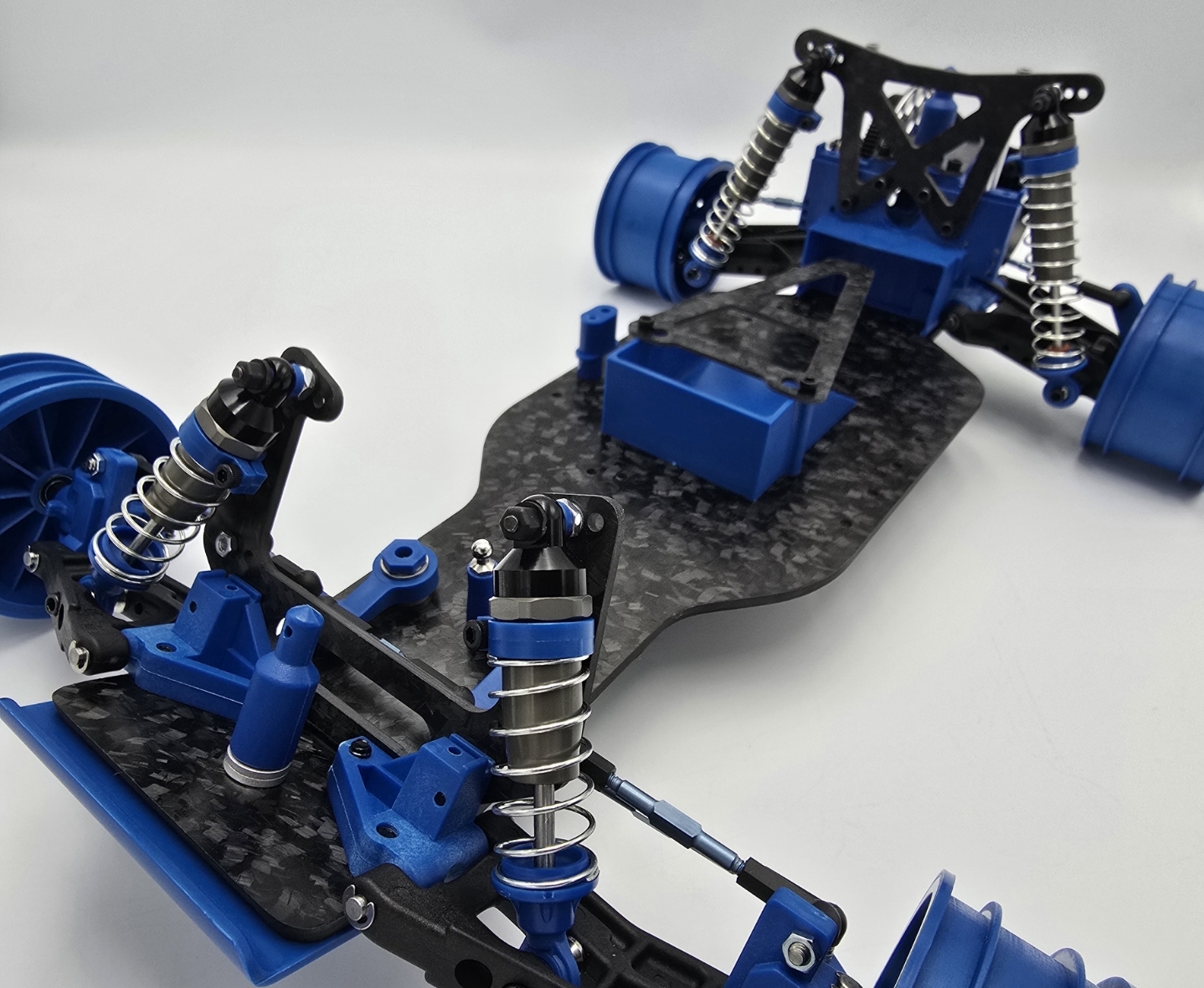

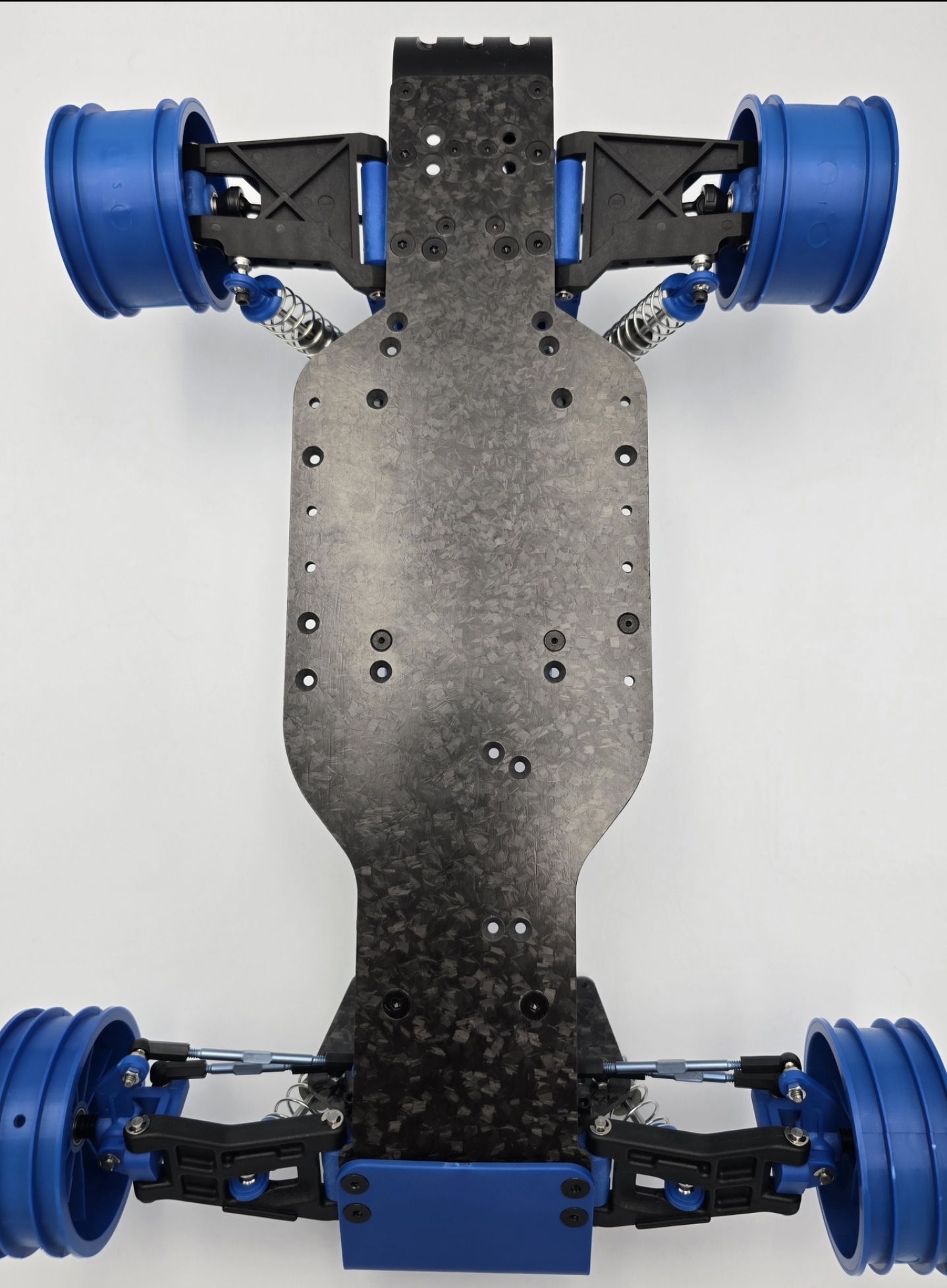

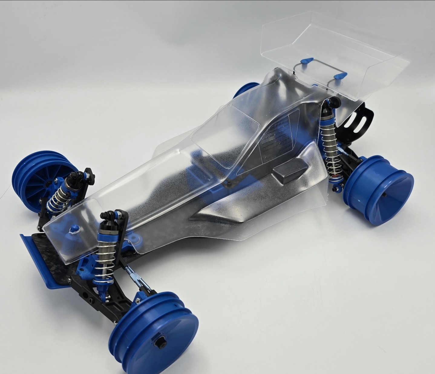

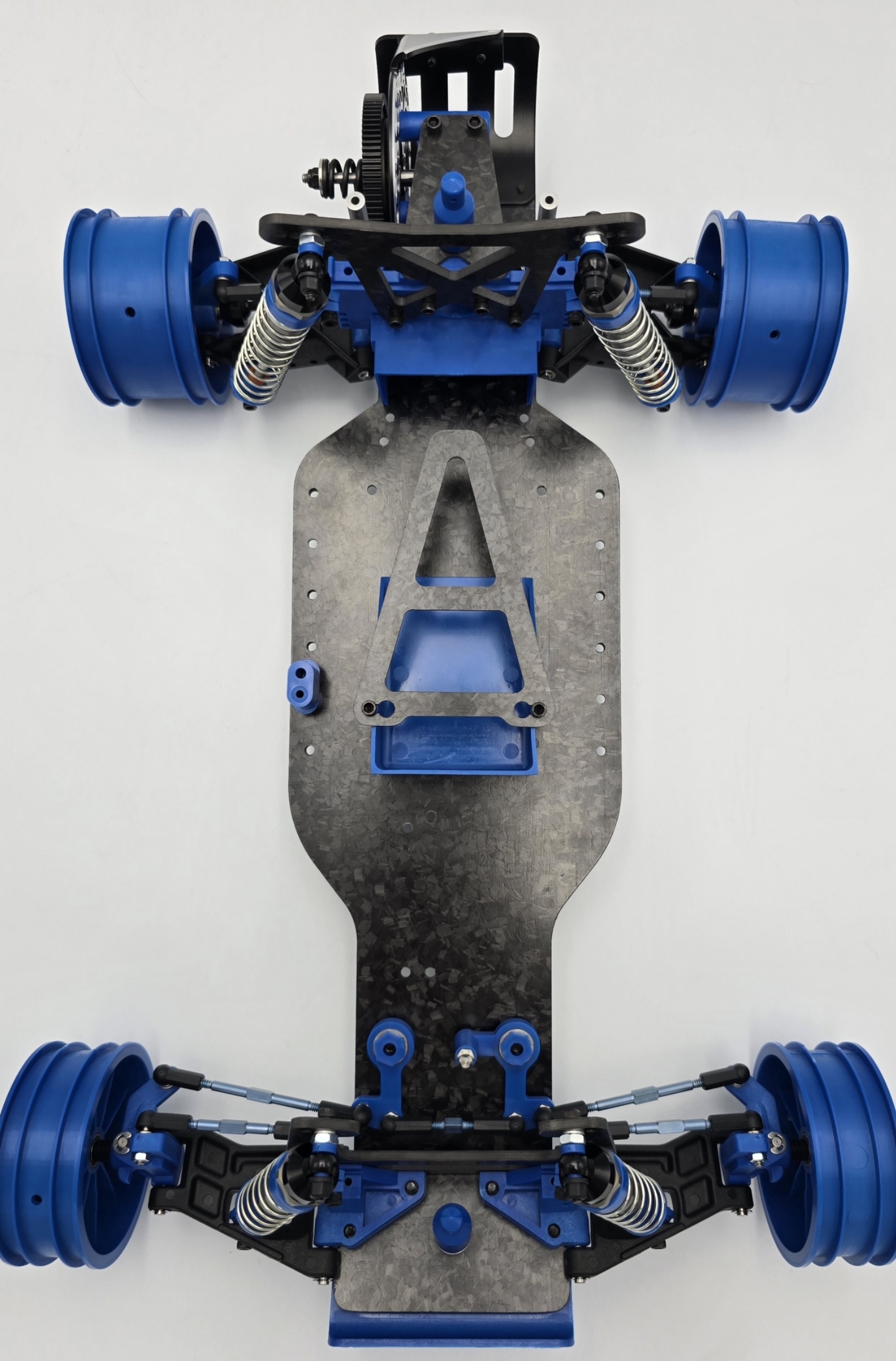

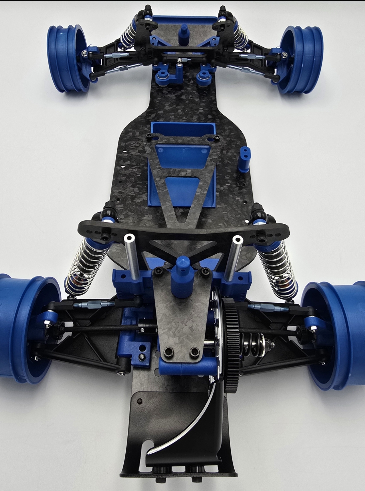

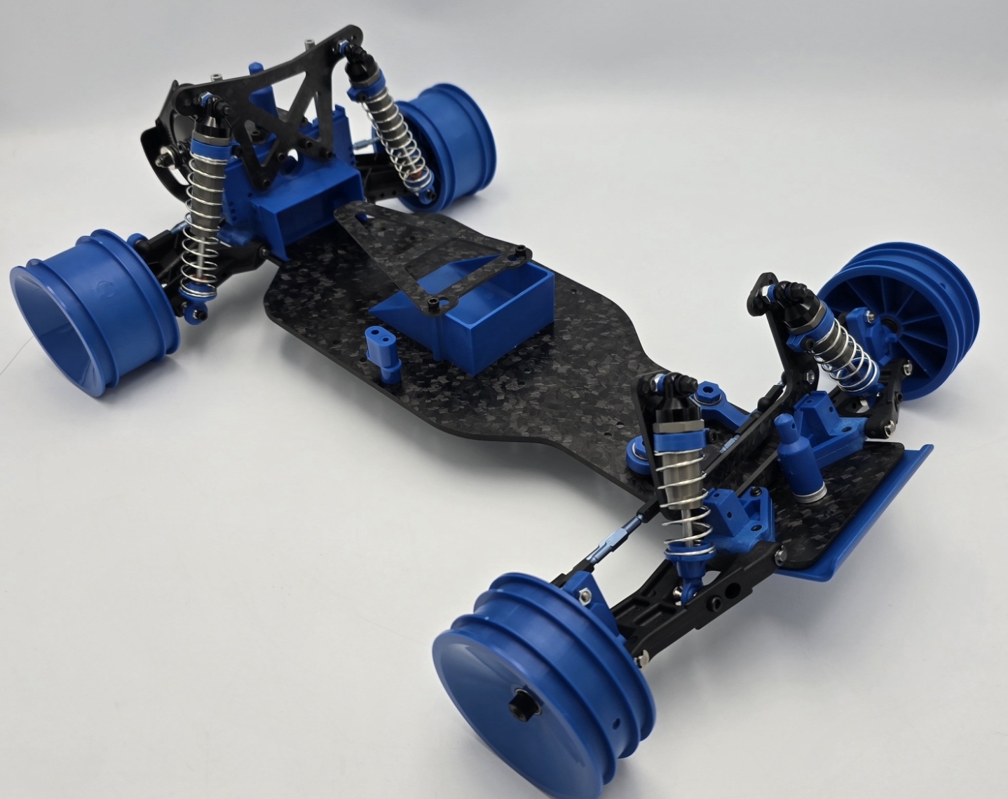

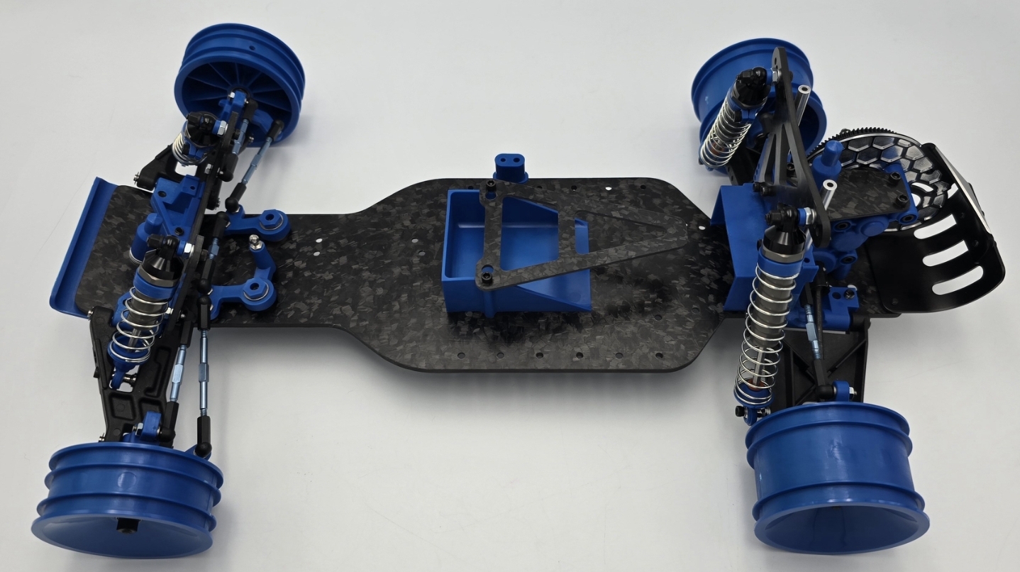

I recently bought and built this Fan RC FR-01 Blue Version kit. I added the Fan RC forged carbon chassis, towers, transmission brace, and battery brace. I also added a Jconcepts motor plate.
Besides the above upgrades, I built the kit basically stock. I swapped just a few pieces of hardware for aluminum units. I was very impressed with the quality of the kit. I didn't have any issues building it. Although I have never built an AE re-re kit, I think this kit is better quality. These shock bodies are far superior to AE.
I don't typically like blue on AE cars, however I really loved this blue kit. I know it's not for everyone, but it really works for me.
I'm still not sure what I'm going to do with it, but it was a fun and easy build and I love the result.

Re: Fan RC FR-01 Worlds RC10 Blue kit
The FR-01 is a great car. I have an earlier one and only really had few complaints: Steering belcranks rubbing and coming loose if used as is (I just added spacers underneath and used longer screws to get more bite) and my earlier model had a binding issue in the gears, which they have since fixed. I did have an issue with the diff rings too but apparently 1 side is smoother than the other so flipping the offending ring solved the gritty feel.
You have any of the above issues or have they all been fixed since?
- Lavigna
- Posts: 1424
- Location: Petaluma, CA
- Has thanked: 1053 times
- Been thanked: 1333 times
I knew about the need for a spacer under the bell ranks before building the kit. I added an aluminum washer under each. I would also swap for some longer screws before driving the car, but the included screws are in for now.RogueIV wrote: ↑Mon Apr 14, 2025 12:11 pm The FR-01 is a great car. I have an earlier one and only really had few complaints: Steering belcranks rubbing and coming loose if used as is (I just added spacers underneath and used longer screws to get more bite) and my earlier model had a binding issue in the gears, which they have since fixed. I did have an issue with the diff rings too but apparently 1 side is smoother than the other so flipping the offending ring solved the gritty feel.
I gave the diff rings a quick sanding with 1200 grit sandpaper. The diff is smooth and went together very easy. I always look for the smoother side on diff rings, and the sanding just adds another level of insurance.
The ball cups in the kit are great. Easy to thread, and a good fit on the ballstuds.
- RogueIV
- Posts: 1049
- Location: W. Mass
- Has thanked: 1945 times
- Been thanked: 967 times
Yeah their ballcups are leagues better than the AE ones. They actually fit!Lavigna wrote: ↑Mon Apr 14, 2025 1:12 pmI knew about the need for a spacer under the bell ranks before building the kit. I added an aluminum washer under each. I would also swap for some longer screws before driving the car, but the included screws are in for now.RogueIV wrote: ↑Mon Apr 14, 2025 12:11 pm The FR-01 is a great car. I have an earlier one and only really had few complaints: Steering belcranks rubbing and coming loose if used as is (I just added spacers underneath and used longer screws to get more bite) and my earlier model had a binding issue in the gears, which they have since fixed. I did have an issue with the diff rings too but apparently 1 side is smoother than the other so flipping the offending ring solved the gritty feel.
