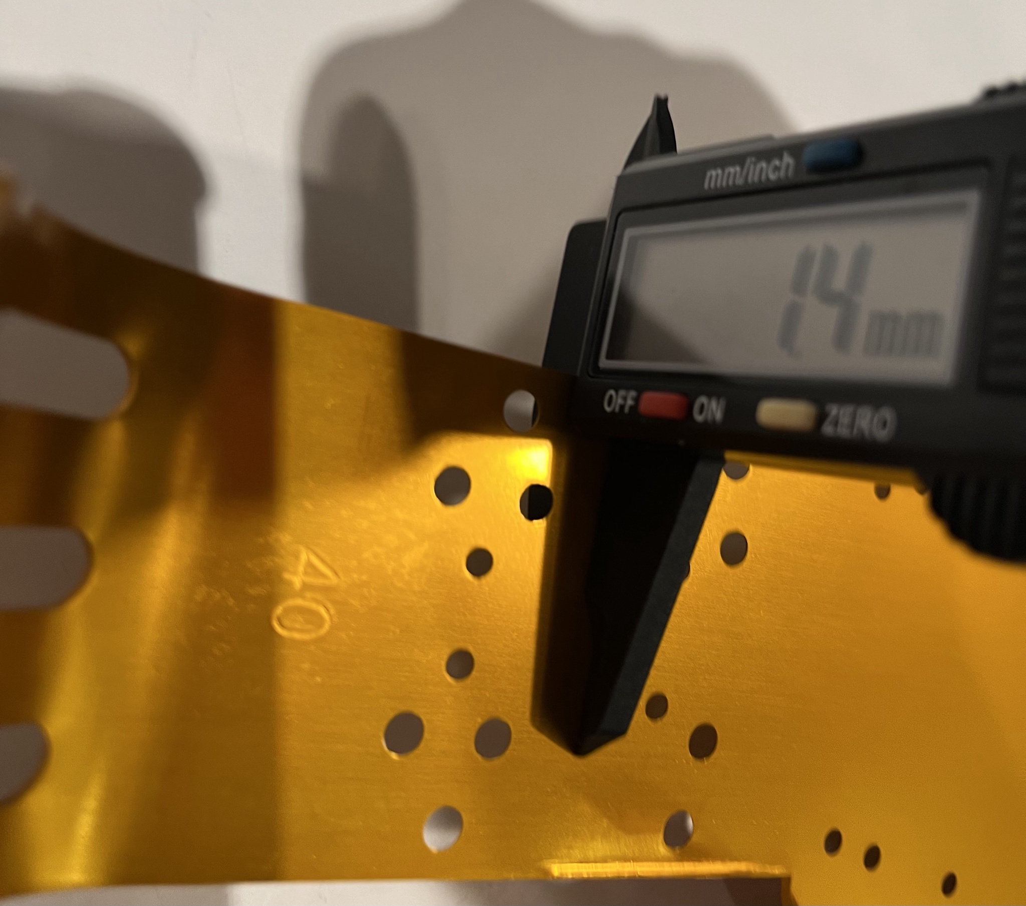

From what I can see in the manuals and build threads, the 40th only had the 6 gear holes, but by the time the Halsey and Gold Team have been released, they both seem dual holed. They have the same part number and the same images in the manuals.

The ebay pictures I see are dual drilled alreadyvonmarshalll wrote: ↑Thu Apr 24, 2025 5:25 pmFrom what I can see in the manuals and build threads, the 40th only had the 6 gear holes, but by the time the Halsey and Gold Team have been released, they both seem dual holed. They have the same part number and the same images in the manuals.

The 40th was dual drilled.

I started a chat on the L&L site and ended up having a call with Lee, the owner. What an amazing guy!
We ran through everything and he ended up customising this package… https://landlmodels.co.uk/products/rc-10-racers-parts-kit-less-chassis, swapping in the gear diff, changing the shocks to gold, changing the front arms and turnbuckles for the short ones and adding in an Associated gold chassis. Literally everything I want in one very reasonably priced package. Cannot praise L&L highly enough!
