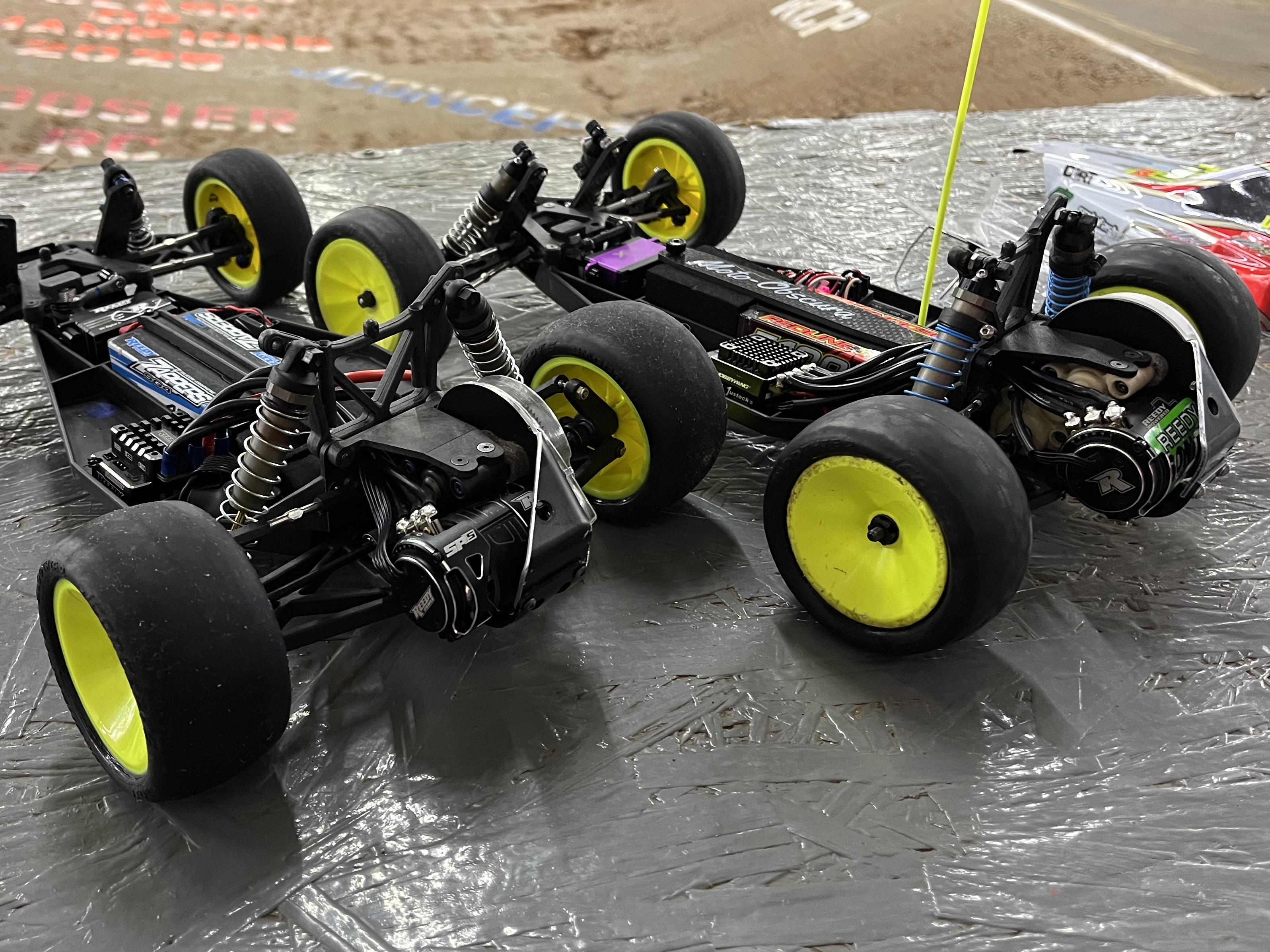

Here’s my B2 with the proto replica kit that I raced at the Vintage Clash of Champions next to Matt Ledger’s original ‘95 worlds B2 prototype (Matt’s is on the left).
It was really cool to be able to compare it with the real thing, especially since Jason and I developed the replica parts almost entirely from photos.
