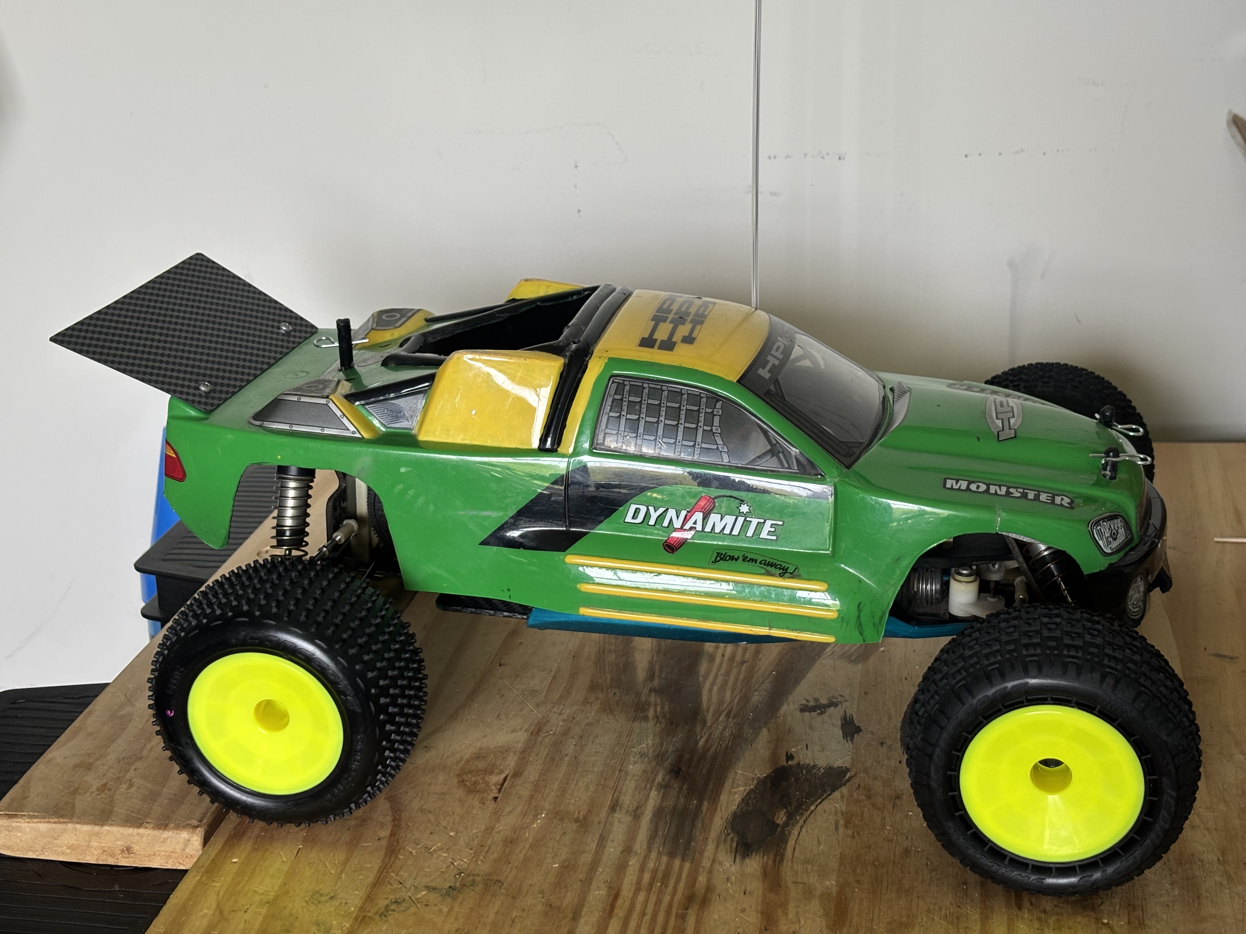

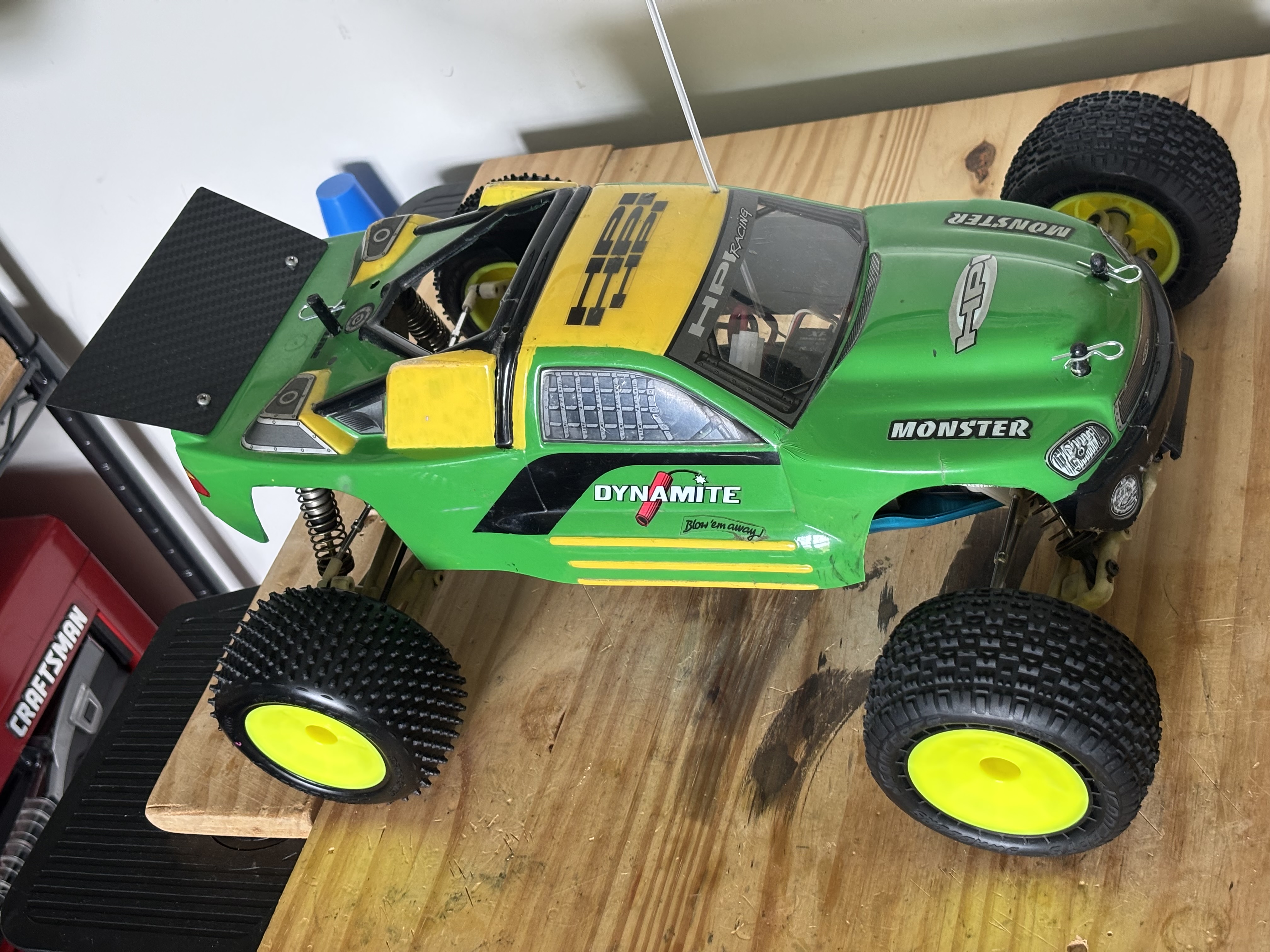

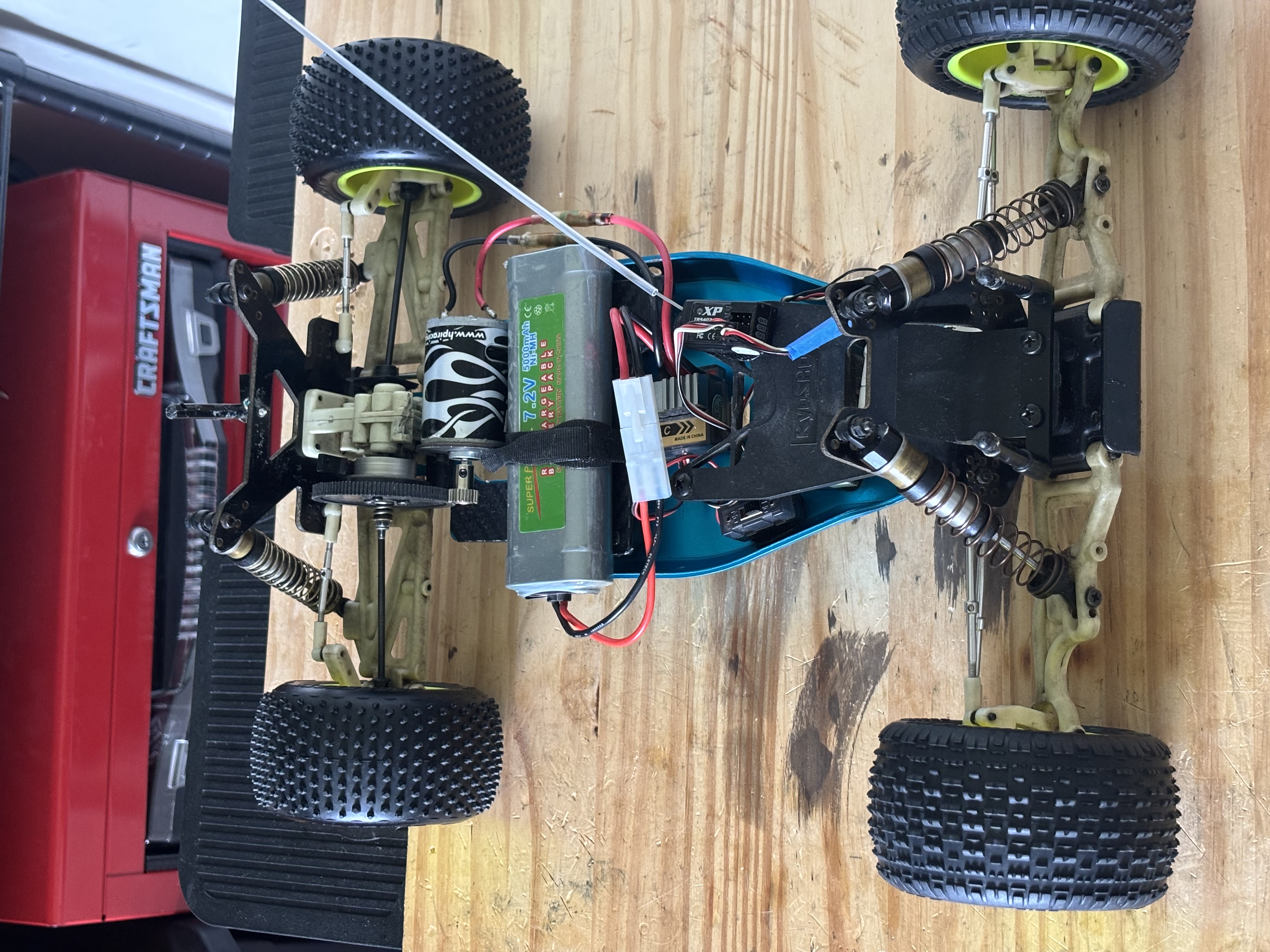

This was found in the trash in early 2017. Finally got around to making some small fixes and improvements.

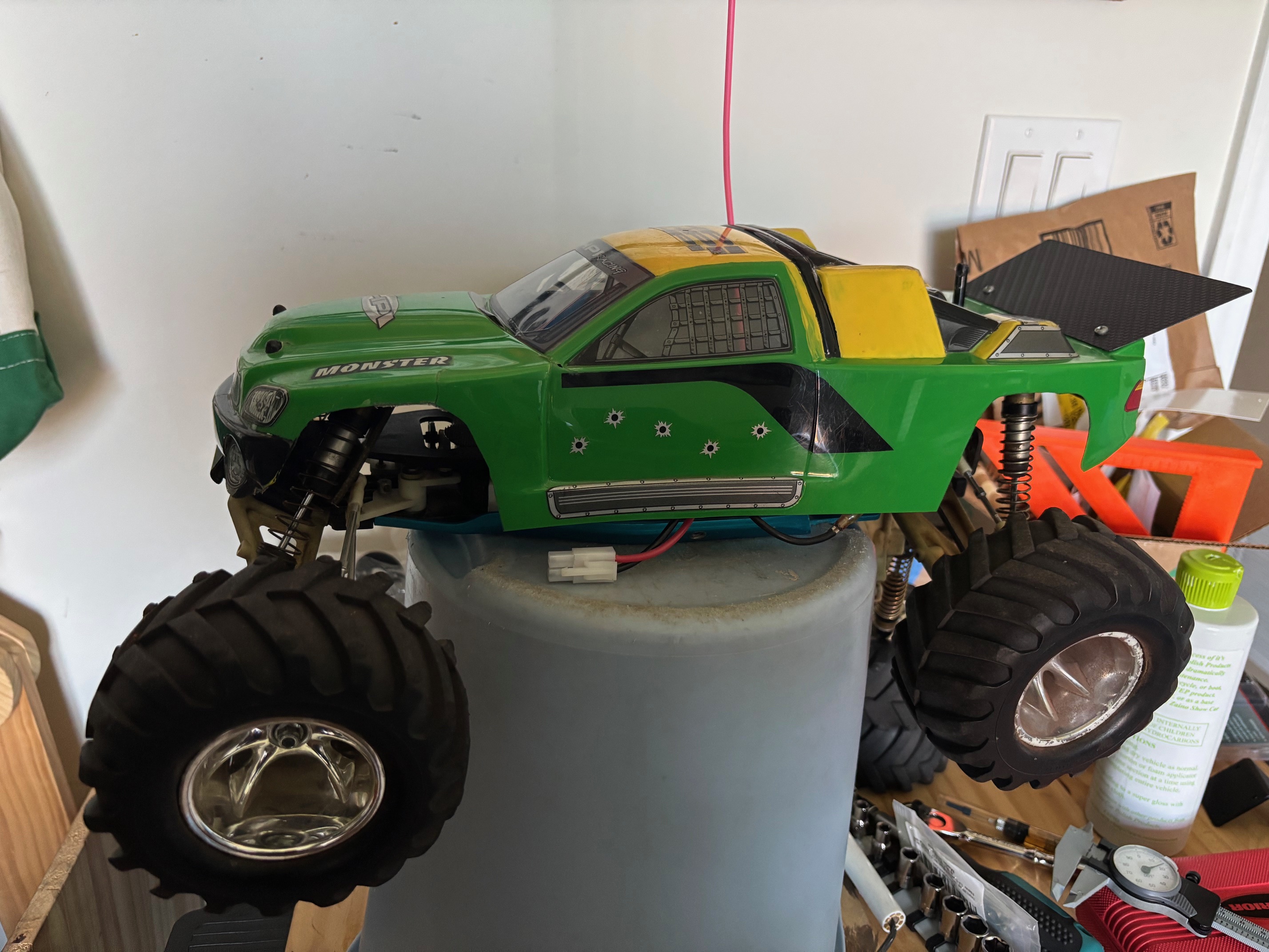

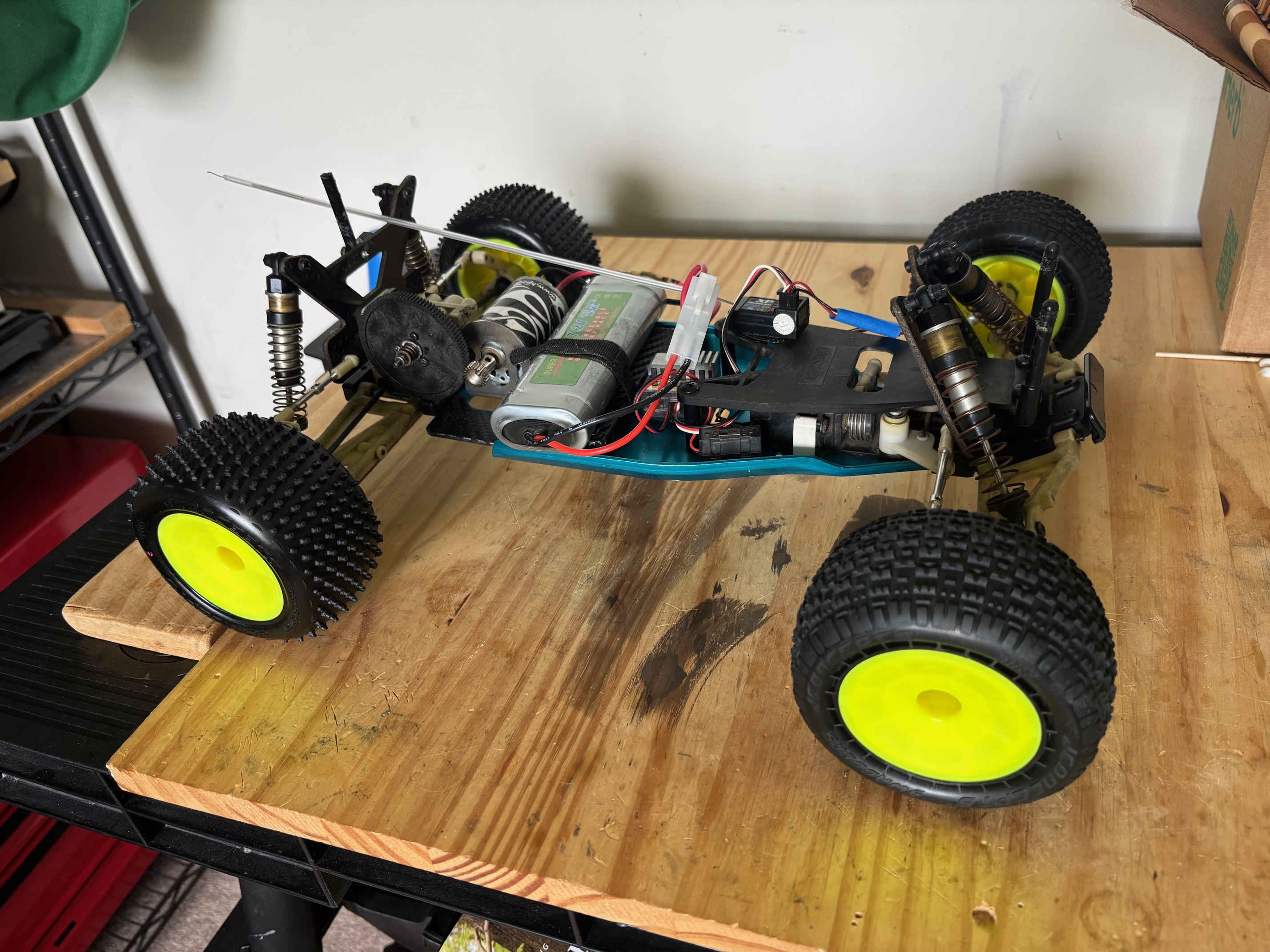

Re: Outlaw Rampage Pro Team - electric conversion rescue
Here is how it looked originally. Notice the custom motor mount. Took awhile to figure out, but the wheels and tires are for the old nitro Stampede/Rustler.
I would love to invest in a repro body and modern electronics but I do not think the SST gearbox can be sorted. I have watched/read about "fixes" and unfortunately I think mine is just bad. It is currently working but it is not smooth. It is smooth until I try to tighten the diff at all. This torques everything and the diff gears are no longer concentric.

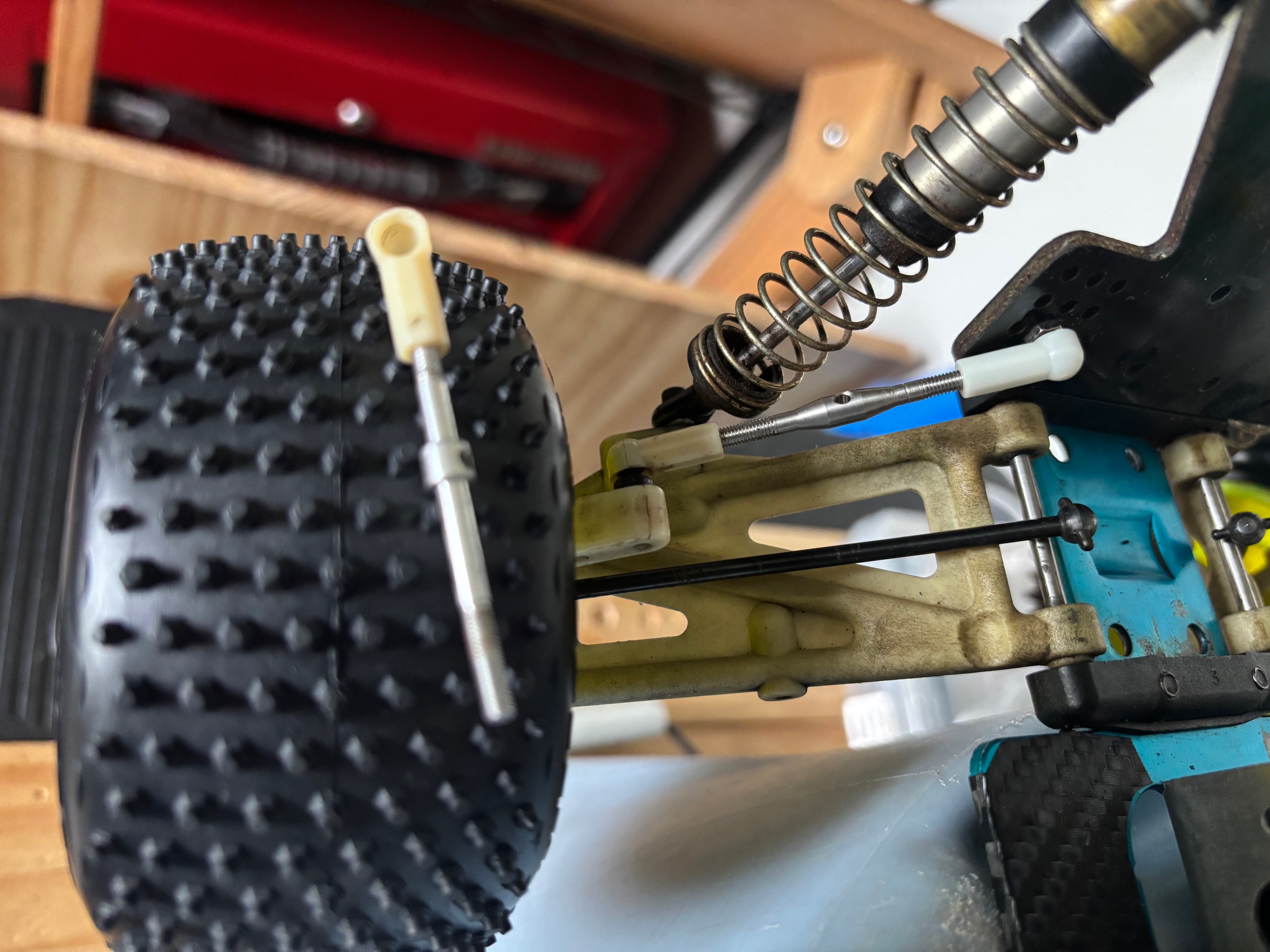

Turnbuckles:
Two of the factory turnbuckles were bent. One in the rear and one of the front steering linkages. Secraft m3 turnbuckles seem to be a perfect replacement for both. 50mm rear and 70mm front.

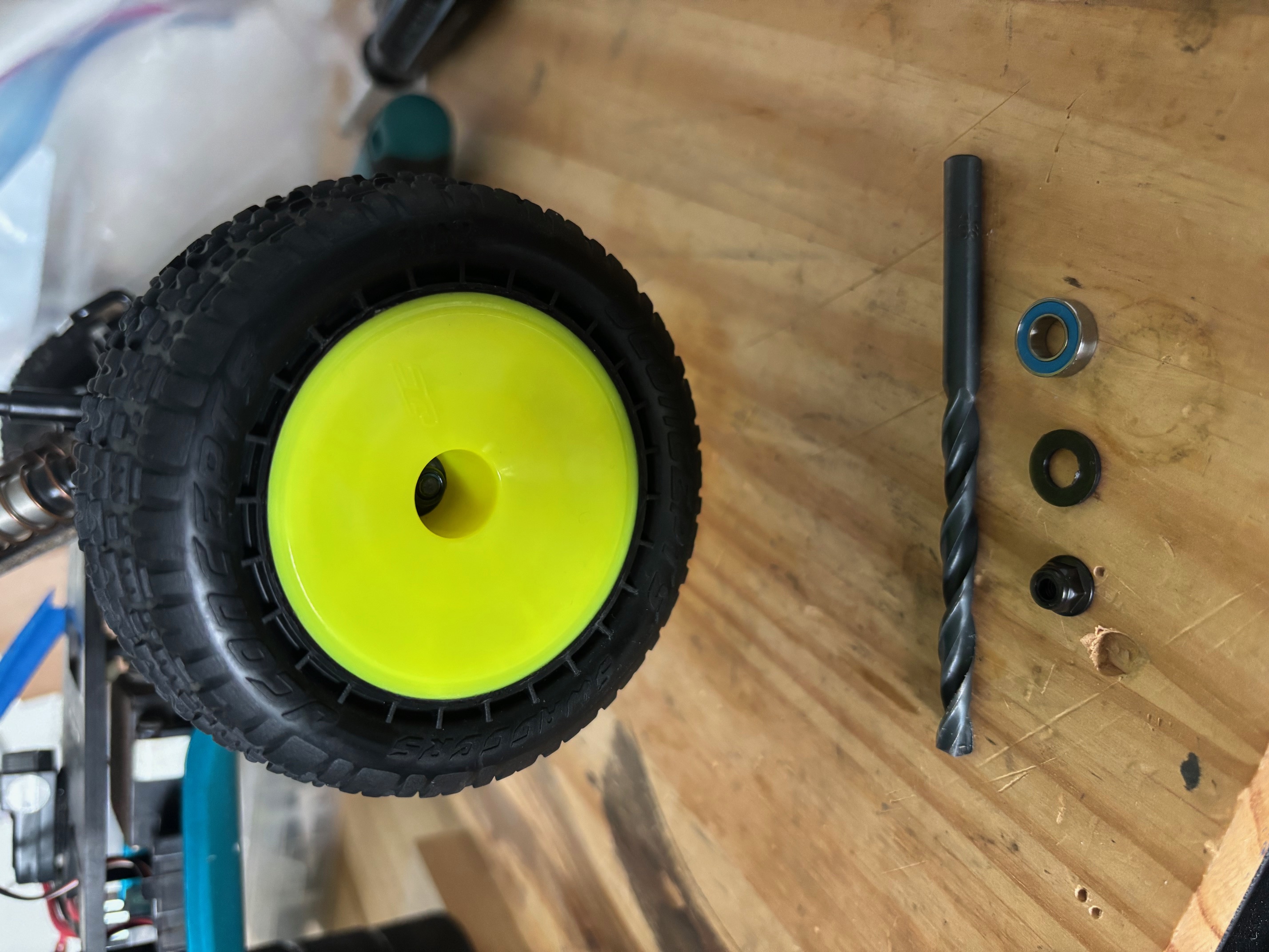

Front wheels:
This was a pain and I bought a number of parts that ended up not working. The plan was to use Ultima 4mm axles and the GPM Tamiya adapters along with new 4x8 bearings. The problem is the factory Ultima axles are way to short. I am sure at some point longer aftermarket axles were available but I could not find them.
Ultimately, I arrived at a simple solution. Its not perfect, but it works. 6x12x4 bearings followed by JConcepts RC10 wheels drilled out to 6.1mm, followed by a 6x12x1.5 plastic plumbing spacer, followed by NON-serrated nylon locknuts. Most wheel nuts seem to be serrated. I used Axial AXIA1045 from AMain.
Edit: I would recommend going with TLR wheels. Based on my research, TLR wheels should have closer to factory offset than the more common Associated wheels. This will be especially important in the front. The TLR wheels should reduce wheelbase by .700" over the Associated wheels.

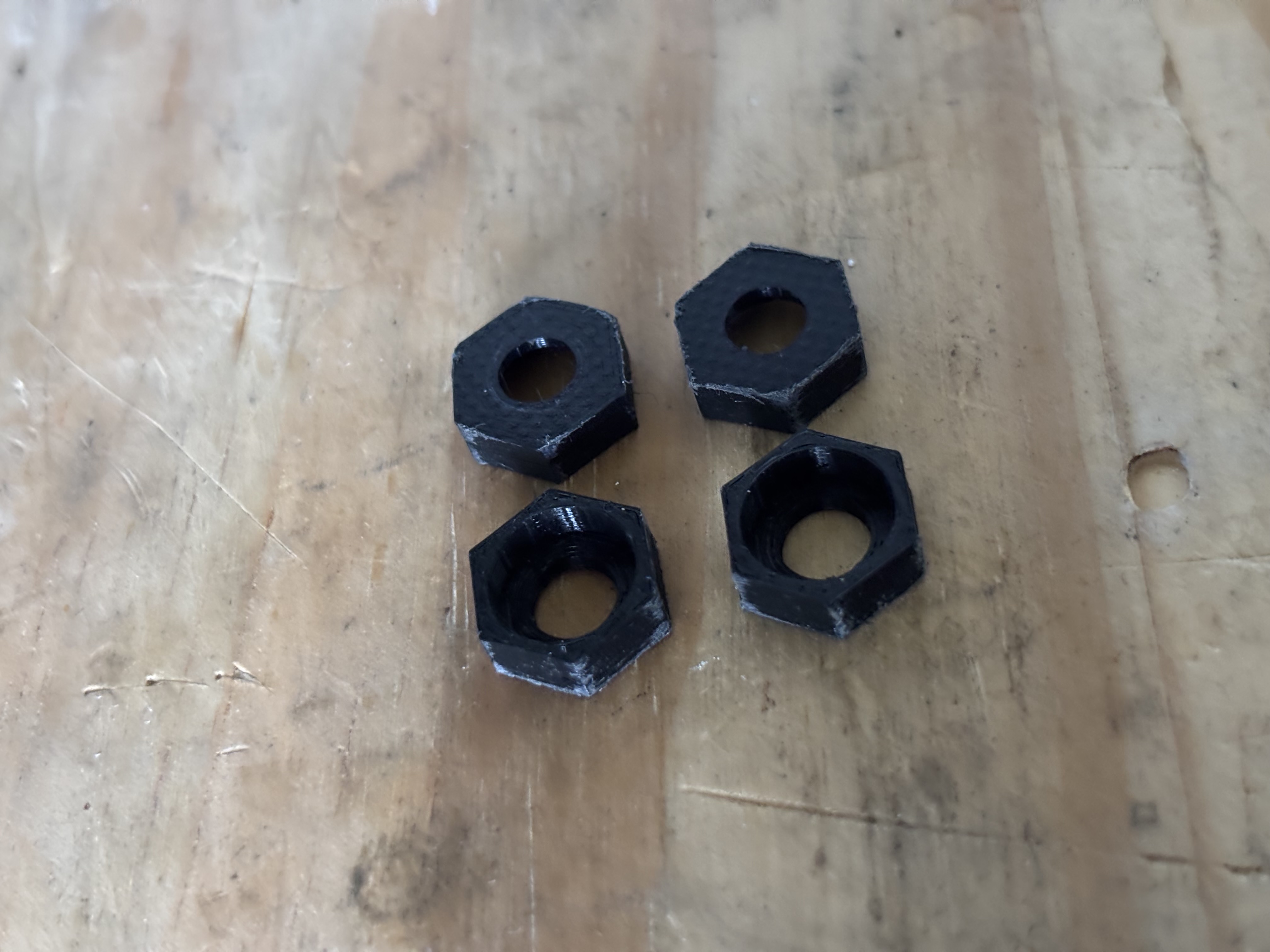

A friend printed some hex adapters for me. If I had these originally, I believe I could enlarge the front wheel holes to 10mm instead and just use two 6x10x3 bearings (same as factory). I plan to have a jig printed to make sure the hole is concentric.
Commonly available stadium truck wheels as of today:
Associated spec: JConcepts, DE Racing, Rudog, XRay, Schumacher
TLR 22T spec: TLR, DE Racing
Please add to the list if I missed anything.

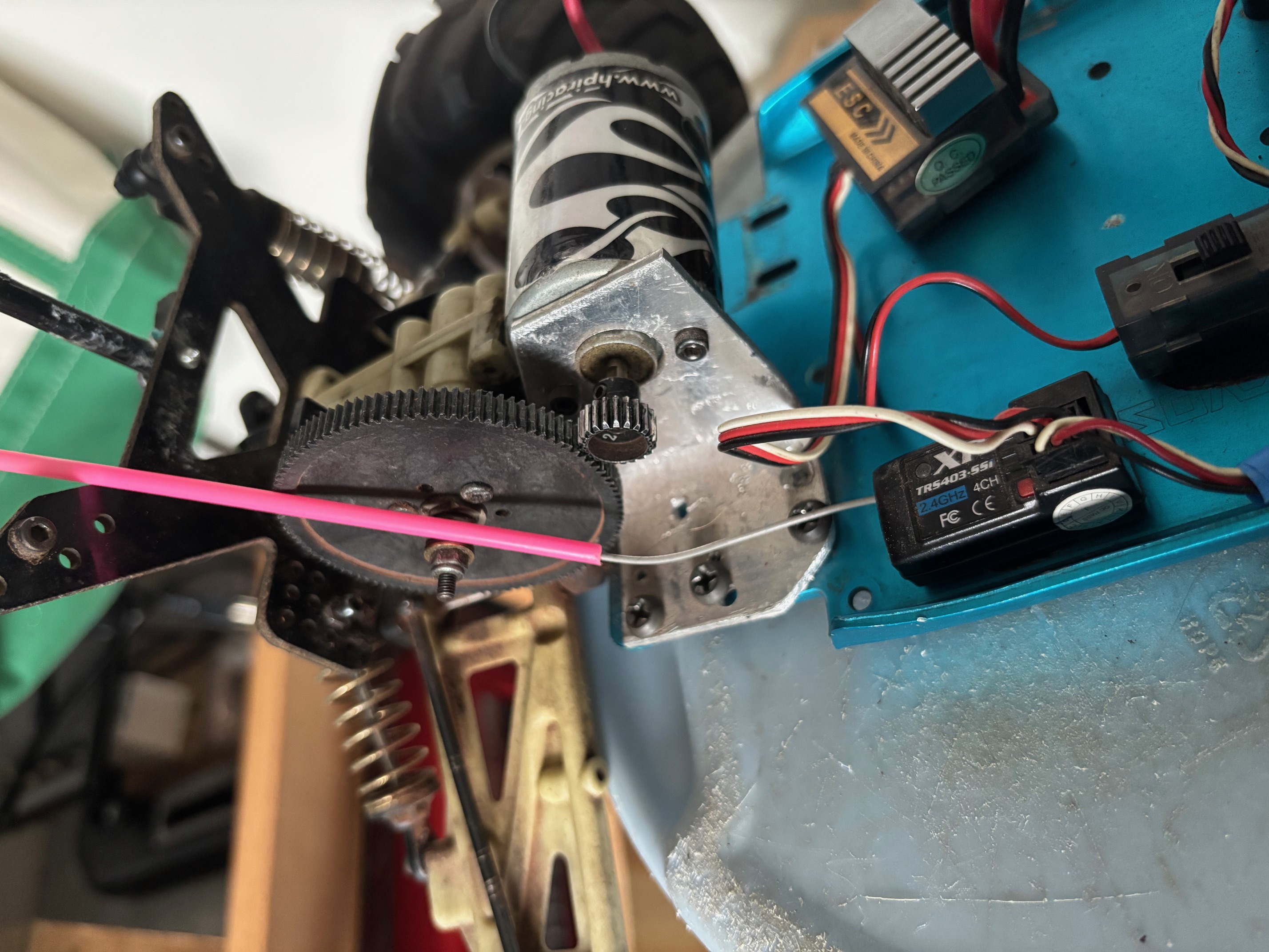

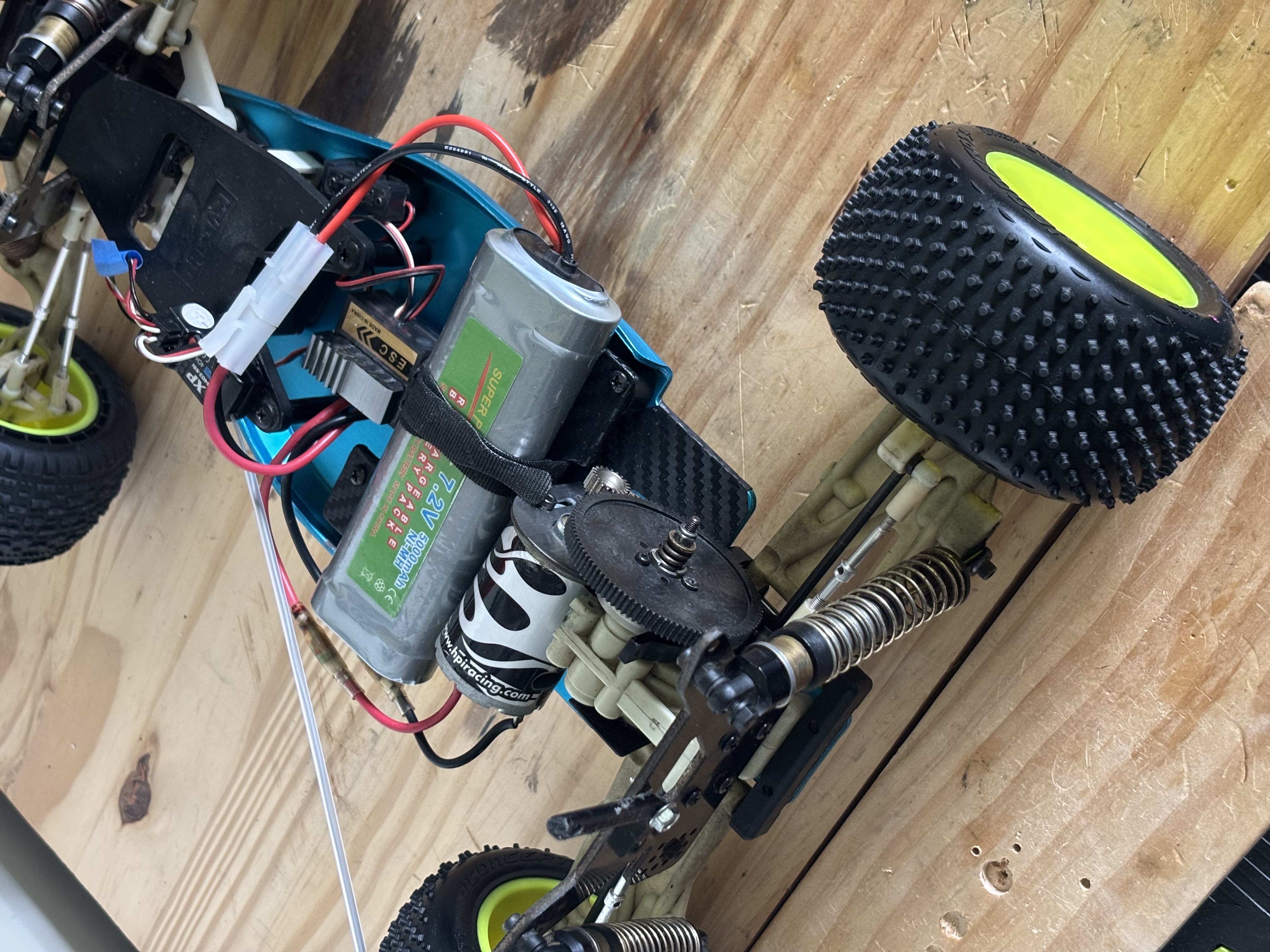

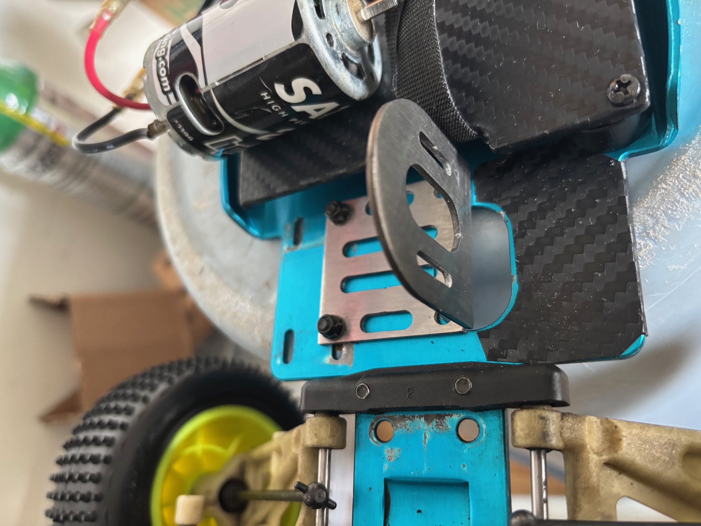

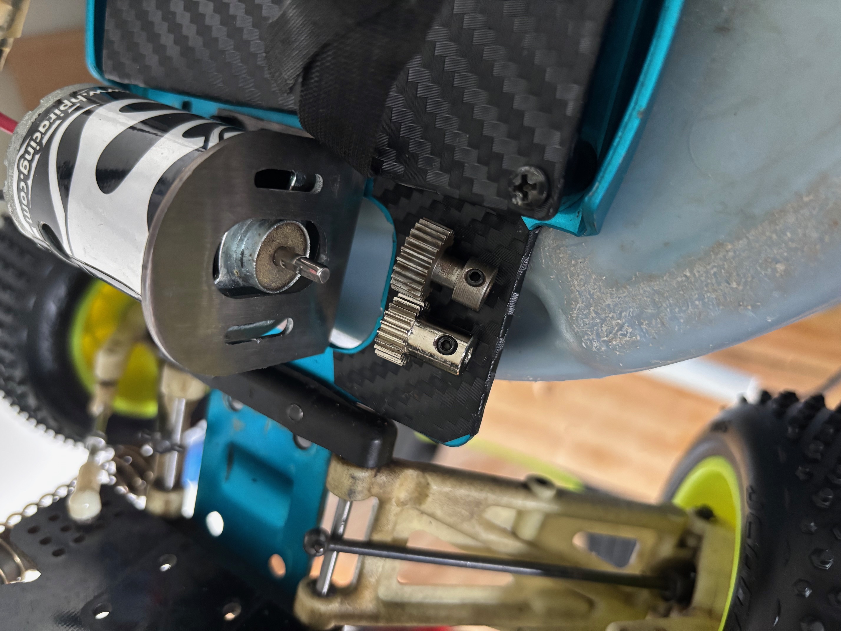

Motor Mount:
As pictured in my earlier post, the previous owner used a bent piece of aluminum for a motor mount. Attached with self tapping screws
I found a universal 540 mount on Amazon that I planned on modifying. However, it fits perfectly using two of the factory engine mount slots when used with an extended pinion. Kyosho makes extended pinions for the Fantom and Schumacher also makes extended pinions. They are both the exact same length.
I covered the self tapping screw holes with some carbon fiber vinyl. If I can't see it, its not there.

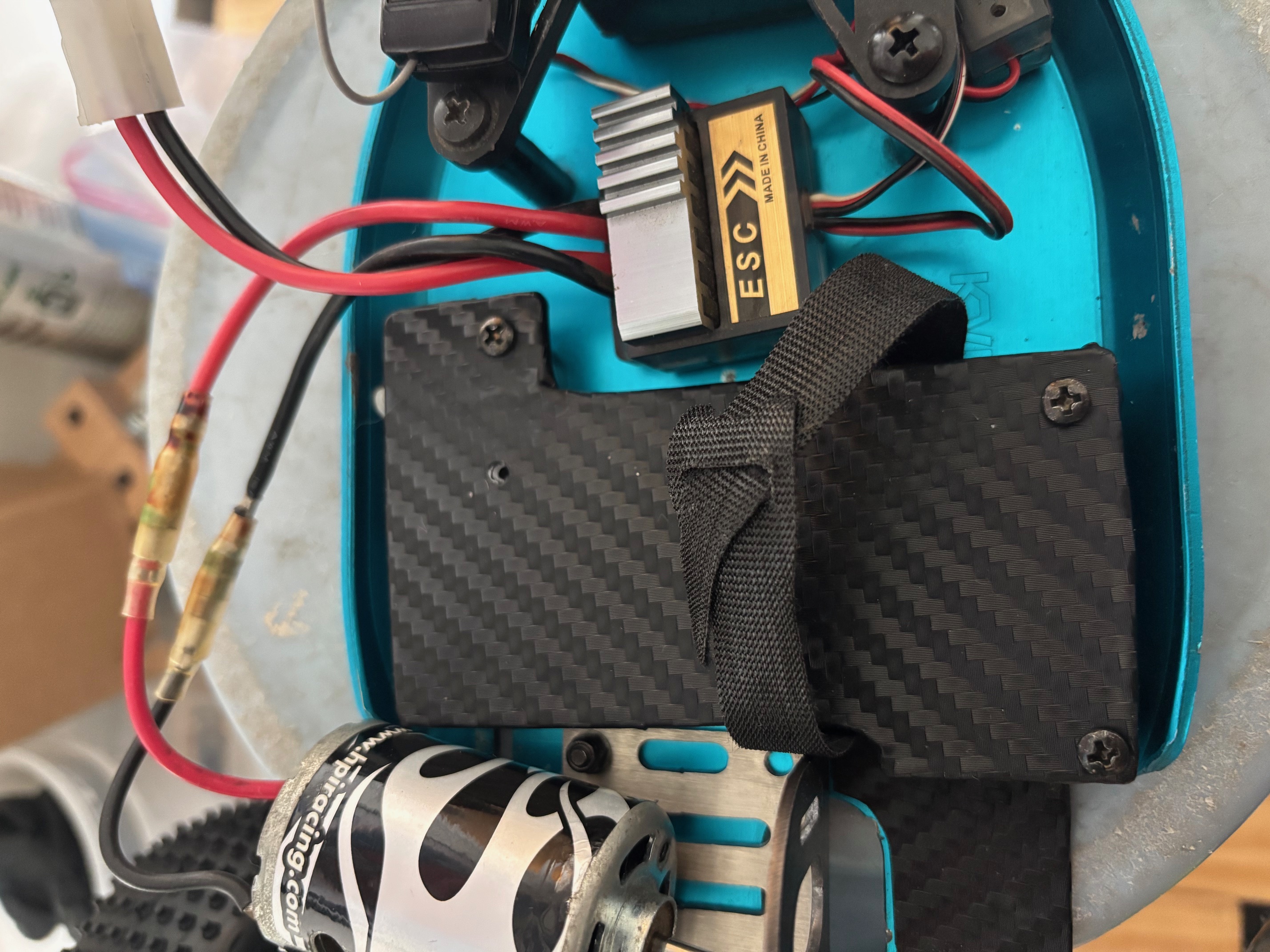

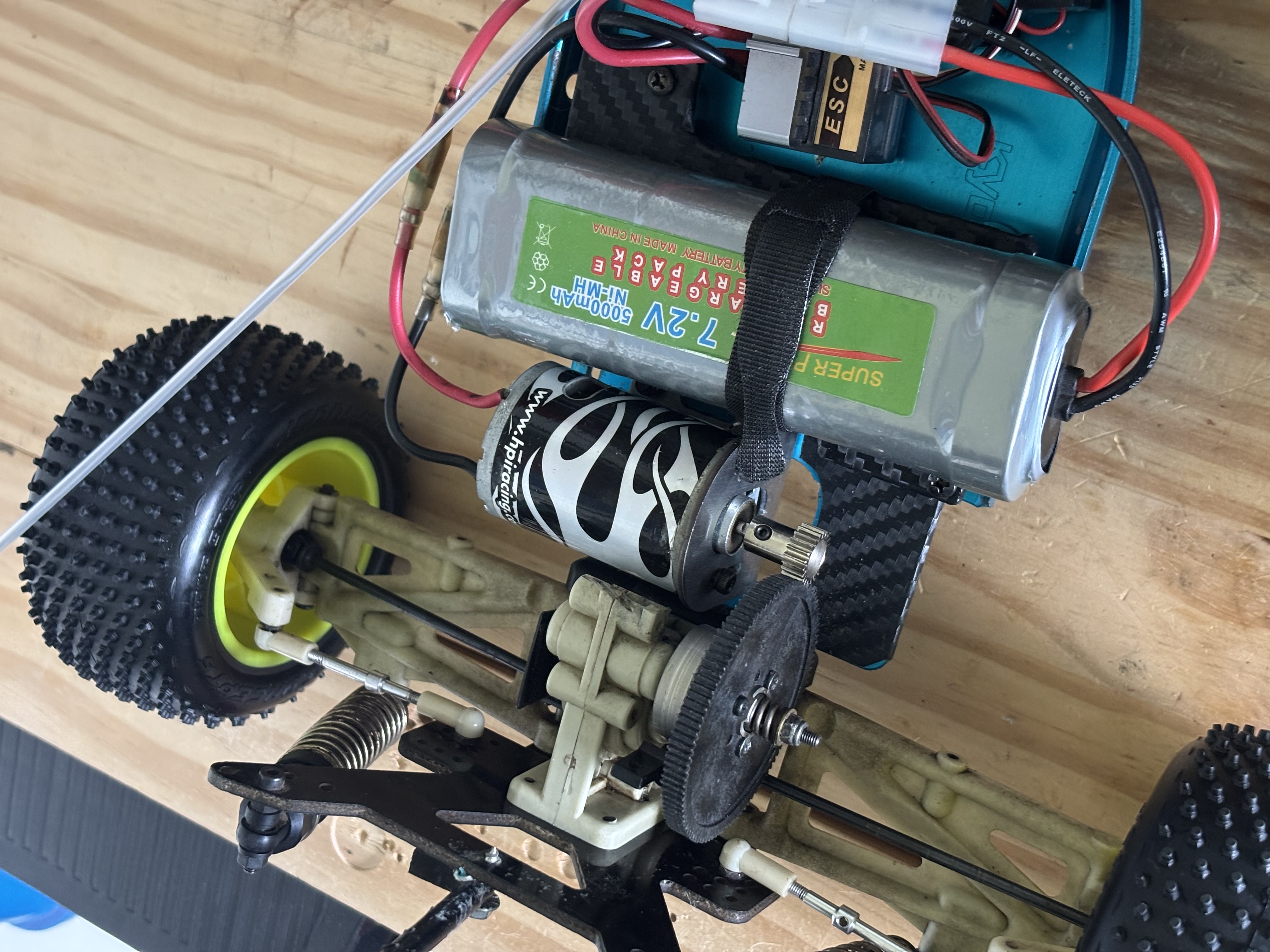

Battery Tray:
Made the battery tray out of a scrap piece of plastic and covered (poorly) in carbon fiber vinyl. Its mounted on black plastic spacers that I saved. I can't remember where, probably Ikea furniture or similar.
Where are people ordering the custom carbon fiber plates and shock towers that I keep seeing?

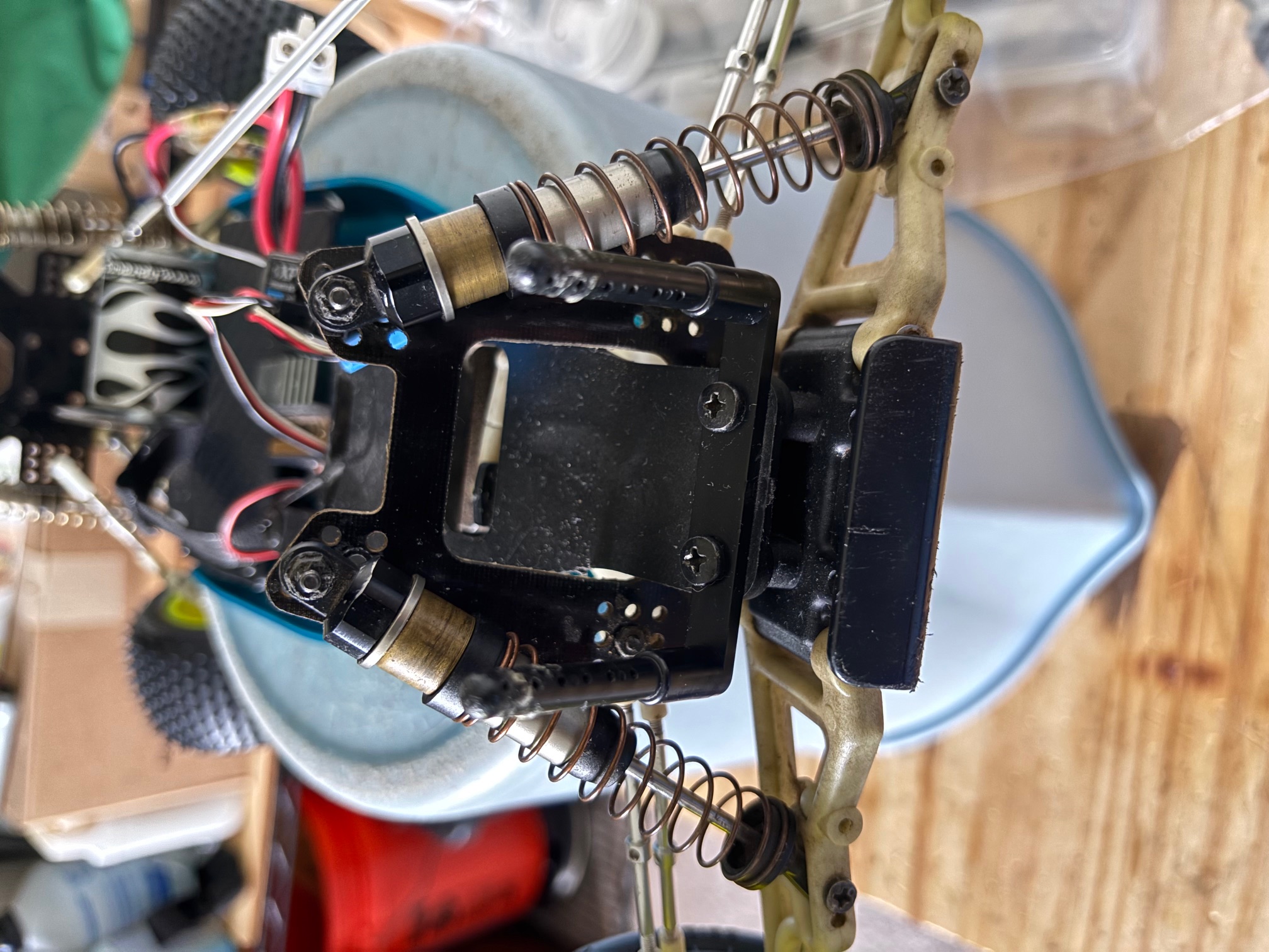

Shocks:
The shocks are in skyjacker mode thanks to what I believe is custom brass spacers. I would like to get the original spring clips but they are not easily found. Does anyone know of any spring clips or clamps that fit 12mm OD shock bodies?
- RogueIV
- Posts: 1190
- Location: W. Mass
- Has thanked: 2166 times
- Been thanked: 1114 times
Maybe Traxxas Slash spring clips would work? I think they're around that size.

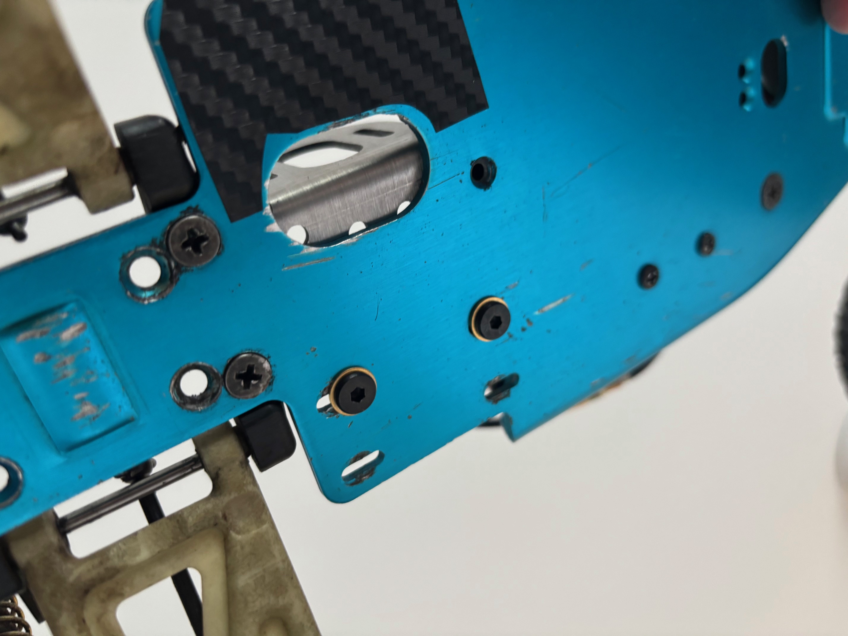

Got a good deal (or so I thought) on a chassis on eBay.
Should I try to straighten this or return it? The bend angle is identical to the protrusion in the tail. I am guessing it got stepped on or something similar.
- RogueIV
- Posts: 1190
- Location: W. Mass
if it was me, I'd just unbend it. heck it might even straighten out when you mount the transmission. I'd probably add a brace back there too if one doesn't already exist.
- Dangeruss
- Posts: 1525
- Location: Surf City USA
- Has thanked: 438 times
- Been thanked: 1441 times
Does anyone have one that isn't bent? I swear it was a factory option.
Jokes aside, I think the tweak was intentional so the bulge for the diff gear didn't hang down below the rest of the chassis.
- Posts: 52
- Joined: Wed Apr 16, 2025 5:27 pm
- Location: New Jersey
- Has thanked: 39 times
- Been thanked: 18 times
I’m probably being too picky. However, I do think it is supposed to be straight.
