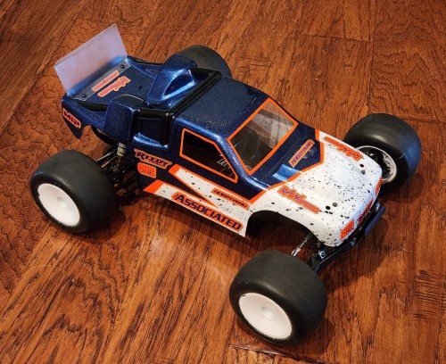

Done in my sons theme. Still needs to be stickered up.
Posts: 9240
Has thanked: 305 times
Been thanked: 415 times
Re: Blasphemous T2 retro racer
Stickers on. Some new, some old.
Not happy with the bearing seat tolerance on these wheels, not sure I'm going to be able to use these for long.
Interestingly, 3 sets of tires. JC Ellipse, PL M3 Cut'N'Shut and the JC Smoothie 2 LP. The CNS tires with custom pool noodle inserts were what we did to run diesel as sauce in 2012 era, but the smoothie LP is even smaller. We'll see how they are on track
