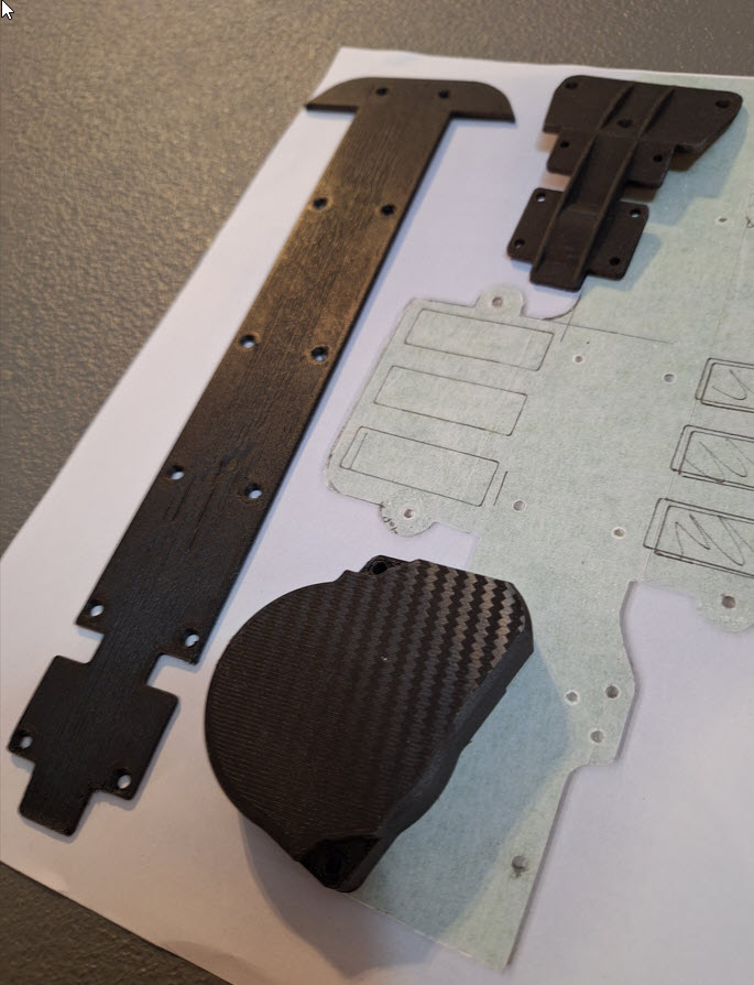

So after spending ages mucking around on fusion 360 i went old school on the chassis, scanned and printed it and been playing around with different ideas, because we can,
Its a hobby, after all, snd quite a lot of fun,so we can try stuff and bin it if it doesnt work.

When i got the car, it had both Maxima and mini mustang chassis.
Im getting some parts kindly 3D printed up by a contributor here so decided to morph them together and give it a bashing with the dremmel.
See how it turns out.
Also found a supply of MXL belts if anyone needs them, 318 teeth

Thanks again Dadio for the Printing.
Helping to rescue these old girls out of the attics and basements by sending parts across the planet.
Much Appreciated mate.

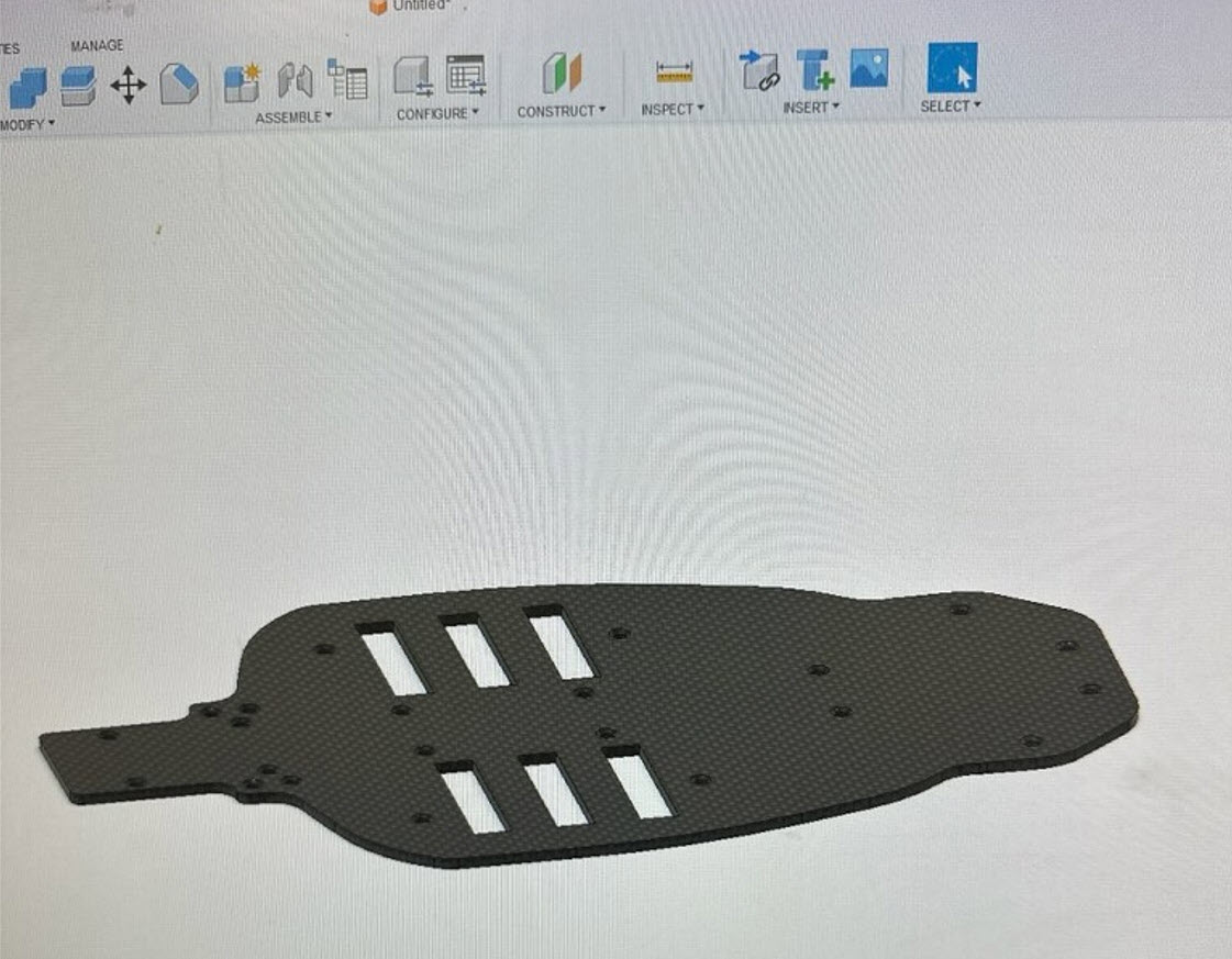

Finally delved into some Fusion 360, complete newb at this, seems so tedious when i could just draw it up manually, but getting the cutting file will be worth it.
Mine came with both the mini mustang and Maxima chassis, so been playing around with a composite of the two. Why not, its not like im sacrificing and rare or NOS parts.
