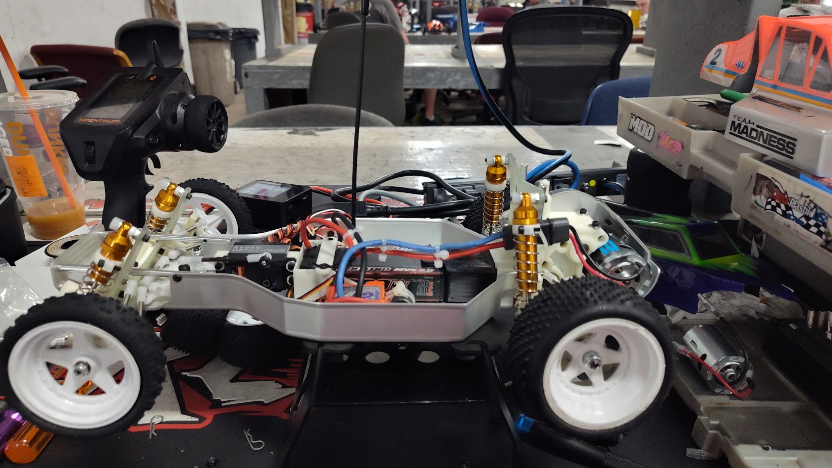

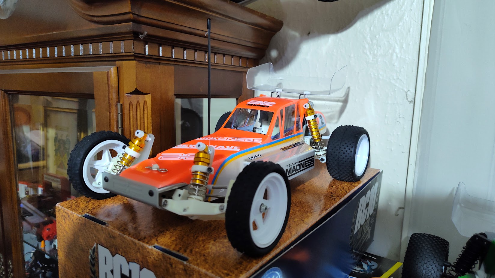

Good morning,
I recently completed the 40th anniv, of course i will be taking it to the track but i would like the option to take it to an indoor track. i seem to have trouble finding rear mono wheels that fit with carpet tires. apparently the RE RE has 1/4 stepped axles. and the j concept wheels are 3/16 straight axles. Could anyone recommend some wheels that fit? Thanks!

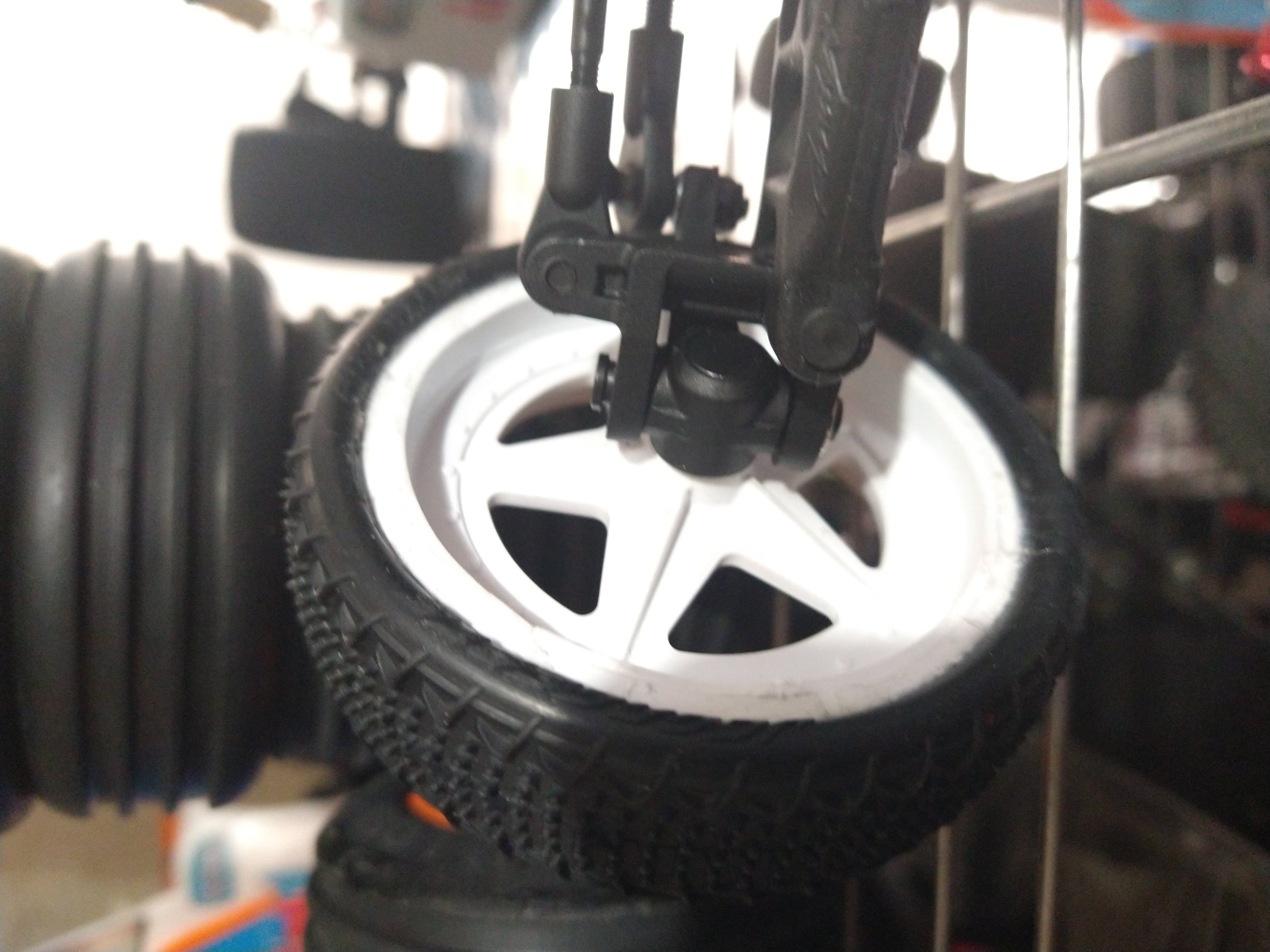

I use hex adapters in the rear (factory works make them, but I 3d printed mine) and run Kyosho Turbo Scorpion wheels. This requires 3/16x5/16x1/8 bearings (I use TRB-100494) for the matching front wheels but works well and keeps the car at the right width.
Front wheel I trim of the bead on the inside facing portion of the wheel to fit the modern narrow tires.Consistency is the key I keep misplacing.
