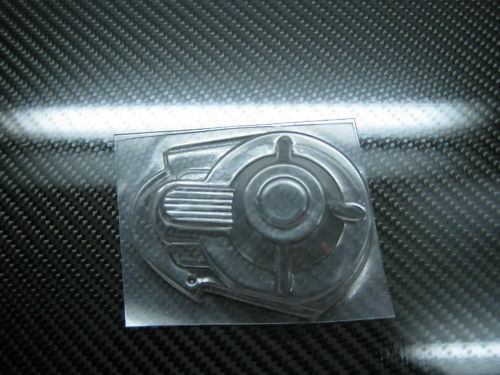

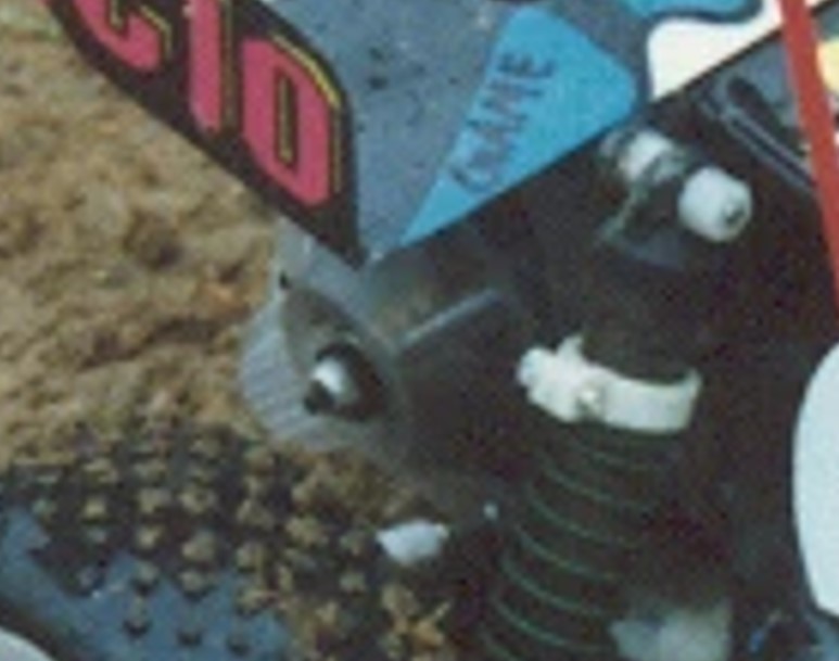

What gear cover did Brian use? Will the kit supplied gear cover fit over a Hydradrive or should we order the repop from TBG?
I'm not yet ready to build mine so I haven't yet opened the box nor have I rummaged around in the attic to find the Hydradrive.
I'd like to get the cover ordered asap if it's needed.

XLR8 wrote: Sat Jun 07, 2025 9:17 pm What gear cover did Brian use? Will the kit supplied gear cover fit over a Hydradrive or should we order the repop from TBG?
Nope no way the one in the kit will fit over a hydradrive. Not many pictures of the one Brian used but it appears he used a RC10T lexan cover like this https://teambluegroove.com/products/rc-10t-rc10t-rc10-rc-10-gear-cover-free-ship-w-body?pr_prod_strat=e5_desc&pr_rec_id=ab85ed1ae&pr_rec_pid=6713012912294&pr_ref_pid=6712985288870&pr_seq=uniform I don't know if it will fit or not because i'm not sue if the car had the hydra drive on when this picture was taken.
They have a hydradrive specific one too, but I haven't seen a pic with that style of cover fitted.

Me neither and I don't believe the 10T cover will fit over the Hydradrive.
I've just browsed Cedric's build again and none of the surviving photos show his car with a gear cover. However, he does mention "building" a cover.
I got my Hydradrive used and without the original packaging. Did the kit include a gear cover or was it sold separately?

No, the stock cover will definitely not fit a Hydradrive, nor will the one in the kit. I'm pretty sure I was told this, he actually used 2 of the stock AE gear covers. trimmed the tapered and ribbed section off the one that mounts to the motor plate, trimmed another to extend that section, and glued them together.
I need to look into that more...
