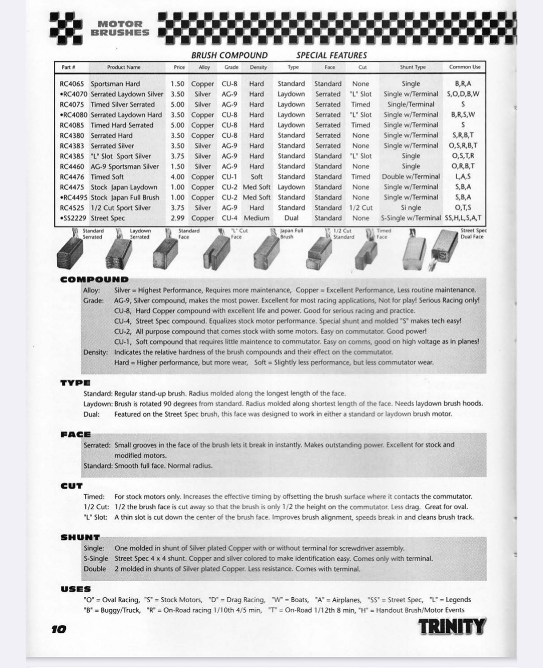

Here is a brush guide from the mid 90s.
Anymore, I put serrated brushes on nearly everything, with a medium spring. I want my motors to run pretty good, for a long time. I'd rather preserve my vintage motors instead of trying to get every drop off power out.

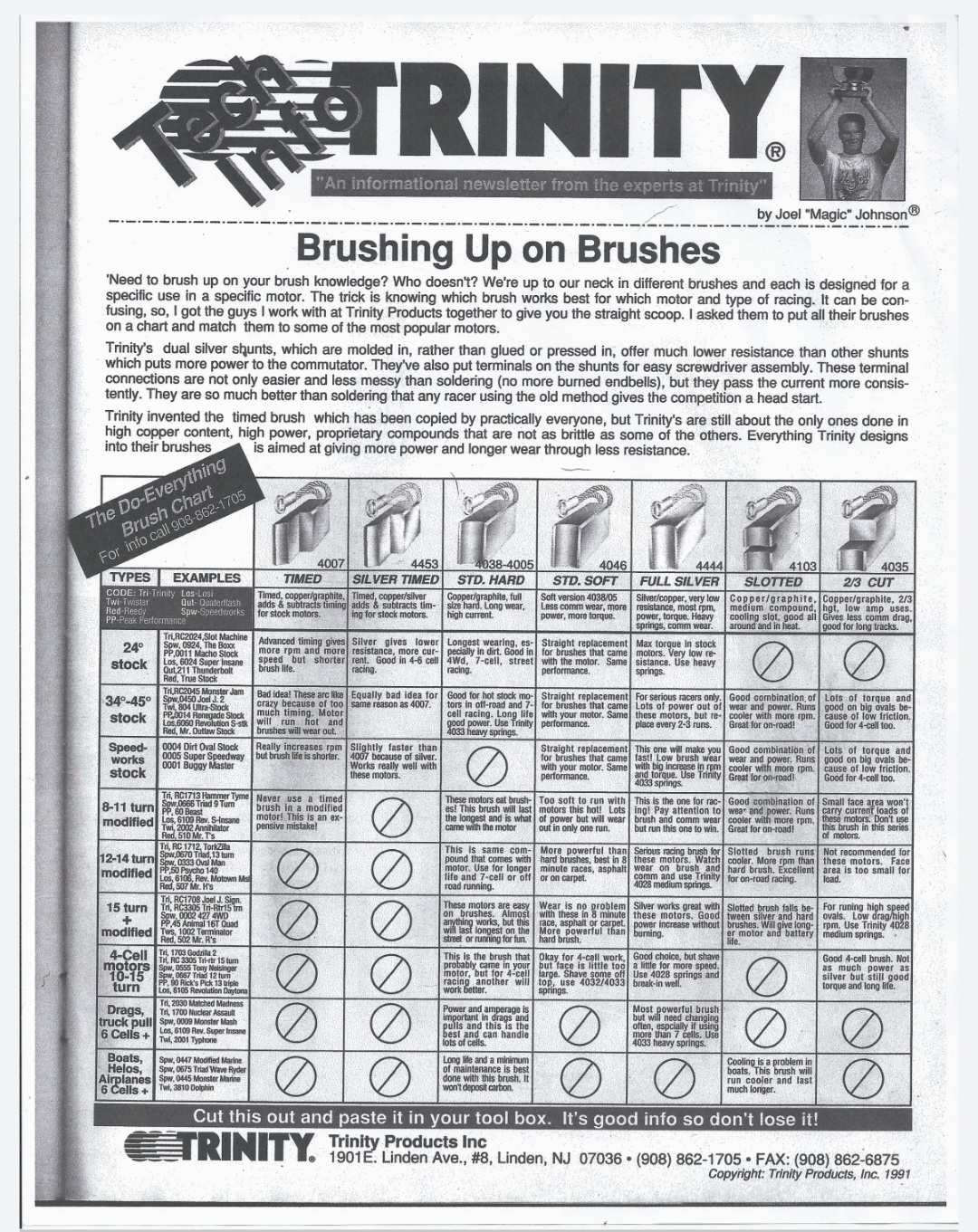

Here is another Trinity guide. It took me a little bit to find.
