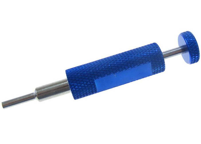

Recently I replaced a few antennas for old Futaba radios.
Never throwing out old parts, I stashed the broken antennas.
I also saved several Tamiya connectors with mostly cut wires and the terminal still locked in the connector.
I can get the terminals out but it always a PITA. Never bought a tool specifically designed to do the job.
Then put the two thoughts together.
Found that one of the antenna sections is ideal as a terminal removal tool and it works perfect. And it was free.
I already have several sets of new terminals and the proper crimpers so I'm good to go.
Chuck
Tamiya connector tool

Re: Tamiya connector tool
Lisle 56500 Terminal Tool https://a.co/d/6QRweNB
- RC10th
- Posts: 4761
- Location: Australia
- Has thanked: 52 times
- Been thanked: 1547 times
I used to do the same, use K&S tubing to get the pins out.... until I discovered this tool which makes life even easier !
