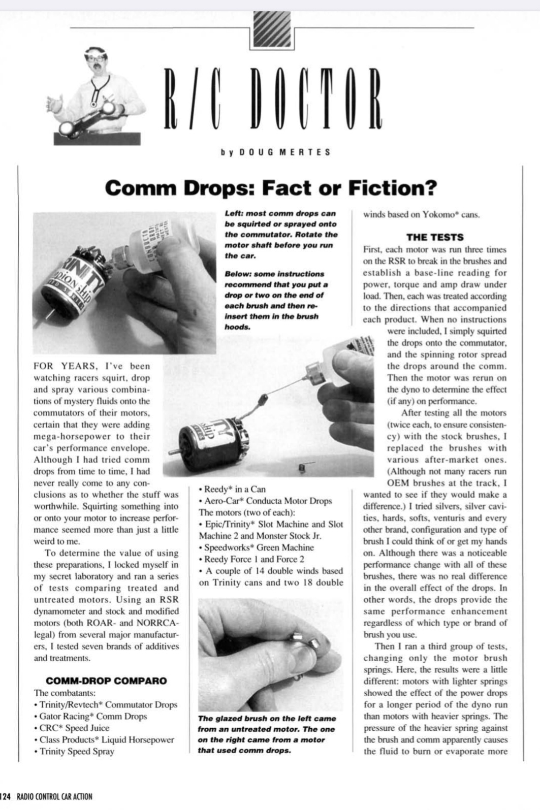

Dangeruss wrote: Tue Jun 03, 2025 4:27 pm Comm Drops increased electrical conductivity between the brushes and the commutator for more power/rpm. RCCA did an excellent article on Comm Drops back in the day... I'll post a link when I find the article unless someone else beats me to it as it was a neat read.
Found the article but for the life of me I can't get the PDF viewer to open directly to the correct page so... click either the image or the link below and it'll open the July 1994 issue of RCCA from the Library... then you can scroll down to "page 63 of 65" (page 124 & 125 of the actual magazine) to the "Comm Drops: Fact or Fiction" article...
https://www.rc10talk.com/library/?RCCA/1994#7-RCCA_1994_July.pdf

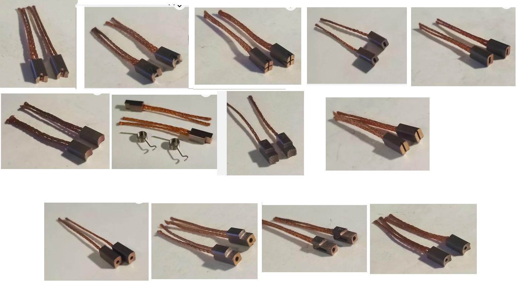

Swath wrote: Tue Jun 03, 2025 2:56 pm What's the theory behind cut brushes?
They were used for a variety of reasons, and any cut reduced the contact area on the comm which reduced friction to give you higher revs and more speed. The downside is it restricted current flow so you had less bottom end power. Because of this I usually used cut brushes in on road cars rather than buggies where you wanted the extra torque. I usually drilled a hole in the centre of my buggy brushes to give a reduced contact area while still covering the full width and length.

Stock motors have a fixed timing, the rules dictated how much advance a stock motor could have. By using timed brushes you advance the timing on the centre of the brush which will give you more speed but a higher current draw. So your 24 degree fixed timing stock motor would effectively be a 28-30 degree advanced timing motor. Small changes made a lot of difference when you are using 1200-1400mah cells.

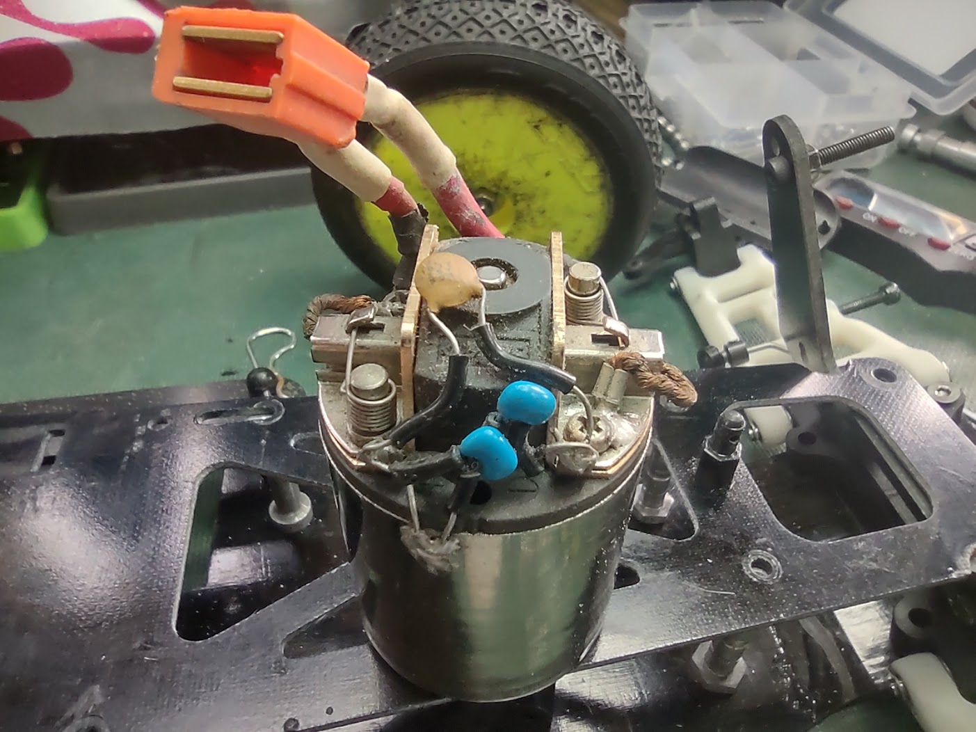

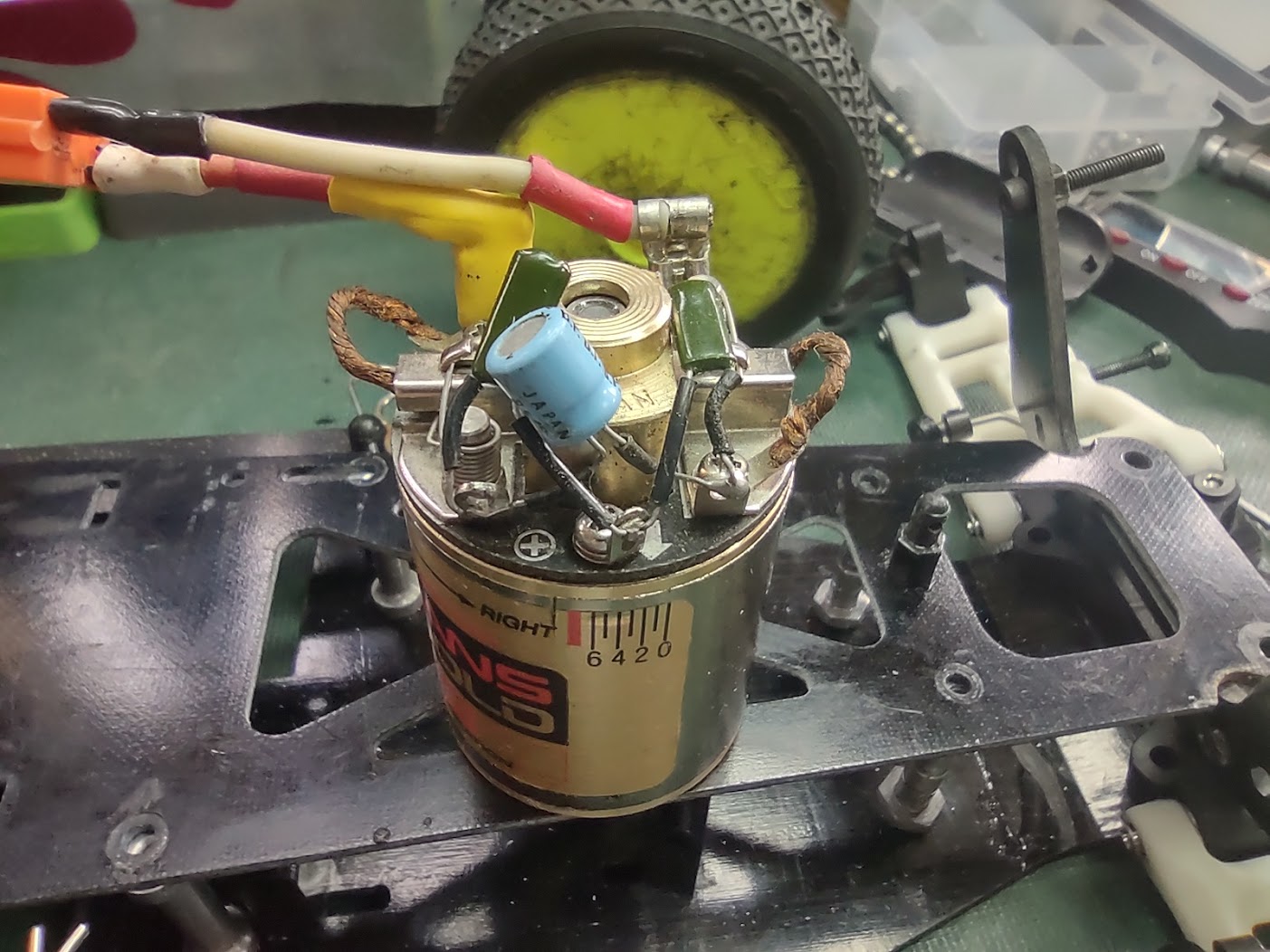

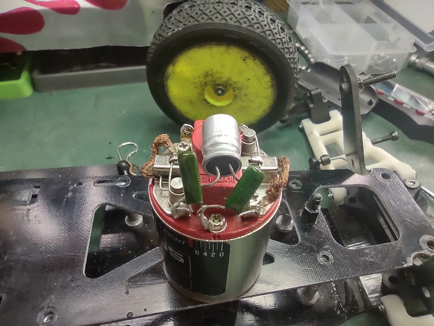

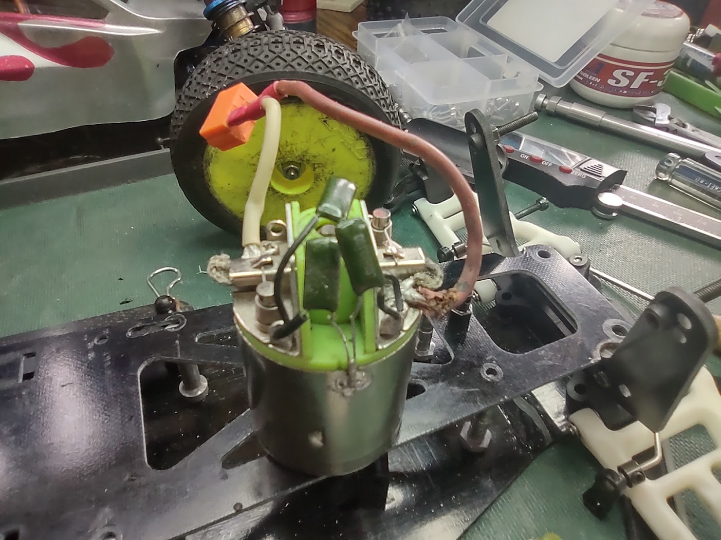

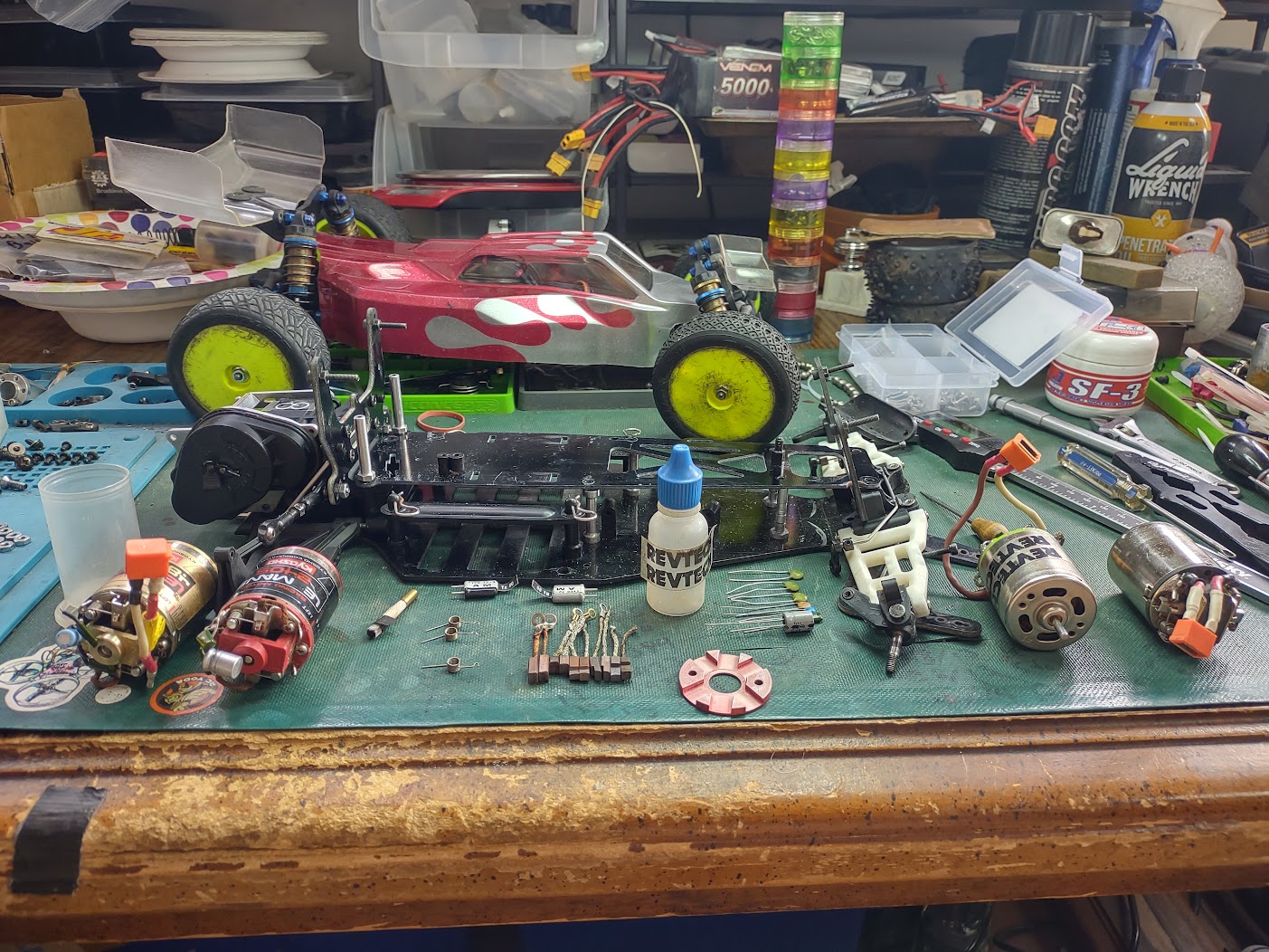

My question arose while I am rebuilding this Ultima Pro.
As I await the numerous parts to arrive so I can continue I began to ponder all the motor stuff from back in the day. (88-89 time frame)

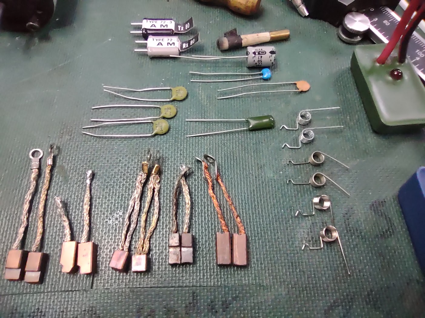

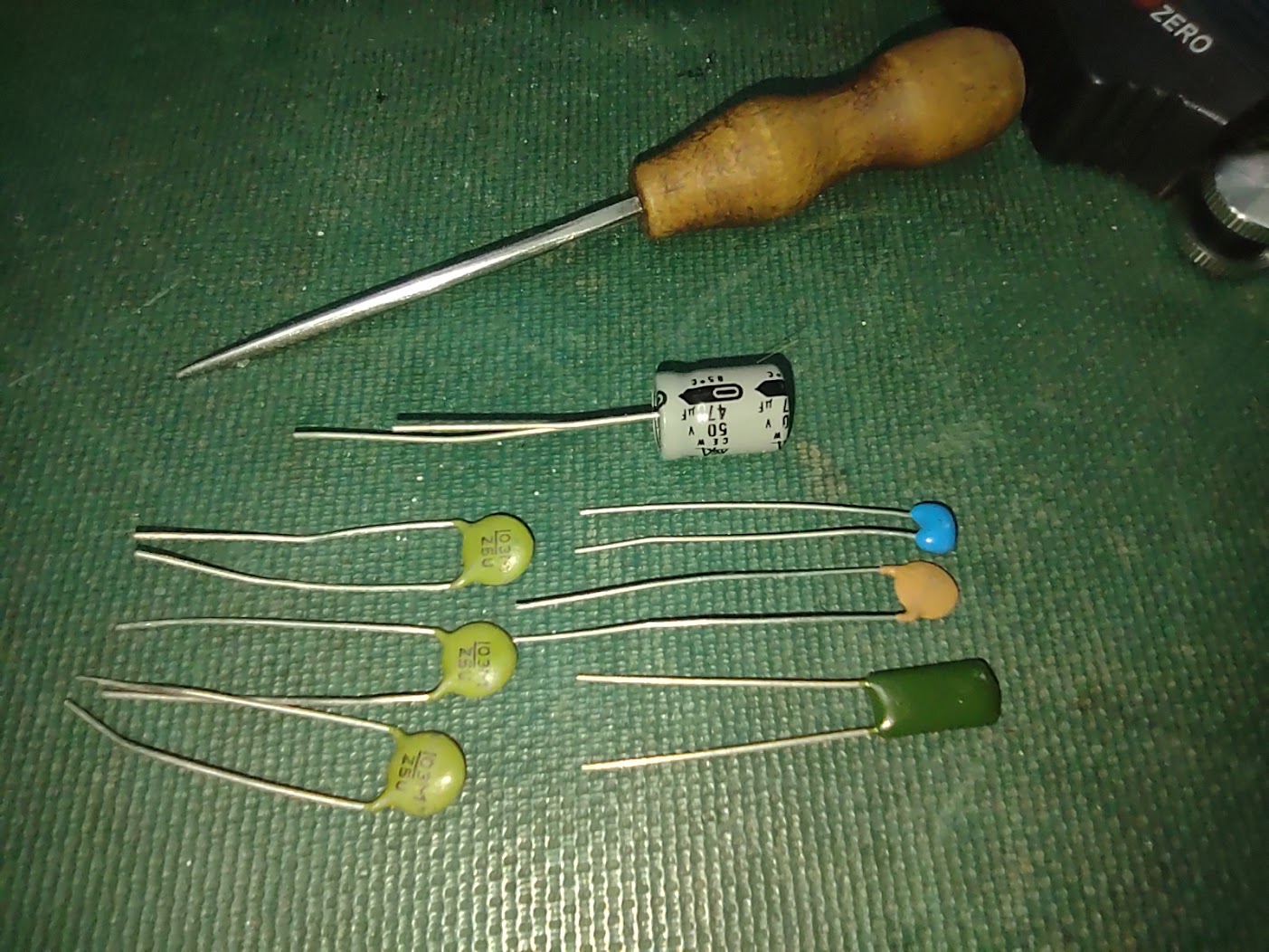

These diodes were never attached.
Does anyone know if they are all essentially the same? I know the big round one is the capacitor, but the rest seemed to be used interchangeably.

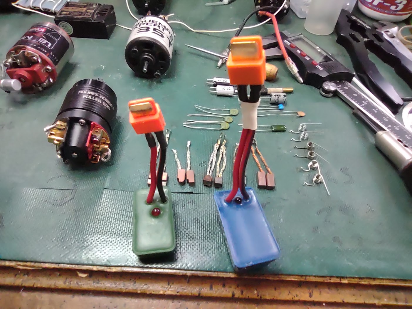

These next 4 pics are the 4 motors I used back then. I had some set up differently. It seems clear the capacitor should be soldered between the + and -. While the diodes? go from either the + to ground or - to ground.
But in these two stock motors I used just diodes. This was 36-38 years ago, my memory fails me on the why do it this way part.

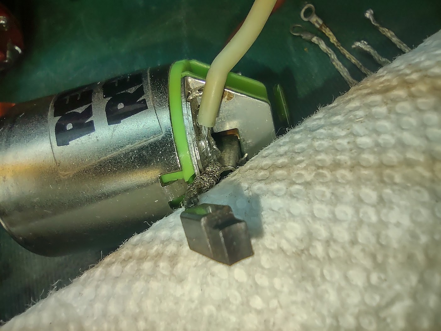

The brushes I used then, differing cuts, one for timing apparently, others just for the surface area change.
This one which is still installed in a stock motor is cut on two sides.
These brushes I found for sale on the net, I had no idea there were so many different cut types.

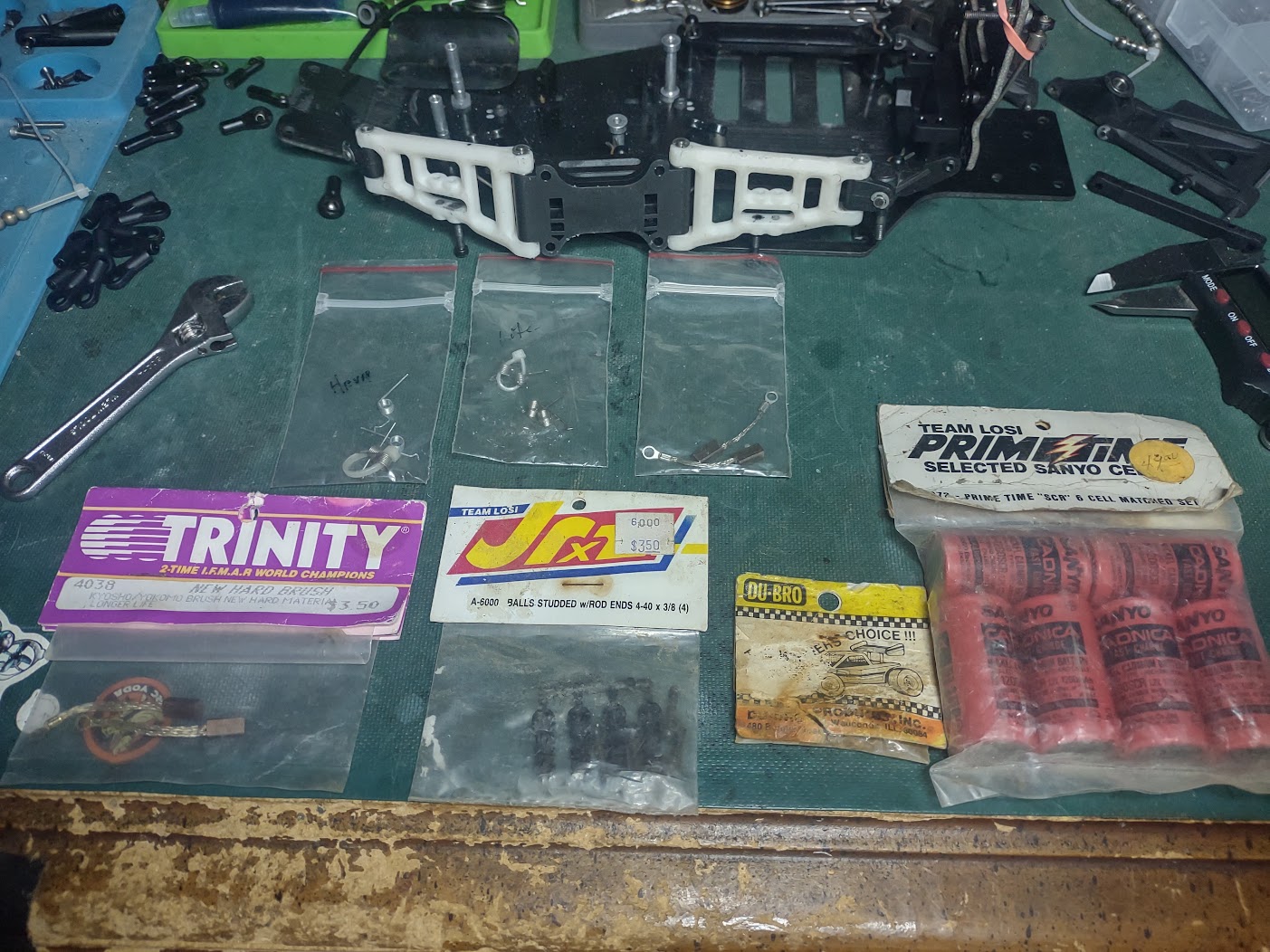

Some of the stuff still bagged from back in the day. A set of matched batteries for $49! I remember that being quite a bit of money back then. This was the first matched set I bought and never used them.

In that first photo with the screwdriver at the top, those are all capacitors. The large one is an electrolytic, which means it is polarized. It has a positive and negative lead and must be installed correctly. The rest are non-polarized and can be installed either way. They are interchangeable as long as they have the same ratings printed on the side. It is possible that the large green one has a different rating. Before folks started using electrolytics, they would often use the larger ones across the tabs in conjunction with 2 smaller ones (1 from each tab to the can). I recall the smaller ones being .01 uf, but don't recall the rating of the larger one (47 uf maybe?).
The "standard" layout is to connect 1 standard cap from the positive tab to the motor can, another standard cap from the negative tab to the motor can, and an electrolytic cap from the positive tab to the negative tab. For sake of appearance, I would use the standard caps in matching pairs.
There were no diodes pictured, but if you want to use one, it goes in parallel with the electrolytic cap. Diodes are polarized as well.

Swath wrote: Thu Jun 05, 2025 12:50 am These diodes were never attached.
The picture shows various capacitors, the round can one at the top is an electrolytic while the others are ceramic.
All the smaller ones can be used anywhere on the motor, but the electrolytic one is directional. This can be used across the brushes on a motor, only if you have a forwards only speed control. If you use it on reversing speed control, when you select reverse you short out the capacitor, usually the capacitor will blow before it does any damage to the esc though.

terry.sc wrote: Fri Jun 06, 2025 11:21 am All the smaller ones can be used anywhere on the motor, but the electrolytic one is directional. This can be used across the brushes on a motor, only if you have a forwards only speed control. If you use it on reversing speed control, when you select reverse you short out the capacitor, usually the capacitor will blow before it does any damage to the esc though.
That right there is a critical bit of information, thanks!
