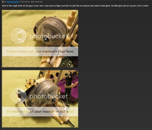

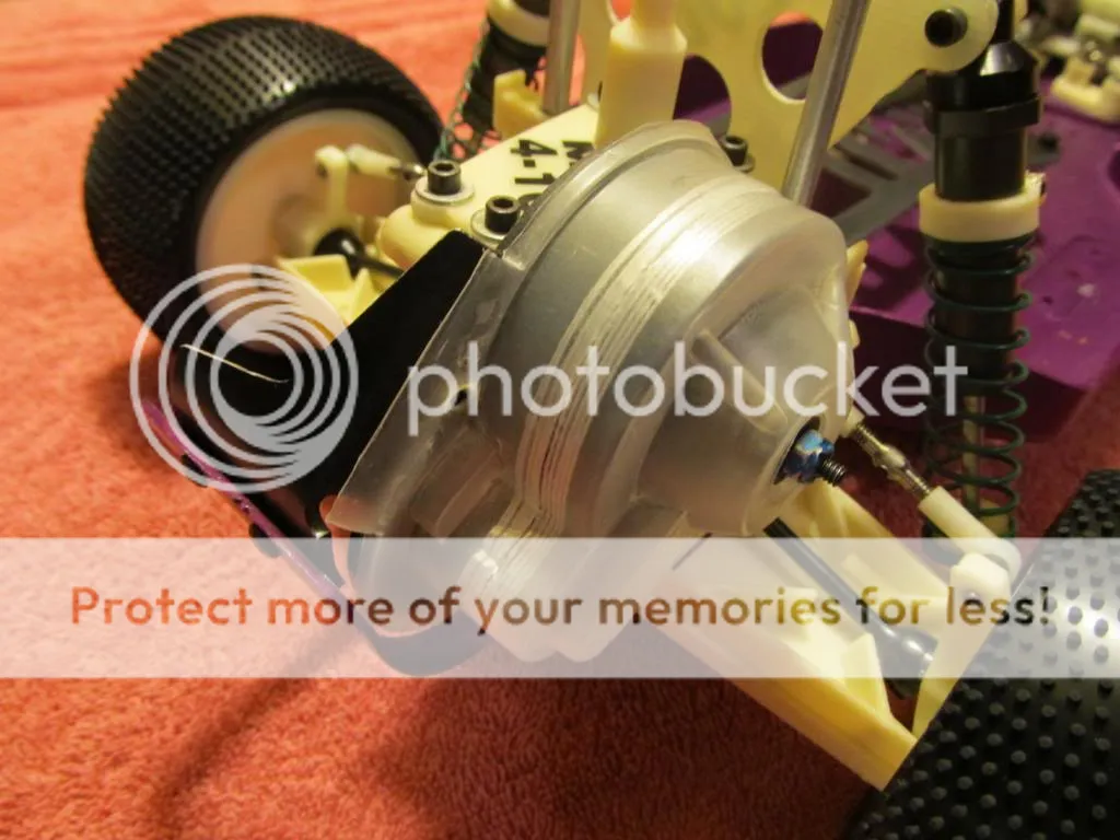

scr8p wrote: Sun Jun 08, 2025 12:14 pm I was debating making a part 2 to my video to address a few things. The CVDs being one, and maybe a few detail RougeIV mentioned like removing the ano on the back end of the nose plate. But also in regards to the gear cover.
No, the stock cover will definitely not fit a Hydradrive, nor will the one in the kit. I'm pretty sure I was told this, he actually used 2 of the stock AE gear covers. trimmed the tapered and ribbed section off the one that mounts to the motor plate, trimmed another to extend that section, and glued them together.
I need to look into that more...
While looking for something else I came across Vintagemishal's thread about the MIP car resto that also ran a Losi Hydradrive. This is likely what most of the RC10 drivers were doing when adapting the hydradrive at the 93 worlds.
https://www.rc10talk.com/viewtopic.php?p=357929#p357929
looks a little better with strapping tape.

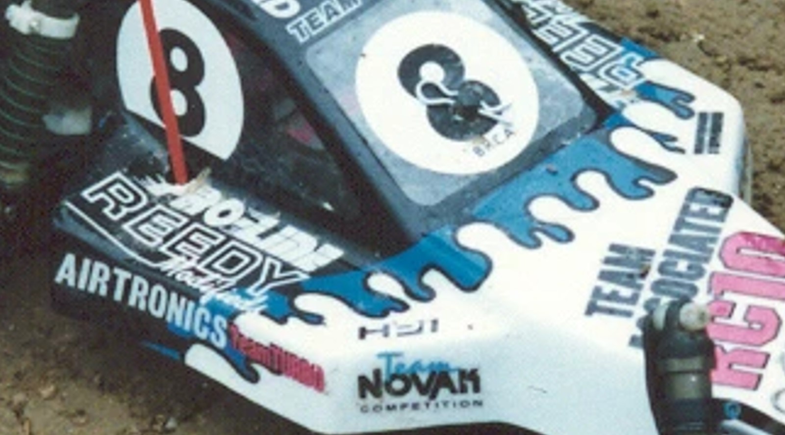

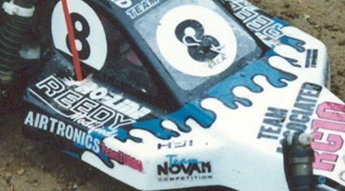

I'm going to mention this loudly:
The BOX ART is not correct!!
There I said it. Biggest take-away here with the paint is that the drips on the actual car are much shorter, Also there are 7 distinct blue fields on the car. 1 Central and 3 on each side of it, decreasing in width. The lower ones only have around 1/4" visible from how the body was cut.

DSaw78 wrote: Mon Jun 09, 2025 2:36 pm Unless I missed it, one small thing left off the list are the black e-clips. The kit comes with the chrome ones.
