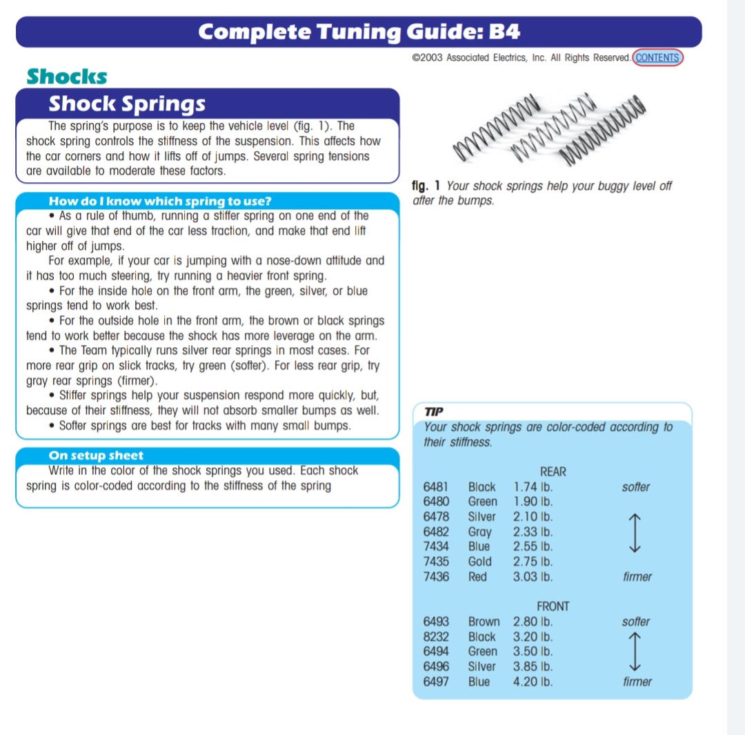

I am in the process of completing my FanRc Worlds and am curious to know what spring options exist for these shocks. Are there any recommended packs with a range of tensions to experiment with?
And while I’m on shocks, what weight oils are people using?

Re: Spring options for .76 and 1.32 shocks
Here are the original spring rates and part numbers. I see them all the time on Ebay.
