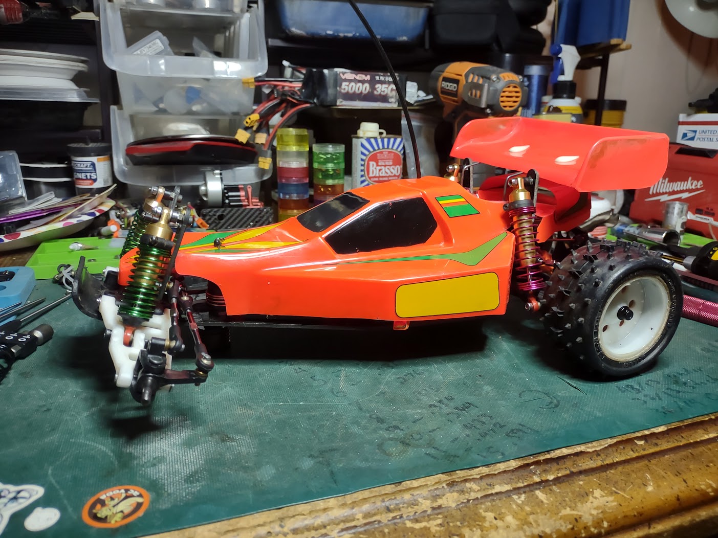

Swath wrote: Sat Jun 07, 2025 4:43 pm I didn't notice back then but the shock tower is different than stock. Not sure if that was a mistake or supposed to be an improvement. I'll try to use it as is but the link connection holes are a bit different, this will cause some different dynamics, the mounting holes to the bulkhead are correct. Not like I'll be going to any nationals anytime soon.
The top shock mount is the Kyosho standard tower for fitting gold shocks. The lower mount is a third party item, the bottom is shaped like the original Ultima alloy shock tower for the red shocks, made taller to fit gold shocks. The top is shaped like the JG towers, but the lower section is different on a JG mount.

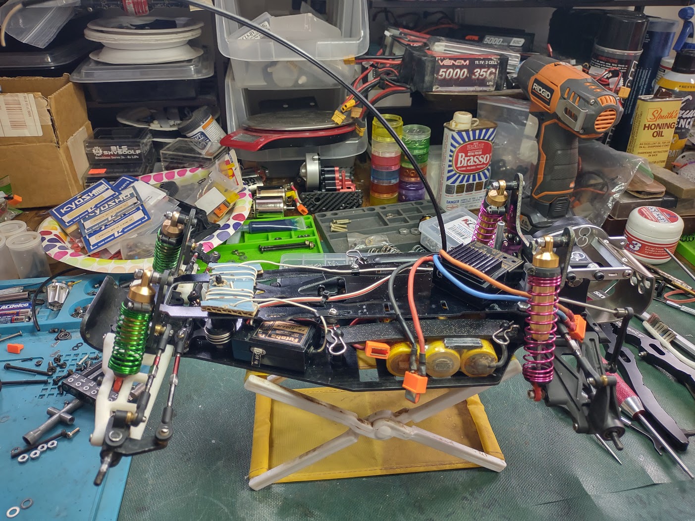

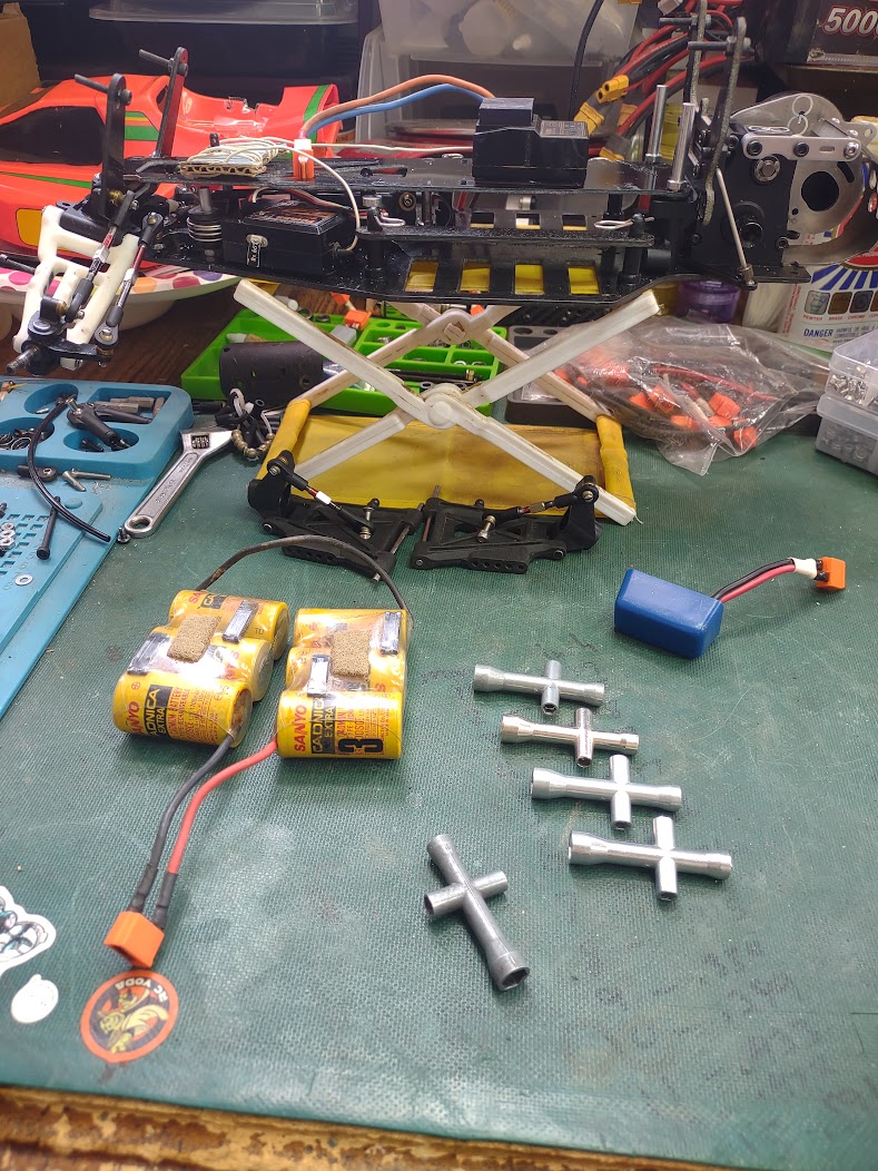

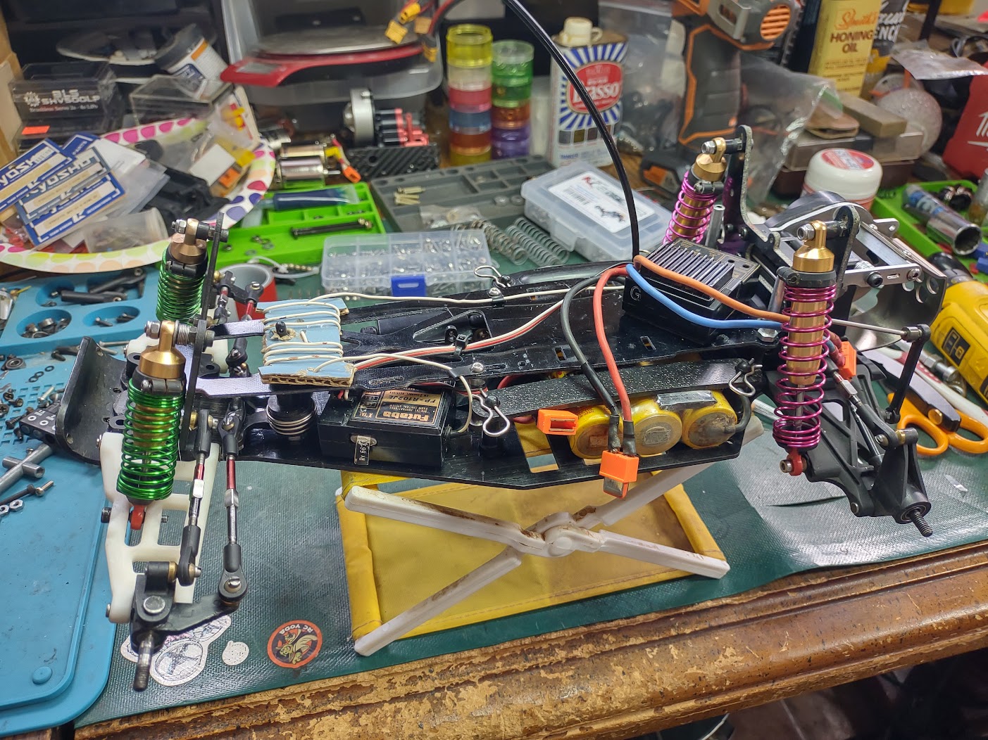

Re: Ultima Pro Restoration
Post by Swath »
I still have a few critical bits to get in via snail mail. But it is nearing completion. I still have to build the shocks, I just wanted to get a fitment done to verify I have all the parts needed. I still need springs, the rears may be ok but I don't have the short fronts, the ones on there are a set of rears I cut a couple loops out of just for a dry run of things. I have not found a single front tire in my batch of crap! Kind of weird, they got misplaced somewhere, perhaps I need to revisit my shed.
The star tool by itself is the one that came with my kit back in the day. Interesting they still make and include them. The vintage one has no markings, the newer ones identify the size of each end.

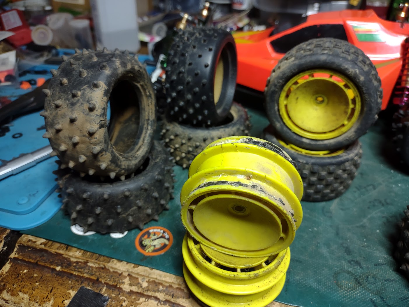

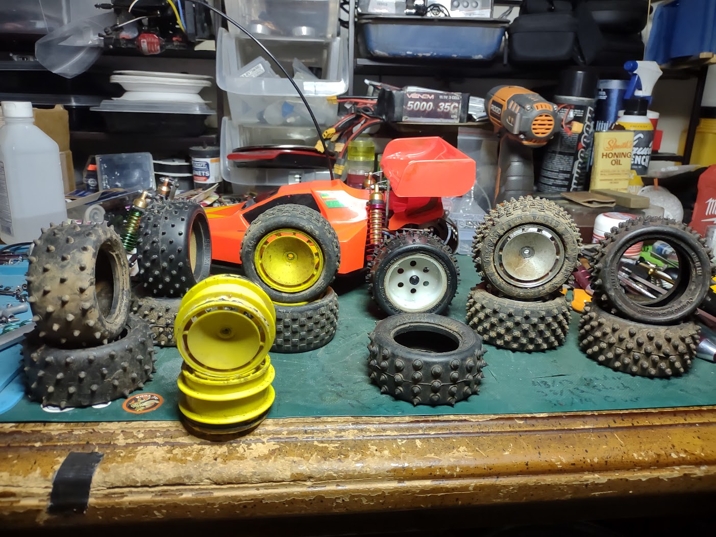

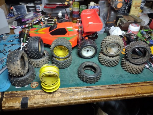

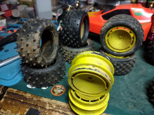

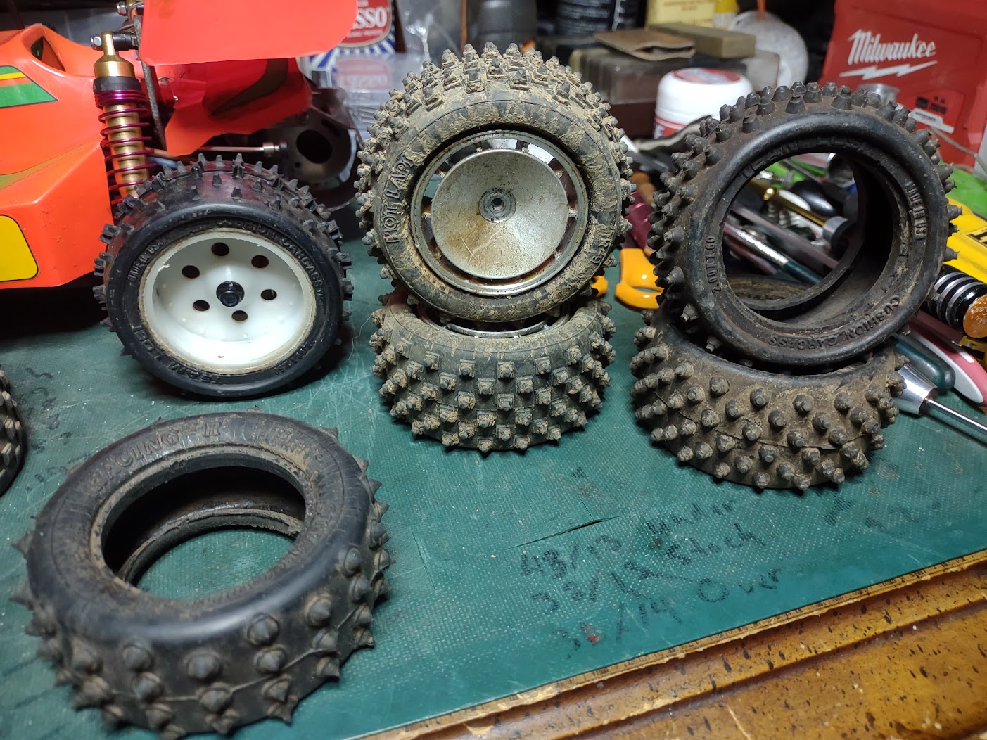

Tires from the period:
Posts: 3533
Has thanked: 268 times
Been thanked: 2090 times

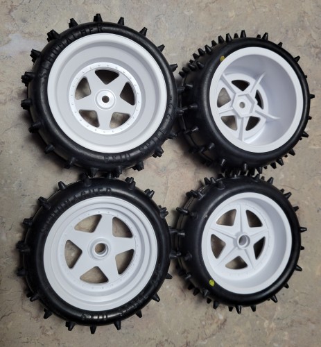

Why not a set of modern 2.2 tires and wheels?
These wheels are from the re-re Turbo Scorpion, and the tires are Schumacher. The rears are 12mm hex and the fronts are regular bearing mount.
Post by Swath »
juicedcoupe wrote: Sat Jun 14, 2025 1:51 am Why not a set of modern 2.2 tires and wheels?
I'll be running it on a clay indoor track initially so I will put some modern tires on it designed for that. For sitting on the shelf it needs some of the knobbies.
