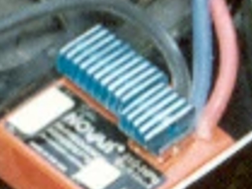

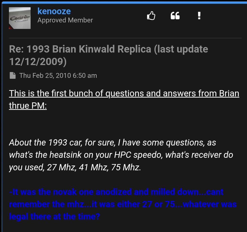

Pretty sure this was the heatsink BK used on the Novak 410-HPc. I remember seeing them back in the early 90's, but haven't seen one since. Looks like he just shaved the top of the hexagon off.

Tang wrote: Sat Jun 14, 2025 10:19 pm Pretty sure this was the heatsink BK used on the Novak 410-HPc. I remember seeing them back in the early 90's, but haven't seen one since. Looks like he just shaved the top of the hexagon off.
I thought the ones he used were more like an oval i could be wrong though, really hard to make it out in the pics.

RogueIV wrote: Tue Jun 17, 2025 1:45 pm
I could certainly be wrong, too. The one decent shot at the right rear of his car isn't in high enough resolution to see it clearly. I remember seeing oval ones back then as well. I even remember the hole through the middle with a tube like connection between fins. I'm on the hunt, but can't tell you the last time I saw either.

Dirtburner wrote: Fri Jun 20, 2025 7:04 am
I guess that answers that question!
But I also I think it might be a misremembering. Looks like its a heatsink with the hole through it, a round central area and is also wider than a stock Novak heatsink.
