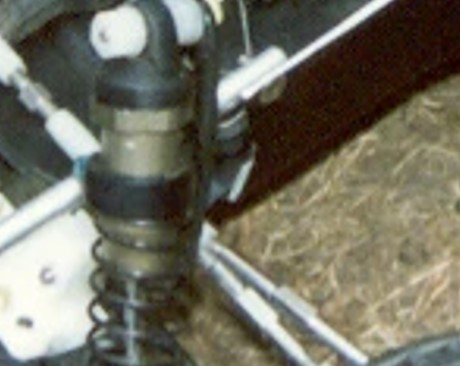

Need black eyelets, perches and clamps for the front shocks.

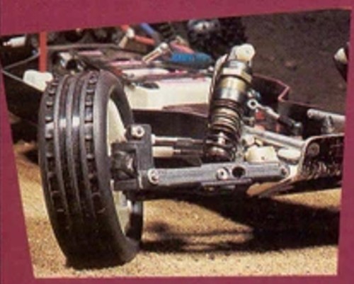

Front #1 pistons, .060" internal limiters. 30wt Black Springs. Mounted to outside holes on arm.
Rear #1 pistons, .090" internal limiters. 30wt Green Springs. Mounted to outside holes on arm.
Note about this magazine article, it states that he towers have more than 1 set of holes, I can't tell if these were added after the race or if these exist at all as the pictures in the article are too grainy for me to see any other holes.

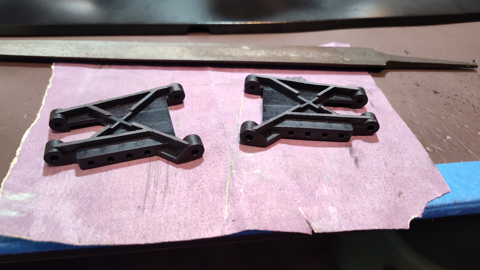

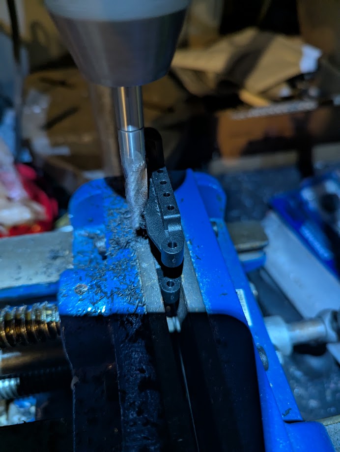

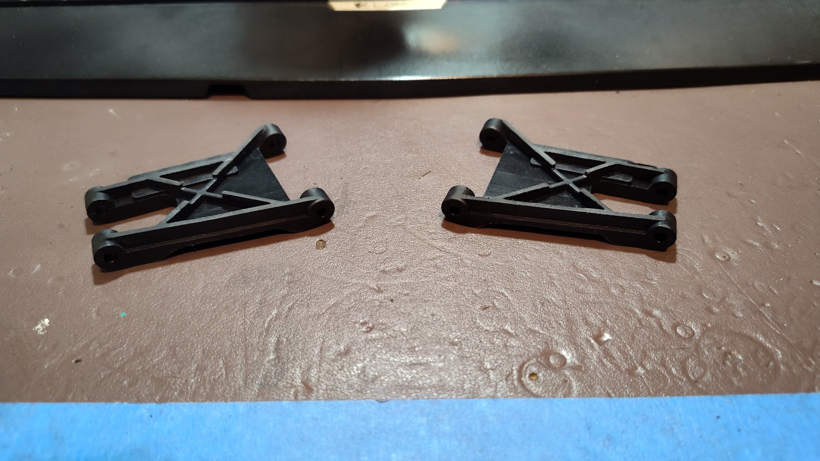

After work today I finally started to actually get to work on the car, starting with the "machine" work. I use that word lightly as I do not have a machine shop, but I do have a crappy, old drill press, an endmill, and a ramshackle cross slide vise.
First up - The rear arms

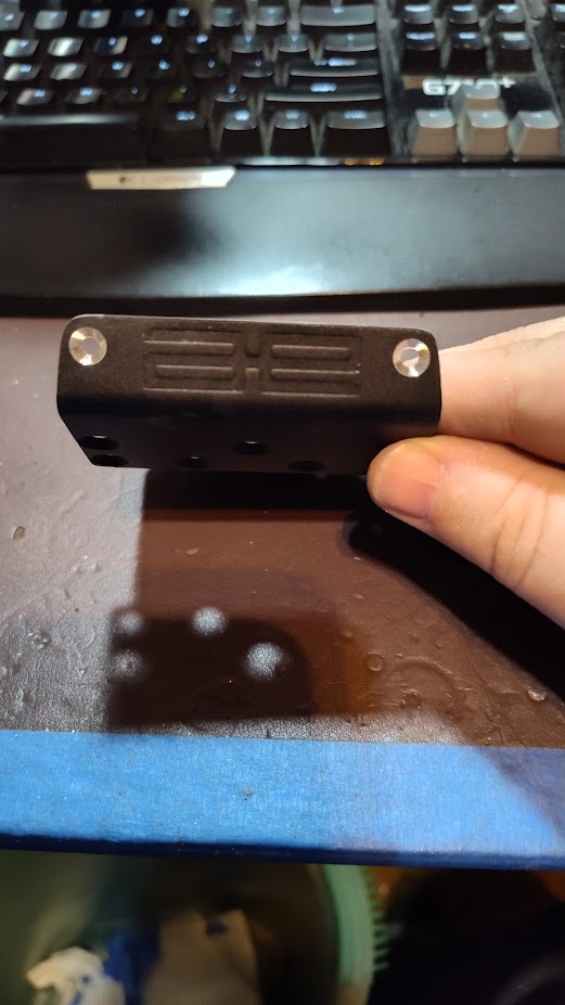

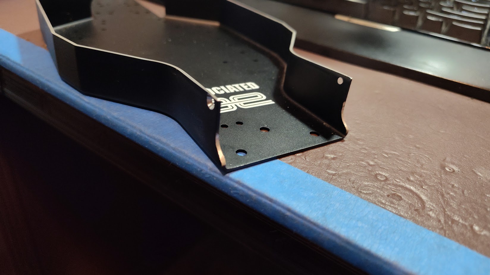

Added the missing countersinks to the chassis along with reshaping the front of the tub. I also went over the and cleaned up the factory machined edges with fine sandpaper to get the edges more consistent.

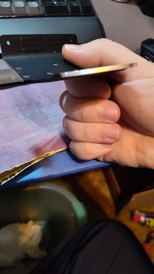

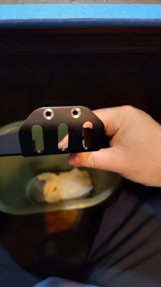

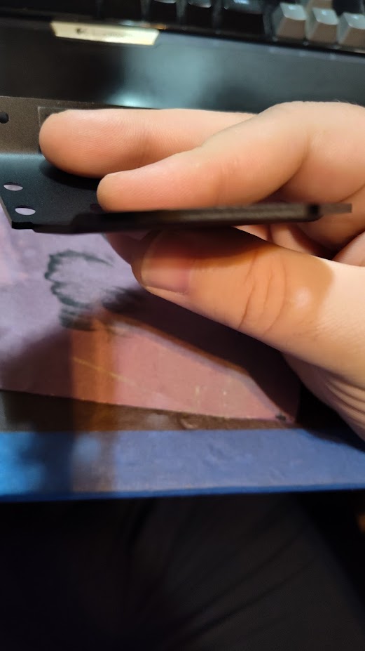

Next is the noseplate. While the factory machining looks nice on this it's not contoured like Brian did. Also, the back side "Worlds cut" isn't machined. Since the back of it is uneven from being cut via a punch smoothing out with a file first was needed, then followed up with some 320 grit. Nose contour was also done using a file as I trust it more than a Dremel, and it's only aluminum.
