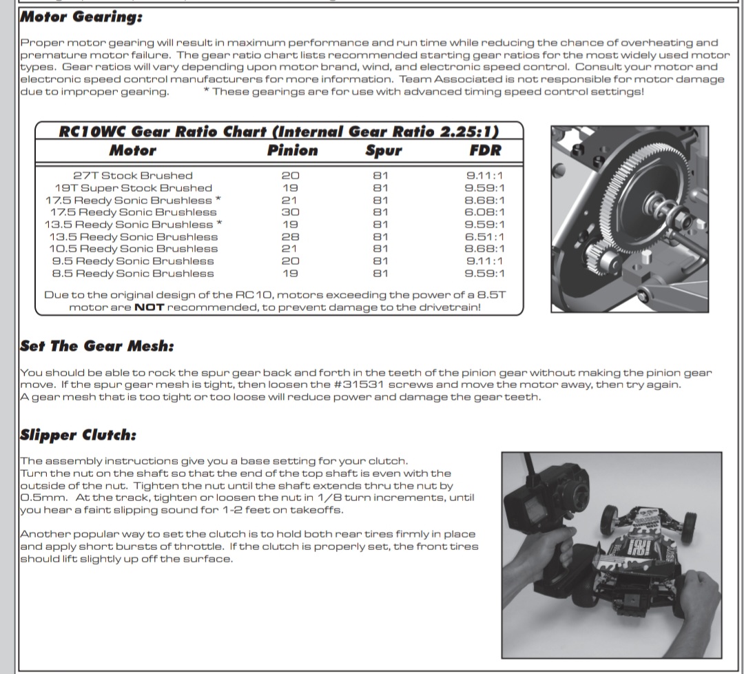

Here is the gearing chart from the 2014 Worlds car.

Interesting link…
So 19,20,or 21 should fit in the small range and 28-30 in the larger.
I did not know I was restricted until I tried to fit one.
21 or 30 recommended for the 17.5 with a * by one.
I think I’ll experiment and get one of each.
Thanks

Post by RC10th »
21 is for dynamic timing
30 is for blinky
For 17.5 that is....

6.08 FDR? Man.... I'm at 5.61 FDR at 43* on a Trinity Slot 2 17.5 with a 30mm fan and with NC summer indoor racing (no AC at our track) I'm under 140F on the motor in a 6 minute heat. They're gearing conservatively. That B4 slipper plates setup takes a 72T spur easily and opens up gearing options

I’m using a Justock esc / motor and if I race it will be in restricted classes so blinky it is.
Having said that there is talk of switching to 13.5 so I may get the 28 as well and see what difference, if any, I notice when it is on my 17.5 while practicing.
