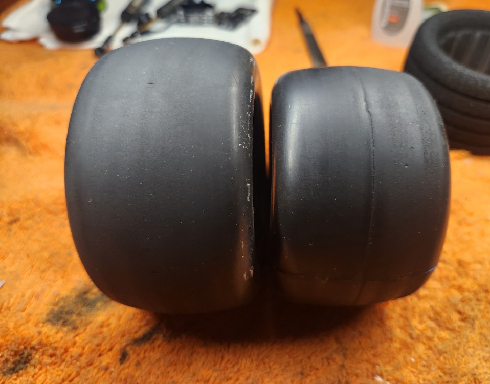

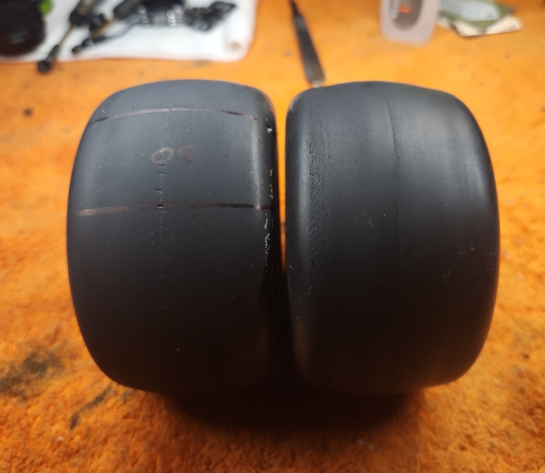

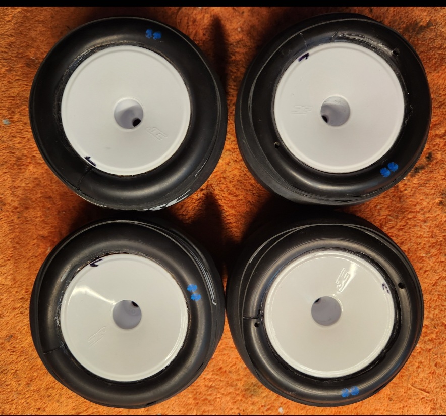

Making a lower profile 2.2 Stadium Truck tire by removing 30mm of tire, then gluing back together to lower the tire profile and decreasing ride height by 2mm
See, I wouldn't have picked that... as I would have thought, for the same size rim, the tyre would no longer fit all the way around the rim bead.
Learn something new every day.... witchcraft!

Off the rim, then mounted on the rim. Pretty crazy how much the tire and the closed cell foam conform

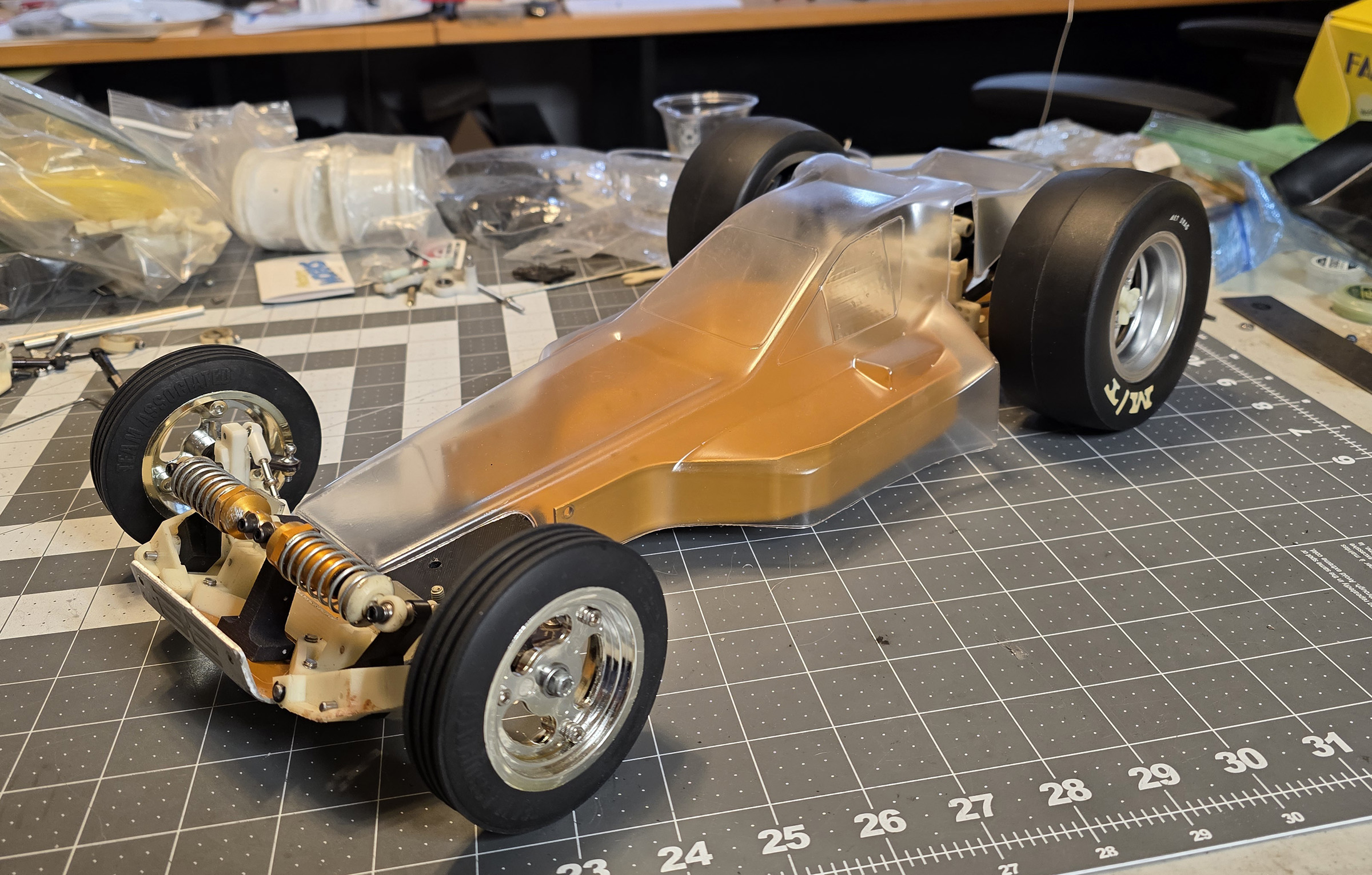

I have 4-5 open builds that I should be working on, but for some reason, this stupid B1 dragster is using up most of the partition space I have set aside for RC in my head. I think I have the front mocked up, but the rear is going to be a whole new ballgame. The front is kinda a printed Mcallister kit, but the outer arm/shock mounts are at a completely different angle due to running the arms at a completely different angle. I still need to work out trying to get a sway bar kit in there.

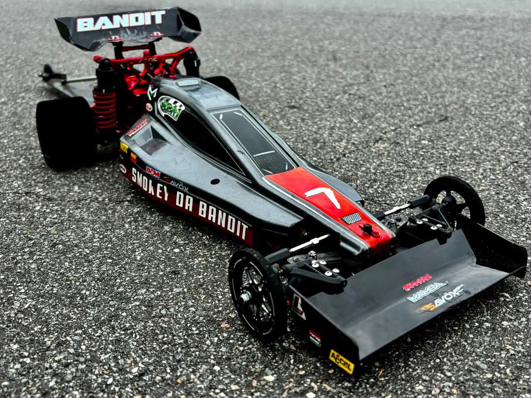

Not a secret at all! I 100% want an AE RC10 B1 version of a Drag Bandit! :D This pic popped up on my FB a few weeks ago, and yep, in my head since! :wink: For now, I don't want to swap to a pan car front, with "appropriate" tires. I want this to be more a buggy conversion. More along the lines of the Drag Slash movement, that lead us to the popularity of drag racing today.
