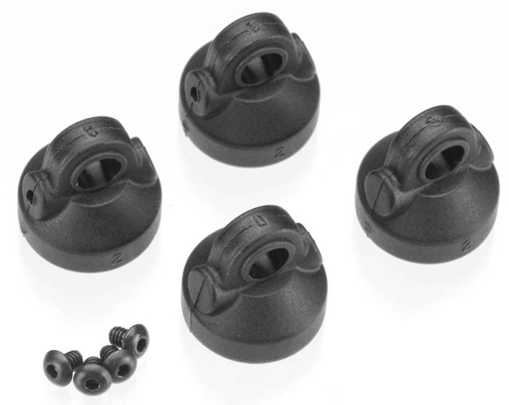

What do your shock caps look like?
The ones above were a running change by associated. They make it much easier to bleed the shocks.-

Mine do not have the bleeder screws. They are just solid black.
Are those caps available for the old shocks?

I just did a quick Google search and found those shock caps.
You sir, are my hero.

While I like the bleeder caps, you can do it without them.
