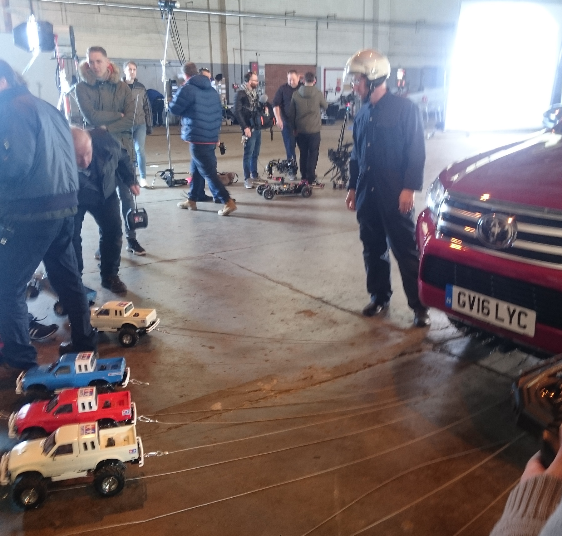

GreenBar0n wrote: Thu Jul 03, 2025 1:24 pm You built those Bruiser's for that commercial?? Very cool! Was the stunt driver in the Toyota just having a laugh with that crash helmet? :)
We nicknamed him Mild Willy on set. :lol: Also notice the HPI Baja camera car.
There was a team of us who built them as they needed them built and ready within two weeks. The only modification to the trucks was adding some weight under the camper on the body to help traction.
