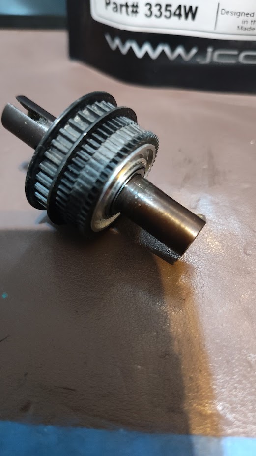

This actually happened last weekend but yeah, when they say the stock diff gear is made of butter on the Optima Mid rere they weren't kidding.
Car only had about 5x 5min runs on it with a 13.5 on turf. Slipper was set properly.Consistency is the key I keep misplacing.

Yup, those ball diffs have no durability at all. The only way to not strip them is if you are maybe running a silver can motor or set your slipper loose enough so it is screaming all the way around the track. The actual plastic they use is just simply not right for diff gear material, especially with a narrow metal idler gear. Grab a set of gear diffs and then you can really push the rere optima/mids and ultimas to the limit!

Yeah already have the parts on order with my LHS. Sure would be nice if they just made it as a kit though, having to order 3 different skus to make a whole diff is annoying, more annoying that they don't list it in the manual for the Worlds. The car is capable of keeping up with the modern buggies though, aside from this.carloco8 wrote: ↑Sat Jul 05, 2025 8:41 pmYup, those ball diffs have no durability at all. The only way to not strip them is if you are maybe running a silver can motor or set your slipper loose enough so it is screaming all the way around the track. The actual plastic they use is just simply not right for diff gear material, especially with a narrow metal idler gear. Grab a set of gear diffs and then you can really push the rere optima/mids and ultimas to the limit!

Unfortunately I started with the regular optima mid kit so I wasted money buying the ball diffs as an option part only to then go back to the stock gear diffs LOL. Agreed the chassis definitely has some good pace and if you trim the gear cover a little bit you can fit big bore shocks on the rear as well.
