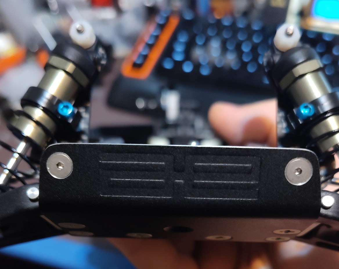

Next is the noseplate. While the factory machining looks nice on this it's not contoured like Brian did. Also, the back side "Worlds cut" isn't machined. Since the back of it is uneven from being cut via a punch smoothing out with a file first was needed, then followed up with some 320 grit. Nose contour was also done using a file as I trust it more than a Dremel, and it's only aluminum.
reference pic

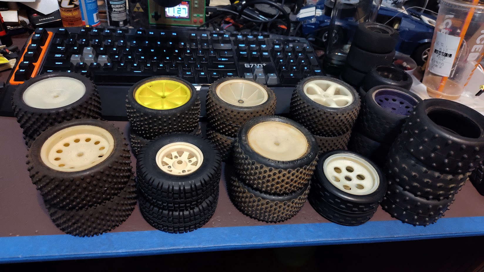

I saw a lot of tires on ebay that had a pair of flat stubbies. It actualy had 2 pairs! granted at least one of them has a messed up bead. Bunch of other interesting stuff too. will be pulling the tires off of the wheels over time.

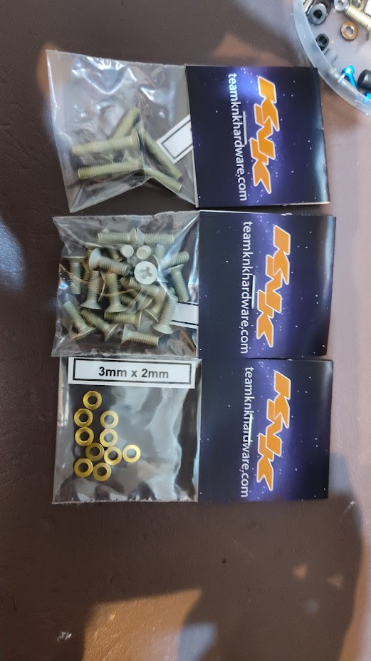

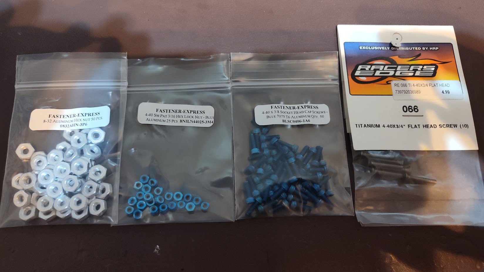

Also got an order of KNK screws, Some Aluminum hardware from Fastener Express, and 2 bags of Racers Edge Titanium 4-40x3/4 FHSC screws.

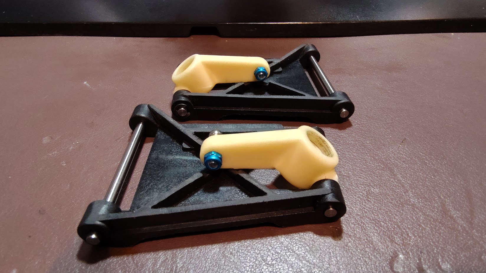

The KNK screws are great, these are very pale yellow. Honestly I do with they were slightly darker. but its either these or I use a bunch of old fasteners. I'll just stick with he slight color variance as it honestly doesn't matter that much.
The fastener express stuff is OK but the small pattern 4-40 lock nuts are a bit of a letdown. The blue anodizing is inconsistent and I had to prethread them onto a screw before using them on the ball studs because they refused to thread on straight because the nylon insert was too tight. The other stuff seemed fine though.

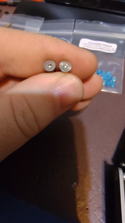

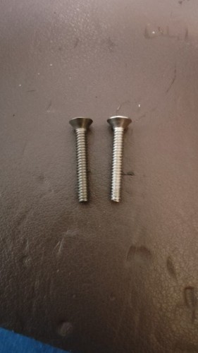

The racers edge screws I got were a chance crossing, they were cheap enough and work quite well. I'll be using these throughout the car, cutting down some to go into areas that doesn't require the length.

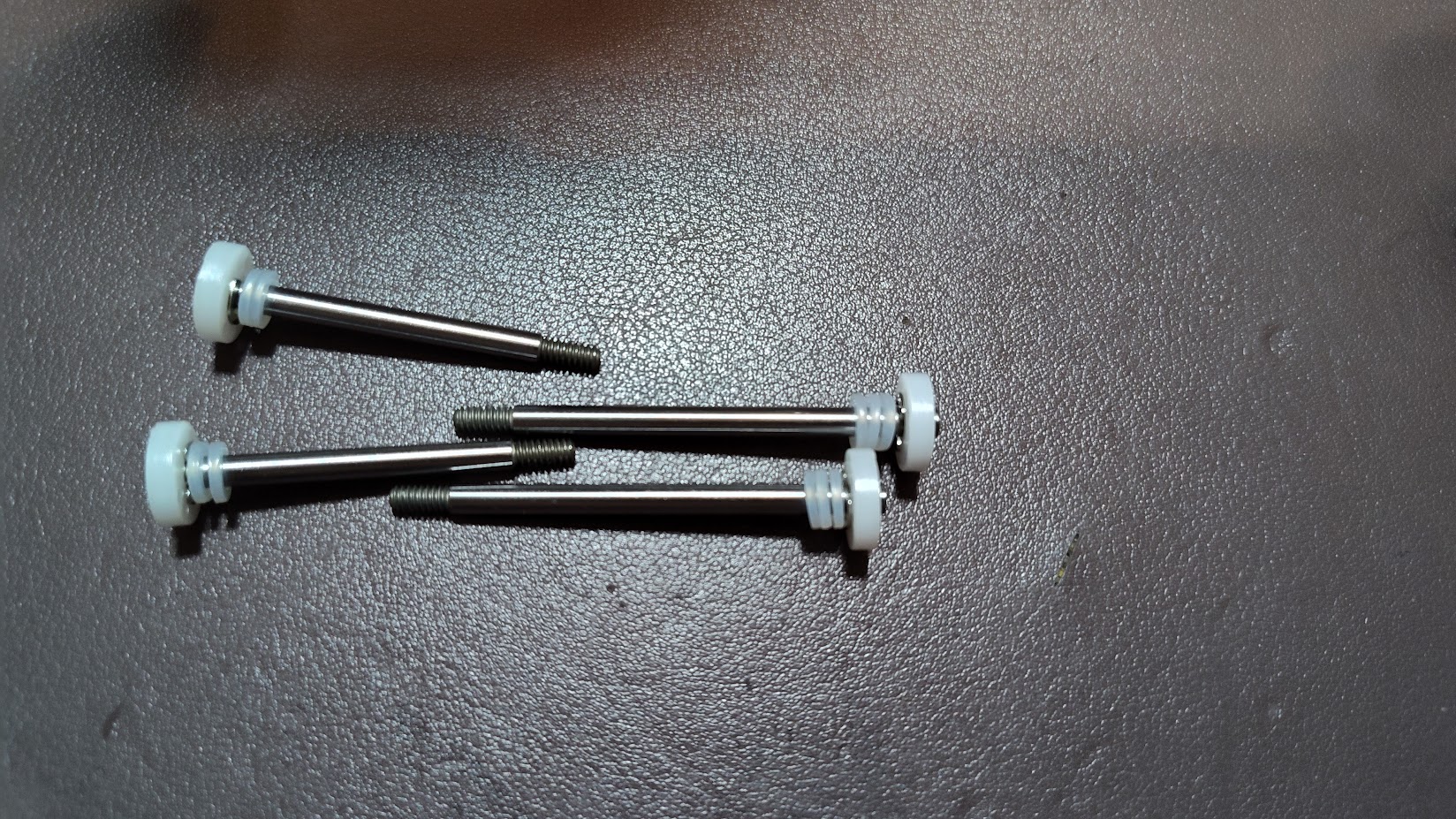

Cut down the shock mounts to be used with the double nylon nut setup. Noticed that BK's car didn't have the bleeder caps so I'll have to change those at some point

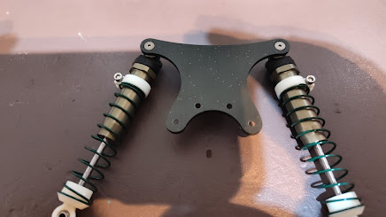

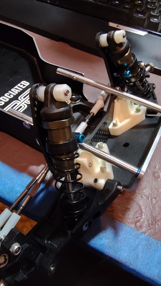

Rears mocked up. Need to mod the rear bulkhead soon.
rear tower shocks.jpg (24.45 KiB) Viewed 113 times

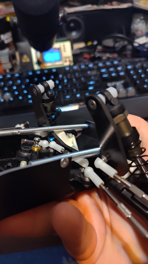

Nose assembled with titanium screws. Spacers changed to 1mm. Not you have to tighten the 3 noseplate 8-32 screws before doing this. I also ran the 100deg countersink in the 3x chassis to noseplate #8 screw holes a bit to make the screws sit a little better. I had already done the #4 holes earlier.

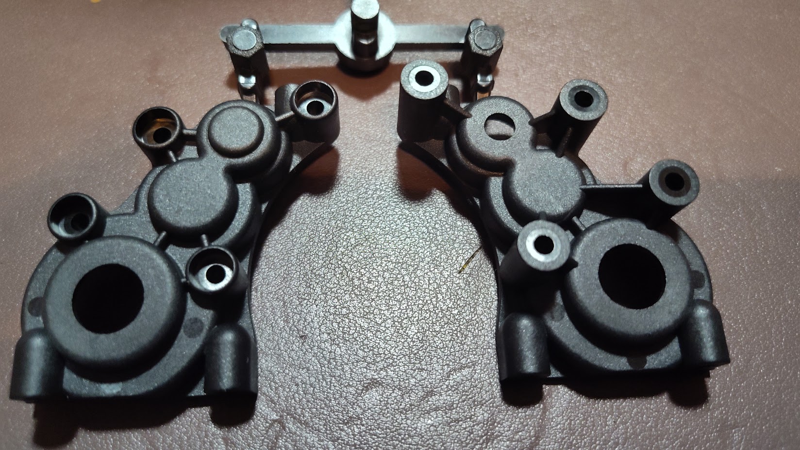

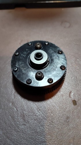

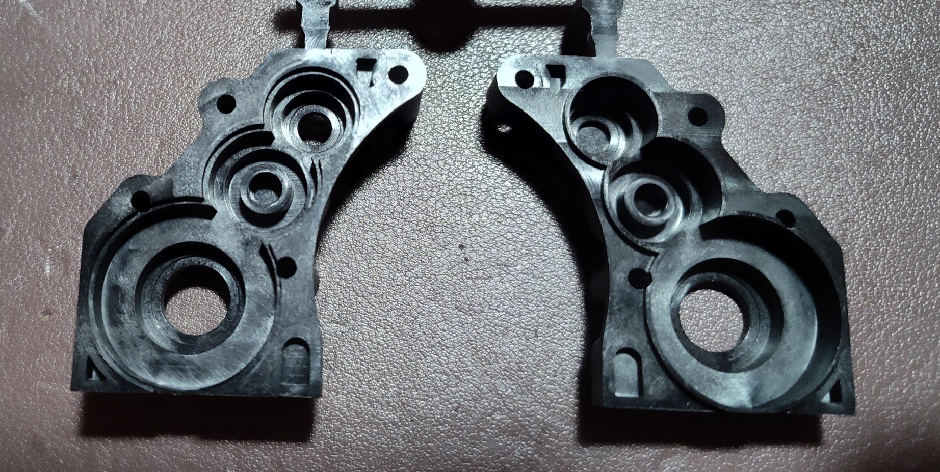

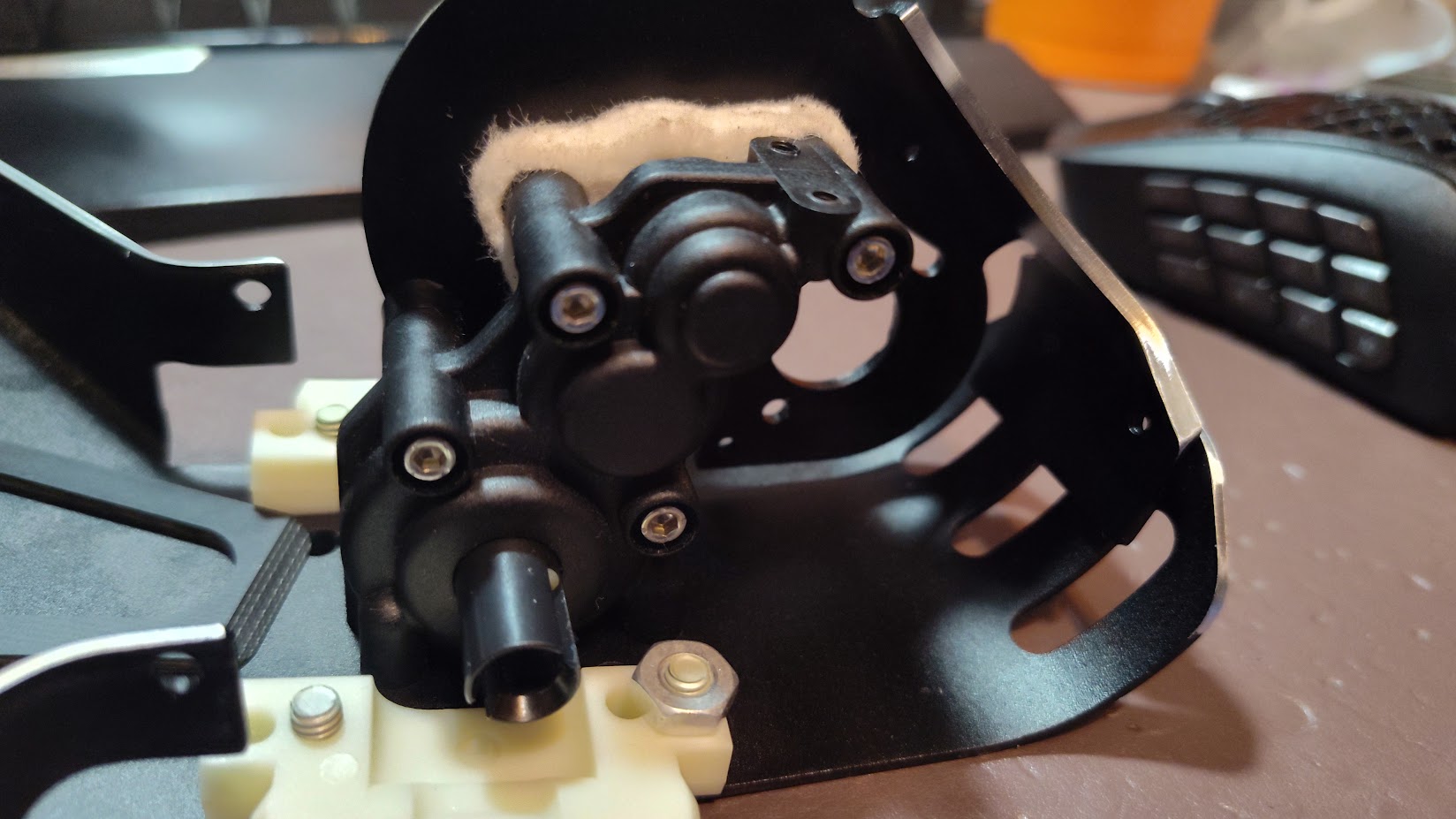

The transmission supplied with the kit is a modernized unit, with extra webbing, molded in spacers and a different idler gear with internal bearings. This is a strange choice to me, since the DS came with the proper transmission molded in black already. I decided to just swap the trans out of my DS to use on this car as its more proper, and will put the newer style trans into the DS. This will also allow the use of the felt gasket. I need to change to a grey felt though as the DS was supplied with a white one.

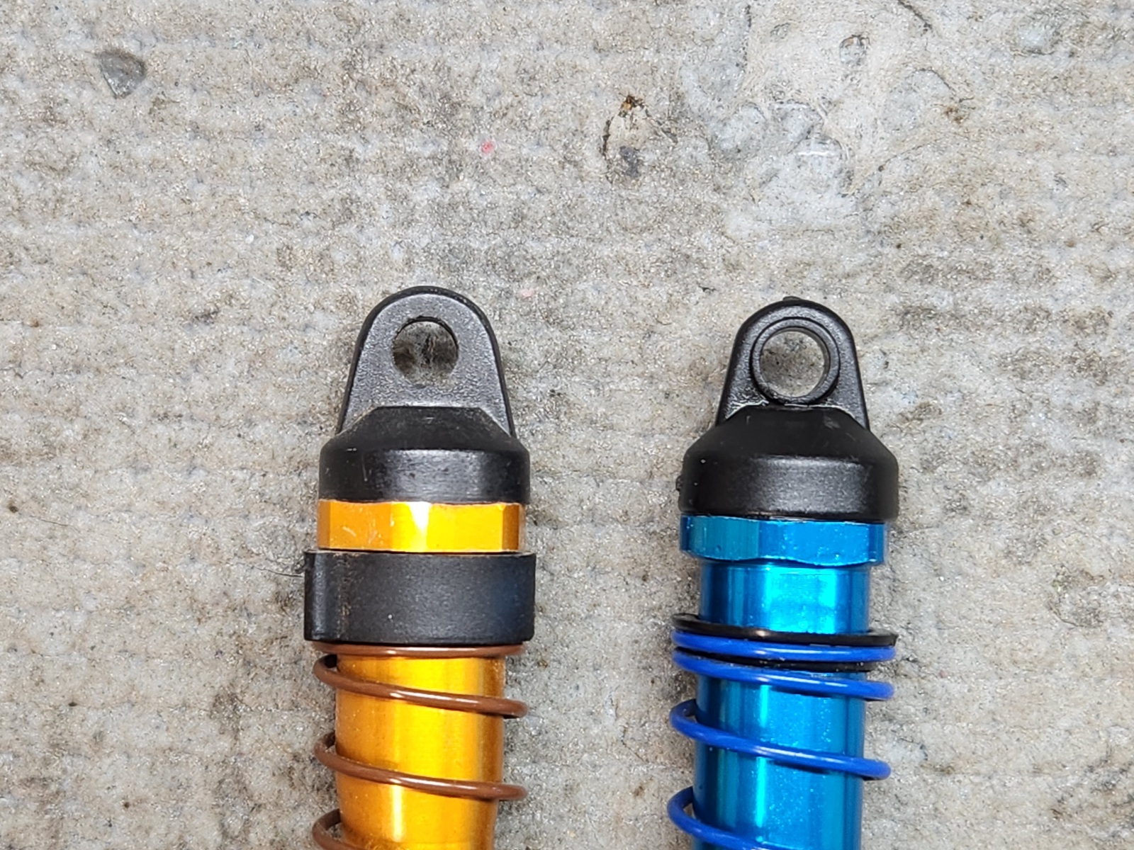

From the recent chat talk. Correct ones on the left.

scr8p wrote: Sun Jul 06, 2025 1:08 am From the recent chat talk. Correct ones on the left.
I'll have to pick some of those up at some point but honestly when the ones i got are installed they look basically the same unless you look really close. This is it with the B4 caps.
It's not right, but it's more right than the bleeder caps in the kit. Plus side is now my B4 has bleeders.

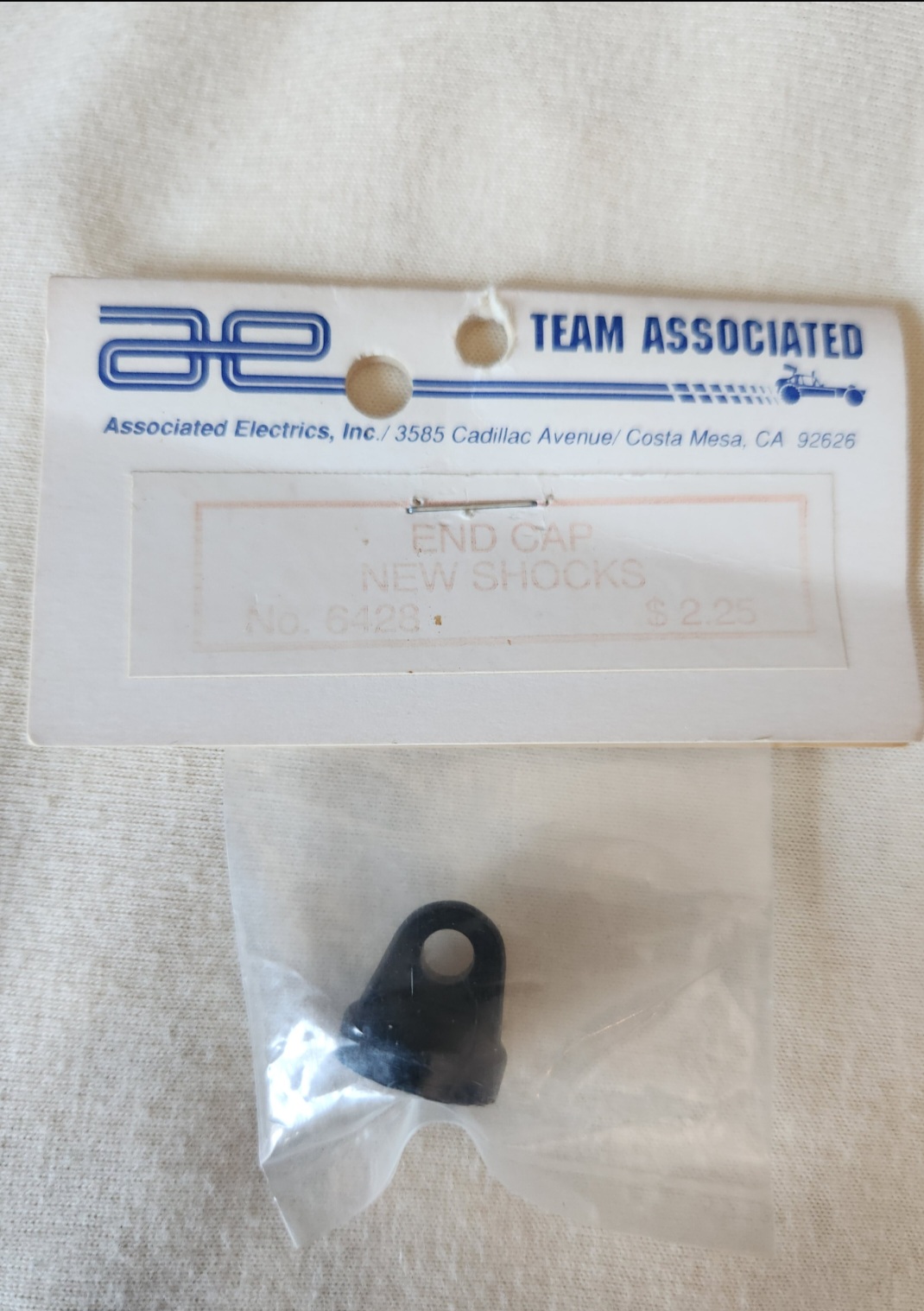

Straight to ebay for those early plastic rc10 CE caps. There were a handful of gold shocks with those plastic caps on them from parted out CE's.
Posts: 9302
Has thanked: 365 times
Been thanked: 483 times
Re: "Make it trick!" - RogueIV's Enhanced Kinwald Rplica (and runner)
I've sold all of them already, but this is the correct early cap for further reference
