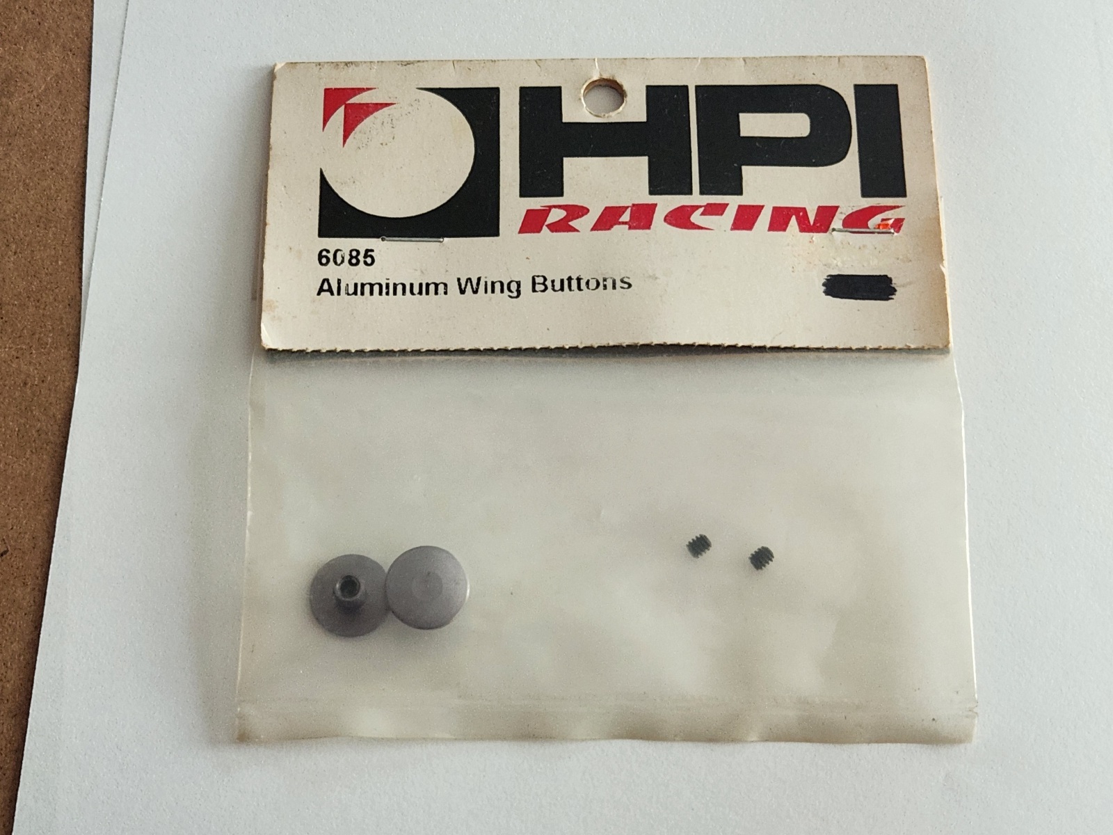

I'm not planning on getting super crazy with OG parts on my build. But these wing mounts showed up on ebay dirt cheap and I wasn't gonna pass on them.
