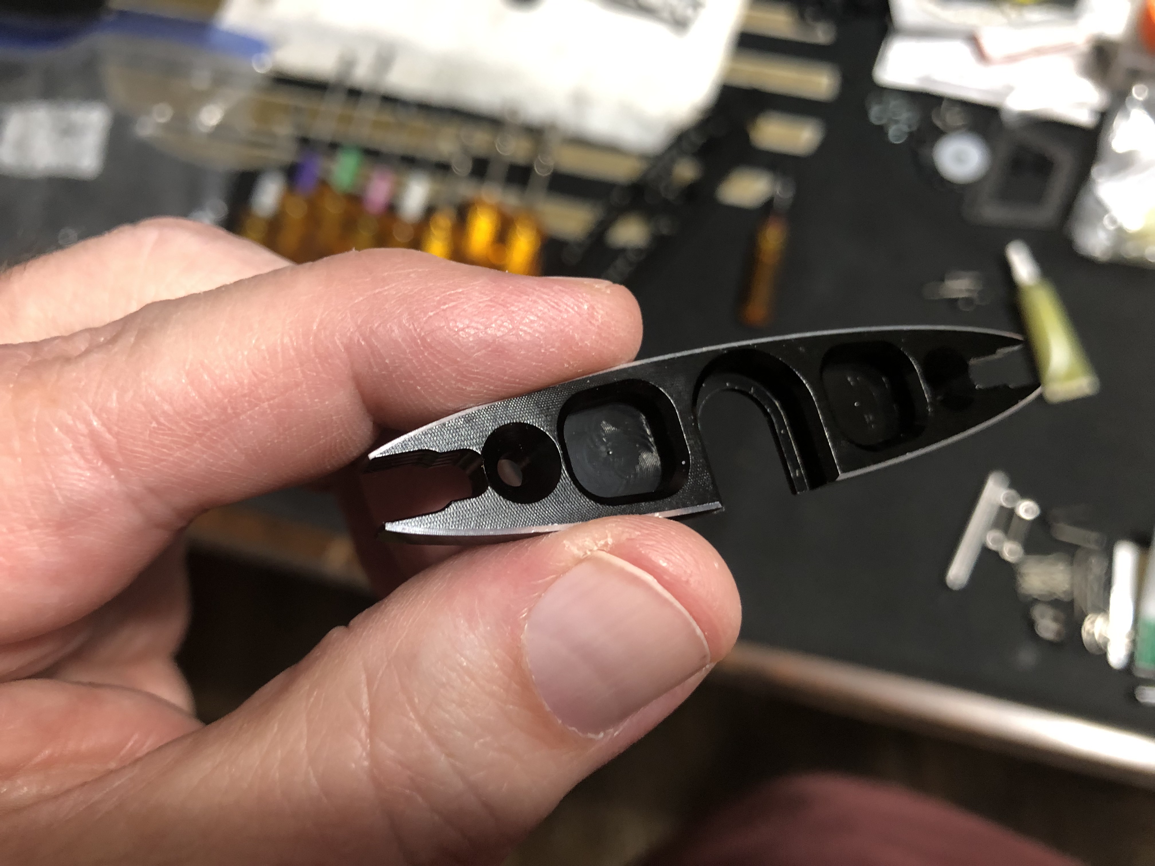

From using my own tool, which is different, I can only say what I have found those areas useful for:
The squarish areas between shock shaft and ball end, for griping hexes on the top of shocks like AE, although I much prefer my rpm tools
The measuring section with the T shape is for measuring screws. The shape of the screw is like a flathead screw
The circles of diameters I can only assume are for sizing shafts. Not sure why anyone would need that though.
The end of the tool that doesn't close all the way, I would assume are for turnbuckles.

They are multi-function pliers. Some of the holes are for measuring ball stud sizes, I recognize several of them from different brands. Others are for holding terminals during soldering, although aluminum isn't the best material for this (it acts like a heat sink during soldering).dldiaz wrote: ↑Mon Jul 07, 2025 10:30 pm Does anyone know what all the different functions of this shock shaft tool are??
I understand holding different size shock shafts, and the ball end link on/off function.
But what are all the numbered holes for?
And the numbered longitudinal section with like a "T" shape to it?
And the plier end, which does not close down all the way?
And the two larger openings between the shock shaft and ball end link sections??
Thanks for any advice - I feel like I do not get my money's worth out of this thing!
I found this for a similar set.

Ahh for measuring ball studs, I like that! I couldn't think of a reason for those particular sizes but that totally makes sense now.

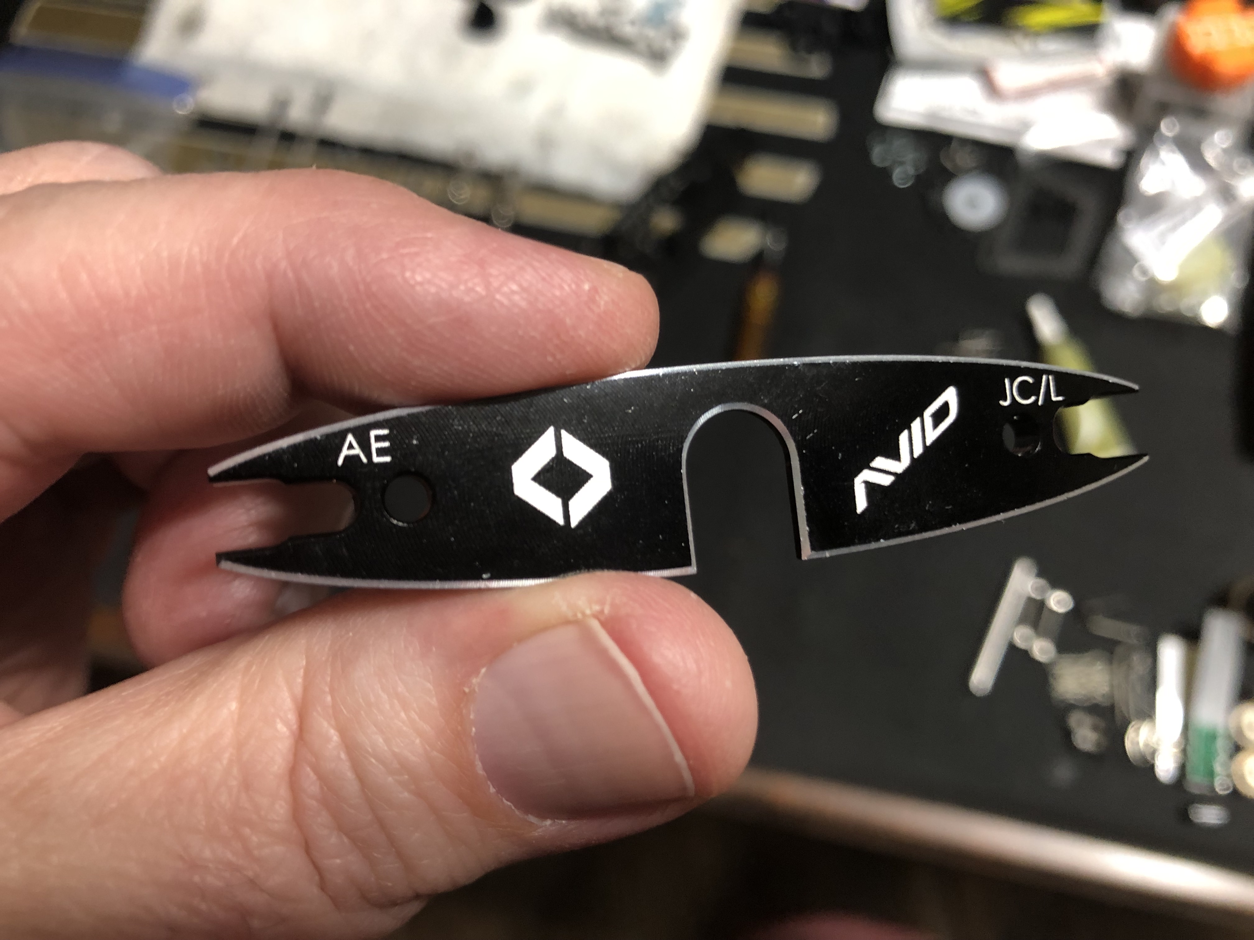

I have another tool question:
I think this may be another shock tool of some sort, but I cannot find it on Avid website or other searches.
- Seems to be machined for a flathead screw to go through the hole on either end?

AV1010 Associated 12mm Shock and Turnbuckle Tool
The Avid Associated 12mm shock and turnbuckle wrench is a great companion to have in your tool box. The tool offers the ability to adjust Associated, Jconcepts, and Lunsford turnbuckles all in one. It can also be used to hold the shock bottom of a the new Associated 12mm shock, so no need to carry that stamped AE shock tool anymore! But we didn't stop there.
Have you ever had difficulty getting your servo mounted in your B44 because you were trying to make sure that there was no tweak in your mounts when locking it down (servo mount holes perfectly line up when attaching to the chassis)? If so, then problem solved because we added two holes to the tool that mimic the B44 servo mount holes so you can mount your servo up to our tool without being hindered by the gearbox. This allows you to get everything nice and centered. Once you got your Avid Servo Mounts (any servo mount will work though) squared up then detach it from the tool and mount it to your chassis.
Details
Adjust your Team Associated, Jconcepts, and Lunsford turnbuckles all in one tool.
Shock body retainer for 12mm Associated shocks.
B44 servo jig for ensuring your servo doesn't get mounted incorrectly (tweaked).
6061 Aluminum alloy, black anodized with silver edges and laser etched logo.
Each package includes 1 tool and 1 AVID mini decal sheet.
Fits the B5, B5M, B44.2, B4.2, C4.2, T4.2, and SC10.2.
Details
