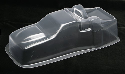

Anyone use a T4 body on the black/ gold tub? Now I'm building a 10T runner so I need a body. However, only T3 and T4 body is available. What other modications needed to make them fit? Also, the 10T require 2.62" turnbuckles all round right? Any advises is very much appreciated. Thanks.

RC10 t3 bodies will fit on there, without too many mods:
For the rear dont' use the stock 10t body mounts, use a body post on the tranny brace, like you would on a RC10 buggy, but make sure it's a bit longer.
The front mount will work without any mods.
The body that would look best, besides the Original 10T, it's a 10T2 body, Like I've used on my Vintage Nationals Truck, make sure that you use the RPM rc10gt body mounts and use the inner mounting points, and it'll fit perfectly.
the 10t2 bodies you can still find on ebay.

I'm in the process of adapting my JConcepts T4 Illuzion body to my RC10T w/ Tekin mid motor conversion. I'll post some pics when I get it done.

Brat wrote: However, only T3 and T4 body is available.
Like tecnica2001 said the T2 fits perfect and looks period correct, and Associated still shows the T2 body #6132 as a Available part, I had my LHS order me one couple of months ago.

i have a t3 crowd pleazer on my 10T. just use a long post in on the tranny brace like technica posted above. fits pretty good. looks nice if you want the "modern" look but i think i might try and find a period correct body.

the t4 crowdpleazer fits on th 10t if you use the rpm body mounts.
this is mine.
this is mine.
Re: T4 body on 10T tub?
Any chance with the body off the tub? Please....acerpower1 wrote:the t4 crowdpleazer fits on th 10t if you use the rpm body mounts.
this is mine.
front mounts................
rear mounts.................
i hope this helps.

Got it! Thanks acerpower1. Had placed an order for the T4 Crowdpleazer but...where to find the RPM mounts? ITowers do not have them... Any ideas? Preferrably Ebay stores? Thank you once again.
Boo on the T4 body Boooo
Just kidding...
RCboyz I think still have them: http://cgi.ebay.com/RC10GT-Blue-Adjustable-Width-Truck-Body-Mounts_W0QQitemZ350100043394QQcmdZViewItem?hash=item350100043394&_trkparms=72%3A1205%7C39%3A1%7C66%3A2%7C65%3A12%7C240%3A1318&_trksid=p3286.c0.m14
I've bought from them many times very reliable.
If not, just type in RC10gt body mounts.
Hope that helps.
towerhobbies still has them. i just checked, i can't figure out how to post a link(not so good with computers) but, towers stock number is:LXEV48
manufacturers stock#80542
i know the t2 body looks period correct and better in some opinions but,
i don't feel as bad messing up a t4 body when i flip my truck.
plus, i didn't see any t2 bodies at tower when i last ordered a body.
SO PLEASE DON'T HATE ON ME!
Thanks alot guys! I do not feel good landing hard onto the newly painted/ acquired 10T or T2 body shell!! They don't come cheap!!!
Just stick in a truck body and bash the bugger!
