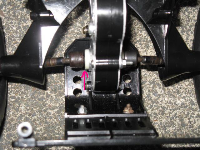

The left outdrive on my Monster Beetle has a gap between the base of the outdrive cup and the plastic bearing carrier and it makes the left rear suspension bind slighlty.
I've rebuilt the tranny three times,as per the instructions,but the gap,arrowed crudely by me in the photo,remains.
Any advice? Suggestions?
That don't involve a dremel and shortening the outdrive?! :roll:

I had the same problem...with the transmission :lol:
It kept binding, so I placed a very thin shim between the diff gears so that it wouldn't bind. I also shortened the outdrives.
If this is a runner, you may want to use the new dog bone set up that came with the re-released frogs. You can still use the old rubber dog bone cover to keep it looking original (and keep the dirt out).

I just saw your last line about not using a dremel. You can put a shim (washer) between the outdrive and the plastic bearing holder (both sides). I personally don't like this solution because you can see the washer and there may be excessive heat because of the friction.

Many,many,many thaks Highway! :D
I don't think I'll shim it,these trannys have a habit of 'spreading',anyway.
I think I'll just shorten the outdrive and be done with it...Freakin' Tamiyas!
Have they ever heard of something called 'tolerances?! :roll:
I guess not...
