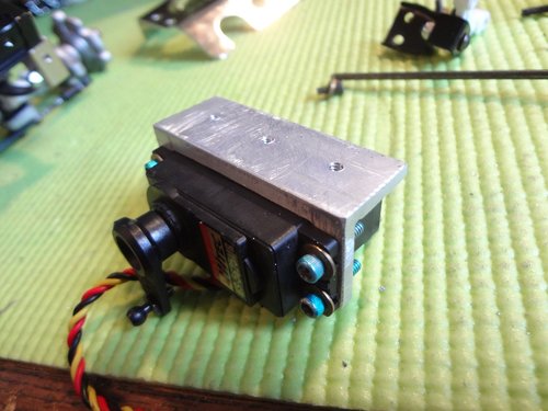

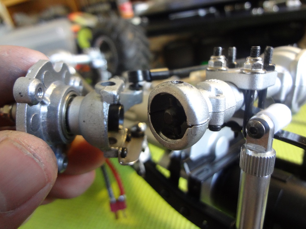

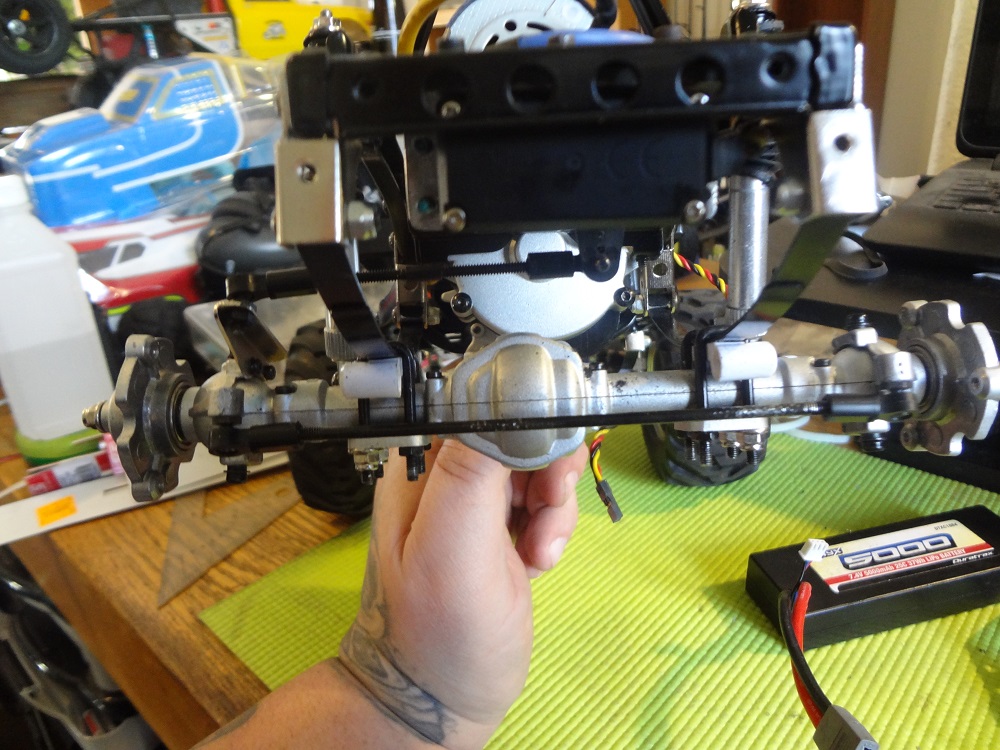

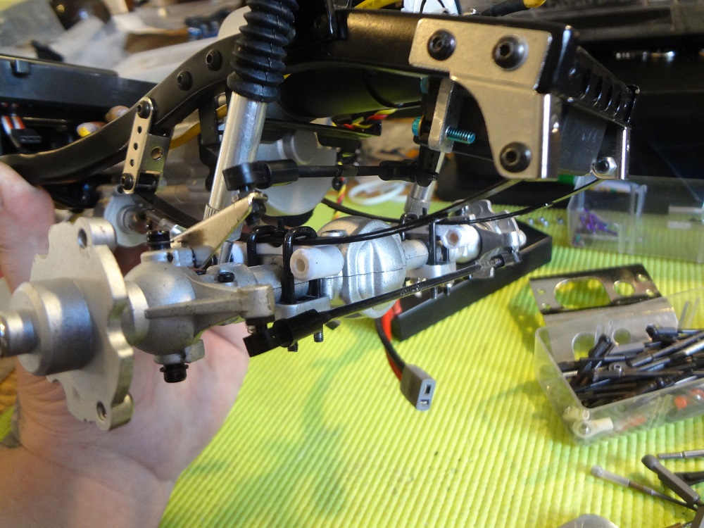

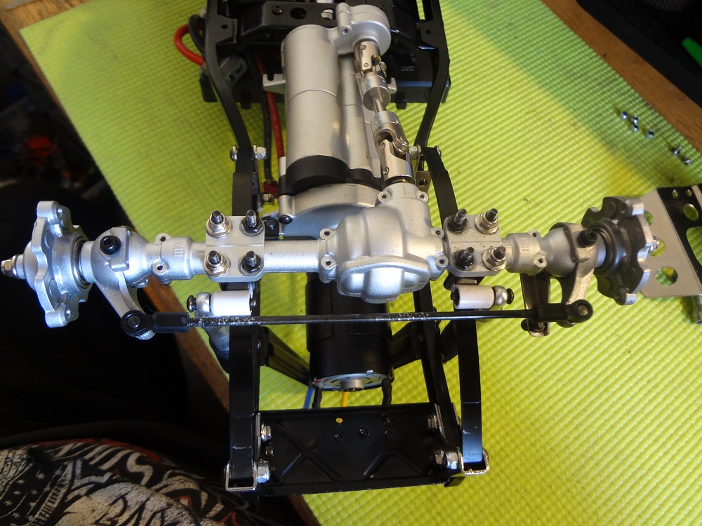

Finished the steering this afternoon and what a difference! More steering, rock solid and more scale appearance. I understand that in the time of the original bruiser release, electronics and servos were not exactly waterproof and it made sense to protect them by having them in splash proof box, but these days, there is just no good reason I could think of to mount the steering servo in the rear of the truck. The required linkage and dreaded pivot point required to connect this rear servo to the steering knuckle borders on ridiculous and is inherently sloppy and weak. I cannot claim the idea for this mod since it came from a few youtube videos. The end result is, imo, the way these should have been designed originally. I removed the steering knuckle/hubs and switched sides they were on, moved the lower shock position to the rear mounting point, fabbed up an aluminum bracket to mount the servo up front, and bolted it all back together. By far, the best mod I've done to this truck yet.

That's a tidy bit of work Basher , can the hub to hub track rod ball joints be mounted on top of the knuckle instead of under ?
