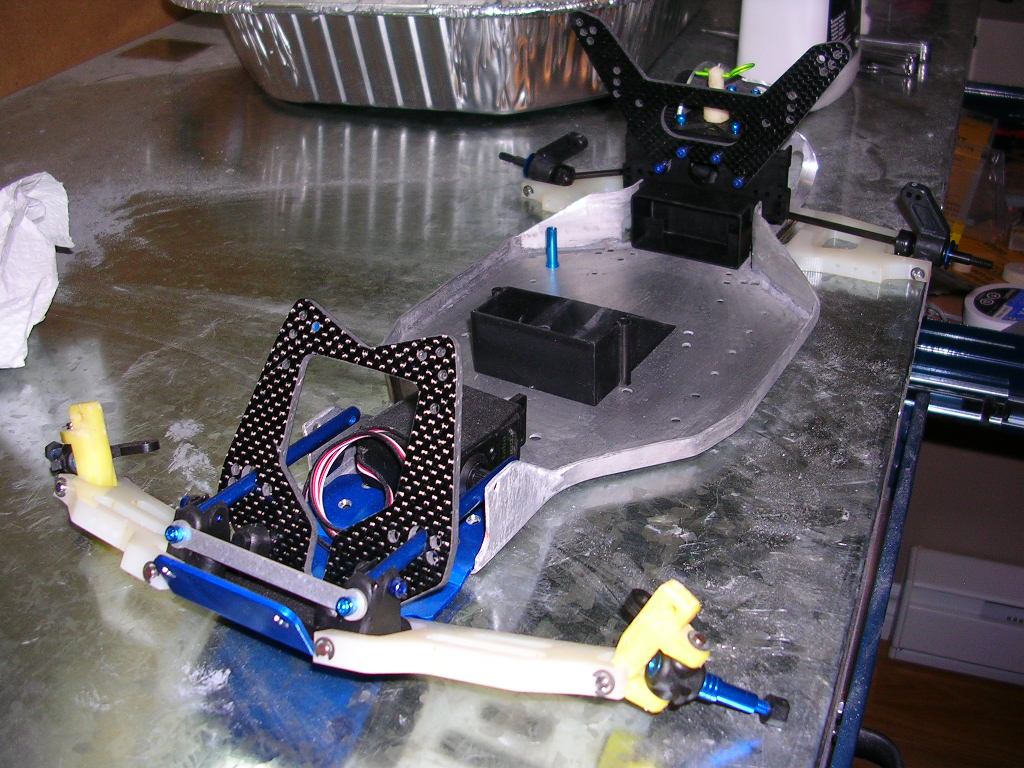

I just got started on my old, but newer associated 2wd buggy...here is what I got so far.
I got many more parts to come and a lot more sanding & drilling to do on the chassis :mrgreen: , I even have a few old dyed yellow RC10 parts to dye black :lol:
I order the wrong bearings from Avid :cry: , is there a bearing that fits a rear 10GT hub with a B44 rear CVA kit :?: :?: :?: I ended up with the ones for the RPM hub and B44 CVA :oops:

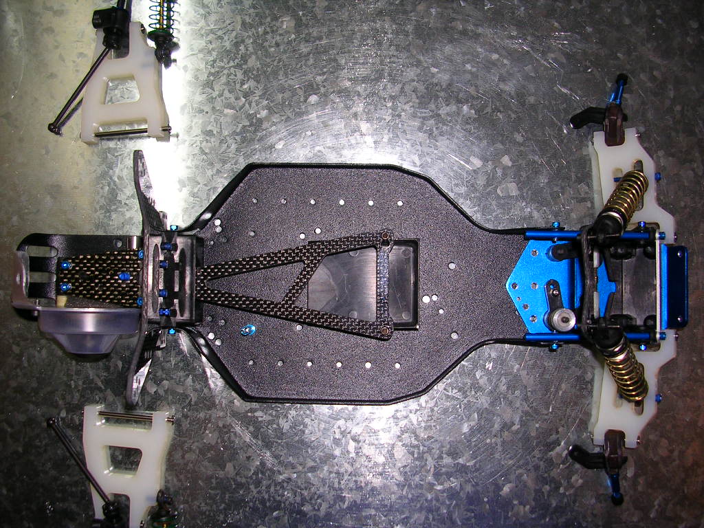

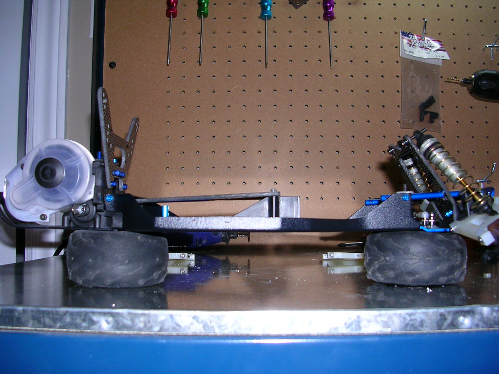

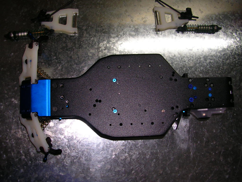

Here is an update on my chassis...I got it powder coated black with a added hardner to it, so no more worrying about scratches :D and it looks like new :D it's come a long way from where it used to be.
gold pan chassis top before.JPG (18.16 KiB) Viewed 1039 times
gold pan chassis bottom before.JPG (18.22 KiB) Viewed 1039 times
I am thinking about drilling some 1/2" holes in it along each side of the battery tray, but not sure yet.
Here are some pics for now..waiting on parts is painfull. I'll post more when I get more done
cheers
