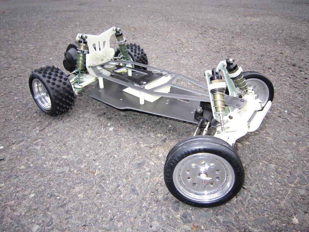

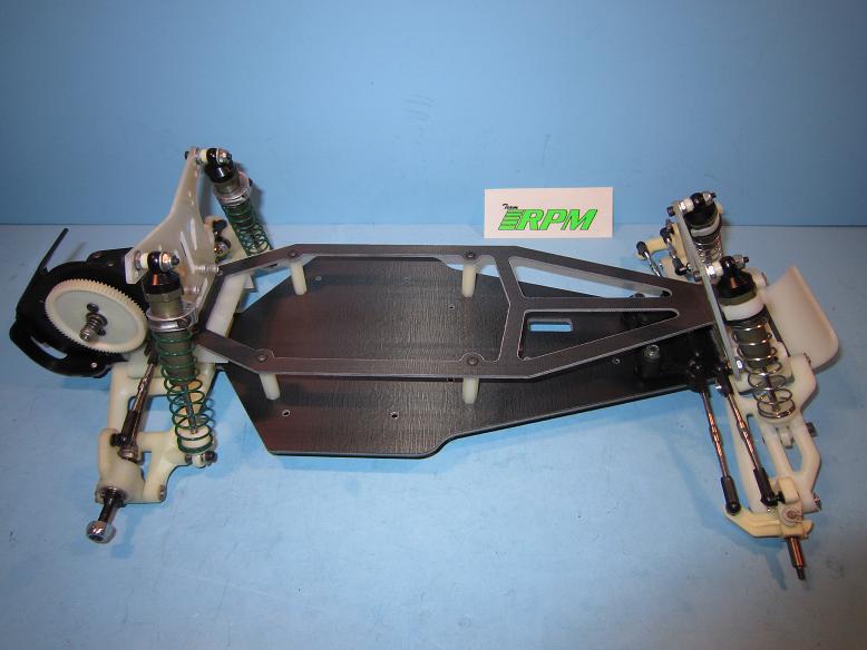

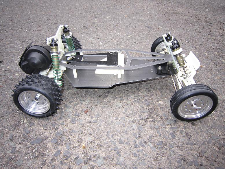

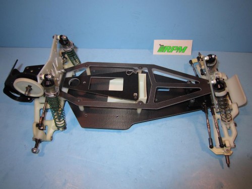

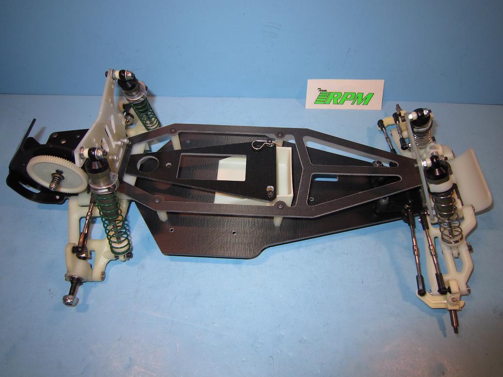

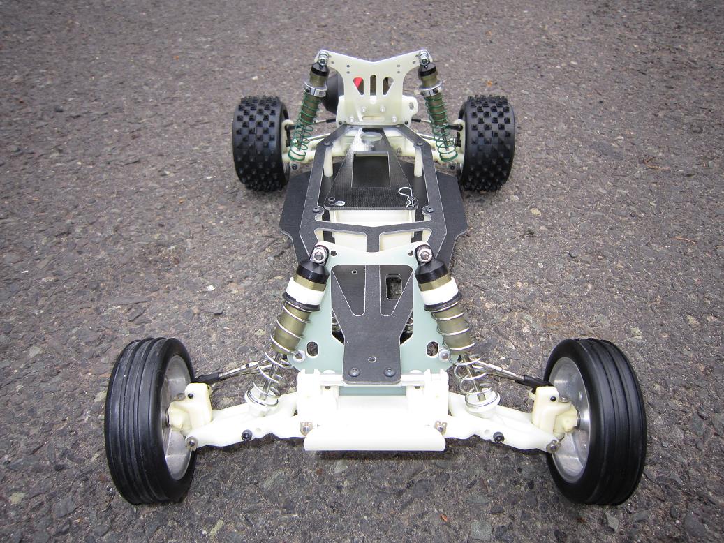

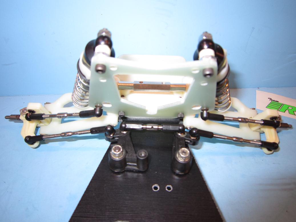

I found some time to complete the chassis. This indeed was a very fun build. I went with the mip steering as the rpm kit seemed kind of cheesy. I really want to put electrics in it and run it but can't bring myself to see it get a single scratch on it. Well next is a body and i think a viper body may fit if i cut down the front a bit. It always takes me forever to mount bodys on these shelfers, but this one is my favorite so far and is crying out for a bodyset. I hope everyone enjoys the pics and thanks again for the kind words.

Nice Build, looks great :!:
fastang
Posts: 751
Re: Composite Craft Worlds Car build
Post by fastang »
You have no idea how jealous I am!
Simply beautiful!

Very nice!
That battery brace design was from the time when they allowed 7 sub C cells in modified, which allowed you to put the 7th cell on top of the 6-cell stick pack.

Thanks! Learn somthin new every day 8)

Wow what a nice car. with those See's wheels its almost sexy :lol: makes me want to build a RC10. It would be a shame to cover that chassis up with a body I would leave moxt of it clear. to see that chassis
