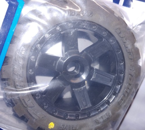

These are actually for the 90s vintage Stampede, so they have the bearings in the wheels. I'll watch ebay for the adapter rings. Thanks.juicedcoupe wrote: ↑Mon Apr 05, 2021 3:45 am A Stampede uses 12mm hexes, and have different front and rear offsets. I have a couple 10T's that use Traxxas caster blocks and carriers to convert the front to hexes.

My Stampede is from the late 90's, so they must be older than that. I was wondering if you might have been confused with a Sledgehammer.RC10TforLife wrote: ↑Mon Apr 05, 2021 4:02 amThese are actually for the 90s vintage Stampede, so they have the bearings in the wheels. I'll watch ebay for the adapter rings. Thanks.juicedcoupe wrote: ↑Mon Apr 05, 2021 3:45 am A Stampede uses 12mm hexes, and have different front and rear offsets. I have a couple 10T's that use Traxxas caster blocks and carriers to convert the front to hexes.
There were several Tamiya wheels that used 11mm OD bearings. The adapter rings pop up on Ebay fairly regularly.
Anyway, a quick search turned up about 10 sets of those adapters on ebay.

Yeah, I probably am a little confused, but the wheels are for sure not hex ones, they're made for 11mm OD bearings. I dug out the proline package to see what the label said. It's a little different than what the seller told me, but it doesn't really change the situation. I still have 11mm bearing wheels I'd like to use on my 3/16" axle RC10GT and RC10T.juicedcoupe wrote: ↑Mon Apr 05, 2021 11:47 amMy Stampede is from the late 90's, so they must be older than that. I was wondering if you might have been confused with a Sledgehammer.RC10TforLife wrote: ↑Mon Apr 05, 2021 4:02 amThese are actually for the 90s vintage Stampede, so they have the bearings in the wheels. I'll watch ebay for the adapter rings. Thanks.juicedcoupe wrote: ↑Mon Apr 05, 2021 3:45 am A Stampede uses 12mm hexes, and have different front and rear offsets. I have a couple 10T's that use Traxxas caster blocks and carriers to convert the front to hexes.
I might be searching for the wrong thing because I haven't found anything on ebay that would work. What are you searching for? Thanks!

I keep trying to attach the pictures of the package but I get an error that says the files are too large. What's the size limit for attaching images? The proline part number is 1175-11.
