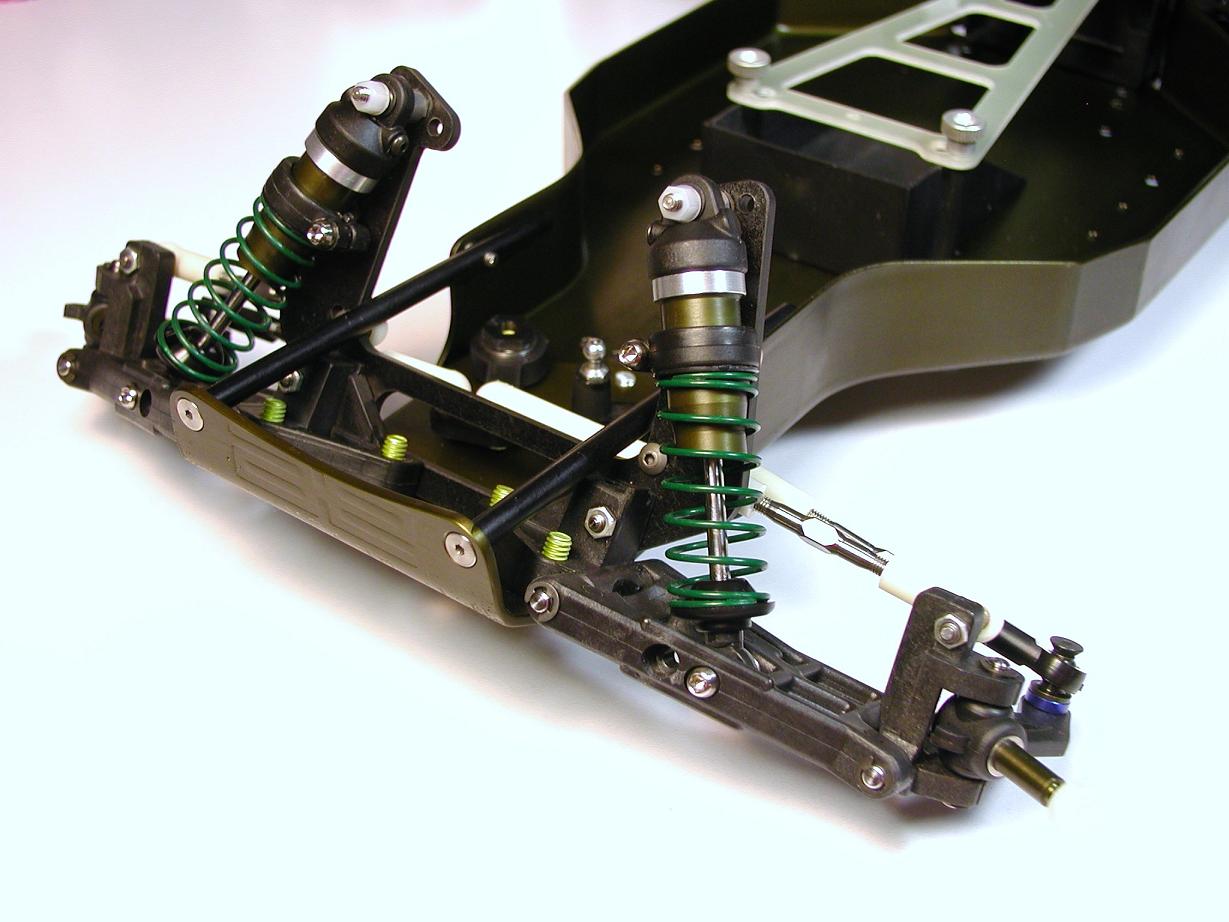

- Posts: 1136
- Location: San Jose, Ca.
Re: Modern frustration with the old car
I too had the issue with the front ball cups popping off. In this pic you can see the thru bolt design. Haven't had an issue since. -Jeff
