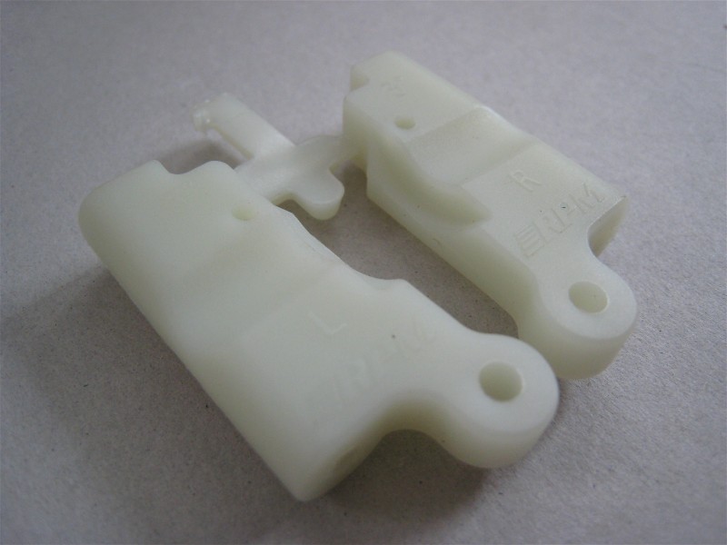

Thanks for posting the updates, really digging the creativity and all the work that has surely gone into this. Surprised at the white parts but shows your patience to get all the right stuff, and it looks really cool with the gold.
I'm guessing from the ruler pictures that you're showing the front and rear track is still within ROAR guidelins (sorry I don't know them, but always read on here that the Klein setup was legal, but those arms on your build are very long!).

It would figure those are the arm mounts he used. I've been looking for those for a long time.

Are those RC10T front arms? And what rear arms did you use? I like how the rear mounts are right up to the tranny.

Thanks so much for all the props gents. I don't have a whole lot of free time these days, but I do like to continue with 2-3 different RC10 projects, all very much inspired by this 10talk site and my childhood roots.
redrilled new holes, essentially shortening the arm. I wish I had photos but I was so concentrating on getting it done in the right alignment I forgot about the photo thing.
I do have a cool new addition I put into it today. I was looking around to decide where I wanted the ESC switch. Looking forward to running this thing, I remember hating switches that end up flopping around after whatever servo tape or zip tie setup fails.
After staring at it a bit, I got an idea. This is my newly positioned Novak switch, firmly held in place with nothing more than a strategically longer screw through the bulkhead..
That sucka aint going anywhere
10t front AND rear arms actually. The rears were a used pair that were heavilly worn and actually broken at one point at the inner pin holes. I cut them down and figured out a drill press jig and REALLY CAREFULLYdspy8083 wrote:Are those RC10T front arms? And what rear arms did you use?....
