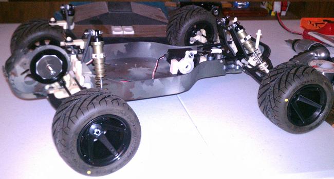

    Finally, a rolling chassis!

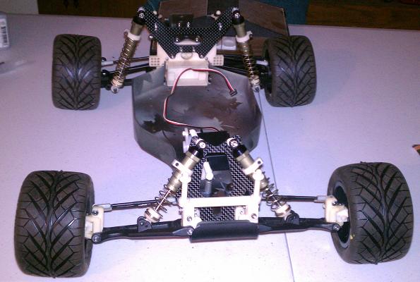

    Another pic...

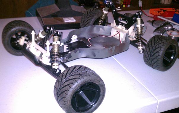

    One more...
