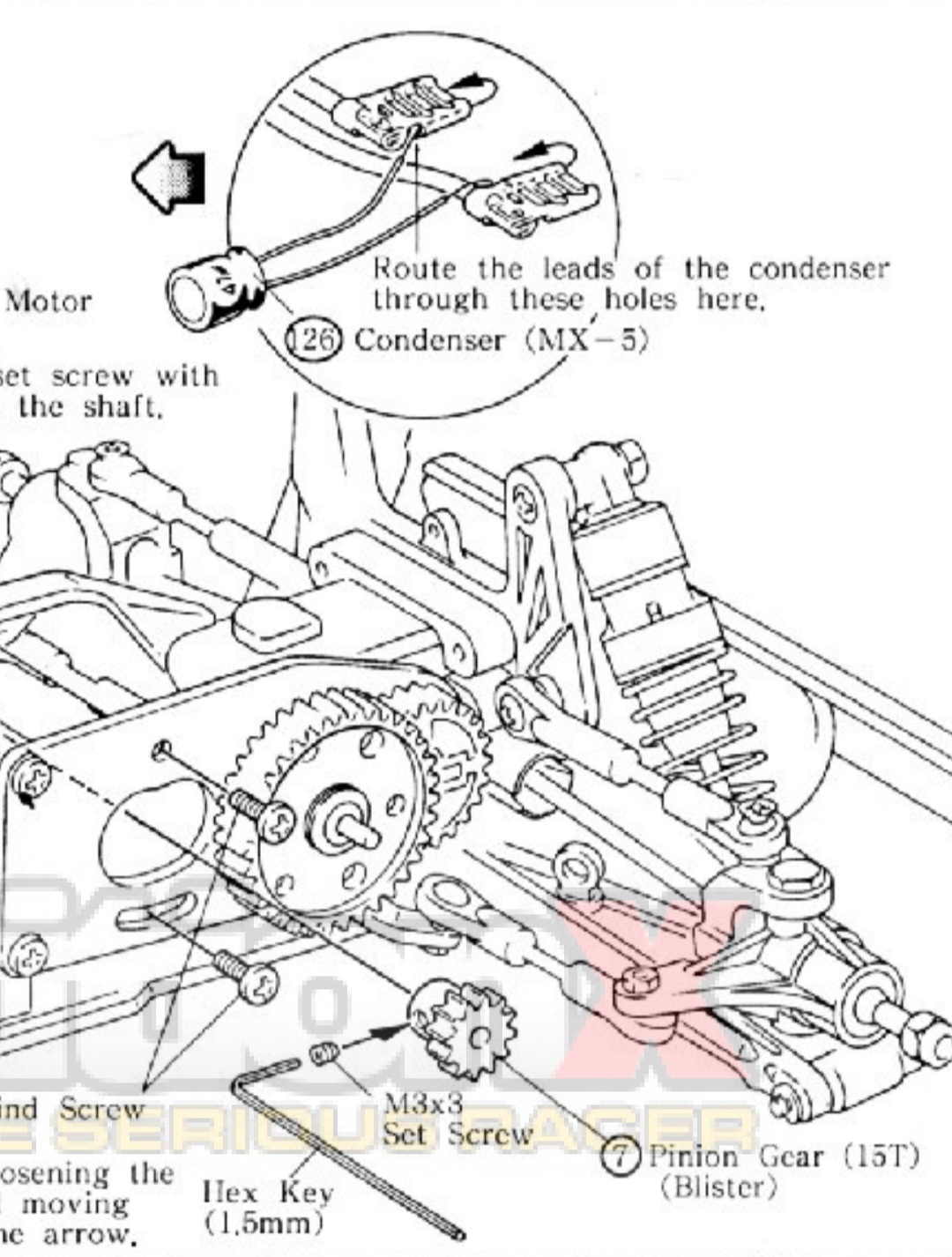

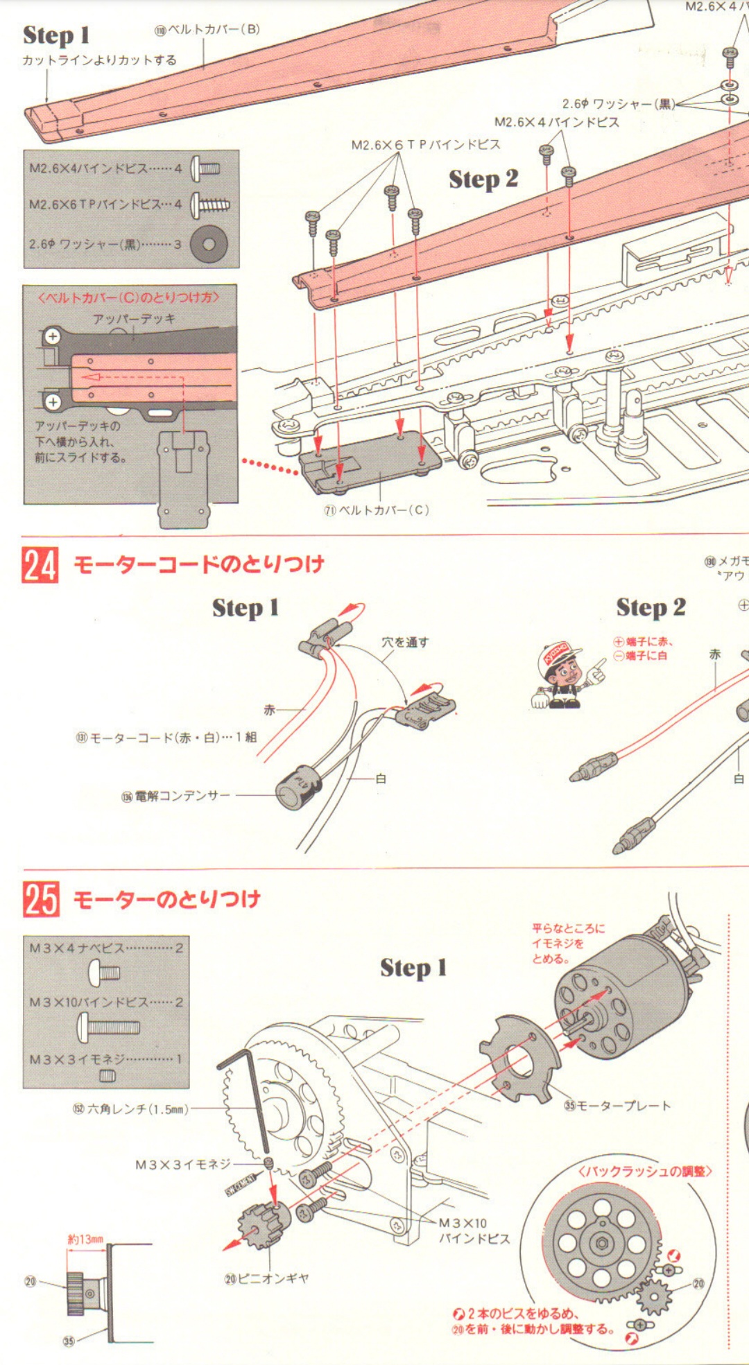

It's weird that Kyosho cars came with polarized caps and mechanical speed controls with reverse. Is it possible that the motor drew all the current so the cap didn't see any?

GoMachV wrote: Tue Feb 11, 2025 4:35 pm It's weird that Kyosho cars came with polarized caps and mechanical speed controls with reverse. Is it possible that the motor drew all the current so the cap didn't see any?
Hmmm, interesting. Are you sure they were polarized? There were(are) non-polarized aluminum can-style capacitors. They look pretty much the same but without the + or - markings on the shrink wrap.
Posts: 12355
Has thanked: 1134 times
Been thanked: 3934 times
Re: how do I know the capacitators are ok?
Very possible, I don't have one here to look at. That would make the most sense. I didn't realize there were non polarized can style caps
