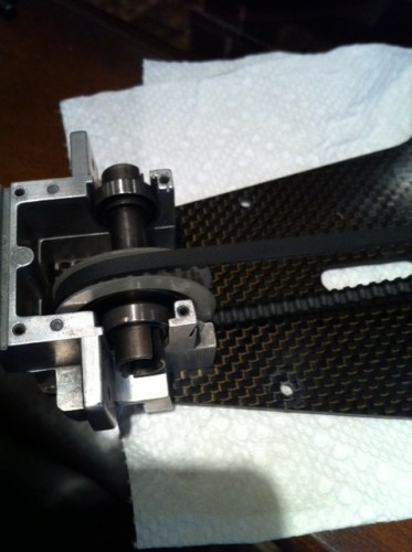

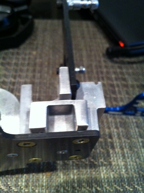

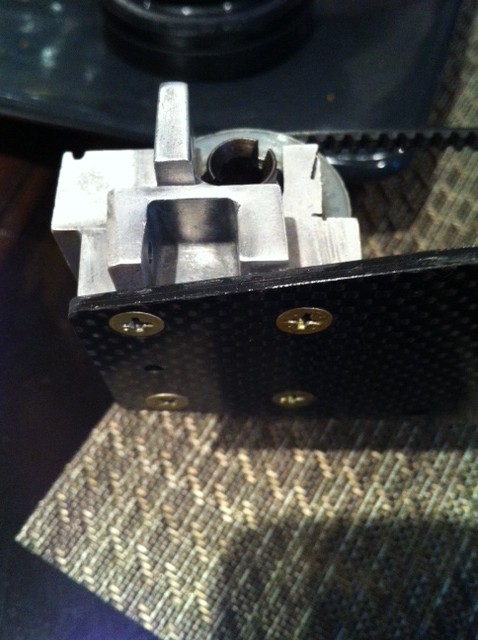

Some inquiring minds (you know who you are :P) wanted to know if the magnesium bulkheads fit correctly on the YR4 chassis...
...well sort of, the back bulkhead appears to fit no problem, but the front appears to require shaving down on one side (see pics) where the previous owner started.
Without shaving it down the steering component bump or rub against it...

Are you running two rear bulkheads on this car? It looks like the first and second pic is of the front of the chassis but that bulkhead is a rear bulkhead...that is why you need to grind off the long side to clear the steering. The front bulkhead is even on both sides.
USAF Retired
870C, Works 91, YR4-M2 Pro, RC10 Graphite, RC10 Carbon fiber tub
Old Skool RC10 Gold pan, RC10DS, Traxxas REVO
aip47-2008
Posts: 1191
Location: Spokane, WA
Has thanked: 170 times
Been thanked: 23 times
Re: Yokenstein Dogsbreakfast
Post by aip47-2008 »
x2
definitely a rear bulkhead in front! You can see the notch for the rear sway bar.

Hey guys, thanks for pointing that out, it was so obvious, can't believe it was overlooked. Might have to shave it down anyways, its already half started :lol:

You'll need to get a new bulkhead for the front: the kick-up is wrong with the reversed rear bulkhead.

I think he wants to know if he can use the chassis pictured and just run some straps to hold the LiPo's in.
I would make some sort of cradle (like the one used on the B44) that will provide some latteral stability and then you could use the straps without worrying if they will slide out the sides.
And a second on the front bulkhead it will have the angle going the wrong direction (front of the arms pointing down)
